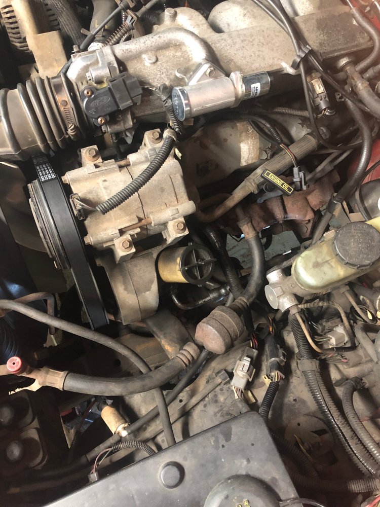

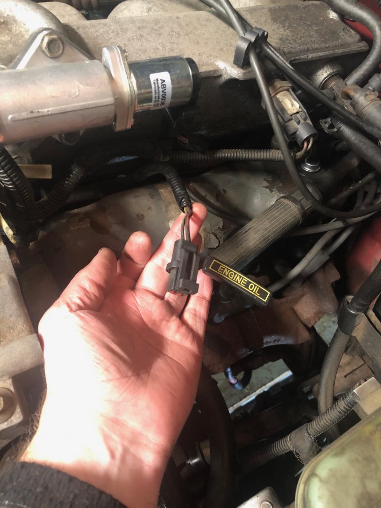

-The vacuum line that runs from just in front of the TB to the evap canisters has a solenoid. I can apply voltage and get it to funtion but does not have a perfect seal, not sure if it needs a 100% seal. Also, the connection is not complete (no voltage) see attached photos. Anyone know where / what this plug above the driver side valve cover plugs into?

The hose to the evap purge solenoid valve looks worn through. Go check on that...
Thanks for the reply. Good eye, can’t believe you saw that in the photo. I saw that when I bought the truck and thought it was a smoking gun but the line is a hard plastic with a soft rubber jacket. I tested all the lines with a vacuum pump disconnecting from their source and plugging. It holds vacuum with no leaks.

Any idea what that plug is above the driver side valve cover? One of the two wires has continuity with the evap line solenoid. I can't find it's mate or anything that looks like it is disconnected.
Can you get a pic?

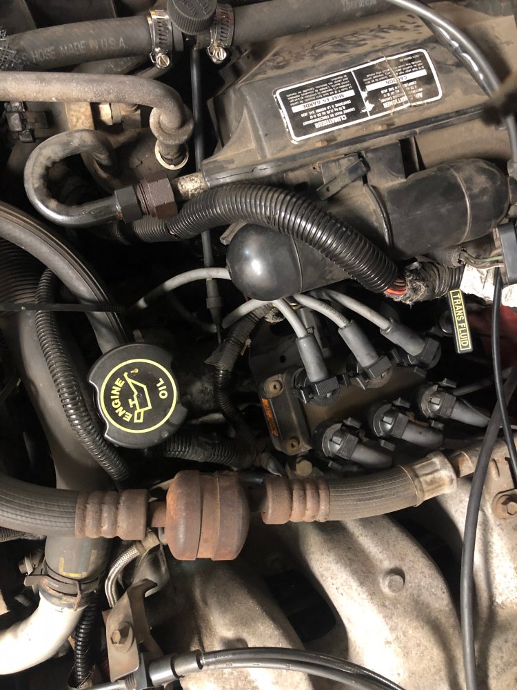

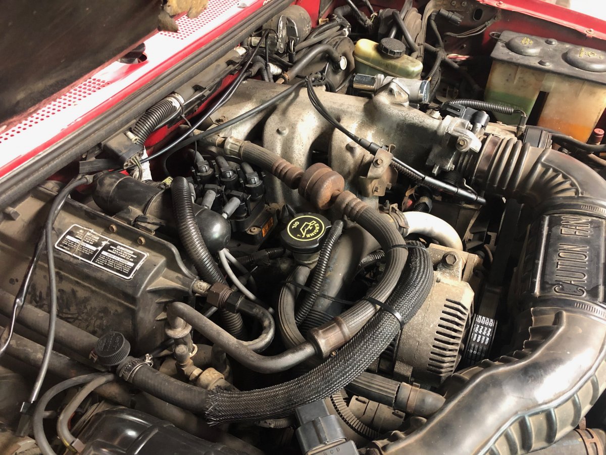

Also wouldnt hurt to get a shot of the passengers side of the engine. Maybe I can see something...
Can you get a pic?

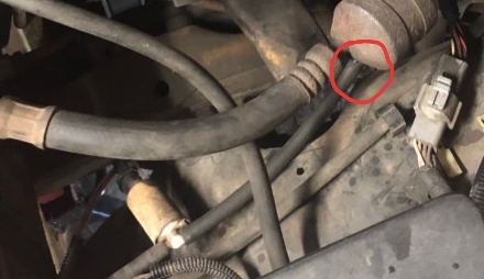

Here are a bunch of pics. The one circled in red is the mystery plug that has continuity with one side of the evap solenoid plug. I can trace the wires along the yellow line and into the gray plug then one of them to the evap solenoid. Also, can you identify the sensor circled in green?
There are two other "mystery" plugs on the driver side of the engine compartment. So far I've not found any on the passenger but I included a pic of the passenger side also.
