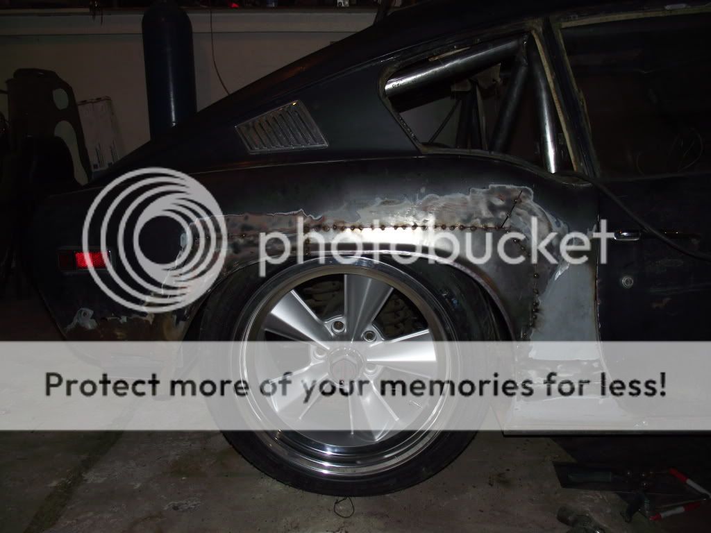

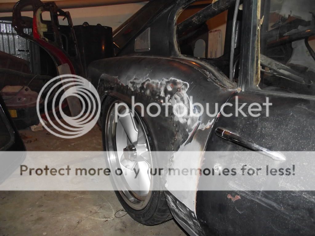

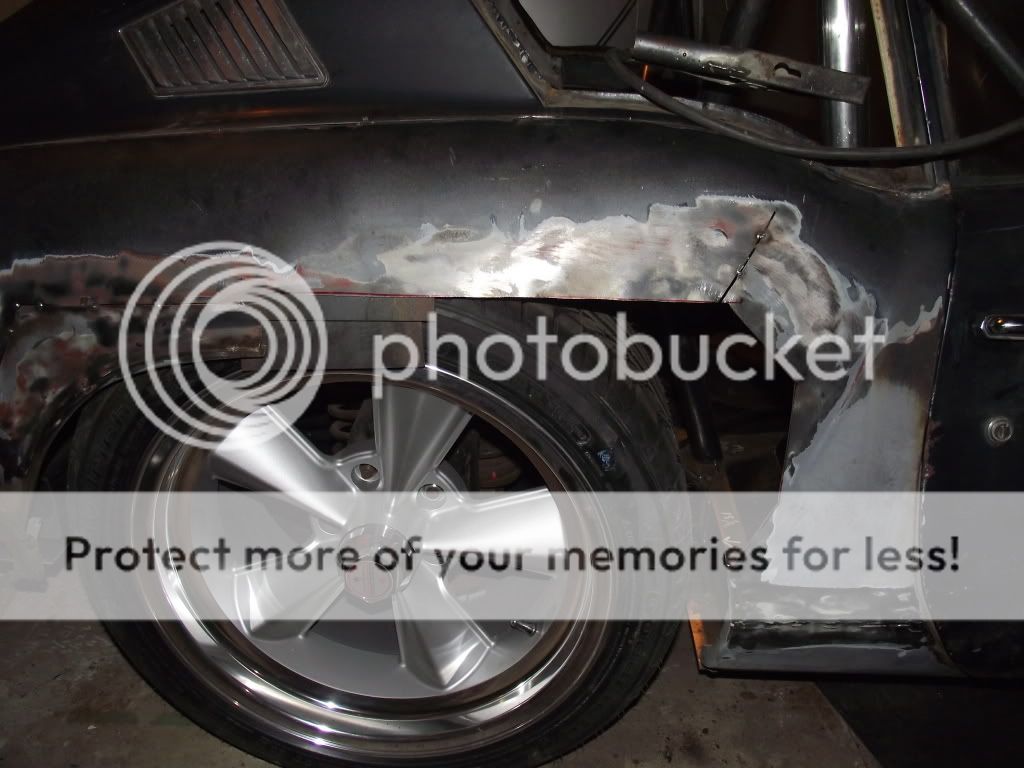

so,i figured since i went and made the patch panel,i might as well put it in.
here i've trimmed the offending material out of the picture(ha ha-get it,it's not in the picture[groan])
Gt-12
after some very careful trimming(i spent almost an hour fitting it)the panel is a perfect butt fit.then,a few tacks keep it in place.
Gt-12
i was really surprised at how getting the ugly metal out of the arch straightened out the rest of the fender.i was ready to do a bunch of beating on it to get it right,but just welding in the patch brought it all into line.
bonus!
now i've just got to do the lower rear section.i'll see how much energy i have after work tomorrow.

Yea i heard the video... nice. and yea back to good ol civilized (haha) korea with tolerable internet. nice patch panel too it's nice when a plan comes together

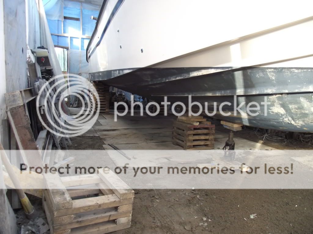

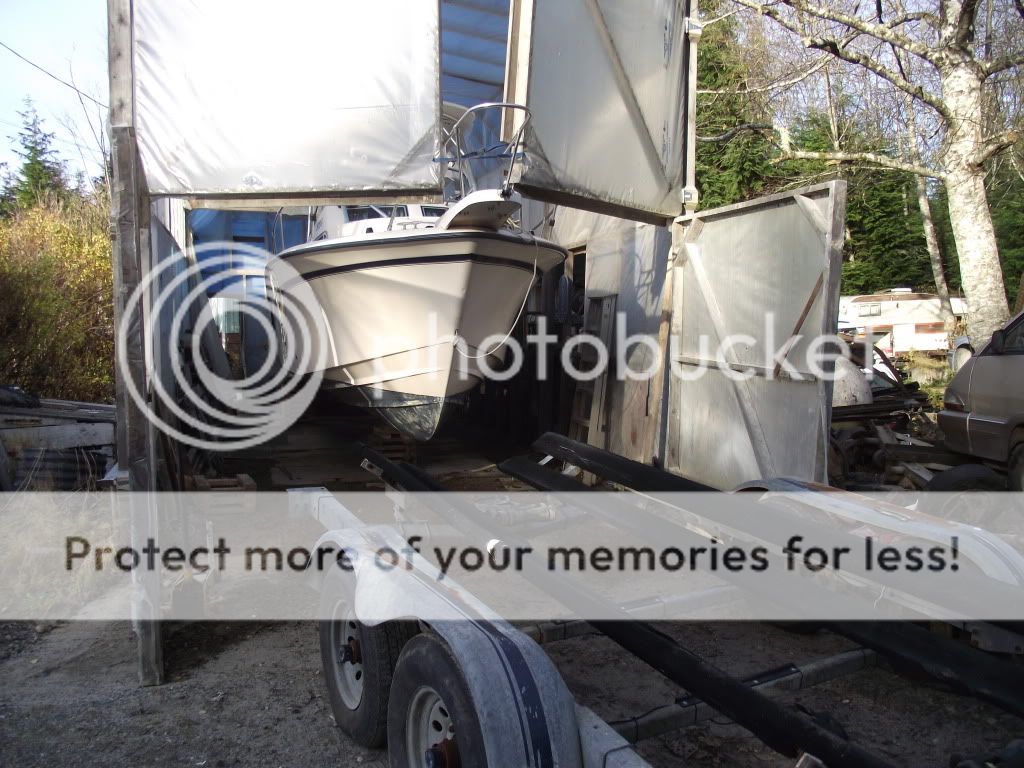

been doing something i hate today,i've got a boat here that among other things i have to redo the antifouling paint on the bottom.that means getting the boat off the trailer.
Gt-12
blocking the back is easy,but the front i block then pull the trailer a bit till the next crossmember or axle hits,reposition blocks and repeat about ten times till the trailer is out.this means spending hours crawling around under a boat trailer setting jacks and blocking,all the while worrying about the 20,000 pounds of boat you could be seconds from dropping on your head.

ya,carefull is the word of the day when doing that.this boat is 26',and is the third of three on this job.the other two were another 26 and a 29.i usually stick to 30' and under at home,bigger boats i rent out a shed with a boat hoist by the marina.
