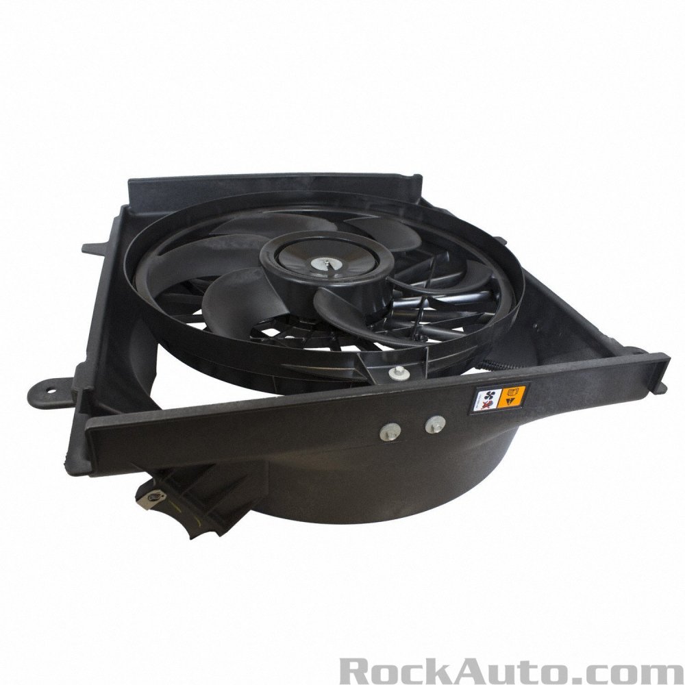

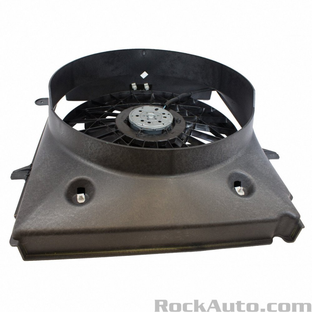

the oem fans from later focus/kia or whatever small cars will blow away anything you can get from the parts store in aftermarket in terms of reliability.....lasting 2 or 300k is normal. just depends on how you choose to configure.
configuring the run operation is key. pairing a 80 dollar controller with a pair of 5 dollar junkyard fans is a worthy investment.....you install one...and keep one for the day the other dies....and build in a manual setup and your good.

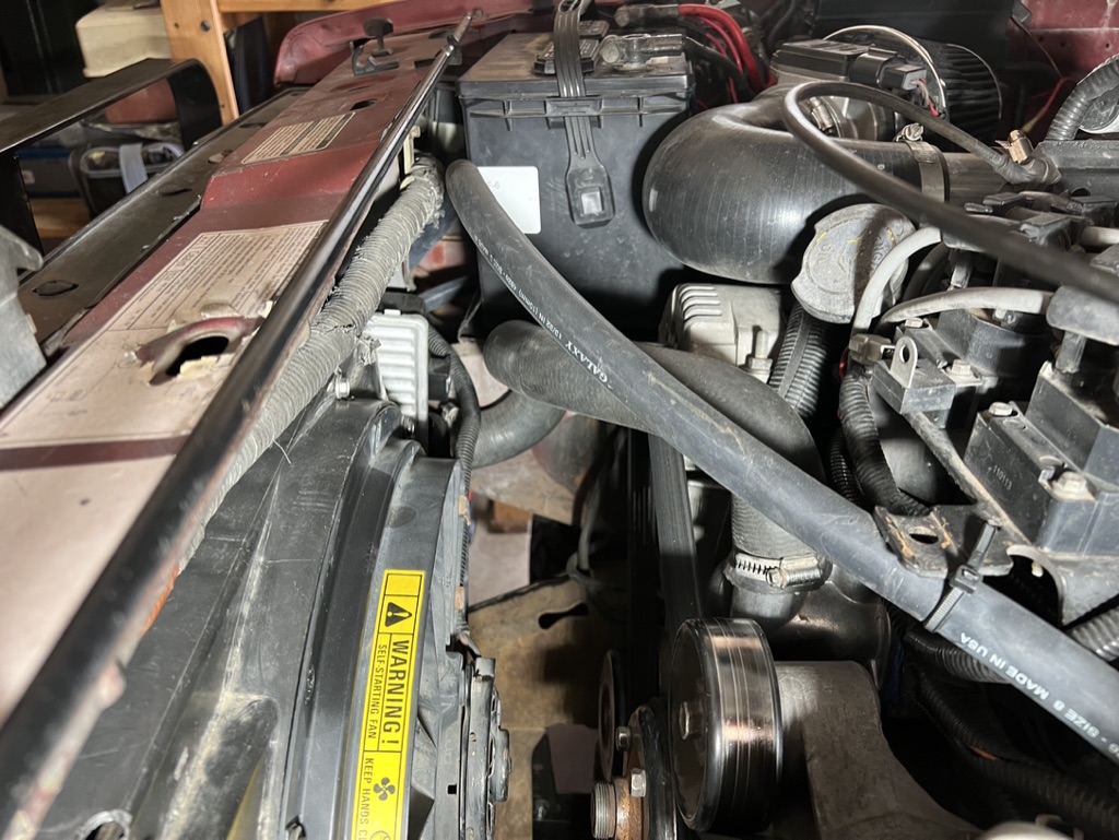

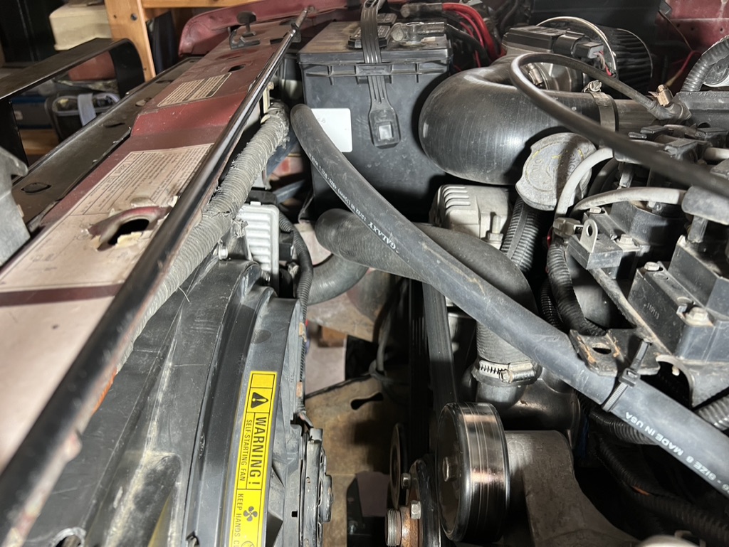

i looked at this one. my ranger is a v8 diesel...its IDI so it can make prodigious amounts of heat.
12 v guy has cool stuff for great prices as well...
these are popular....
i just run a sender in my coolant jacket with the lincoln relays and a manual bypass.....with lincoln intech fans.
they are massive...and work great. but my radiator needs to be replaced....its from 95 and beat to shit.
with selecting a few parts from what is posted here and a trip to the junkyard.......for 40 to 60 bux you can build a ridiculously efficient cooling system.
Yeah, OE fans are much higher quality than anything aftermarket.
