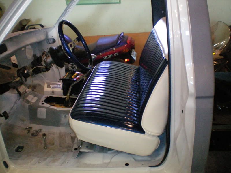

I put a Gen 1 bench in my Gen 2 that originally had buckets. The front required adapters to be made as the angle was wrong, and the rear needed new holes as well. In short, nothing lines up.

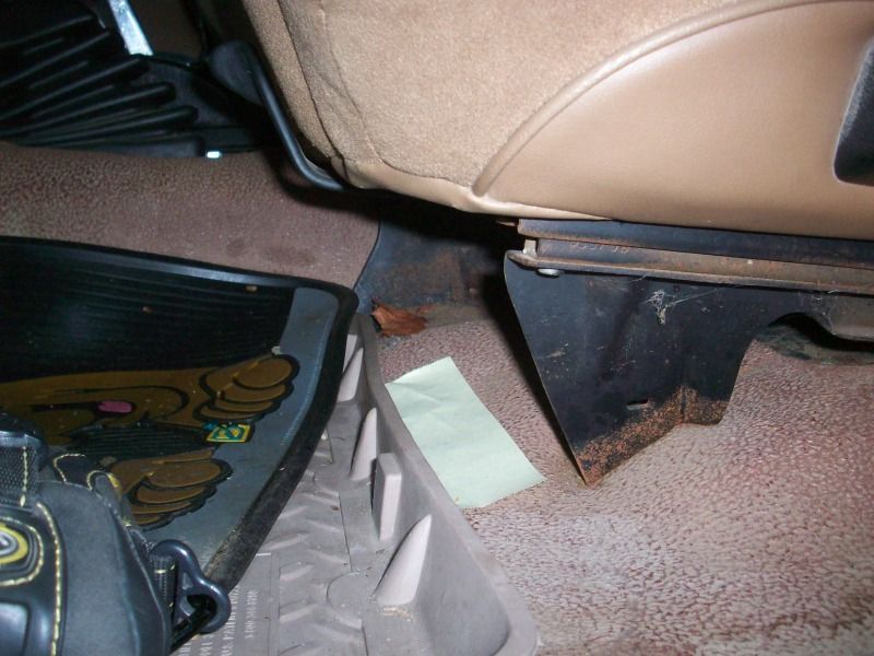

This pic shows the added crossmember stuck on top of the Gen 2 floor:
Gen. 1 seat track bolt to 2 gen floor?
Early trucks did not have this, but I don't know how early they changed.
Maybe the change happened midway through Gen I?
Neither my truck or the second gen I pulled the seats out of had that...
