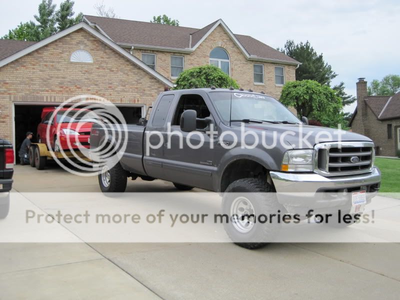

My diesel keeps having issues.
3 Weeks ago i had to get new tires and you all know how much those are. It got new wheel bearings 2 weeks ago at $350 a unit/side. Expensive but easy to install. I also ordered a $1800 Southbend Dual Disk 650hp Clutch for it yesterday since my last one fused itself to the flywheel. It keeps taking away from the Ranger funds. grrrr
Plus I was chasing an oil leak for 2 weeks. But its all good now. As soon as i got engaged the Powerstroke started showing that its jealous :icon_rofl:

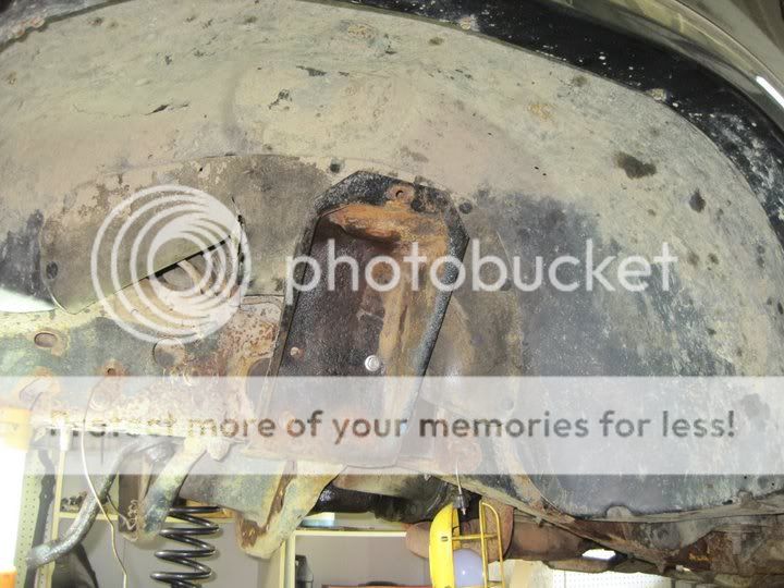

PS. My carpet has been wet for months and is been stored inside. So i pulled the carpet expecting very crusty floor boards. Thats very likely around here. However, I found out that its quite clean. Some surface rust on the drivers side but nothing that cant be fixed. Probably going to Rhino line it or something along those lines.

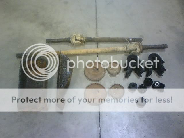

I also got coil towers, axle shafts, New Bushings for the track bar, arms and C-brackets. I also have a D44 5.13 gear set. Most of these parts came from TRS users.

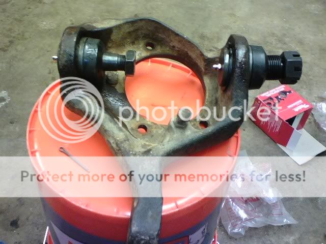

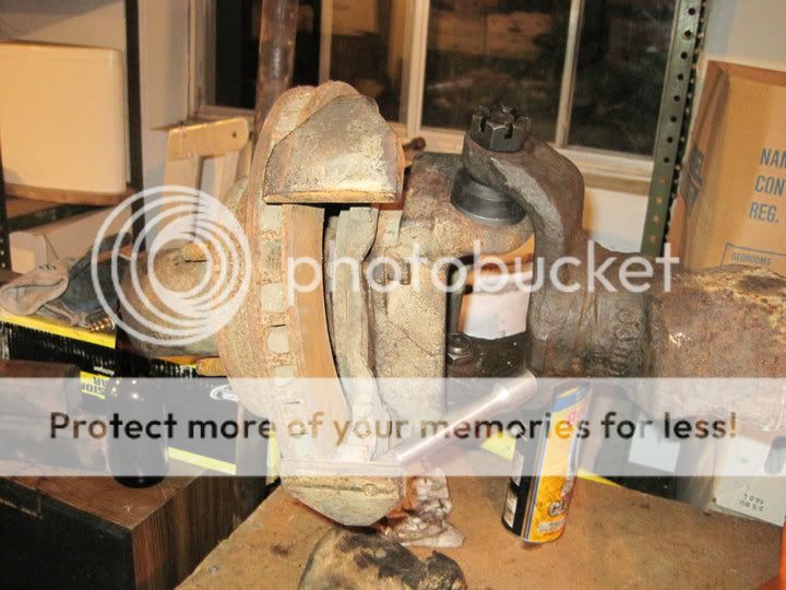

I also pressed in new ball joints to the knuckles. My D44 is starting to looking like one..

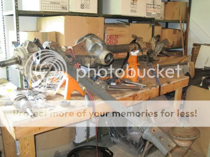

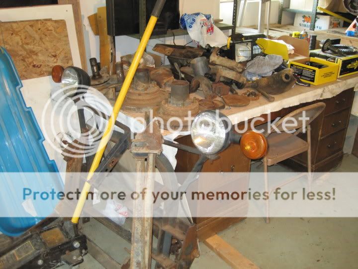

Here is my bench of D44 parts. Still need a carrier of some sort. Preferable a locking one...
Full Width SAS on '90 Danger the 4th

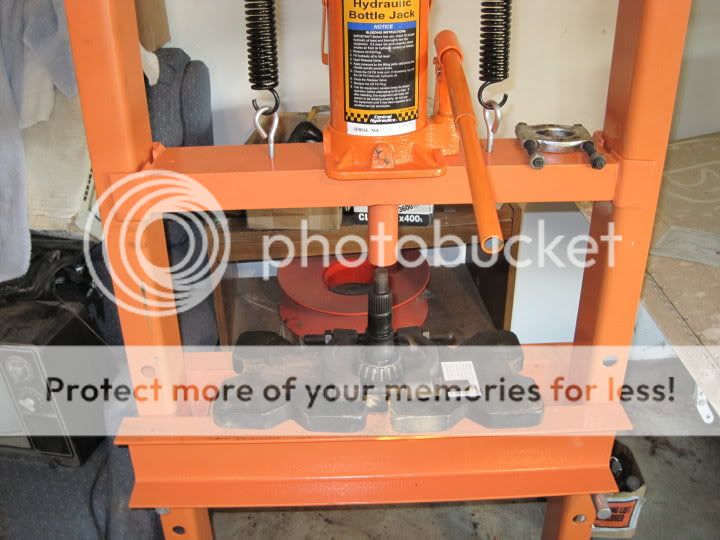

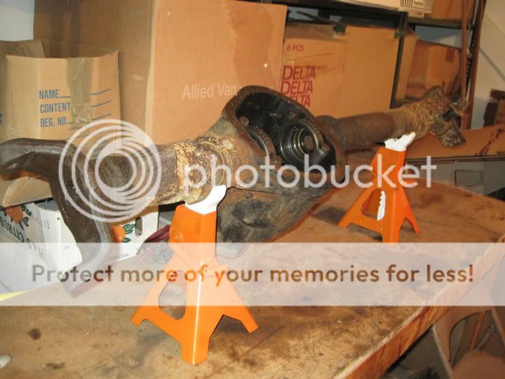

Then i started putting my Full width 8.8 together. I finally bought a press making work on all my vehicles MUCH easier.

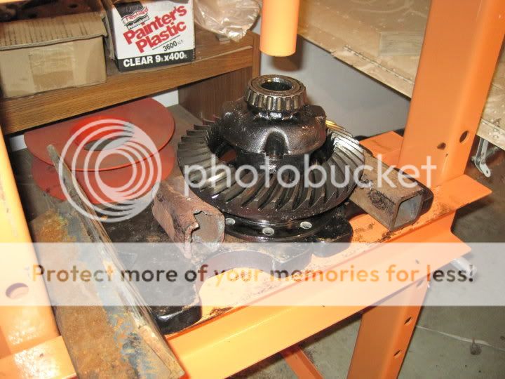

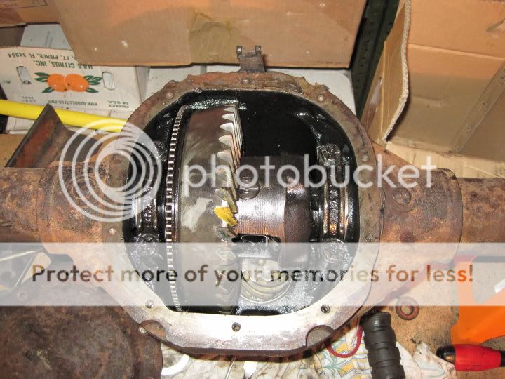

Pulling the 3.55 Ring Off

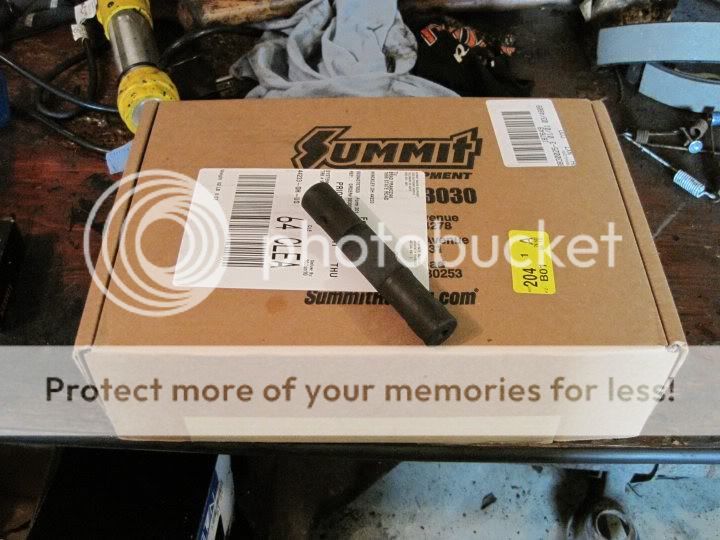

I bought a notched cross pin off of ebay and after 2 weeks it never showed up. The guy said he lost it and over nighted me a pin from Summit Racing. He should have asked first because i live 15 minutes from summit racing. But oh well. So this little pin came in this way to big box haha.

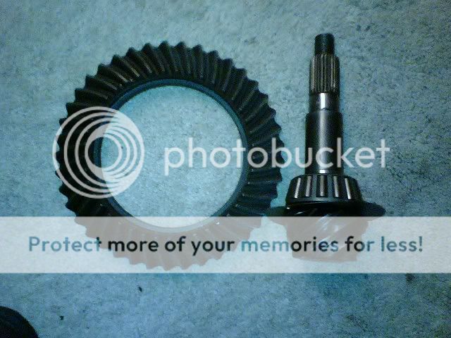

5.13s All set

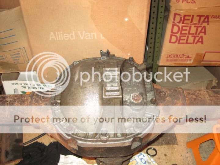

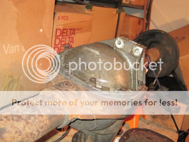

Got a IRS T-Bird rear diff cover for $5

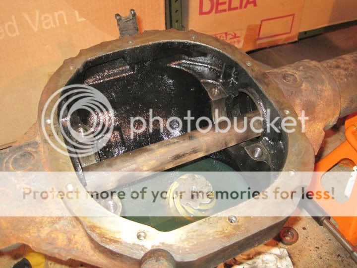

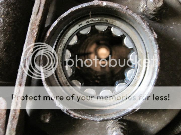

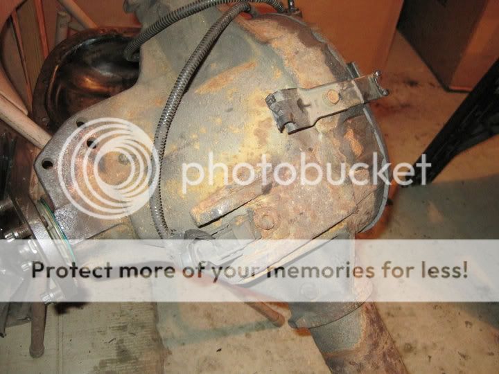

I got the rear end all set and realized my outer seals had a slow leak. So i figued i might as well replace them now. Everything back out....
New Bearings and seals

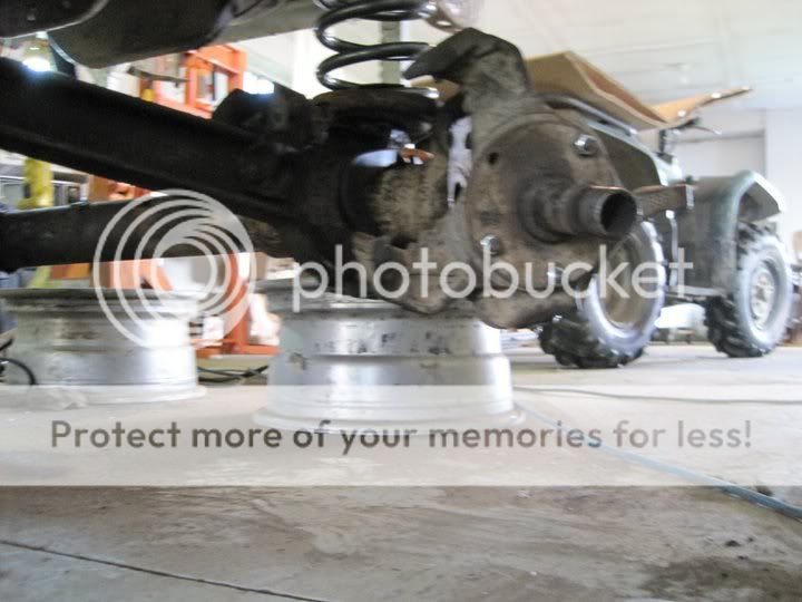

Seeing how all my parts are going to fit together. I am going to mount the spindles first so i can mount 35" tires to the axle. Then i am going to do all my front suspension fabrication. Then i am going to set the 5.13s in my D44.

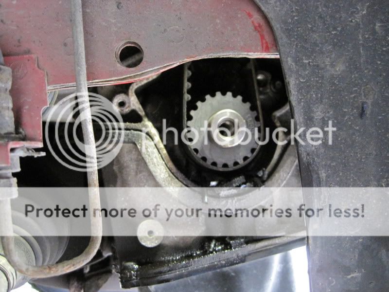

Only bad thing so far is that it snapped a timing belt about 2 months after i got it

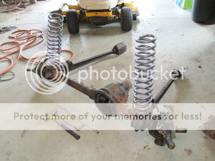

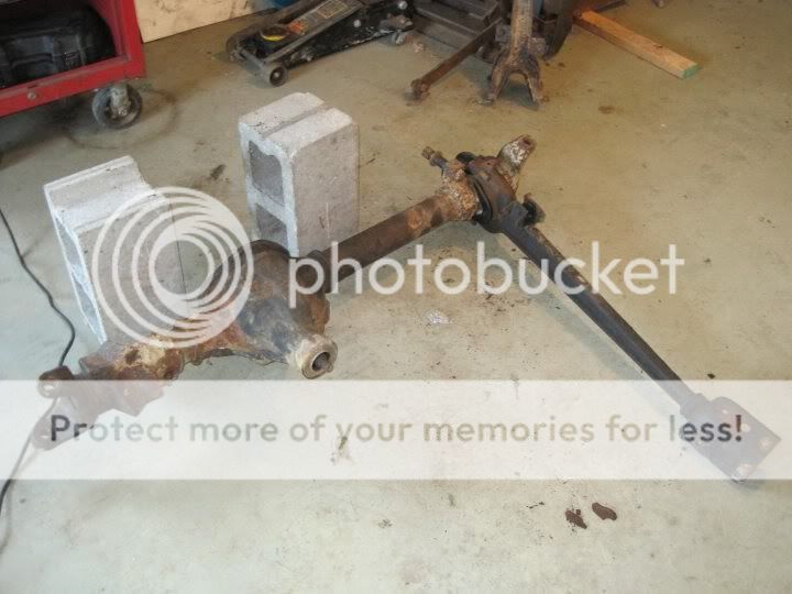

Started putting the outers together on the D44 just so i can fit up the suspension. The axle it self is empty so i can move it around easier. EB arms attached.

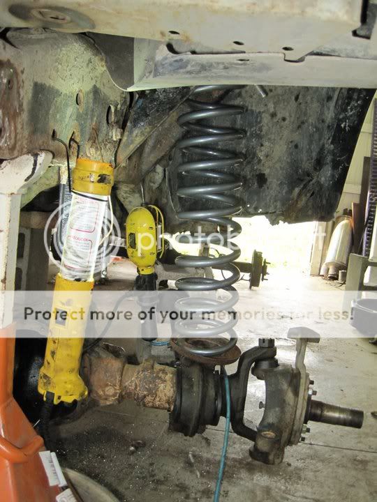

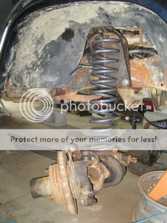

Scrap coil retainers installed with EB 3.5" Flexy Springs

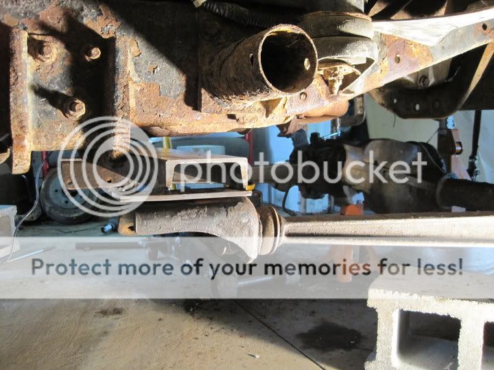

Floating Axle

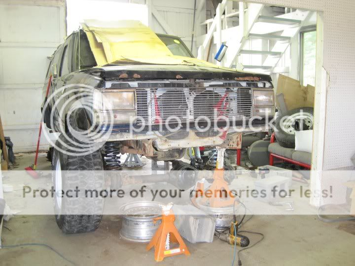

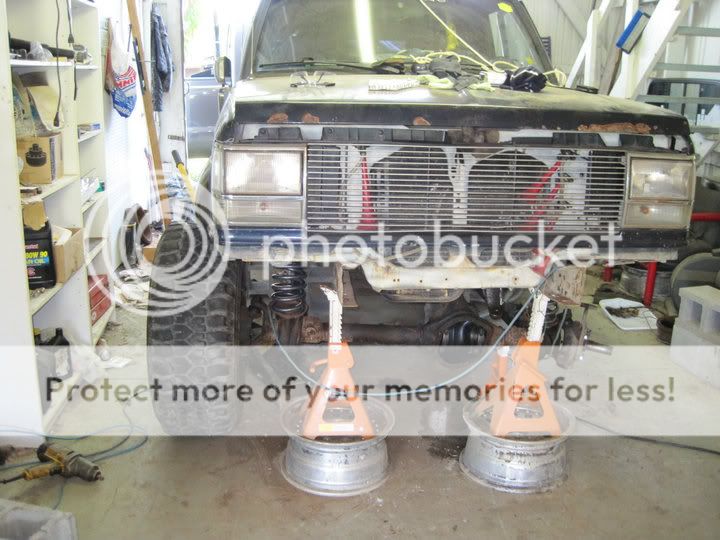

A shot with 35s. Note, Axle not centered under truck. More towards drivers side on this pic.

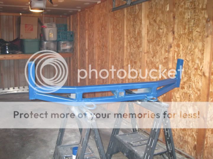

Well i painted my bumper the other day at my apartment. The can showed a darker blue and it came out like this. Oh well. The Fiance wants to paint the hood pink and call it Bubble Yum

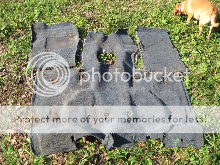

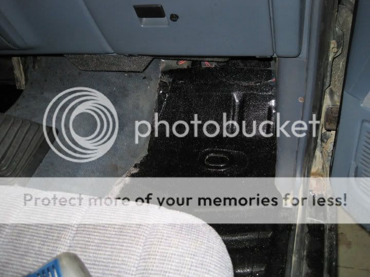

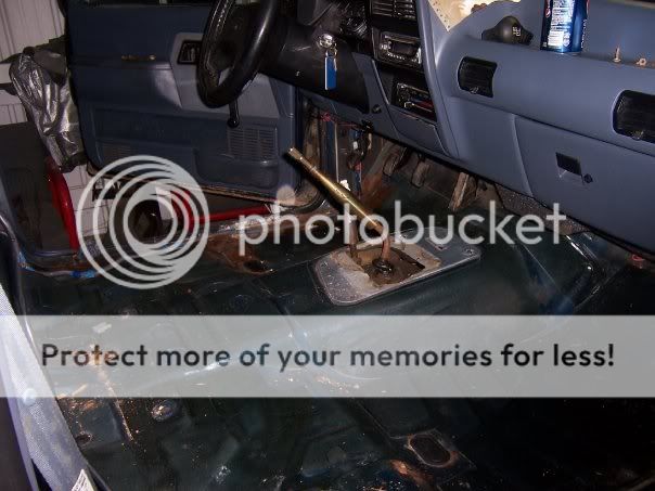

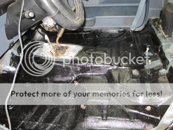

Hurculied the cab floor to make it more water/trail/snow/sleet proof. Turned out better than i thought for just slapping it on there.
I decided to keep most of the carpet for insulation in the winter. So i cut out the driver and passenger floor boards because those sections take a beating. I might end up taking out the center hump section too. We will see how the winter salt migrates.

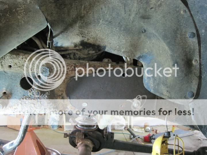

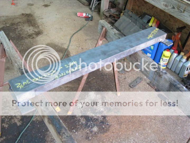

Started to make the arm crossmember. Decided to move my D44 up 2" so now my arms end in front of the trans crossmember.
I need to weld on my coil towers and stuff b4 i can mount the arm crossmember so can set the correct caster.
Axle moved forward and centered. Need to mount the coil buckets now.
