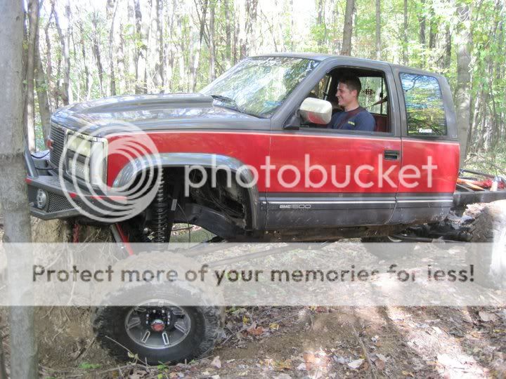

Loaded up my Best Man's 91 4 Linked D60 GMC for its first test run

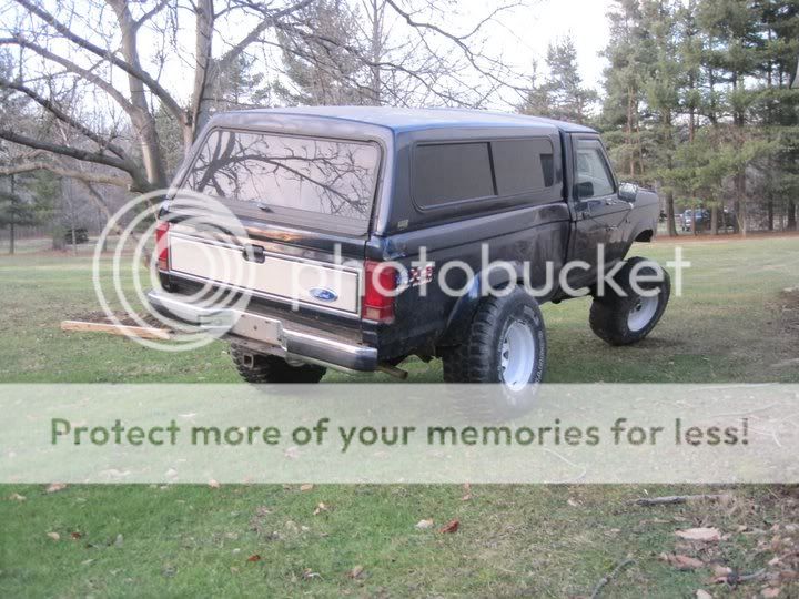

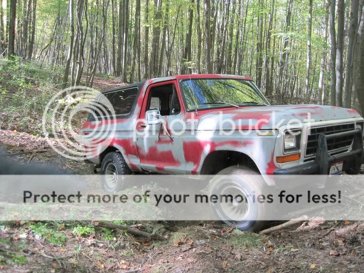

Also brought some other wheelin rigs like this 79 B-Ronc
Full Width SAS on '90 Danger the 4th
Not your normal B-Ronc... This one gets 29 MPGs

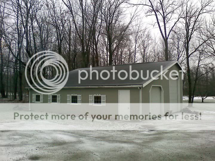

Then it was time to move into the house
2 outbuildings and 6 acres

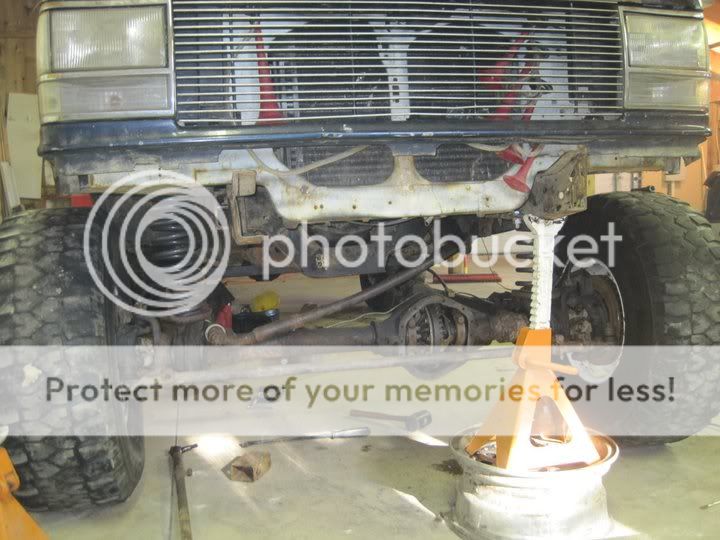

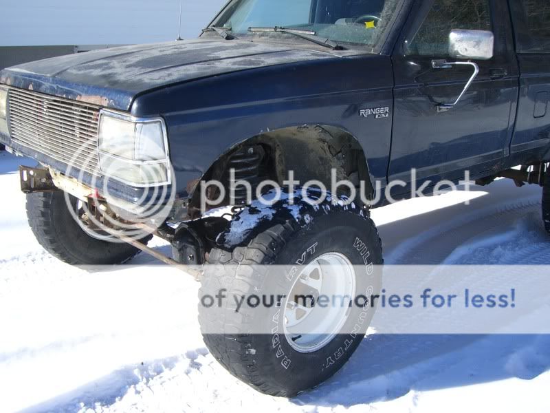

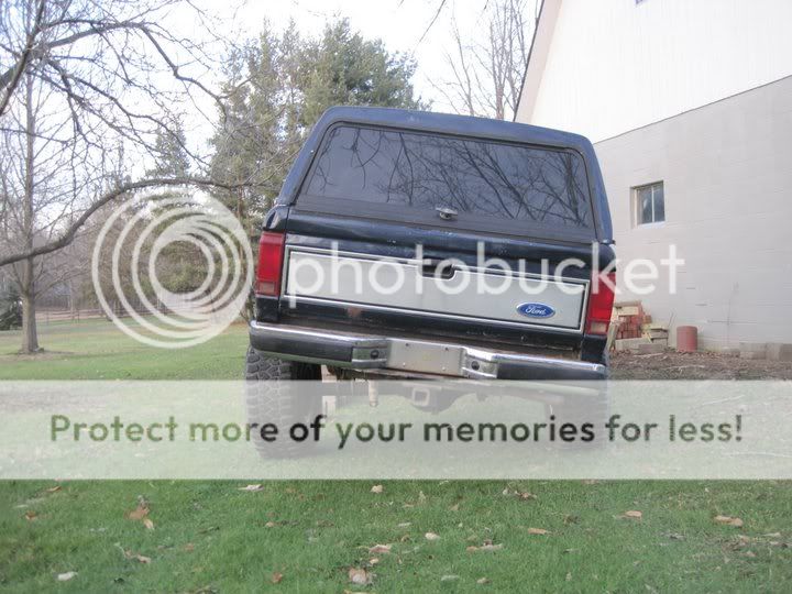

Well I finally got a diff to work, it’s an open diff but it will work for the time being. I will just get a lunch box locker in the future. So once I got that all set, new pinion seal, new spindles and hub assemblies, it was time to test the 4WD. My stock front drive shaft, which was shortened to work with my D35 TTB swap works great with my D44. The U joints are all the same size. So that was pretty nice.

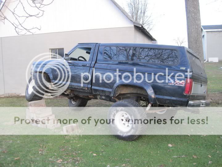

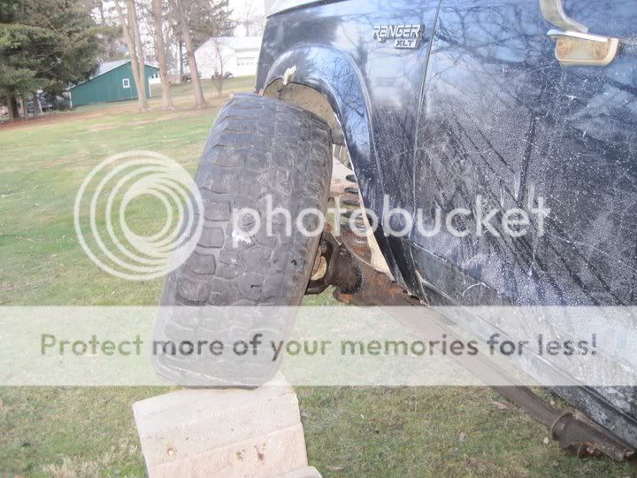

Pics: Bald 35s with 3.5” EB front springs

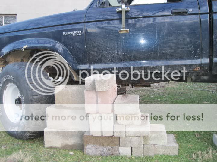

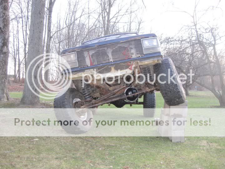

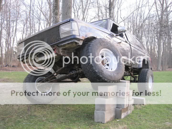

Going to try 4 Cinder blocks when I get my brakes bled

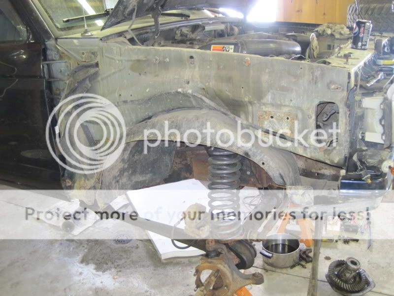

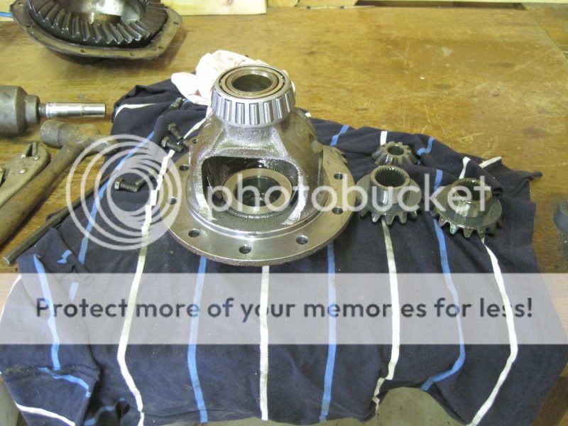

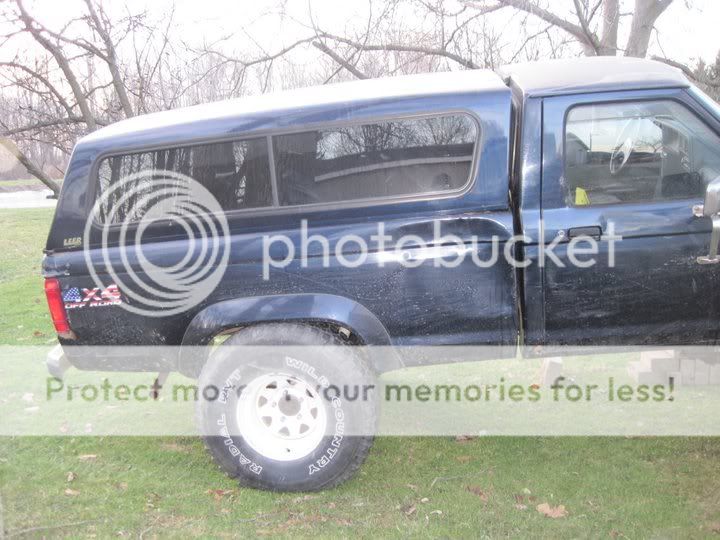

Well, i burned up my outter pinion bearing driving around the yard. I guess i never went fast enough to get oil up there or i set the preload wrong. Who knows. Anyways, the D44 is currently appart. The pinion has been re-installed and i figure since its all apart, i should just get a locker to put in. So when i get my tax return this friday, a locker will be on order. Probably just a lunch box locker. Trying to keep this build cheap. Cheaper than a new ATV at least.

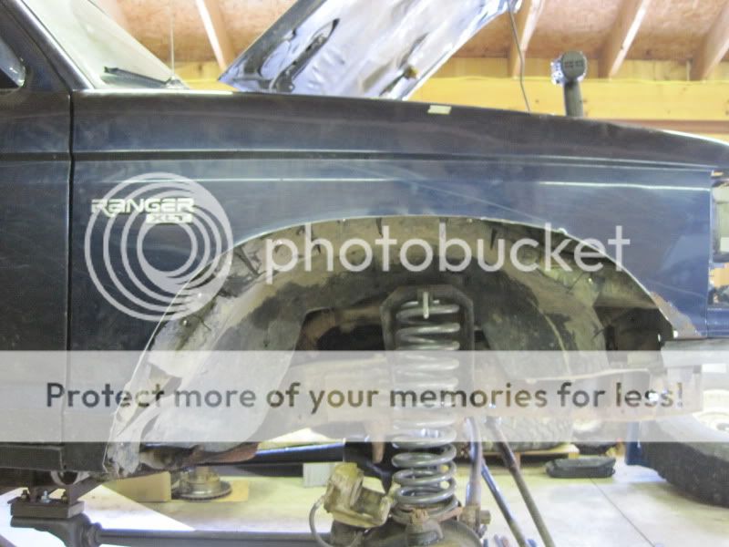

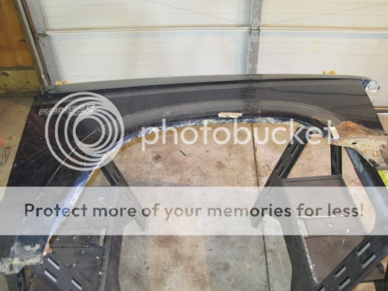

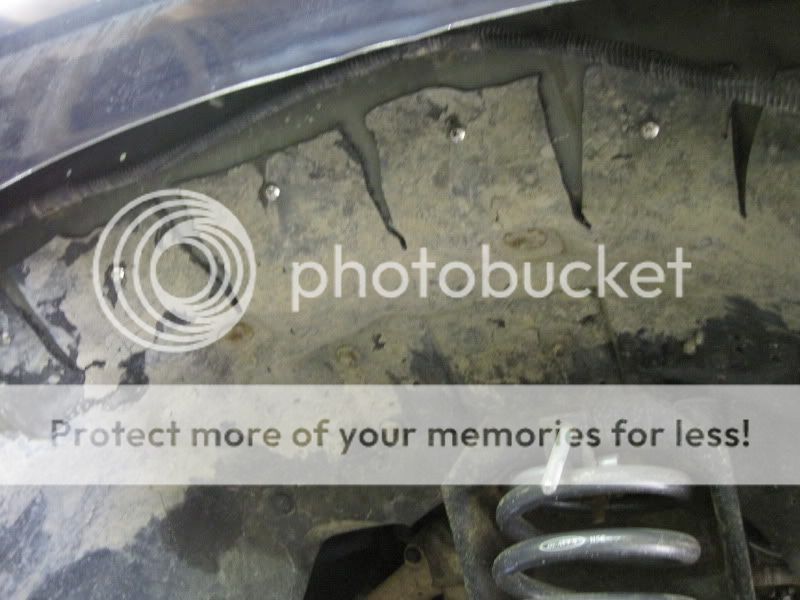

So since i am waiting for parts to finish the front, i decided to start cutting fenders haha. I am not good at body work. I do not have a good steady hand. Trucks are trucks, i dont need it to be perfect. So i just cut only the factory flare line and it ended up coming out quite well.
Pulled the fender off and set it on some horses

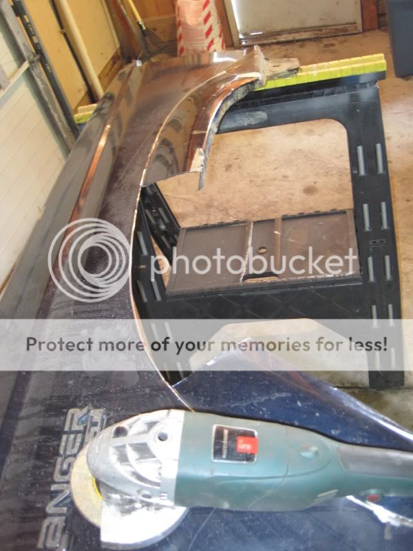

I just ended up using my 5" grinder with a cut out wheel. I made a few passes with out going through. Once i was almost through, i just bent it back and forth until it broke off.
Then i followed the Fender Cutting 101 Sticky on here and followed through with the inner fender.
I used the Dremel Trio i got from santa to cut the inner fender up.

Not Bad for me

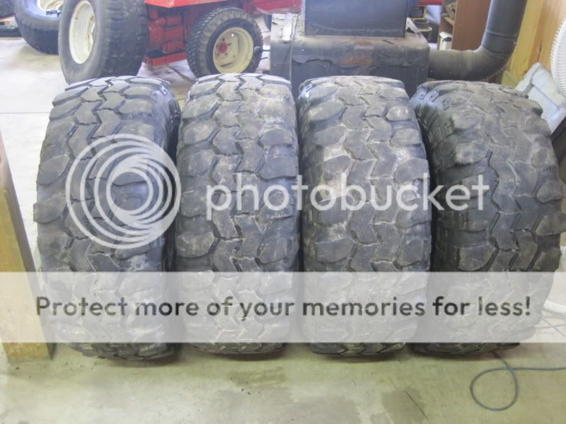

I recently found 4 36x14.50 TSL Radials on CL for $250. 2 are about 70% (measured with calipers), one is an excellent spare and the 4th is not too good. They look better in person. The plan was to buy 2 new ones to match the 2 good ones. Turns out, Interco is not doing so hot and are not producing this tire right now. The ones that i have found are $400 bucks each. So I found out the 36x14.50s are actually 35.6" tall. Most aggressive Interco tires in the 35x12.50 size are about 35.4" tall. So i ordered 2 new 35x12.50 LTBs to use on the front of my truck. It should work out since my rear track is slightly narrower than the front.
