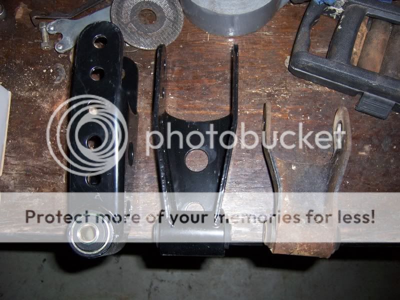

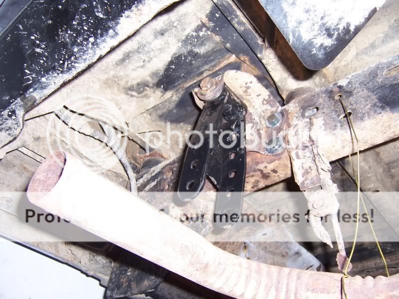

GM Lowering Shackles
I should buy new hangers but i didnt. I will just wait til they break. However, i grinded the rivots and punched them out to get the rear hangers off to install my new GM lowering shackles. I found them in the Summit Racing clearence section for cheap :headbang: It took some pounding to get them in the brackets but they went in there. Anyhow, they are installed with my new "old" springs that are softer than what i had.

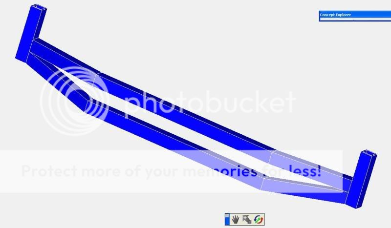

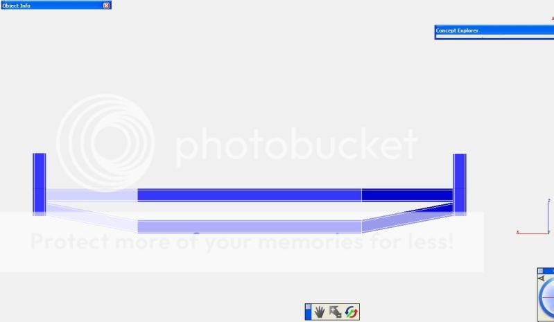

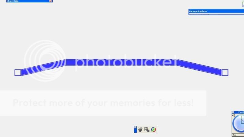

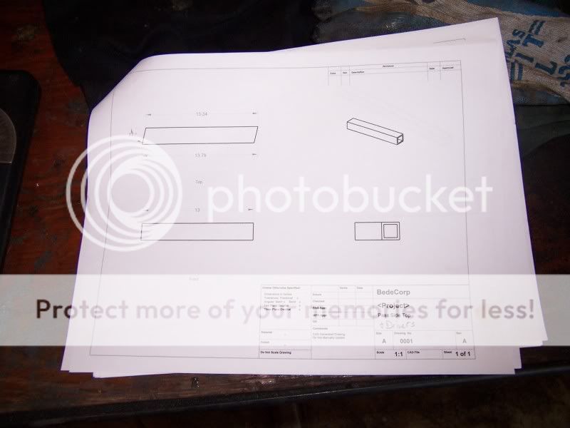

Well, my spring perches and shock mounts didnt come in. and i was at my buddies which is where i have welding access. So i looked around in my barn and found a few feet of 2 x 2 x 0.25" tubing. So i was like, i will go make a bumper. So i went to the office real quick and drew up a simple bumper on 3D CAD and printed out drawings with dimensions to make the build easier.
I want somthing tough but not big and bulky. my 1/4" wall tubing is also heavy so i dont want to use too much of it to save in weight. I also dont want it stickin out the front too far but do want a winch someday. so i integrated a 2" receiver into it.
heres what i came up with:
and the frame connections are not shown in the drawings

Drawings...

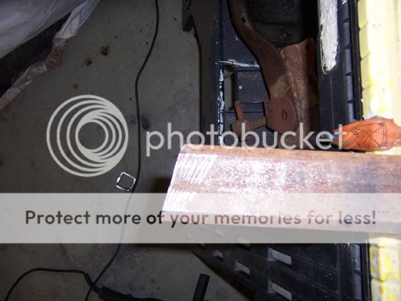

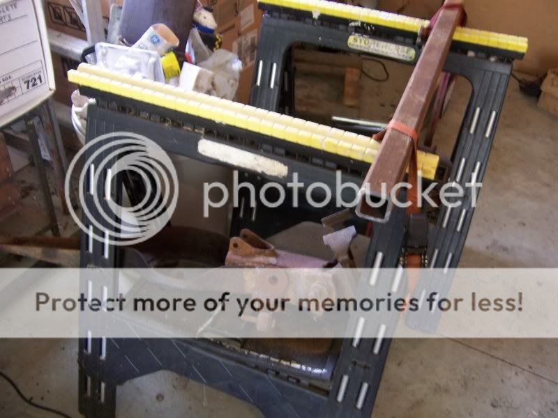

D28 being put to good use finally. Holding down my saw horse while i cut the tubes

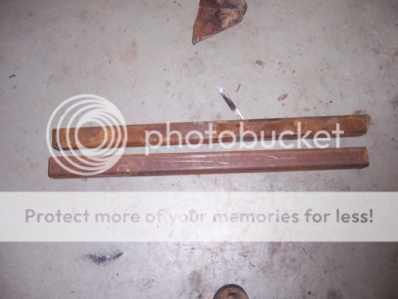

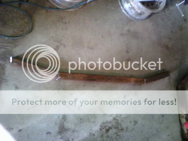

Main Straight Pieces
Full Width SAS on '90 Danger the 4th
One of the Top sections. Cut them all with a sawzaw

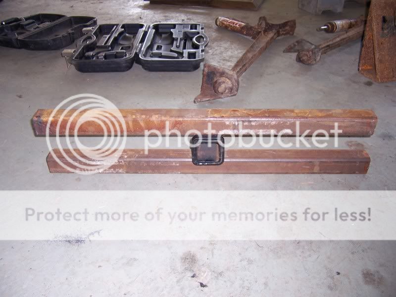

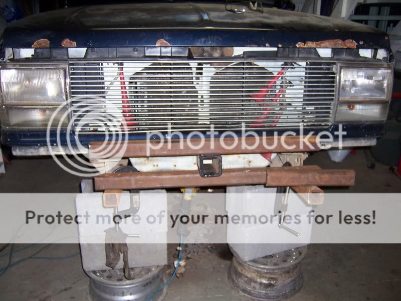

Kinda my plan for the 2" Receiver
Something like this. Cept 2" lower. Yes, i do have DIXIE Horns
