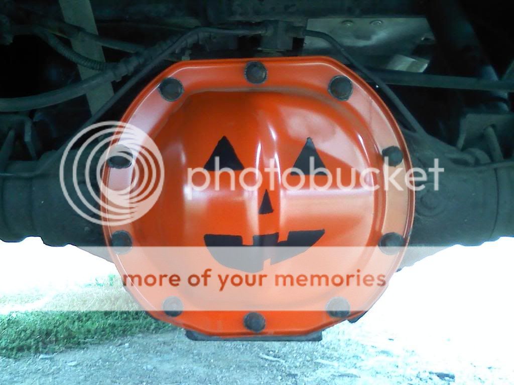

Can I copy or steal your idea on the Rear end Cover, I think that is so cool looking.
Robert
sure robert, you can borrow the cover design. i was actually inspired to make it after seeing plumcrazy's (i think?) pumpkin face cover, so it was kind of original but not entirely.

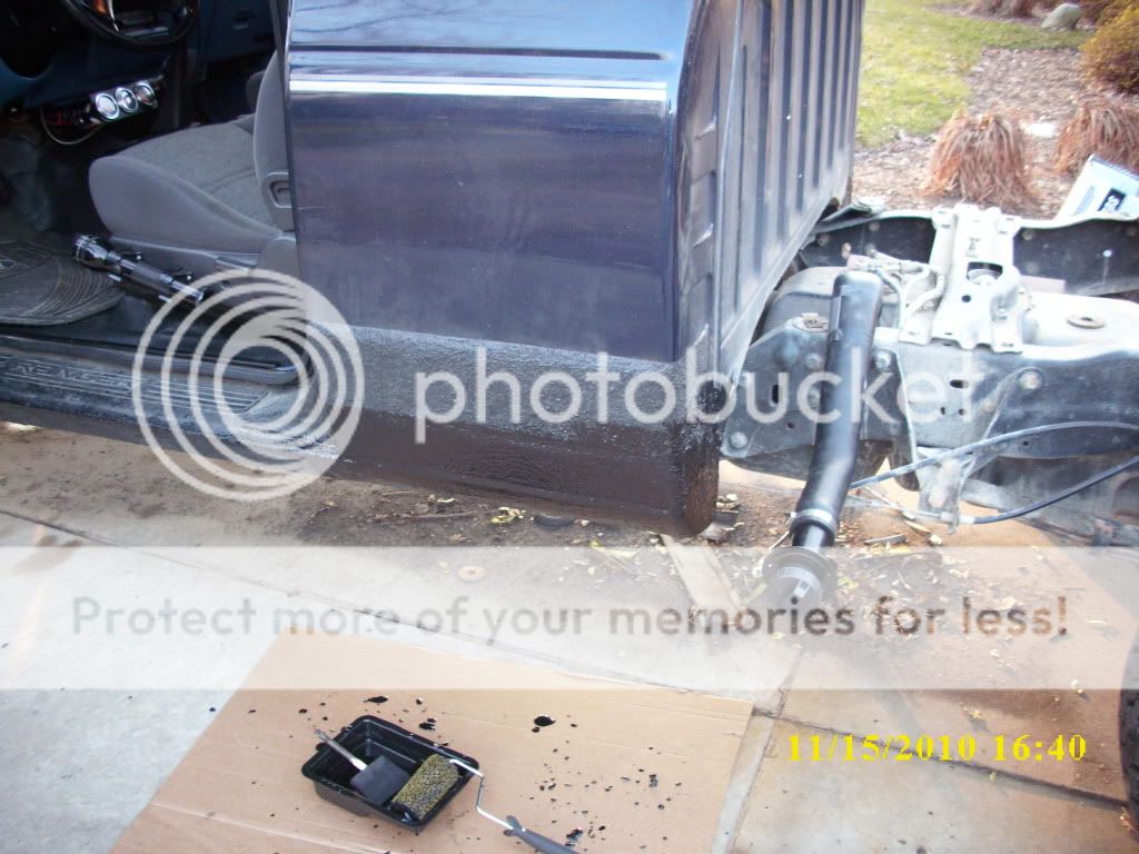

Passenger side is all ground down and the paint is on, i just hope it dries being that its only 38* outside. Now its time to relax and assemble a plan of attack for tomorrow.

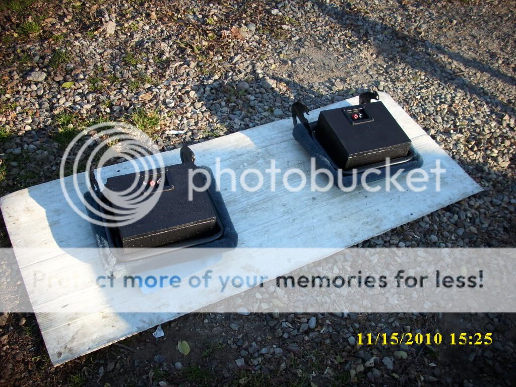

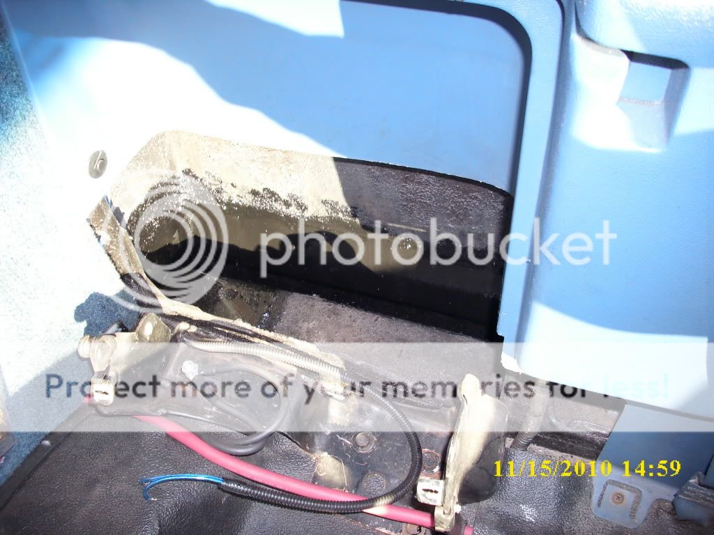

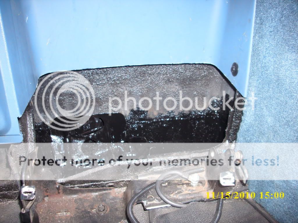

its starting to feel like im in a race against the weather, but at least the finish line is within sight. today i got 2 more coats of por15 put on the panels, i sprayed rubberized undercoating underneath the panels (back sides of the inner rocker panels) and also inside the jump seat compartments. while waiting for that stuff to dry i installed a new fuel filler neck since mine was begining to show its age, and then decided to spray some duplicolor bedliner onto the back of the sub enclosures to give them a textured and finished look. just before dark (5pm WTF?) i was able to get the 1st coating of herculiner on the panels and then hopefully tomorrow i can wrap this up.

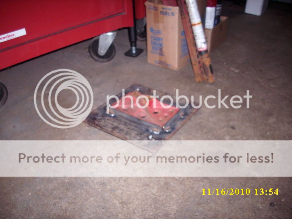

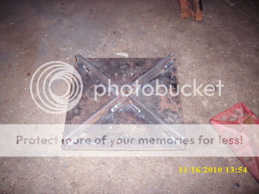

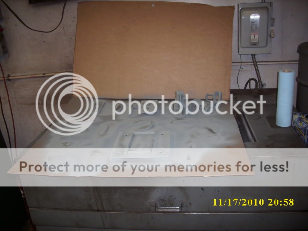

the truck is all back together now and the hi-lift project is about 1/2 complete. i made this base for the jack to bolt to when im in soft terrain or i need to change a tire and dont want to risk the truck tipping over while the wheel is off. ill have pictures up soon of the freshly painted hi-lift and base.
Robert
Do you have a pic of Plum's pumpkin cover?

I looked for the pumpkin face cover, but i couldnt find the build thread on it. i believe it was on plums purple ranger, the one he had before the badass blue one. it was basically a cover painted orange with 3 black triangles for the eyes and nose and then a black mouth with square teeth, just like the classic jack o lantern look. on a side note, does anyone know where there is a good article on setting up the moog adjustable camber bushings? the shop i used to use just lost their alignment guy to the GM tech center, so that means i no longer have someone i trust to align my truck properly.

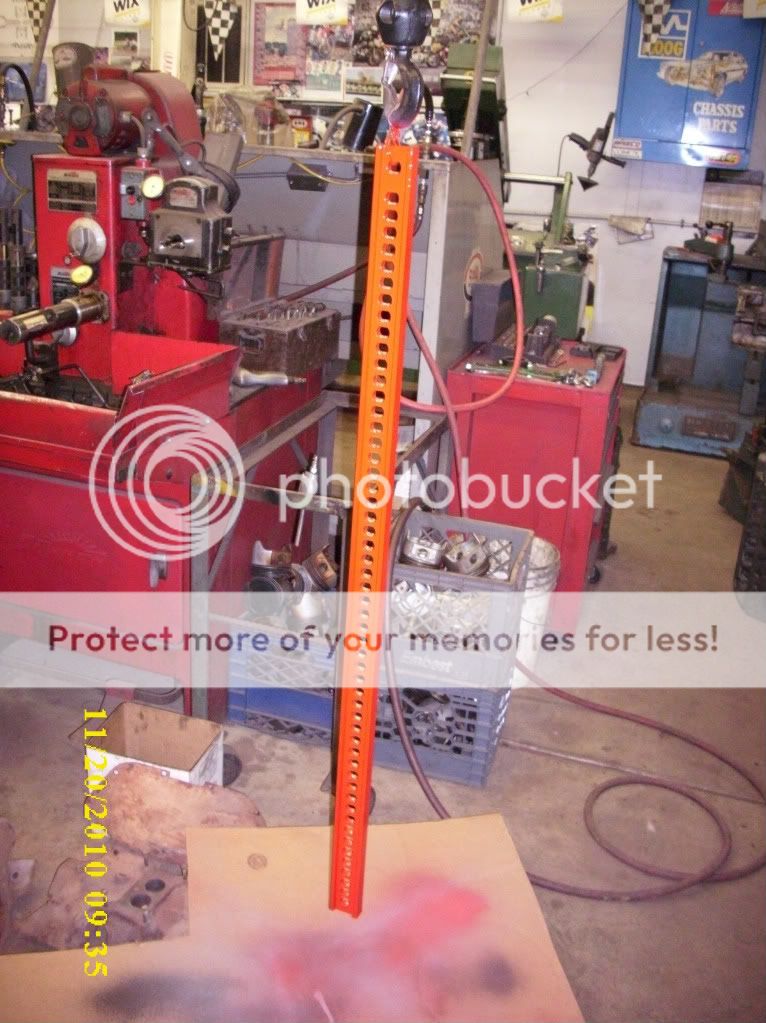

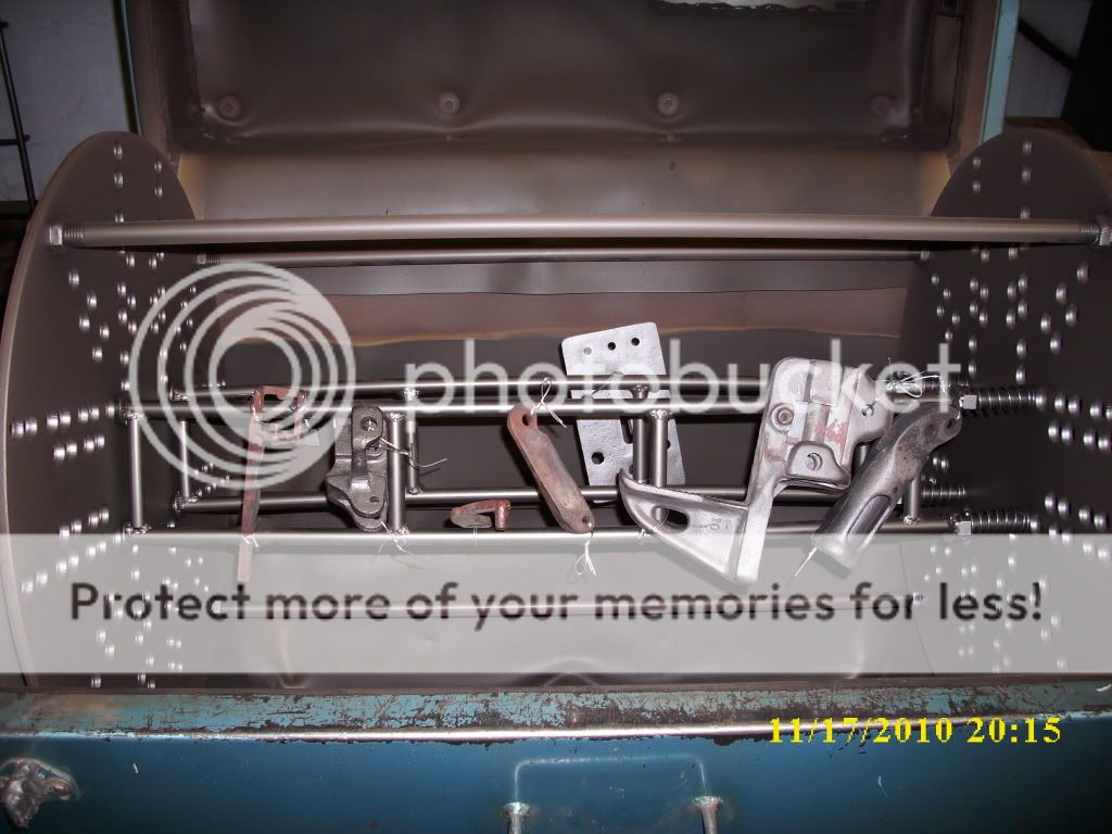

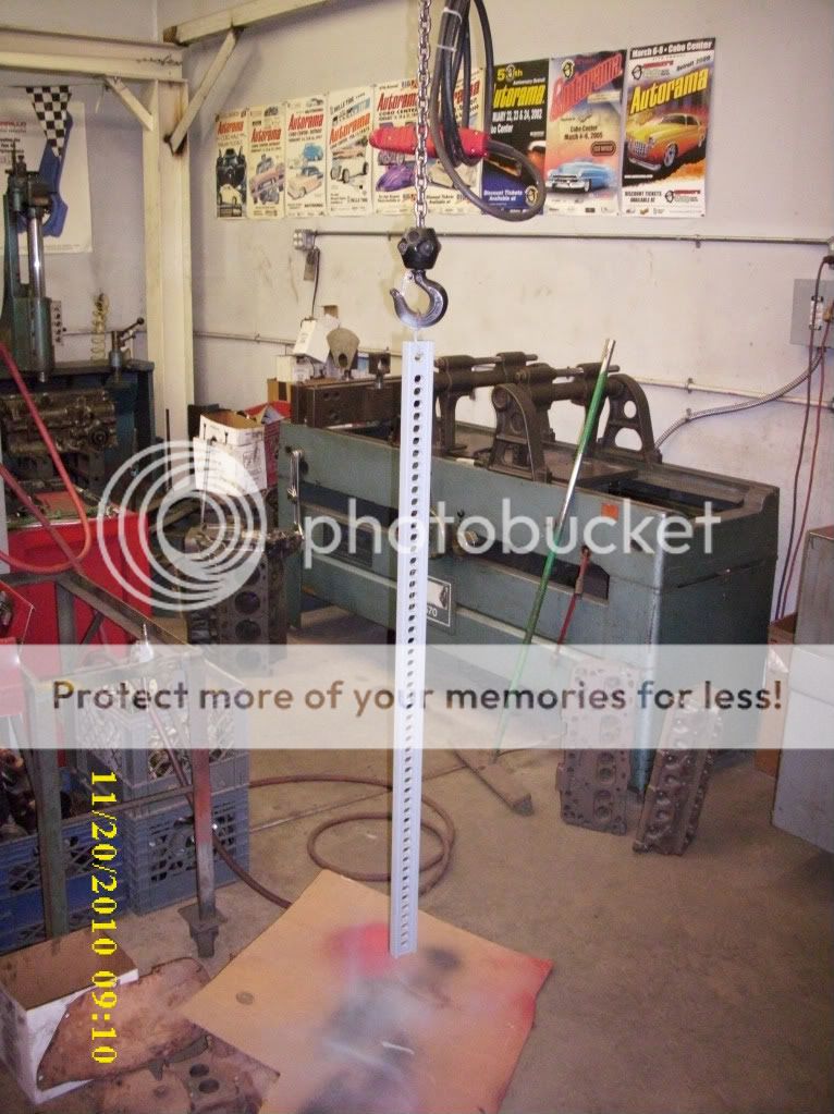

heres the pictures i said i would get up, the hi lift is all primed and ready for the multiple top coats ill be giving it. i still need to sand blast the main post with my pot blaster since it was too long to fit in the steel-a-brator machine. (Edit) i put it in the oven for 2 hours at 700 and when i cooled down i was able to use a scotch brite pad and wipe off the remaining paint dust so there was no sand blasting necessary.

I also emailed Plum and he got back to me with his old cover. Ha, it IS pretty funny.
