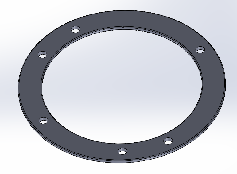

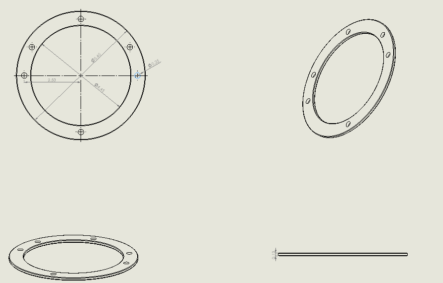

Hey guys, don't know if there's one of these floating around, but the 3-screw Ranger speakers are a pain in the ass to find if they blow. Ended up getting the old ones out of my truck to replace, dropped in some standard ones, and they buzz like crazy because they don't properly mount. Waiting for it to stop raining so I can work on my truck; got bored and threw the measurements in Solidworks and got this STL file.
If anyone is interested in 3D printing one of these, the file is linked below. The adapter is 0.125" thick and will work with both the 3-screw and 4-screw units, let me know if anyone actually ends up printing this and whether or not it works, any issues with a print, anything. Planning on getting a friend to print me some soon and can let yall know if it works as well.

Could you post up snapshots as well for those of us without immediate access to STL's?
