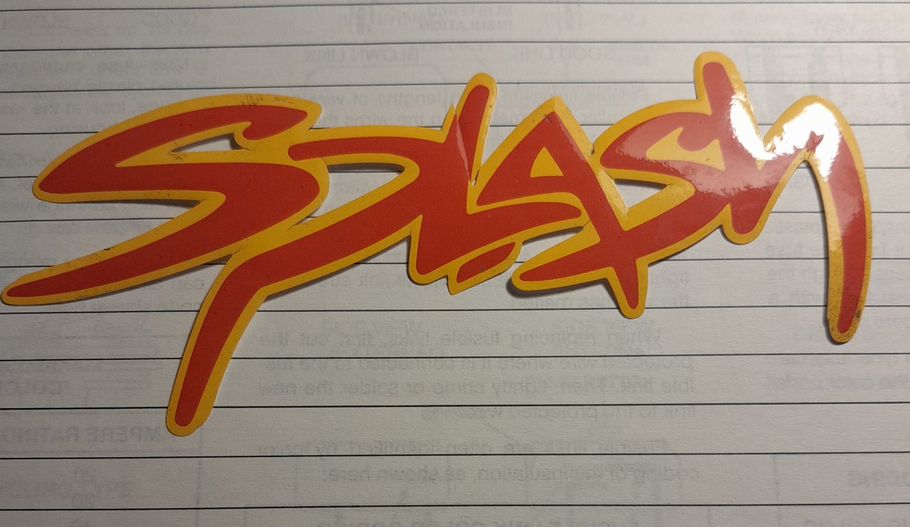

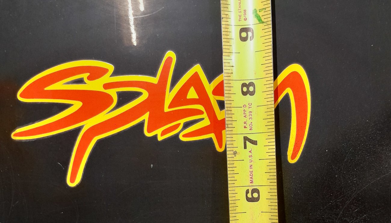

I've managed to safely remove the Ranger Splash tape decal from the old tailgate and want to re-apply it to the new tailgate.
Does anyone have any suggestions on the type of adhesive to use?

I bought a couple of white decals from eBay, but I'd really like to keep the original.

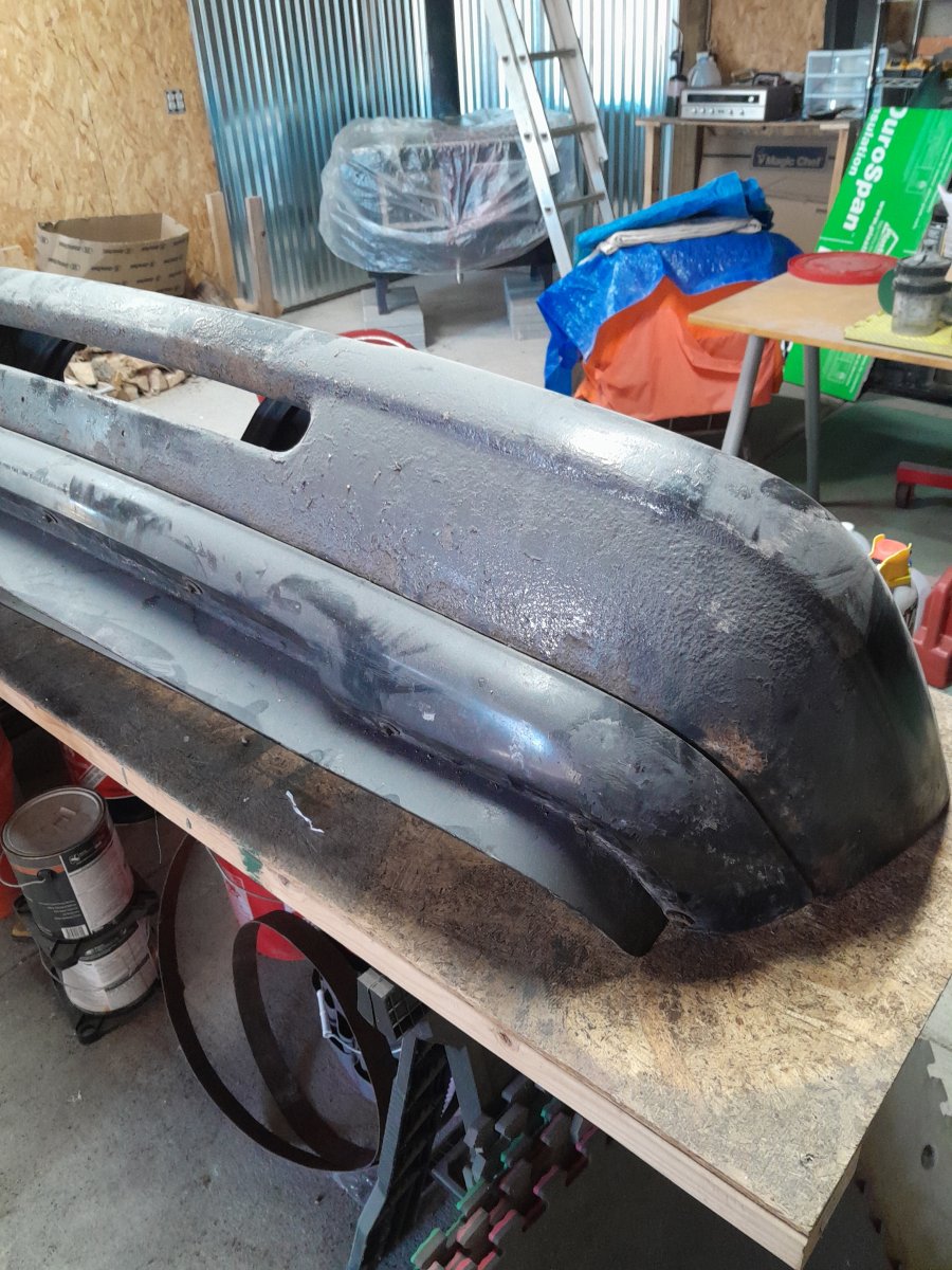

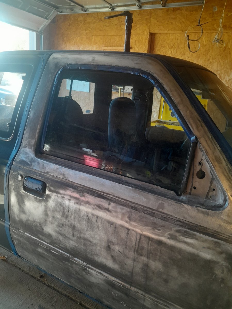

Doing some more work on other areas that I will finish in warmer weather. For now I am just stripping and prepping in the barn where I can stay warm and out of harm's way (read wife's todo list and being able to listen to Lions on the radio)>
The passenger door was a pull-a-part and was stripped to bare metal and rattle-canned a bunch so I wanted to start over again. And the bumpers were in need of help. the front especially. These are things I want to keep track of and not necessarily looking for comments - however, as always your experience is always welcomed. (y)

wow how did you get the old decal off so cleanley !? i have some panels that have a blue and white splash logo on it thats a bit rare and i really want to put it on my new truck !
Hey Red, thanks for the comment. I used 3M adhesive remover - many applications and wipes -and very meticulously used a single edge razor blade to slide under the liquid edges of the decal. Not kidding, it took a couple hours over a couple of days.

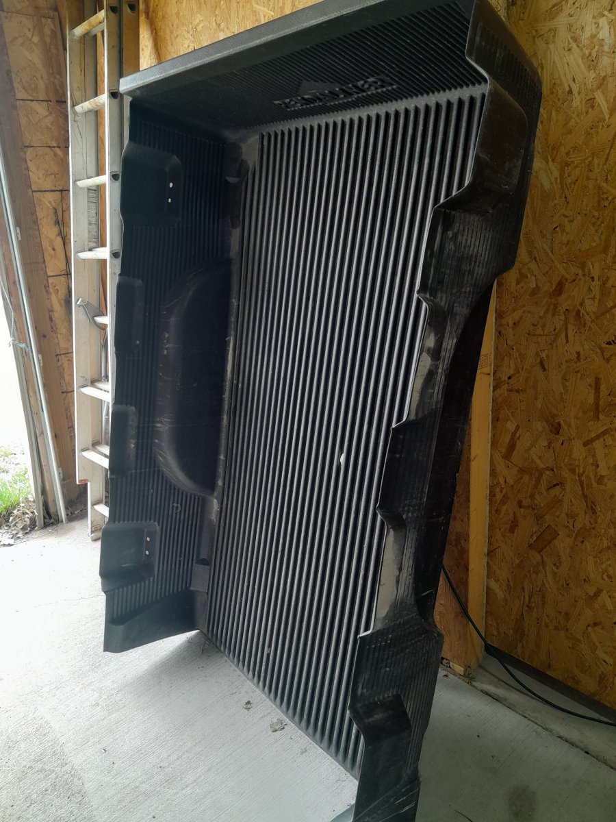

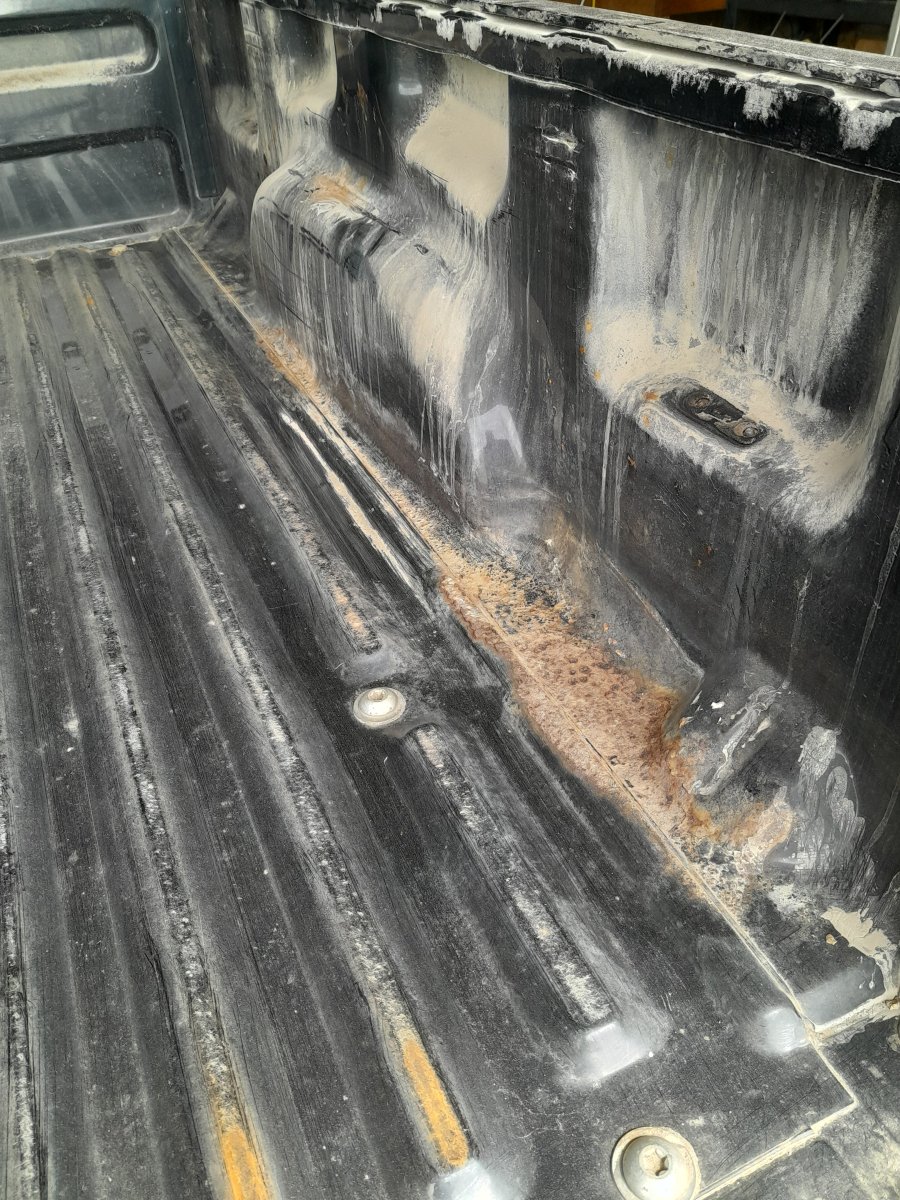

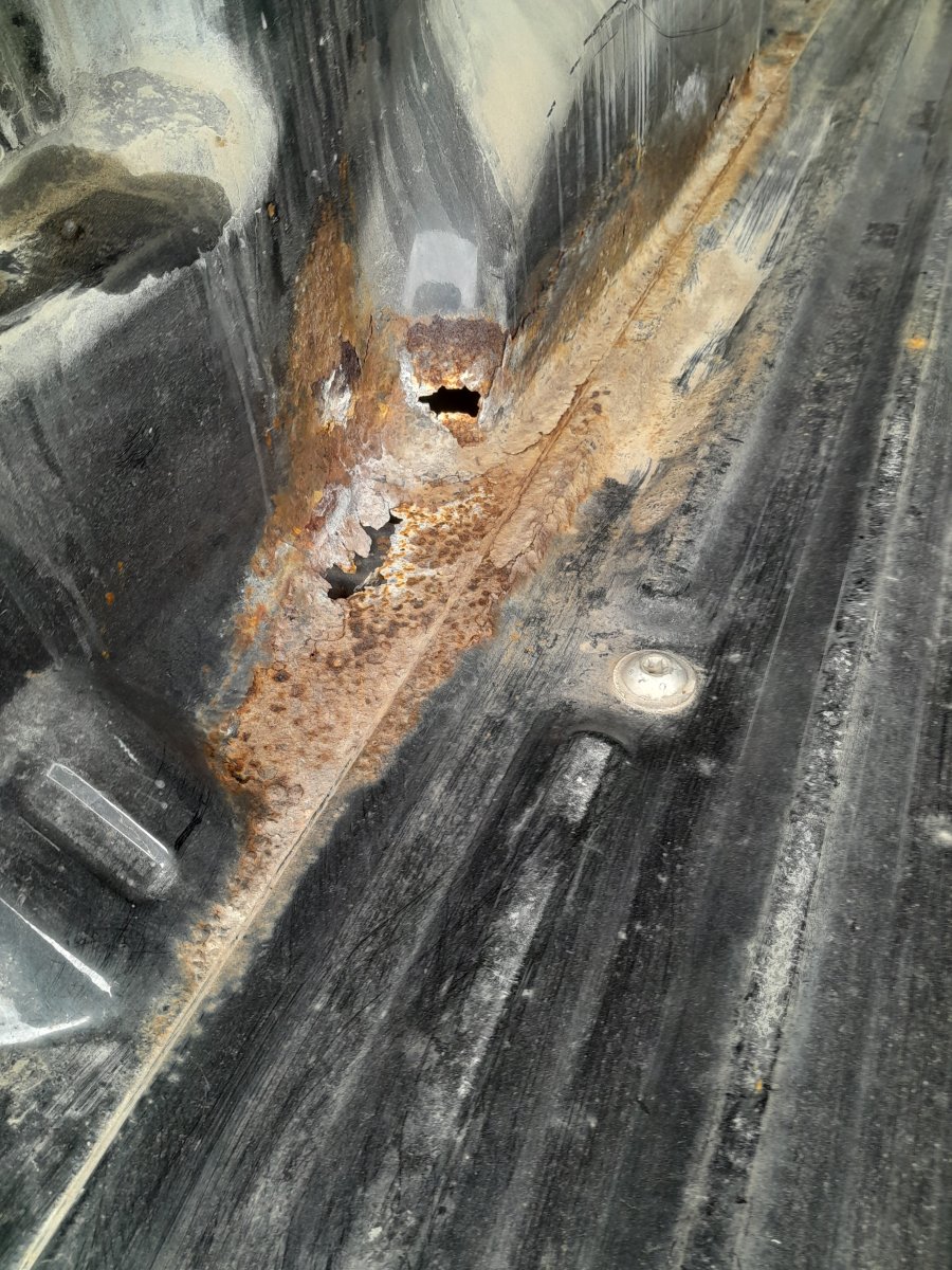

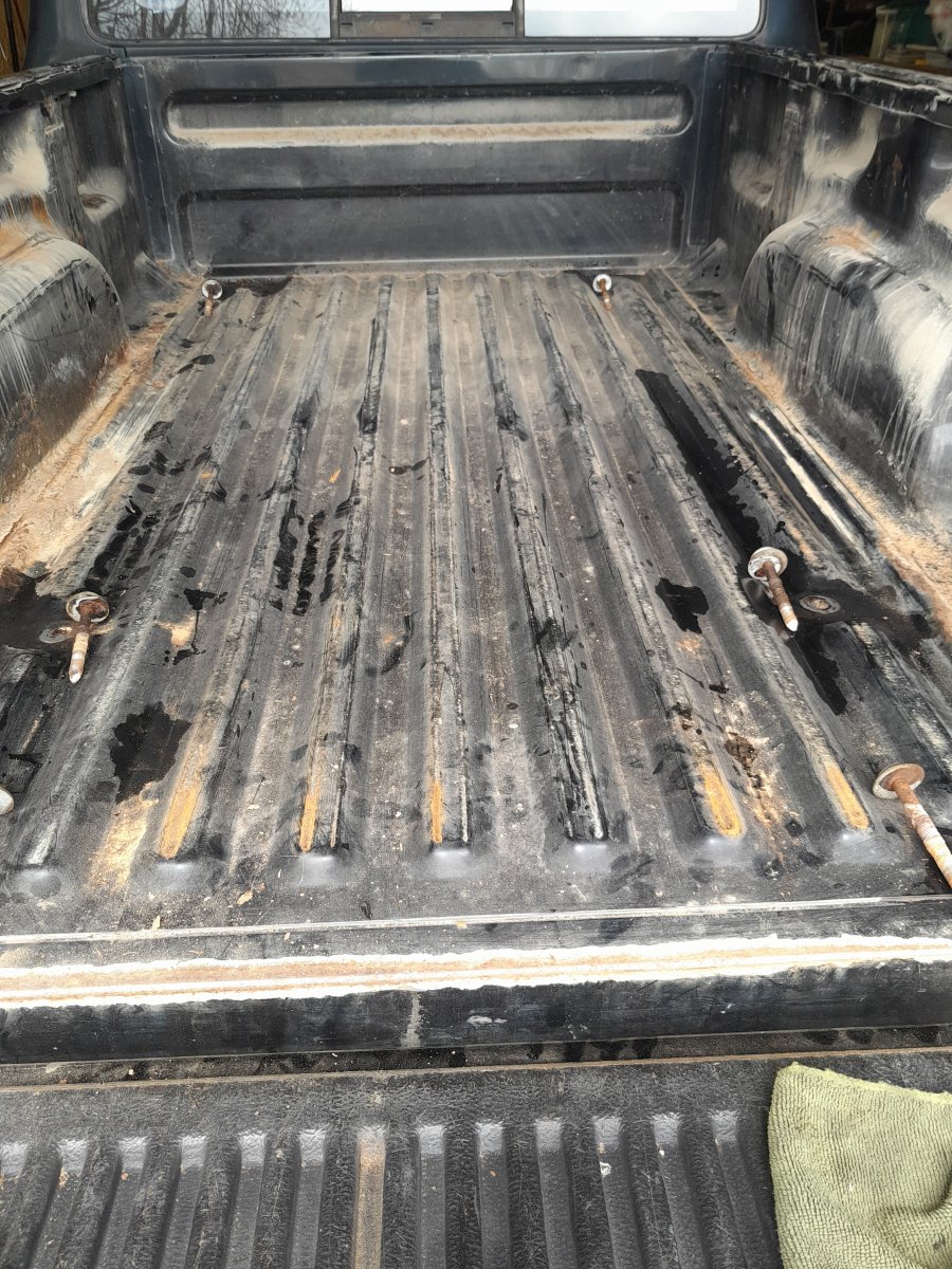

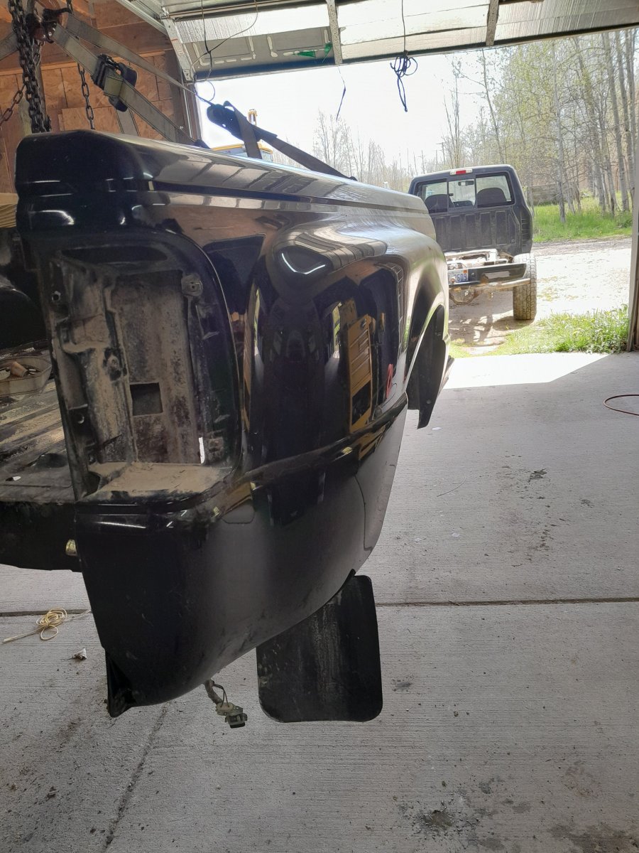

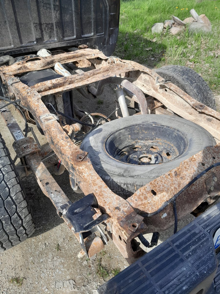

I'm back...finally after a cold winter - too cold to work in the barn even with the heaters and stove. Got started on the bed removal. Took out the bedliner. And removed all six of the bed bolts without one break or strip. - I was shocked - it did require some work though. The bed liner tie downs were another story. Out of the eight bolts that help them in place, only two came out clean. The others are broken and hanging out about a 1/4 inch.

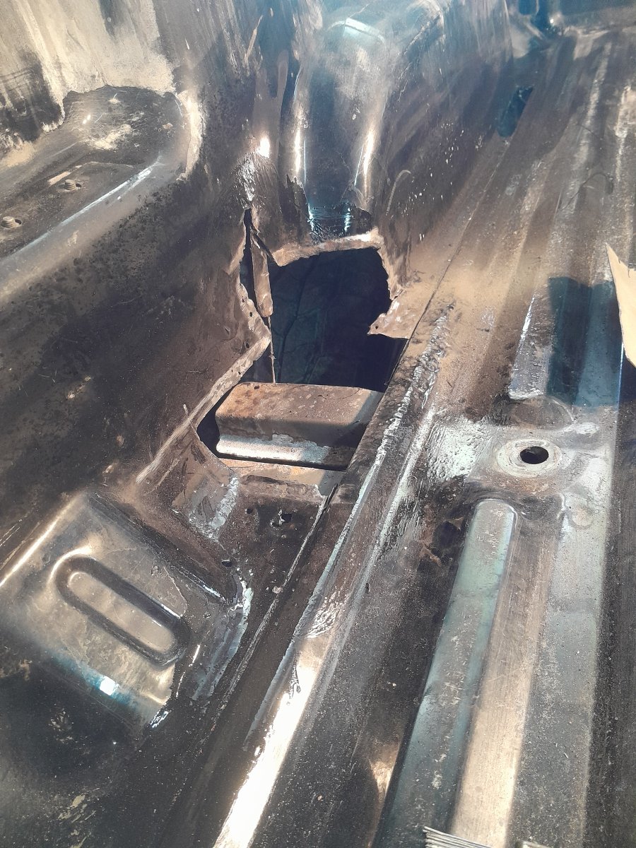

There is some rust-through on both sides of the bed at the wheel liner. I'll have to clean that up and tac in some sheet metal repair panels - fun stuff. Here's some pics

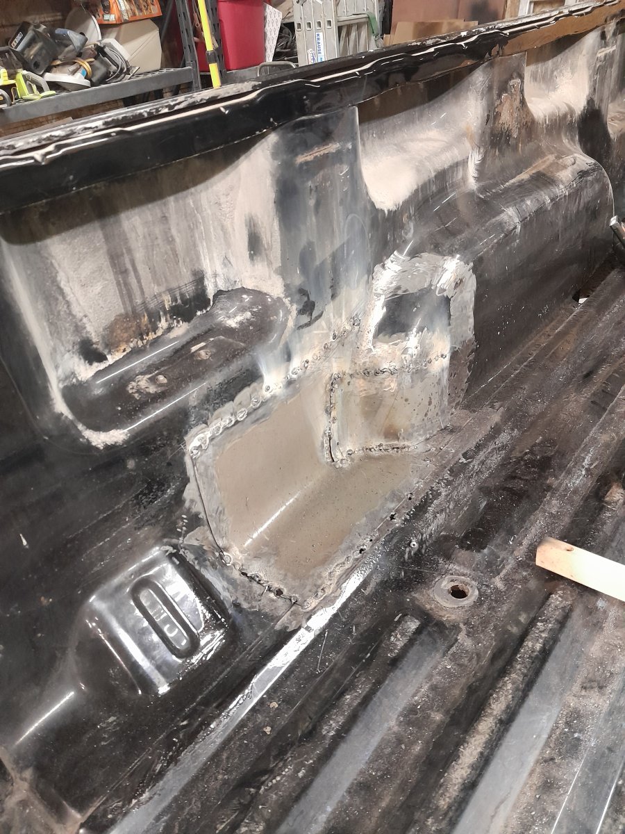

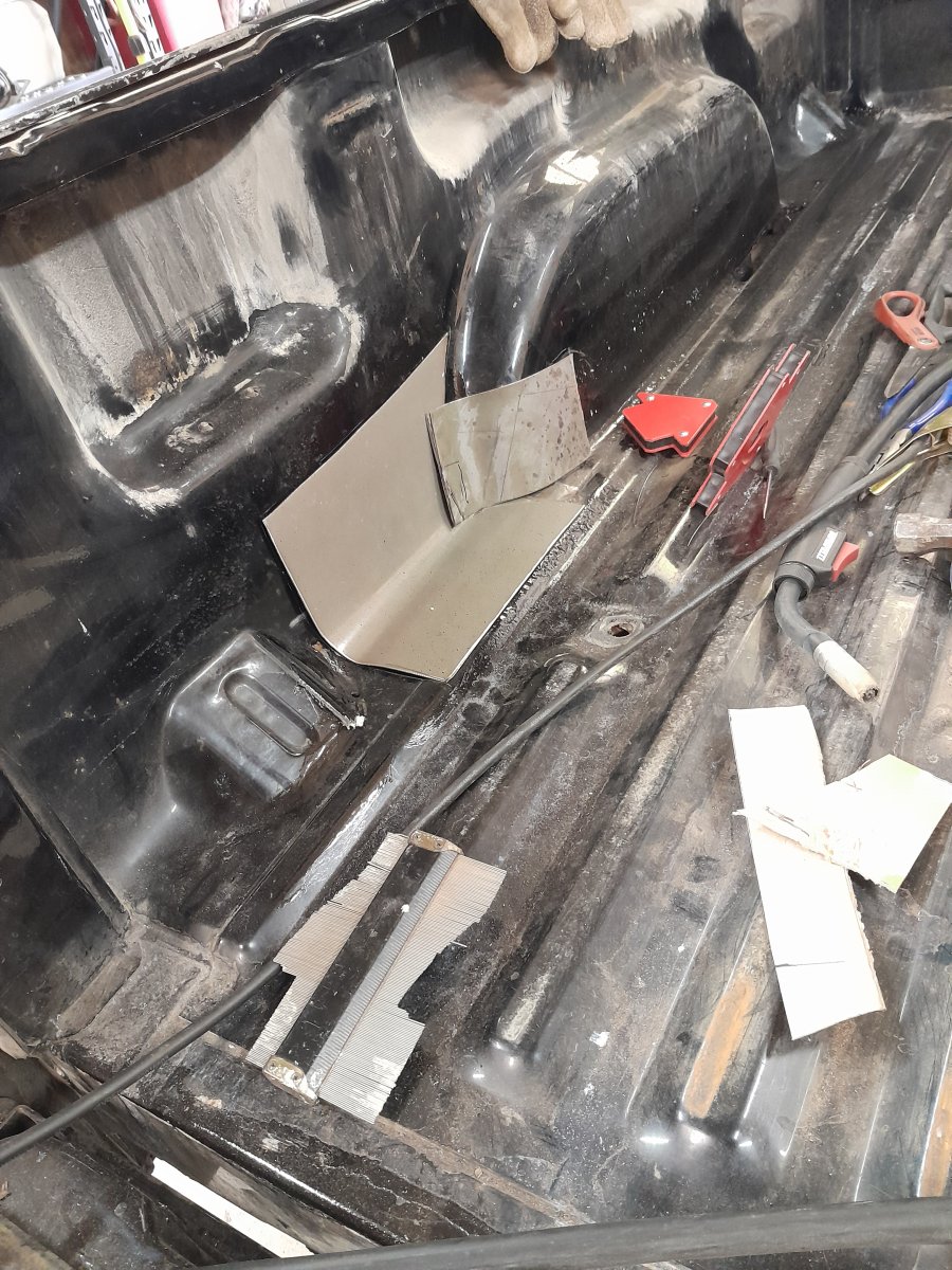

Still working on getting the bed straightened out - cleaning up the rust, POR-ing it. Learning the hard way how to use the welder on thin metal.
Finally getting round to some body work... Finally getting round to some body work... Finally getting round to some body work...
It's just the Titanium multi-process and I'm using flux core. I have to do multiple tacs to avoid the burn-thur. Still working on it, I'm not real concerned about how it looks since the bed box will cover it. Just as long as it's sealed up and rust-proofed.

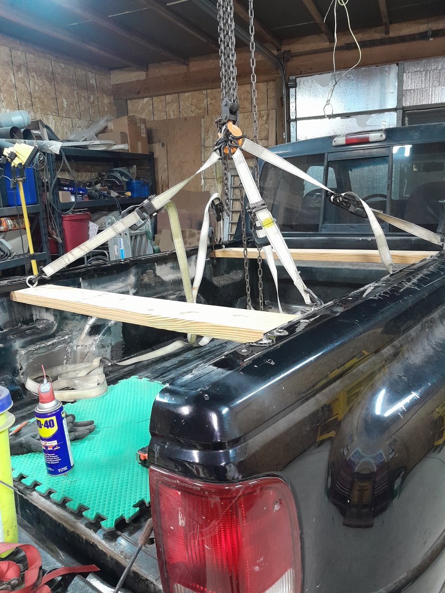

Since I don't have anyone to help. I have to devise different ways to do things without the extra hands. This is my bed removal rig:
It looks messy bu it should work. I used a similar set=up to pull the bed off the Sport Trac, It had the outside tie-downs so that made it a lot neater. Since the Ranger bed tie-downs didn't survive their removal process, I rigged up the planks and eye bolts. I'll add an additional brace across the top to make sure they hold their position when I start to raise the bed with the hoist.
Still need to disconnect some things like the filler neck and taillights and I'm sure some other surprises.

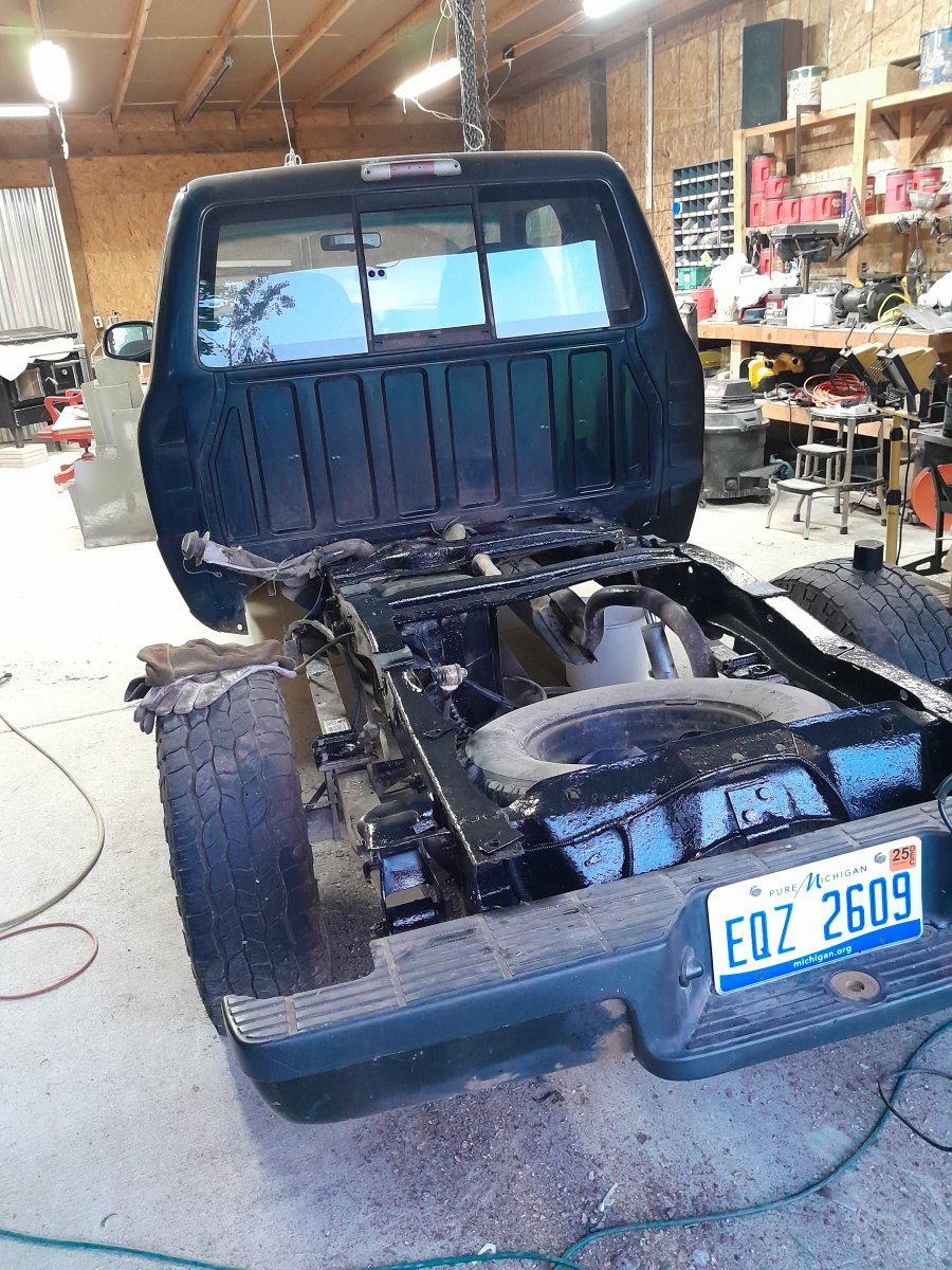

The bed is off with no hiccups:
Now to get after the clean up and POR or some sort of rust treatment.
I ended up using Wool Wax. Not sure if that was the best choice. Still have more to apply, but not ready to do under the cab yet...Messy stuff.
