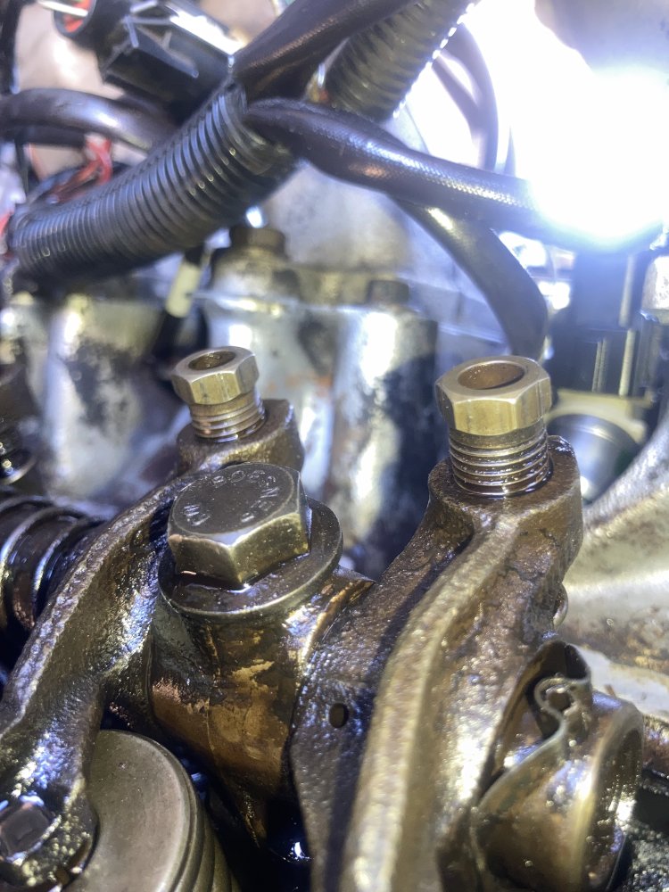

Here is a photo of both being non-jiggly..
The front exhaust valve is simply flush, and the rear intake valve is turned 1 5/8 turns so that the rod actually has resistance from below it.
The spring is there to hold the lifter's piston up so its tight against the c-clip without oil pressure at startup, yes springs can fail so that lifter can start to "tick" usually off and on, but can be steady over time
The lifter pre-load does have wiggle room, 1 and 1/2 to 1 and 3/4 is recommended
This keeps pressure at both ends of the rocker and both ends of the pushrod when cam lobe is not moving lifter up, so there should be no "ticks" of metal parts slapping together because of a gap between them, i.e. valve train noise
Because of wear on rockers and pushrods I tend to go with 1 and 3/4 but no more that that
You can bend pushrods if its adjust down too far
Yes, you can usually feel if a lifter is not what it should be as far as pushback, spring load, because after adjustment the pushrod is easier to turn that other that have been adjusted
Nothing you can do about that, no adjustment for a broken part, lifter has to be replaced, but it will still work until it's replaced
