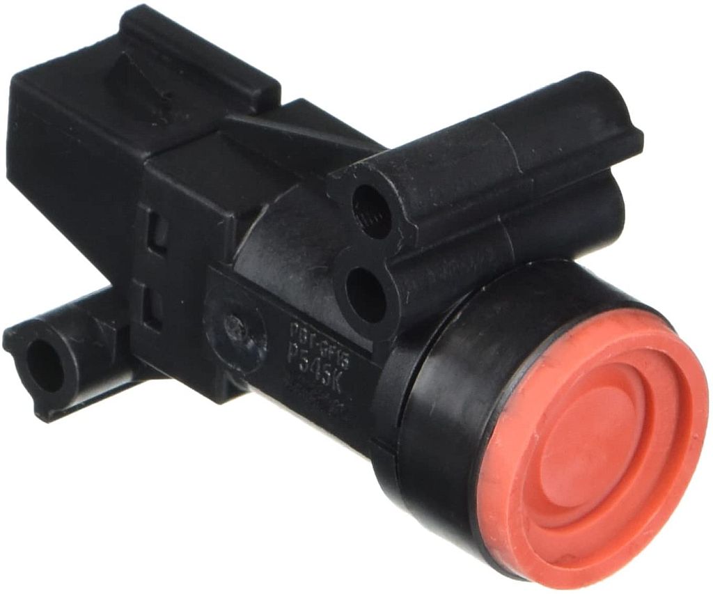

Has anyone used /found a alternate or generic CHEAPER Inertia Switch that works for the late 90's Rangers/B-4000's ?
I saw this one on Amazon. (https://www.amazon.com/Ford-5L2Z-9341-5L2z9341a-Inertia-Safety/dp/B000NTI03C?tag=959media-20)
It is for later model Rangers / Explorers / Merc Mountainers 2002 on. It is a heck of a lot cheaper than the original for 1996 - 1999 Ranger/B Series that are $108 bucks and up.
This is the later 2002 switch on Amazon

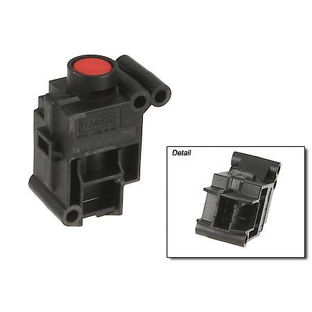

This is the OEM Switch for 1996 - 99 Rangers/B- Series.
Anyone removed the Fuel Pump Inertia Switch out of circuit because it's faulty (and expensive)?
You can use any "inertia switch", there is no assigned IN and OUT, it just a switch(on/off), two contacts
You may need to find a matching connector that fits

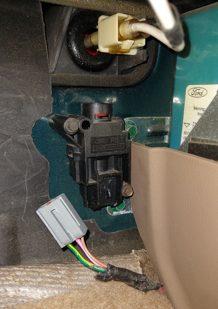

Hey RonD, here is a closeup picture of the Ford OEM Inertia Switch mounted and the disconnected plug.
How would I temporarily jumper this plug for testing, including driving it a bit to see if this is the reason the truck refuses to start after driving it. I was planning to use so 14 or 16ga solid core wire to do the jumping into the plug, just big enough to hold but not spread the female connectors much (not wreck the plug connection to a new Switch). There are 3 female connectors in this plug and the 3 wires are shown - Green/Yellow (left wire), Pink/Black (center wire) and Orange/Gray (right wire).
Thanks much.
Just put a jumper wire between the two contact slots, jumper wire needs to be at least the size of the Green/yellow stripe, that's the IN from fuel pump relay
The Pink/white wire is the OUT to fuel pump
The tan/orange wire goes to the computer to monitor voltage
Just FYI, this wire will show 5-8volts with key on/engine off, no AMPs just volts, from the computer's monitor circuit, this monitor voltage can be confusing when testing these wires, lol
Green wire will only have 12volts for 2 seconds with key on, tan wire will show 5-8v after that until key is off

So jumper between the Green/yellow and the Pink/white connector slots and ignore the 3rd slot which is the computer feed?
What happens if the computer doesn't get a voltage signal (when jumping only 1 and 2 connectors) that the pump is running or activated?

You would get a code but engine would still start, I though pink and tan were in the same slot?
You can jumper all 3 if there are 3 separate slots, then no code
It's a 3 connector plug, that Orange/Gray wire, which is the smallest gauge (maybe 14 gauge) is the last to the right on the connector in the picture above. The Green/Yellow (left wire) and Pink/Black (center wire) are larger gauge wire, easily 12 or 14 gauge. According to the schematic I have which only shows the harness, not individual wires, the cable goes from the Inertia switch to the Fuel Pump Relay and branches on to the computer. So I assume the smaller gauge never carries any appreciable amperage to the computer. I'll skip jumping that connector for now, I can always reset that thrown code with my code reader later, besides that code will give me more diagnostic info.
