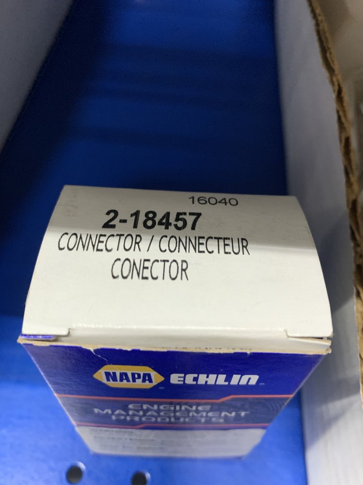

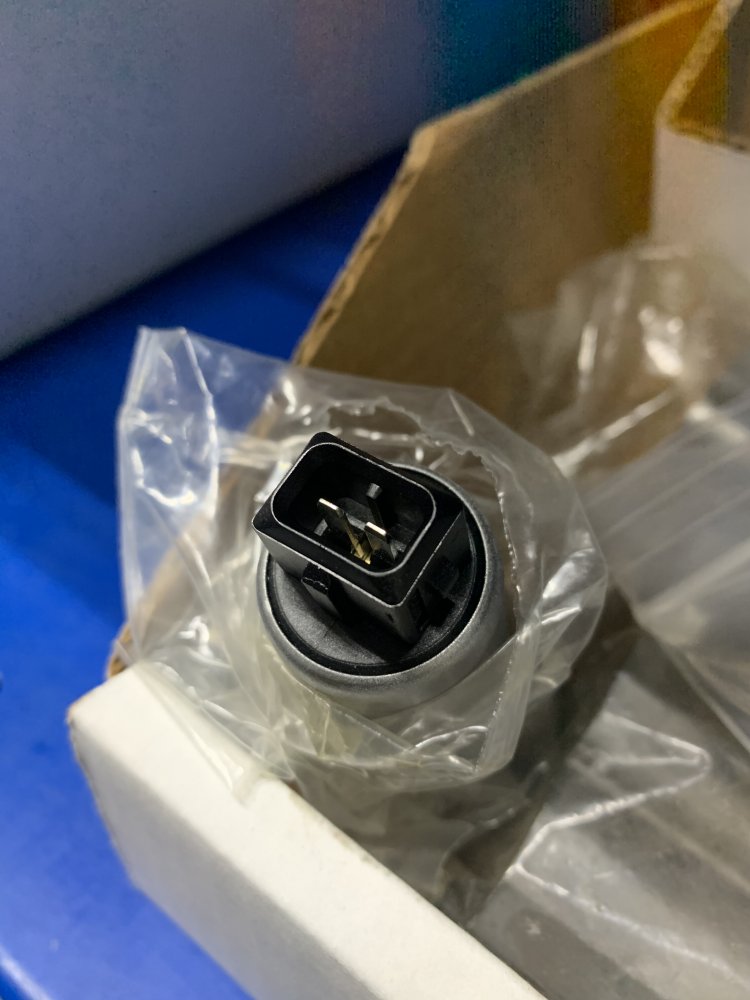

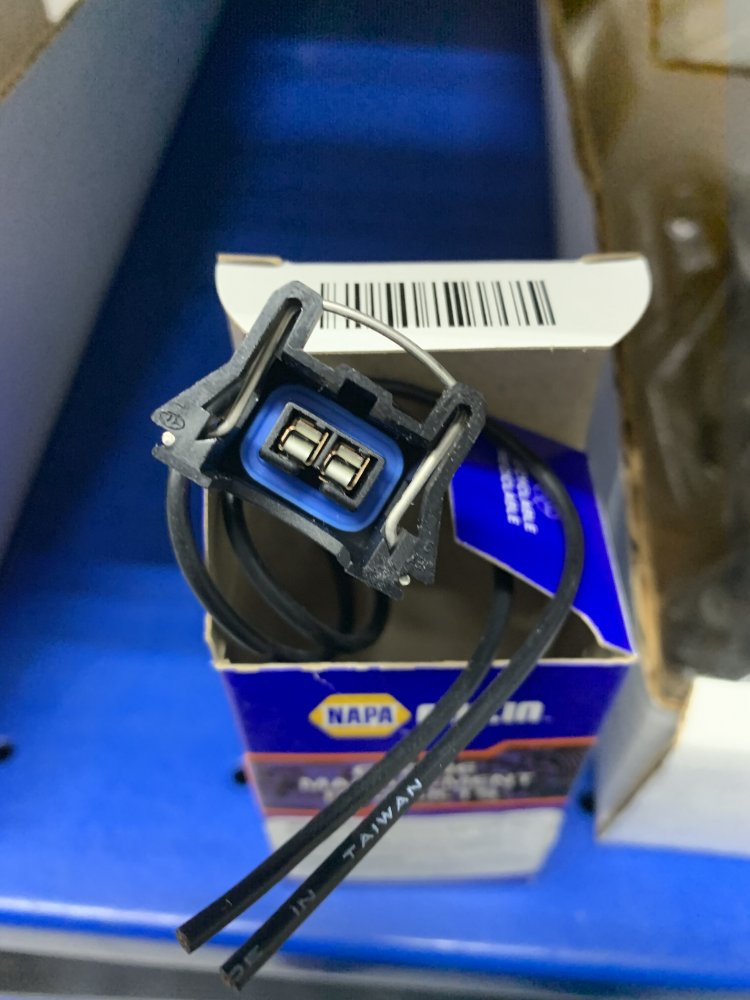

I’ll update this in a little while with pics and part #. I’m on break right now.
I work for the government.... we buy things, we don’t sell them. We use those pigtails on on a specific brand hydraulic solenoid for our plow controls. It’s just a pigtail that happens to fit other applications.
51916
51918
This is what the other end looks like...
51919
It crosses to:
AC Delco - PT 113
GM # - 12085491

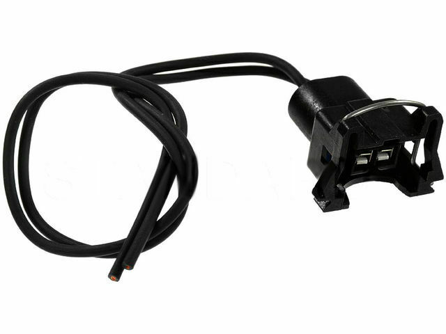

Yeah, that part you've got sure look a LOT like the picture for the 97 - 2002 Mazda B4000 and Ranger XLT V6's I found. Do you know how much those are from NAPA? On EBay they're $18.95

I found the CPS connectors at Rock Auto, very good prices, far better than EBay or retail stores that also sell online - https://www.rockauto.com/en/catalog...tor,crankshaft+position+sensor+connector,2568
