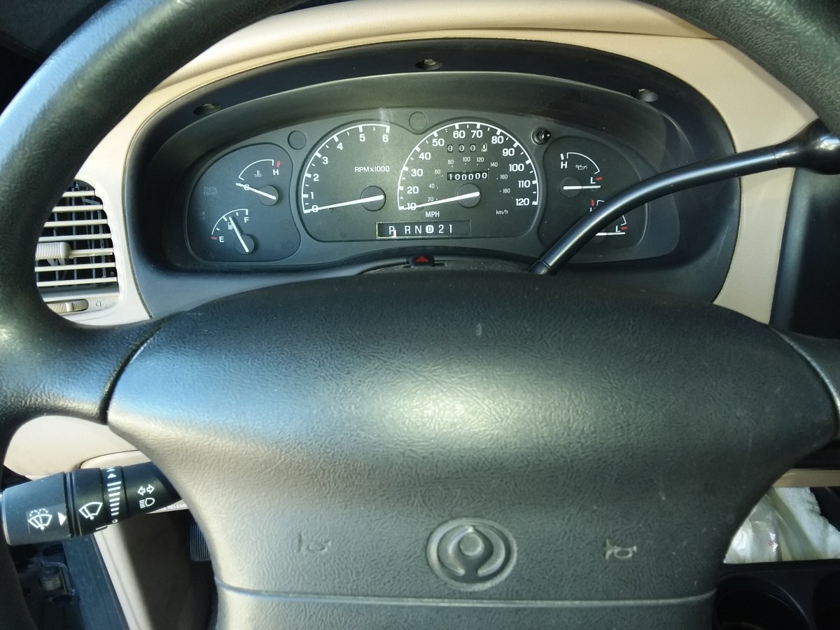

First thing this morning, before touching anything else on the truck, I decided to get a closer look at that Crank Sensor, which I've had problems with on and off for years (see #4 on my list of "history" on the above post.). Not necessarily the sensor as far as I know, but the connector has gotten fouled from road crap and it was loose a couple of times. My driveway is a 8 degree slope, so can't use jacks and I don't have a lift, so it's a matter of squeezing under the front of the truck which doesn't have any lift kits. The connector wasn't loose, but I "jiggled" it anyways and pushed down to seat it to the sensor as far as it would go.
Jumped into the cab and the truck started right up. Well damn! No movement on the harmonic dampener, I think the truck is too mileage young for that, get this, it stopped running EXACTLY at 100,000 on the Odo! (look below)
So, is this conclusive, could it only be the crank sensor or just a fouled connector that is the Troublemaker for the no start the day after it ran fine? Or do i keep looking elsewhere for a co-villian? Anyone know if this is a common problem on the 4.0L V6? Or am I just jinxed.
