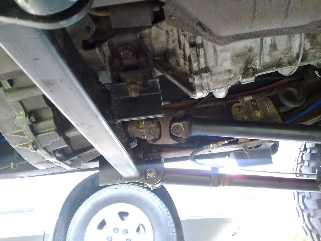

Worked my a** off the last two days. Yesterday I helped a friend move most of the morning till 3pm. Then parked the truck in the garage and started tearing the transmission out. That was a PITA. Much easier on a 4cyl, no y-pipe to mess with. Got the trans out, pulled the guts out of it, replace a few bearings and seals, put the 4wd mainshaft in, and had it put all back together last nite at 11pm.
This morning up at 8am. Got the transmission, transfer case, front, and rear shafts in. Took it for a drive. Drove ok, but I think I am going to build a traction bar to help with the axle wrap. Might get rid of most of the vibrations when accelerating.
Here are some pics of it afterwards. No pics taken during the swap. I was to busy with greasy hands even with gloves on.

When I moved the front axle forward, I forgot about the driveshaft. Now it is to short. There is still about 1.25" of travel left that will be fine for normal driving. I might be ok with it, I think when the suspension extends it might actually shorten or stall the same length.
Escorts 2nd SAS
On the other hand, the pinion angle looks good...

Check your carrier bearing. I have very little vibration out of the rear end/driveline now. The 2 piece driveshaft was my problem. Switched to 1 piece and vibration went away. I still have axle wrap, but it isn't affecting anything really
Yeah. I need a piece badly but i dont have the funds right now.
Got to get the front spring problem fixed first then i will look into a new driveshaft.
just keep an eye on the u bolt straps at both ends. I drove mine with that vibration for like 6 months. lol. Just make sure the slop doesn't loosen those bolts, or you will end up like my 71... driveshaft laying under the truck and a busted yoke... Needless to say, its a one piece now too.
