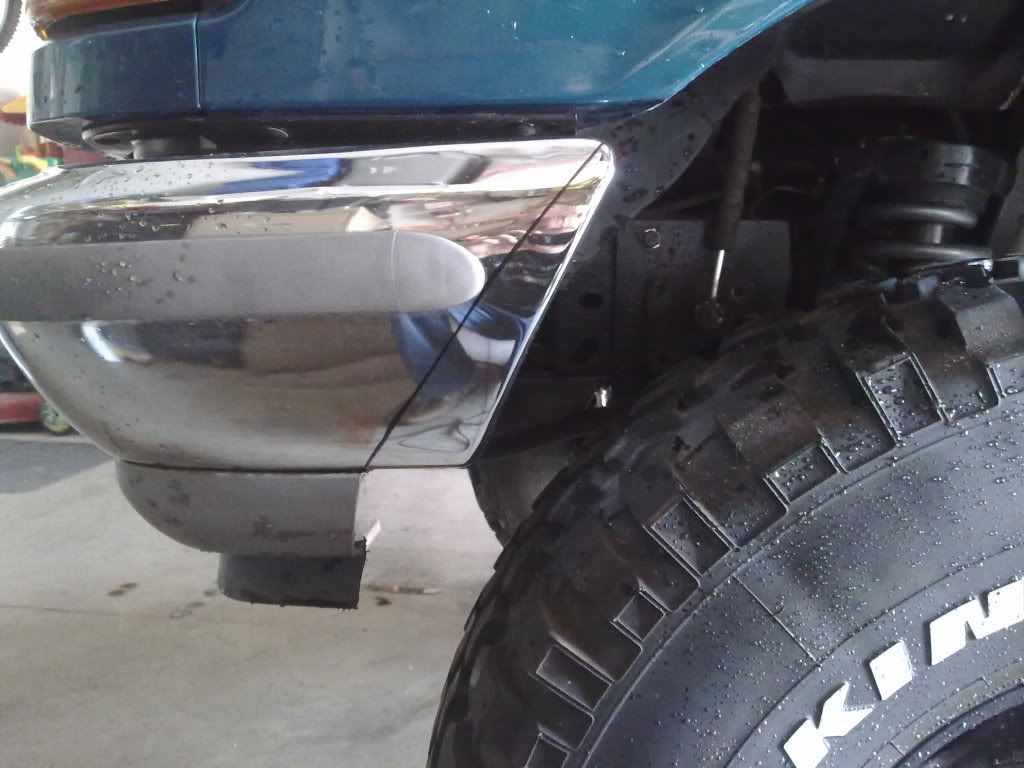

Was board earlier today so I got out the angle grinder..
