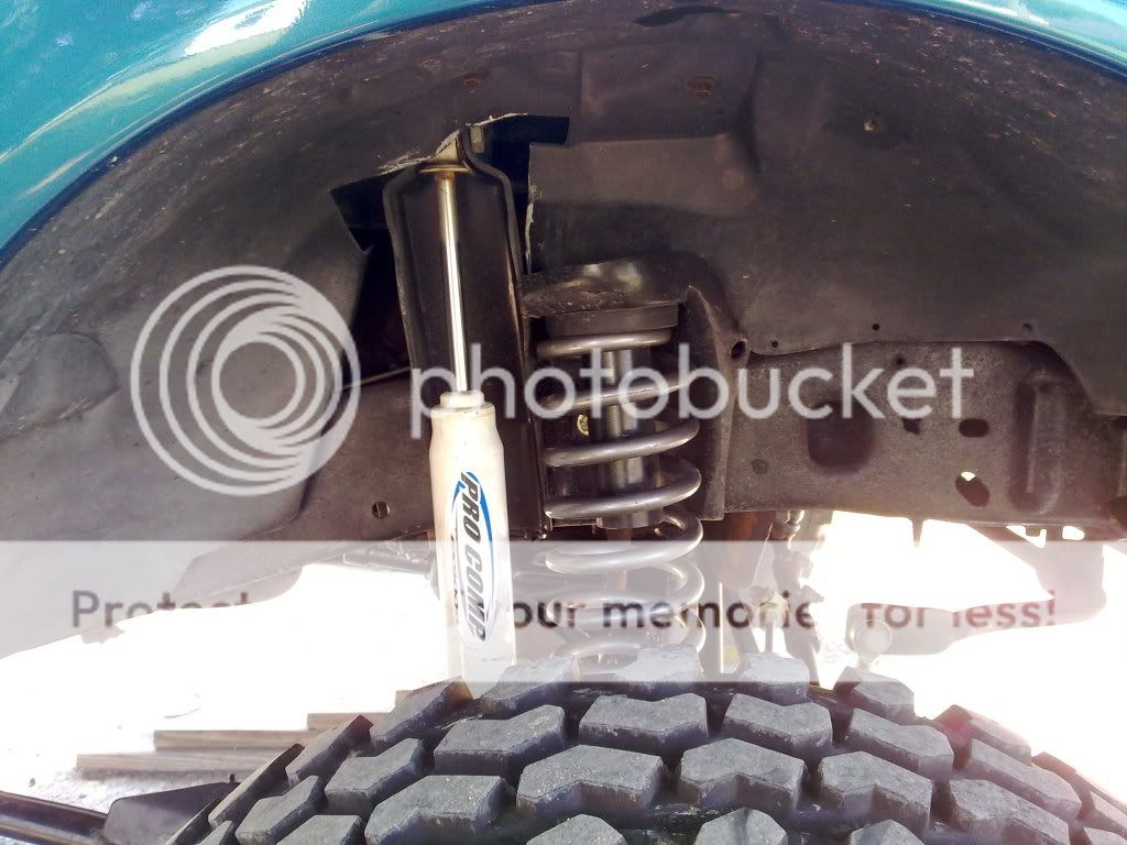

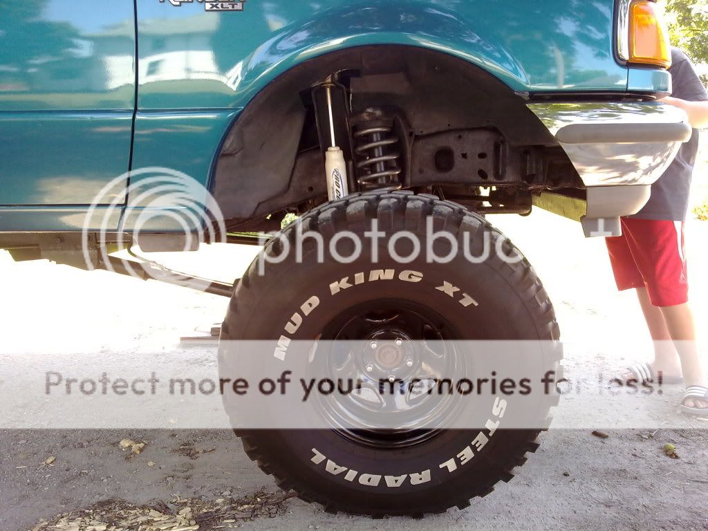

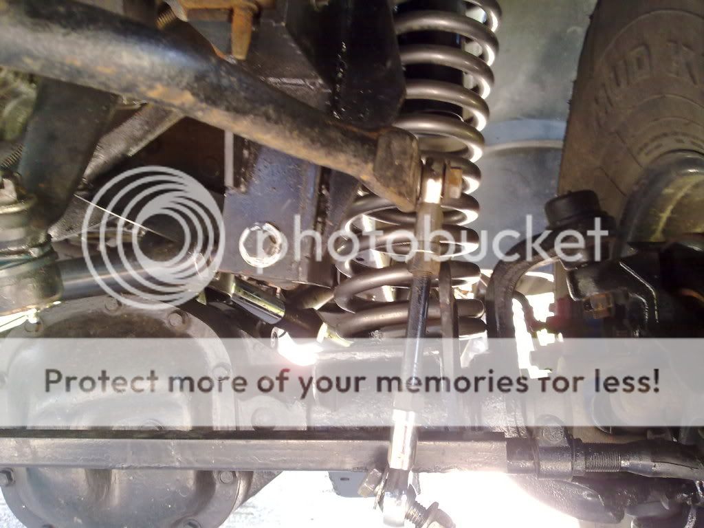

Here is a picture of what my problem is that I will try to fix in the next couple days...
Escorts 2nd SAS
See how the coil is in front of the axle...
Escorts 2nd SAS
I am going to cut the round part off that holds the coil in place and weld a 3/16" plate on top and then reweld the round part to the plate. I will take tons of pics along the way for anyone that might be interested...

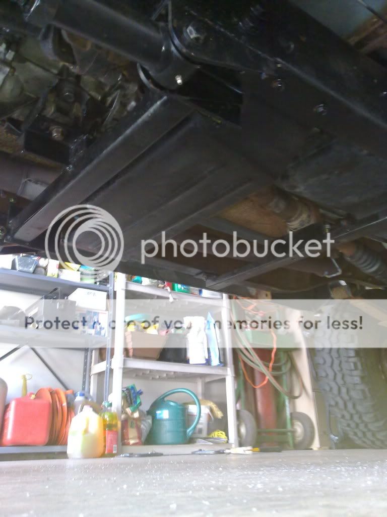

And here is the skid plate
Escorts 2nd SAS
Not yet (knock on wood). Only wheeled once with it.
My coils do the samething but Im not worried about it. I did noice how much your shock travels up and looking at yours, safe to say that mine maxes out on the uptravel, hince why my flex sucks and my rear does most of the flexing. Getting EB shock towers is still on my todo list (alone with a million other things).

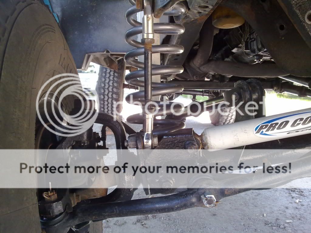

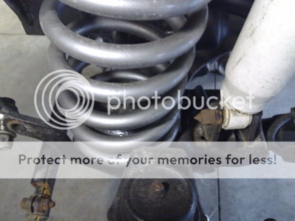

Here is what I got done today...
Cut the coil retainer off the axle...
Escorts 2nd SAS
Escorts 2nd SAS
Then welded this plate to it....
Escorts 2nd SAS

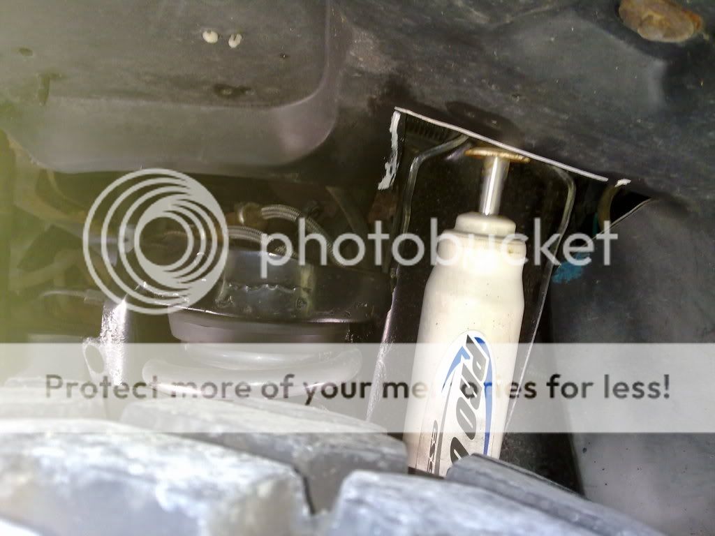

Then welded the coil retainer on top of the plate, it's now centered on the axle...have the shock mount welded on too...
Escorts 2nd SAS
Escorts 2nd SAS
Painted....
Escorts 2nd SAS
All put back in, looks much better now.
Escorts 2nd SAS
Before
Escorts 2nd SAS
After
Escorts 2nd SAS
Only took me 6 hours. Take it for a drive tomorrow and see how it does.
I also welded some skid plates to the lower control arm mount. I'll have to take a pic of it tomorrow

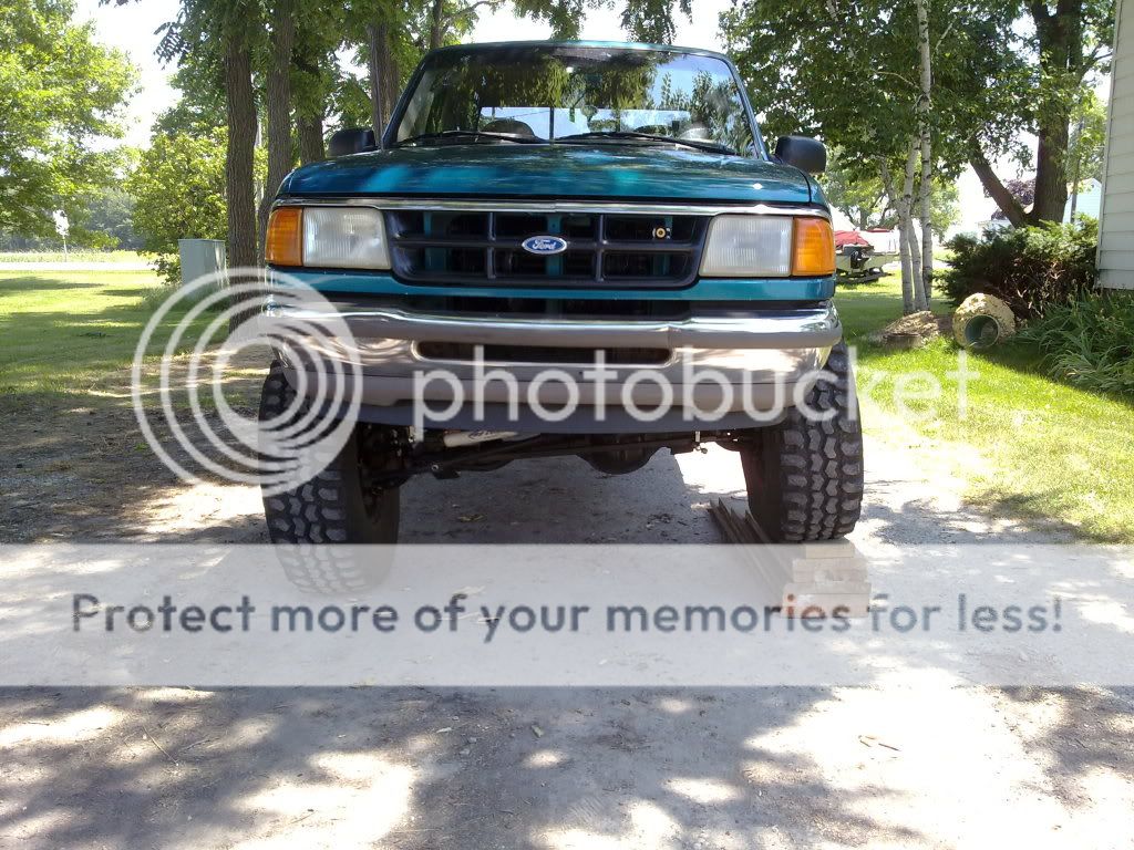

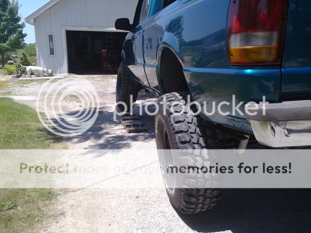

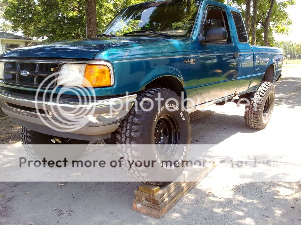

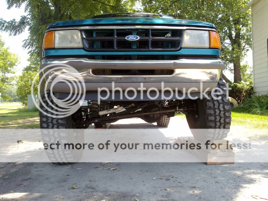

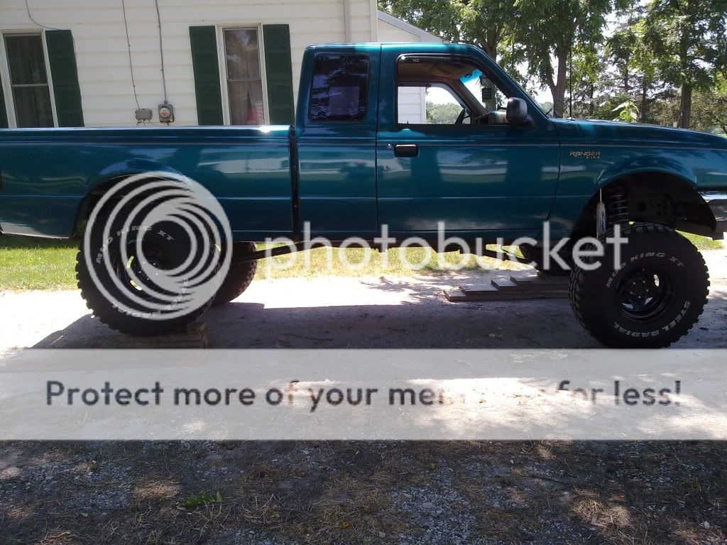

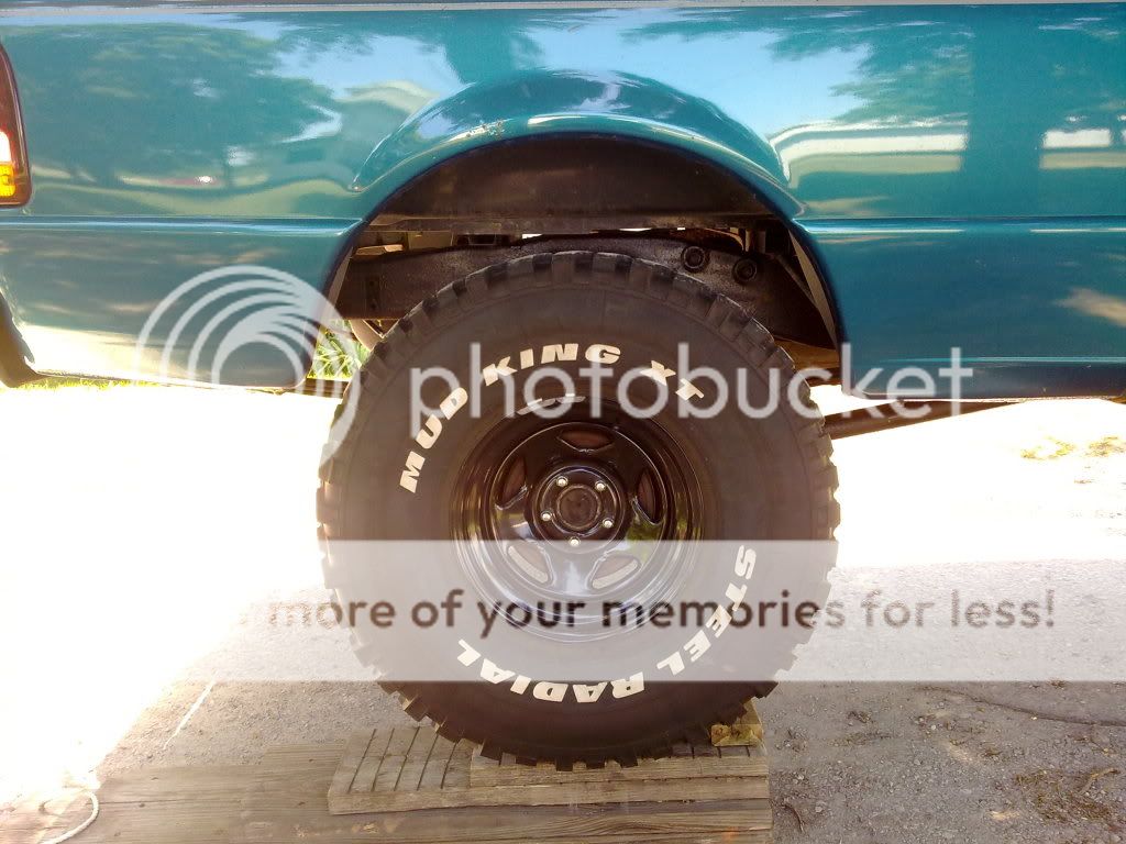

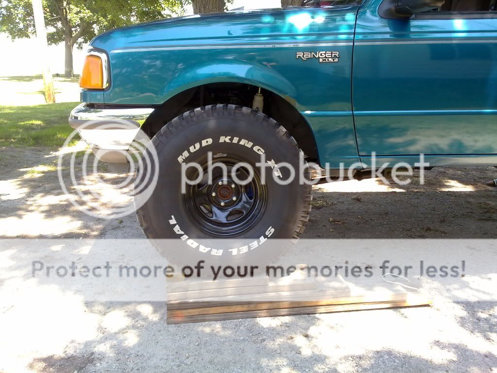

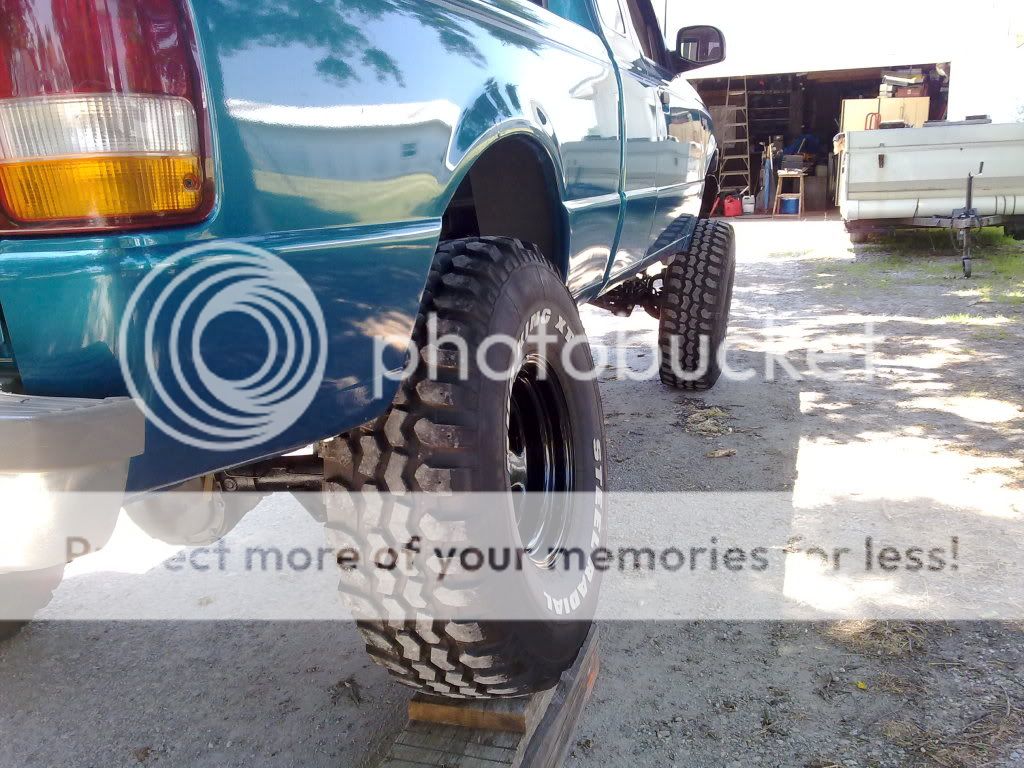

Went to my parents to use some ramps that my dad made to check flex clearances now after the work..... flexed alright could of went more but I didnt feel like trying to make a taller ramps. Mainly I was just trying to check for clearances...

Naw that ruin all the flex! Lol don't you have a ditch to flex in rather then the ramps?
find a ditch, you can really flex it out then...
