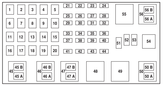

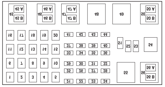

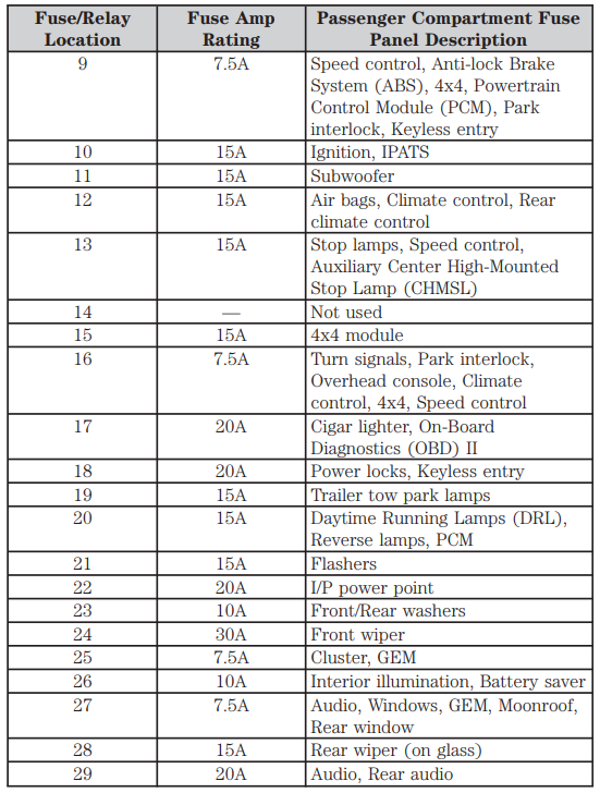

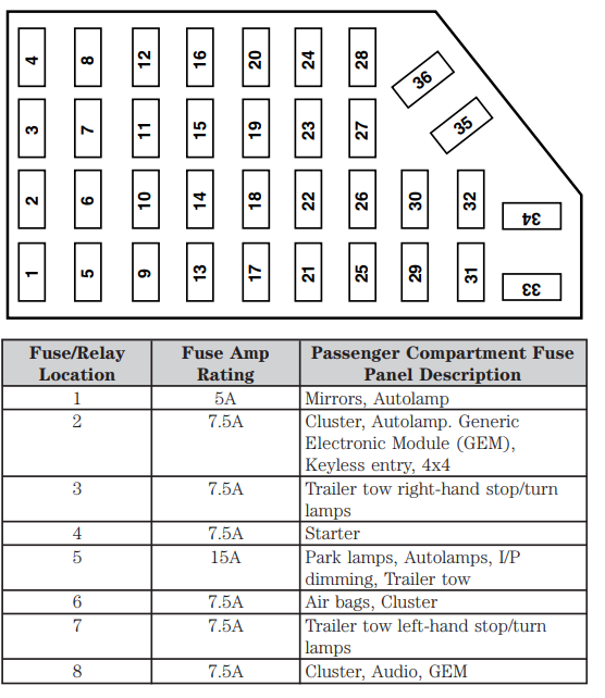

I do have a question on the fuse cover in the engine compartment. Is it suppose to match the layout exactly?
This is the layout...
but the cover looks like this... just imaging the numbers are facing correctly.
it;s a mirror image

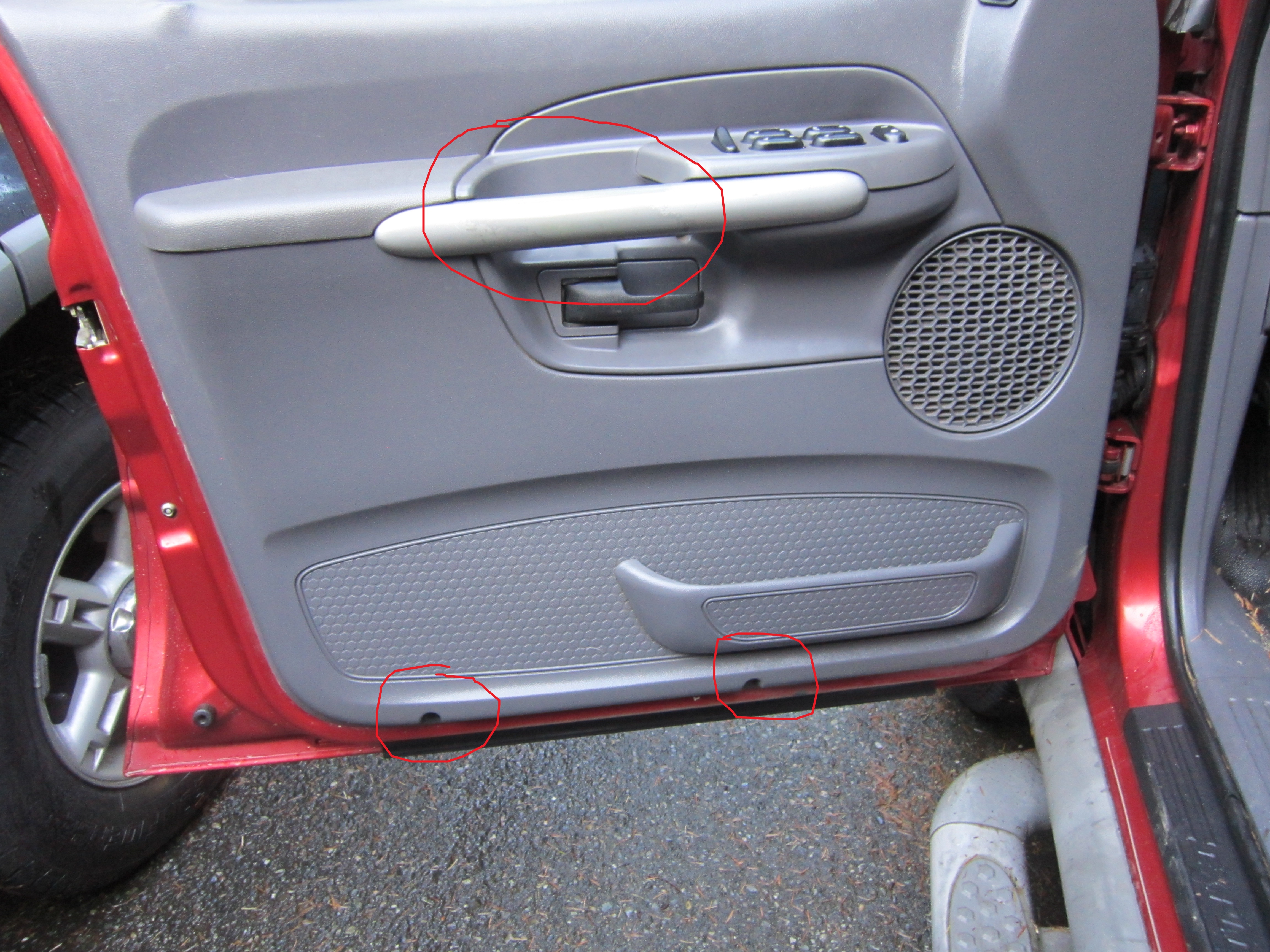

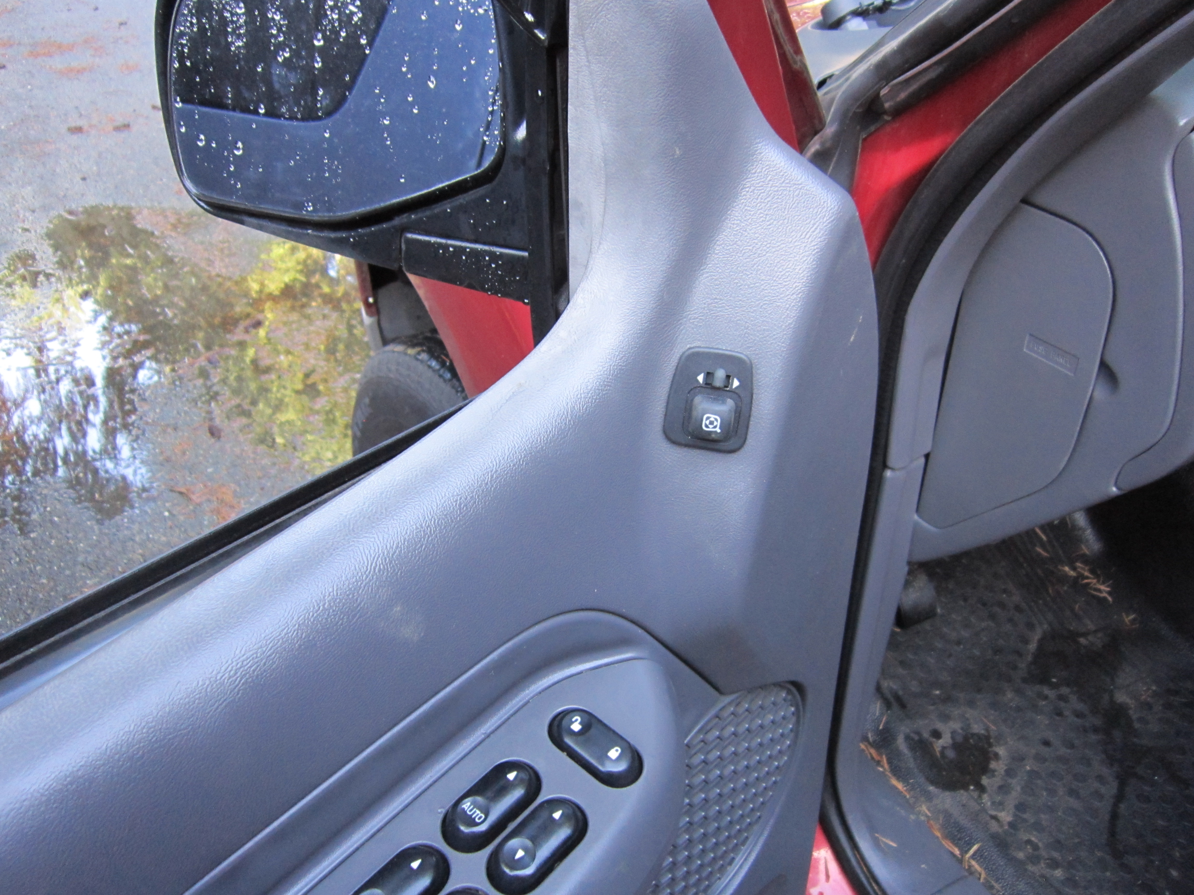

Today, I picked up the power mirror switch. Pulled off the dr. door panel, 4 screws 5.5mm head (2) behind the pull handle and (2) at the bottom of the door panel. There is a little plate at the door handle, it has integrated flat clips on the top and bottom of the plate. It pops of very easily. The multifunction window switch has (2) metal clips, (1) in front and (1) in back. This lifts up fairly easily as well. Disconnect the door lock switch connector and the (2) connectors for the power windows. Pop out the clips (2) at the bottom of the door and (3) on the front and (3) on the back.

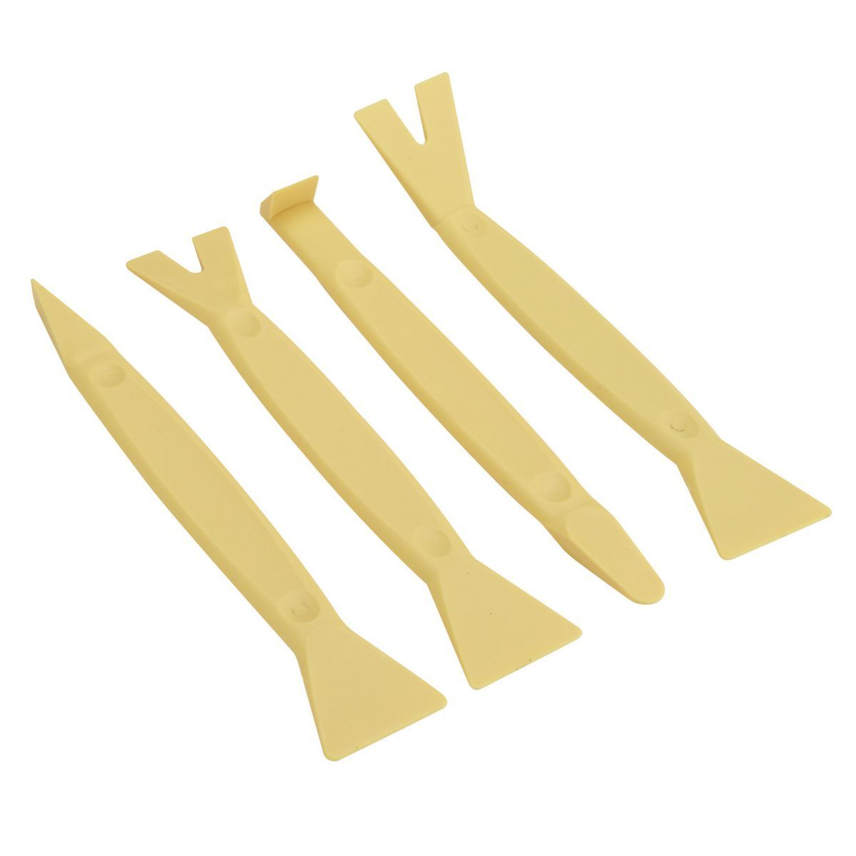

It's a lot easier if you have an interior trim tool kit.
Once all the door panel clips are disconnected, you can just lift straight up to detach it from the window belt trim. You can now disconnect the mirror switch. The mirror switch has (2) clips (1) on top and (1) on the side. If you push in the (1) on the side 1st it will be easier to get it out after pressing the top clip. Once the new switch is installed you can just put the panel back on. The 1st step is to line up the window belt trim, have the window down then start with the back of the door panel 1st at a slight angle, line up the lock knob and with the corner of the panel in window belt trim track the panel will just guide itself in the trim track. Then reverse the process of removing the door panel.
This whole job took about 20 minutes total. If it's your 1st time go slow so you don't break any plastic clips or the parts that hold the clips on the door.

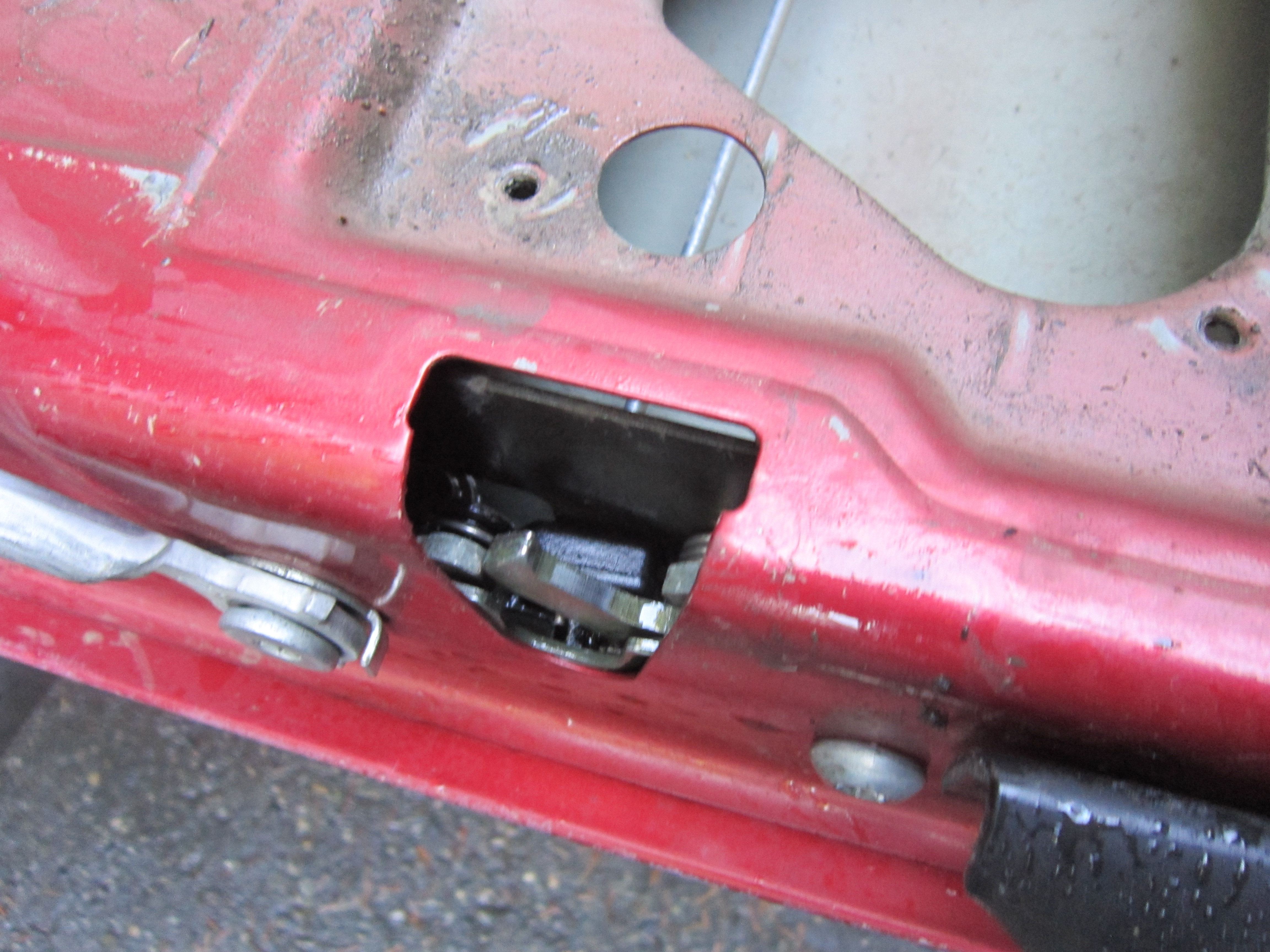

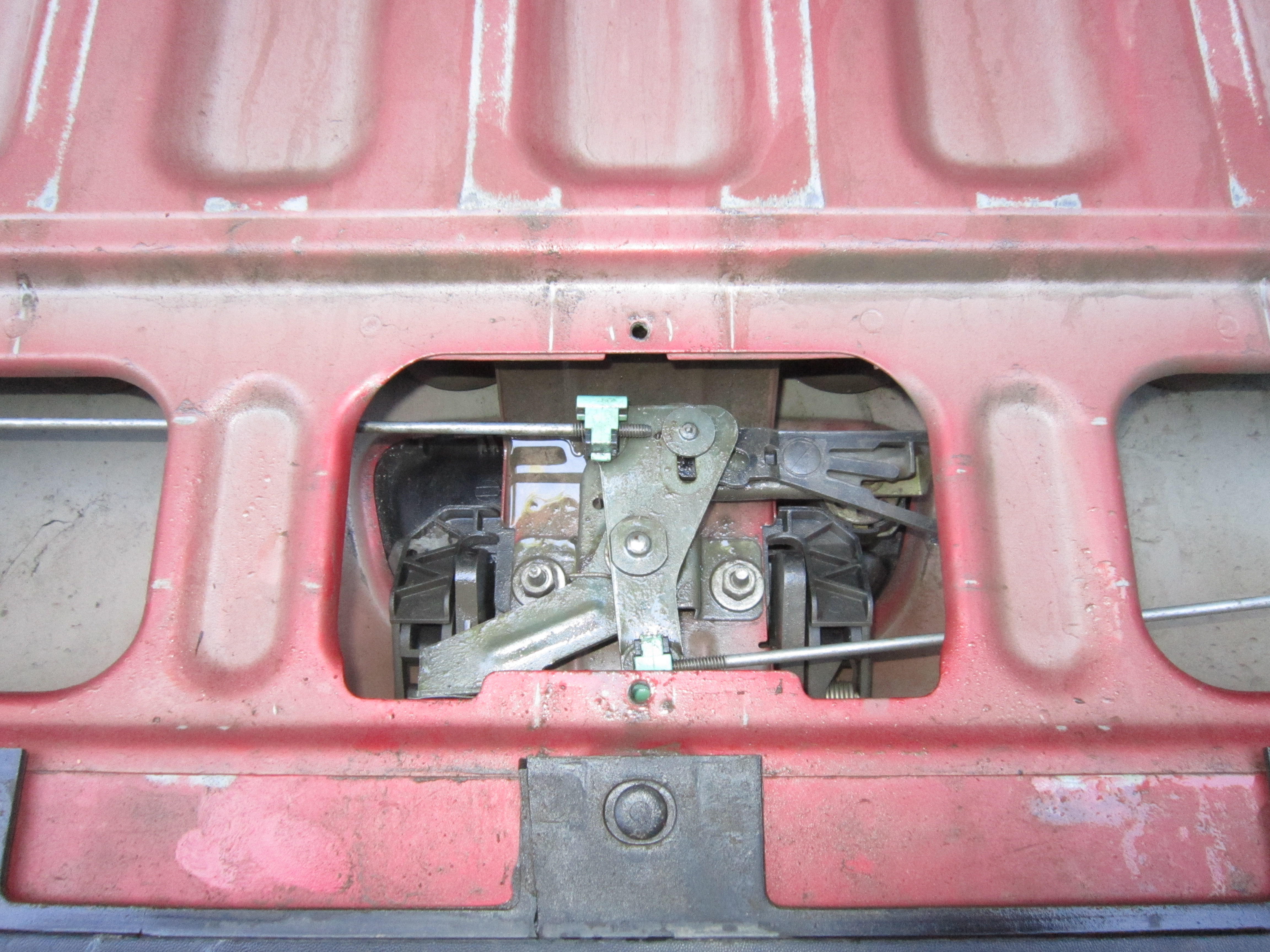

The next task was to find out why my tailgate handle was difficult to operate. You would have to pull up really forcefully to get it too unlatch. I was thinking that something was bent or a plastic clip was going to fail. There are (6) T30 Torx head screws towards the top of the tailgate. (2) on the left side, (2) in the middle, and (2) on the right side. Then there are (4) body clips at the bottom.
Once the panel was off, I could tell that all the mechanisms were dry and dirty. Took some brake cleaner spray and sprayed the mechanisms, the latch and (2) locks on each side of the tailgate. Once that dried, I sprayed WD-40 on them with a good soak. Unfortunately, I didn't have any lithium grease which would have been better. I have plans that I want to do to the tailgate so I will coat latches at that time.

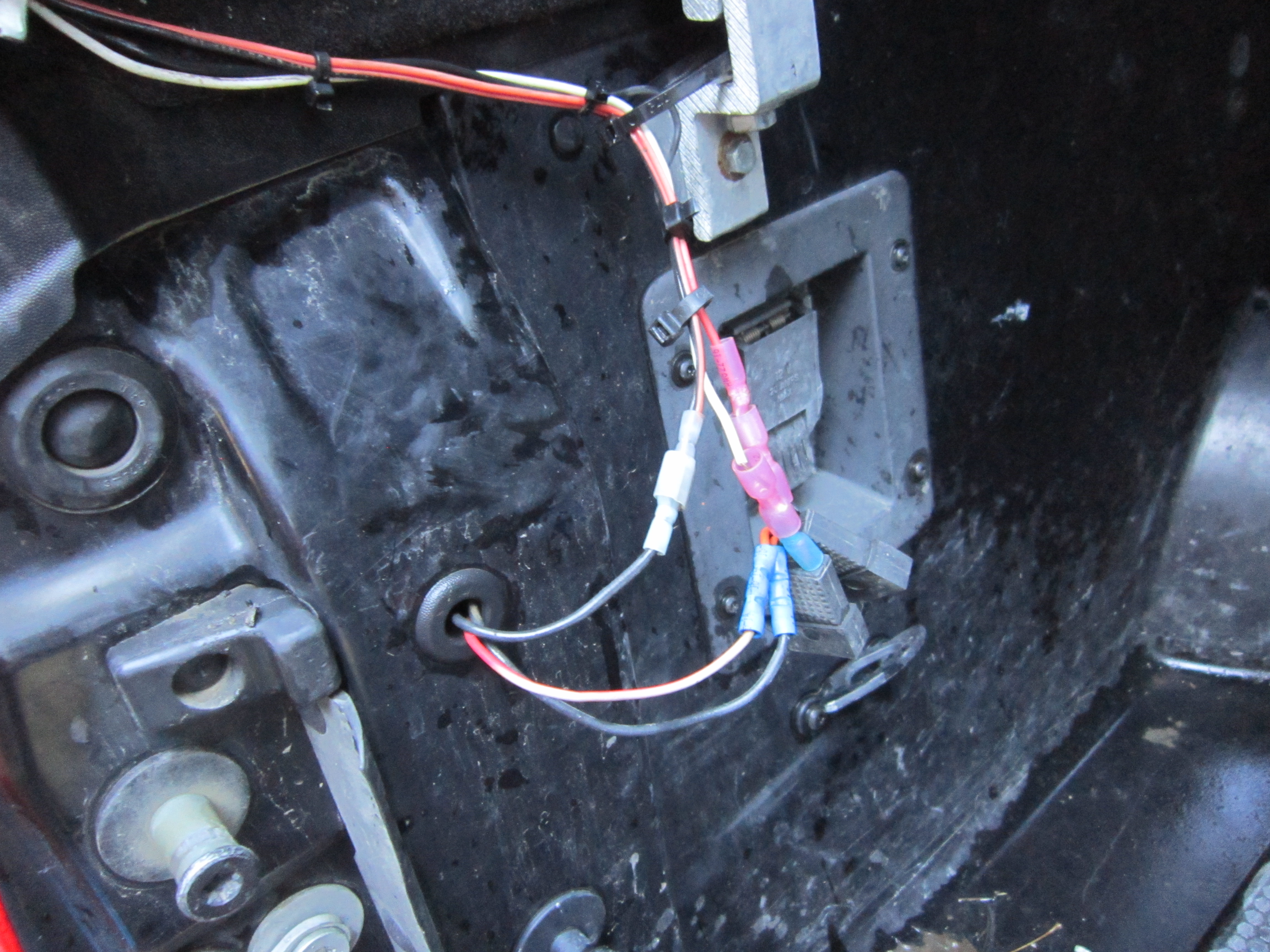

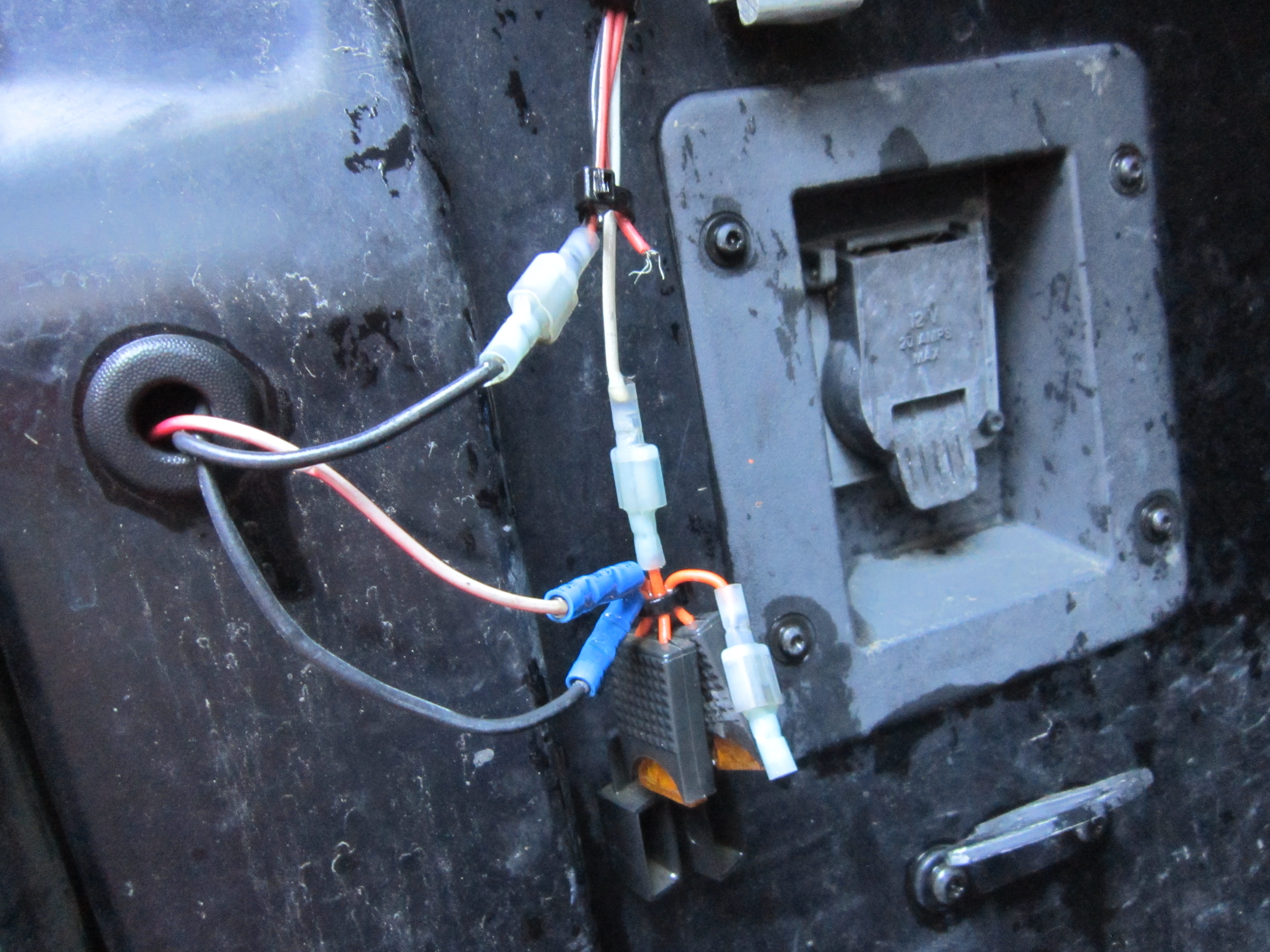

While I was doing this I noticed the poor install of the 3rd brake light on the topper. One of the wires was broken. Surprise there.
I'm not a huge fan of butt connectors just for the simple fact that they can fail. These have been open to the elements because the back glass is missing. The wires have corrosion on them as well. I threw some new butt connectors on to get by until I have the proper connector for this.

Odd about the trim kit -- I lust picked one up from HF. I needed it to put a back-up cam in our Escape -- it really did make the job much easier without breaking any of the trim pieces - which is what would happen with a screw driver.

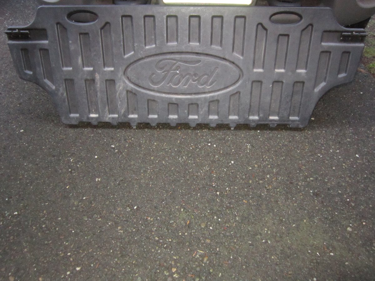

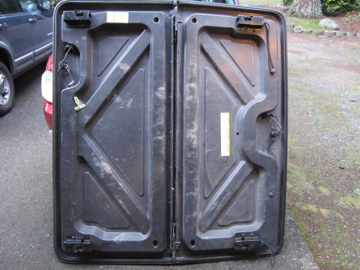

I found a tonneau cover and bed separator for free. I pick those up weekend after New Year.
Today, drove down to Portland to pick up a factory bed cover and bed divider for the truck. Turns out I picked up a bike rack as well. All FREE!!! Well, 80.00 for gas, so good purchase anyway. With keys and hardware.
