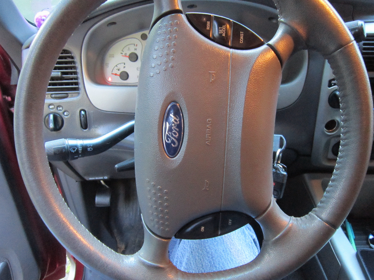

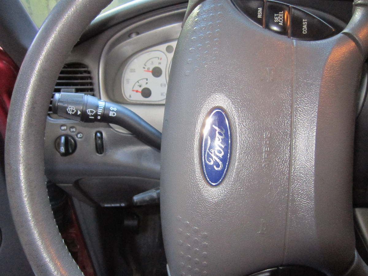

March I installed a F150 turn signal stalk because my knee kept hitting the ST T/S stalk.

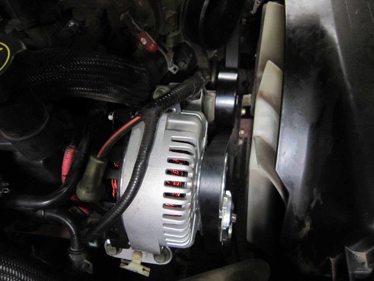

In April, alternator was making noise after washing it. Serp belt was cracked so I just replaced the lot. Belt, tensioner, idler, and alt. Also found a gas cap leash at the junkyard so I installed that too.

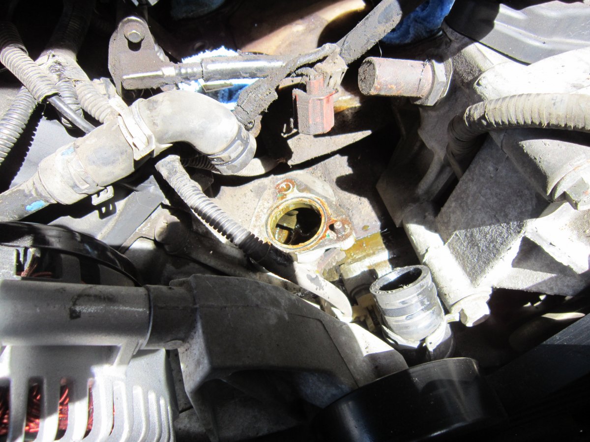

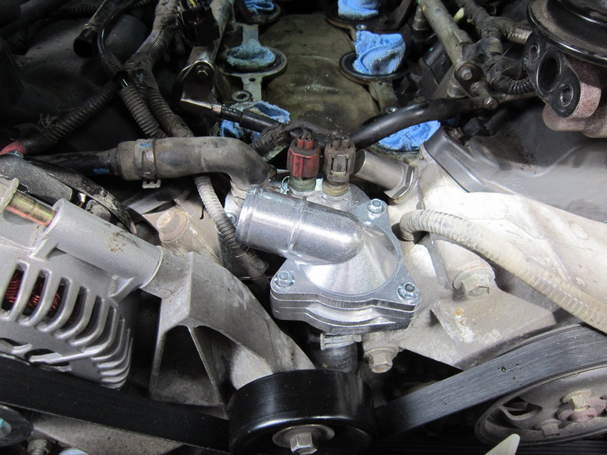

Maintenance wise during that I replaced the t-stat housing and tensioners, and had a small victory.

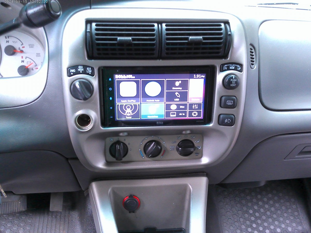

I installed the BOSS radio I got a while back. Hooked and installed the Charger and ApplePlay port also.

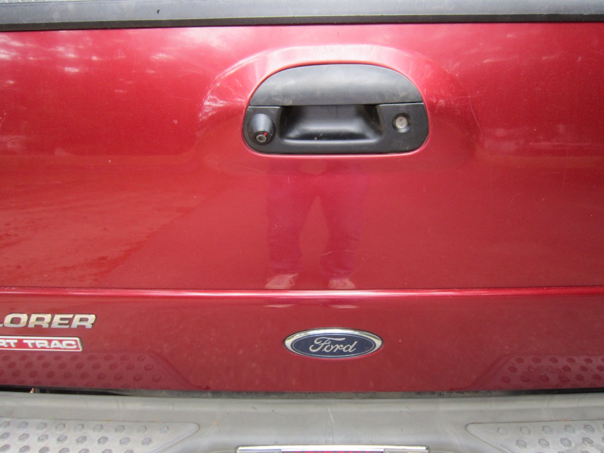

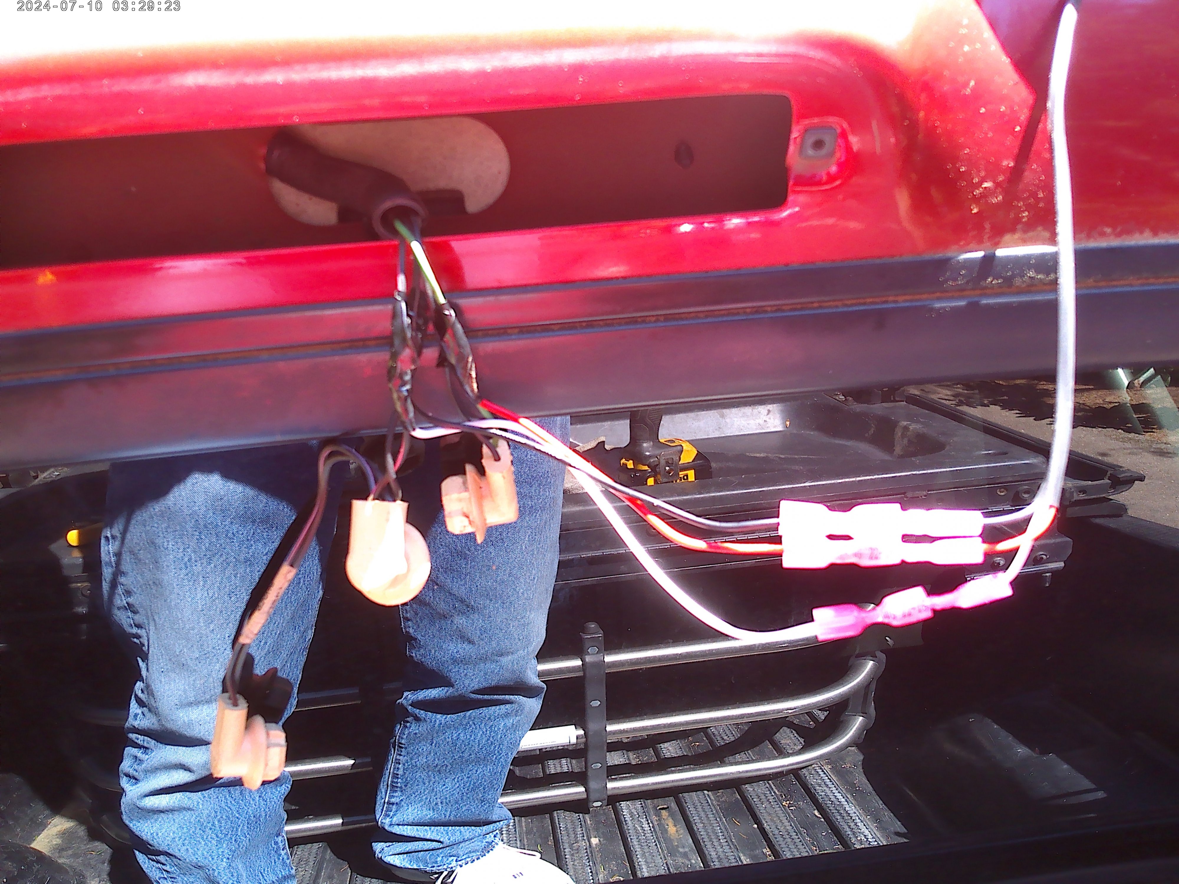

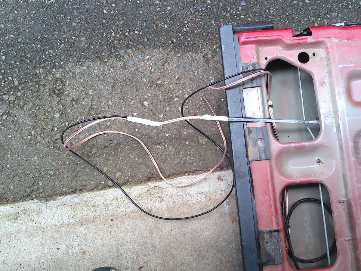

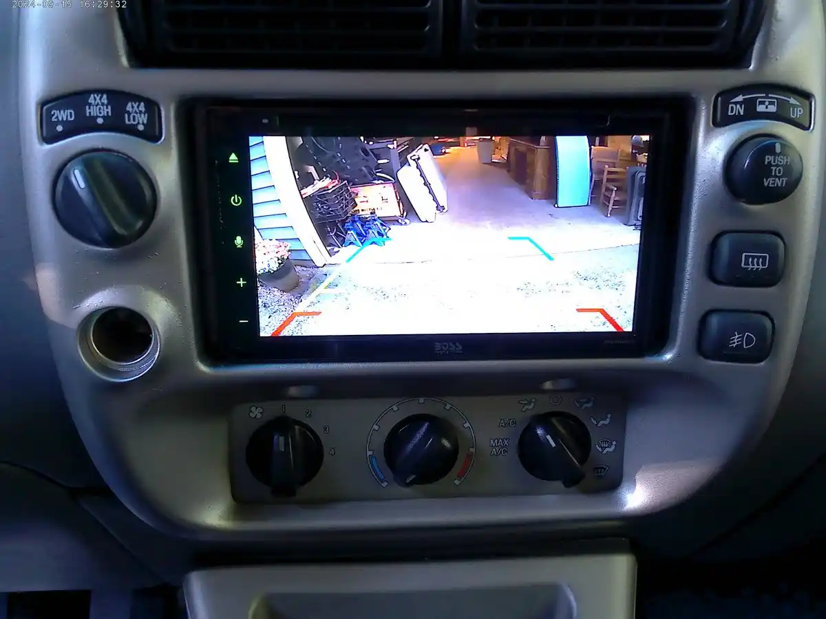

Finished installing the backup camera... punched a hole in the center plate and drilled a hole at the bottom of the tailgate...
DVDSWAN 02 Sport Trac Build/Maintenance thread

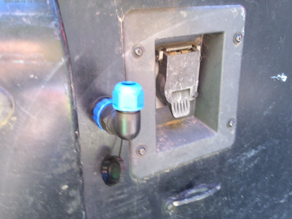

I bought some grommets to seal the bottom of tailgate and installed a weatherproof connector...
All connected up... I need to power it with reverse still.

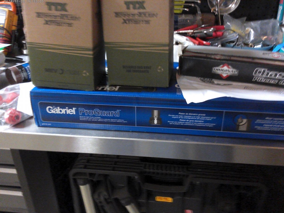

Bought some more parts...

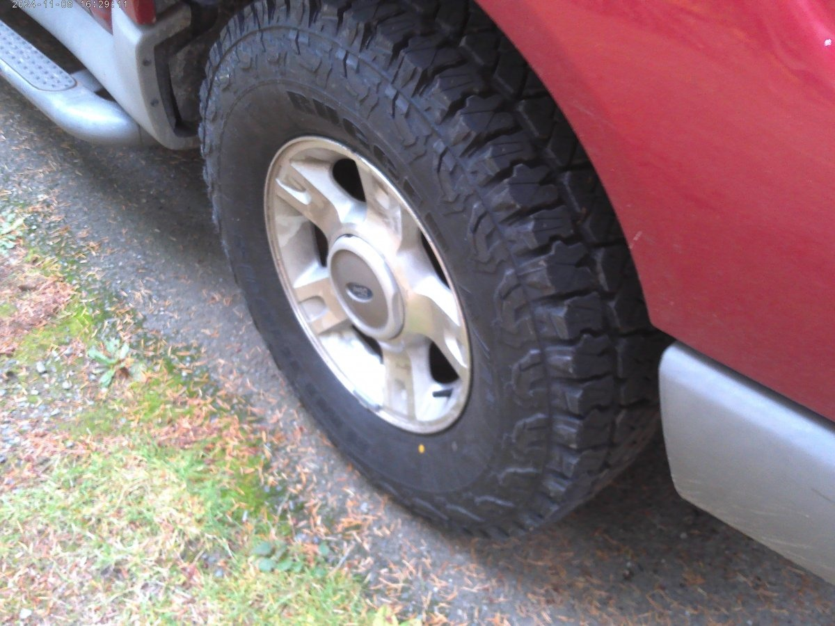

Tires - 265/75R16s Americus Rugged ATRs (Walmart.com made in Taiwan) 1st hurdle passed, they balanced fine. They're a 50k tire and they were on sale, so for the price which was over half less of what a BFG AT was I thought I'd give Wally a try. Aside from the time it took they (Walmart) did a lot of extra little details compared to the Discount or Les Schwab do. Cleaned mating surfaces, anti-seized the studs, cleaned the rim edge for weights, and had a 2nd person re-check the torque.

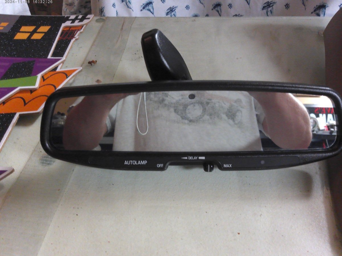

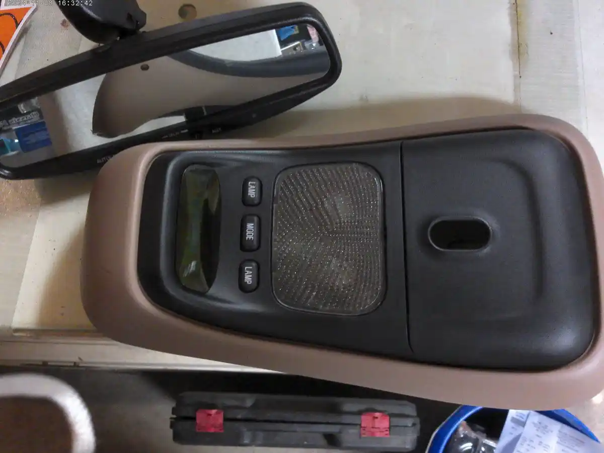

I put some highway miles on them and they are quiet on the freeway and a low rumble on the streets. Went to the j/y and picked up the overhead console and mirror.
I now have front dome lights again...

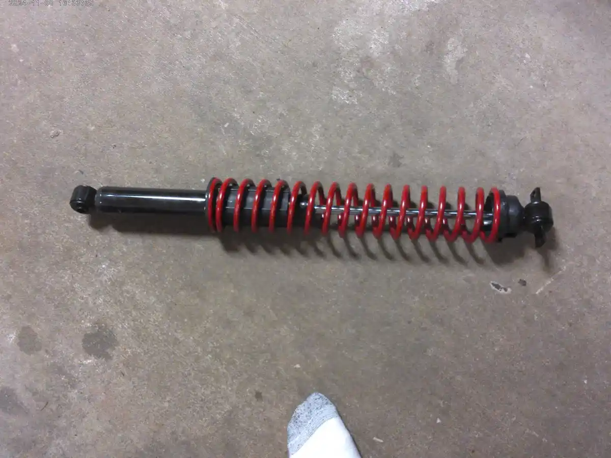

Rear shocks and sock...
Had a little rubbing in the rear with tires on turns so I bought some wheel spacers. They'll be here tomorrow, and I should have them install either Wednesday or Thursday.

Update on the radio install. Not happy at all with the BOSS radio. It has a very hard time connecting with phone. I would say about 75% it won't connect right away and take up to 30 seconds to connect so I have to have the phone on speaker to talk hands free. Would not recommend.

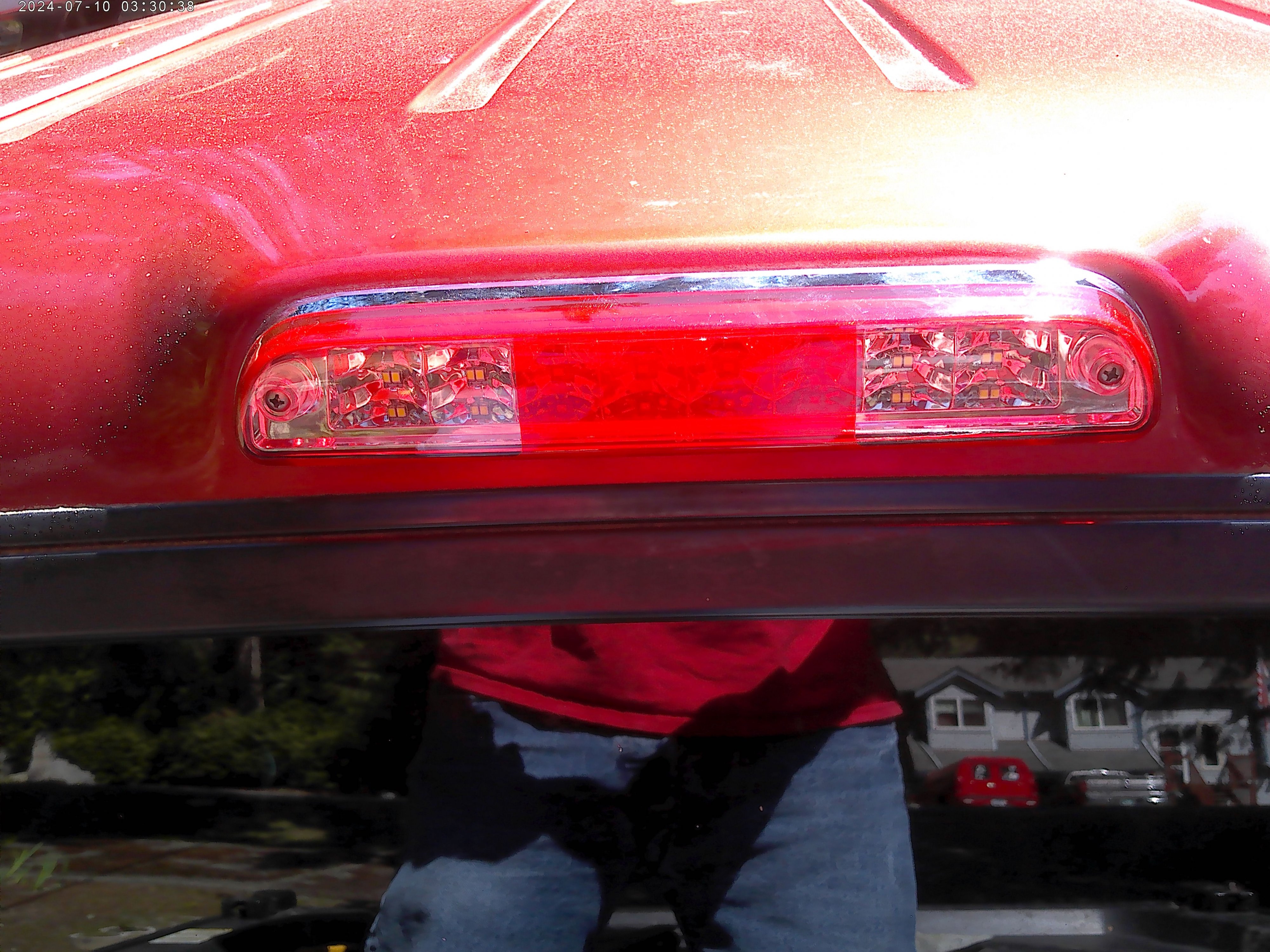

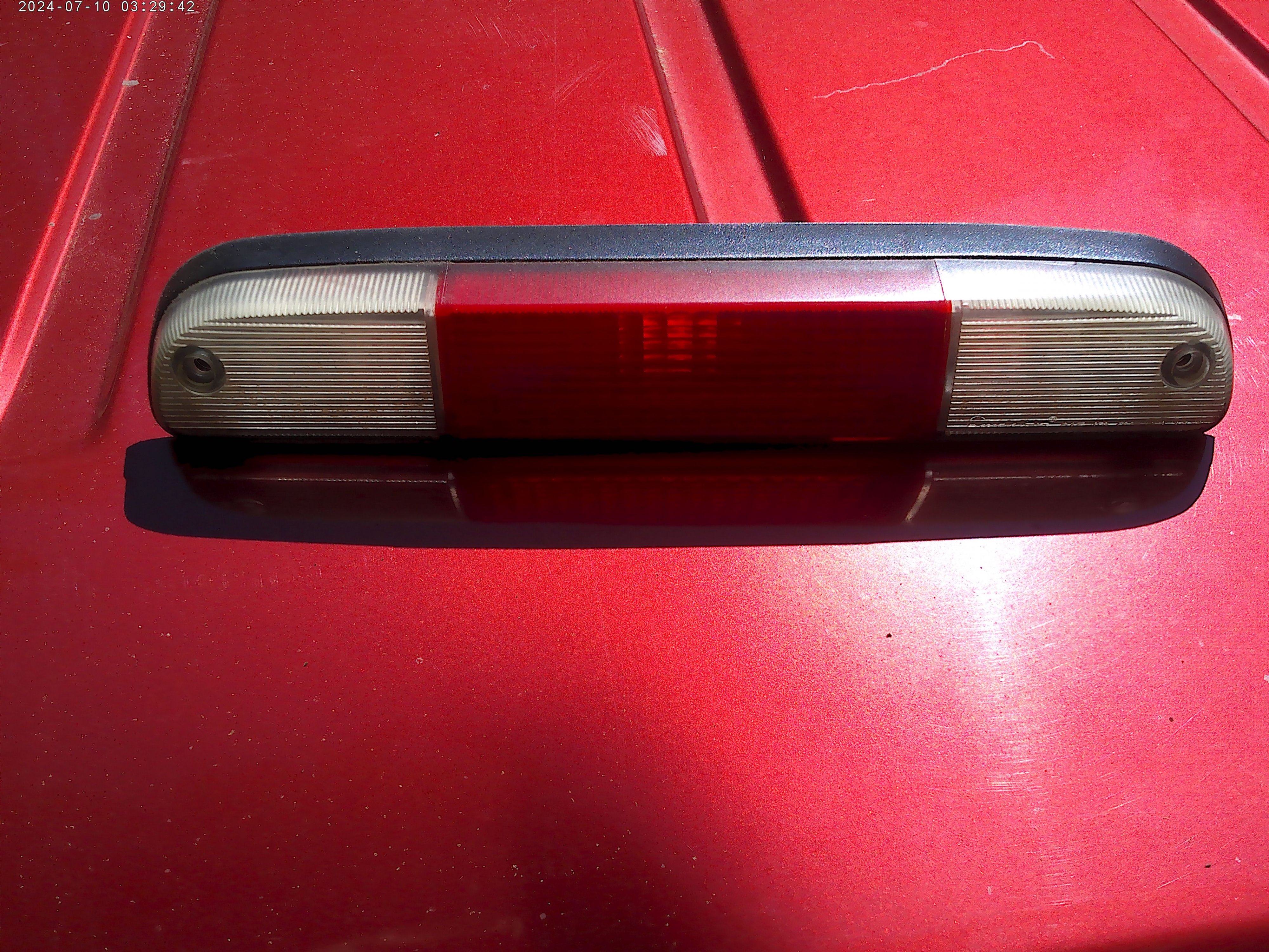

Installed a new 3rd LED brake light.

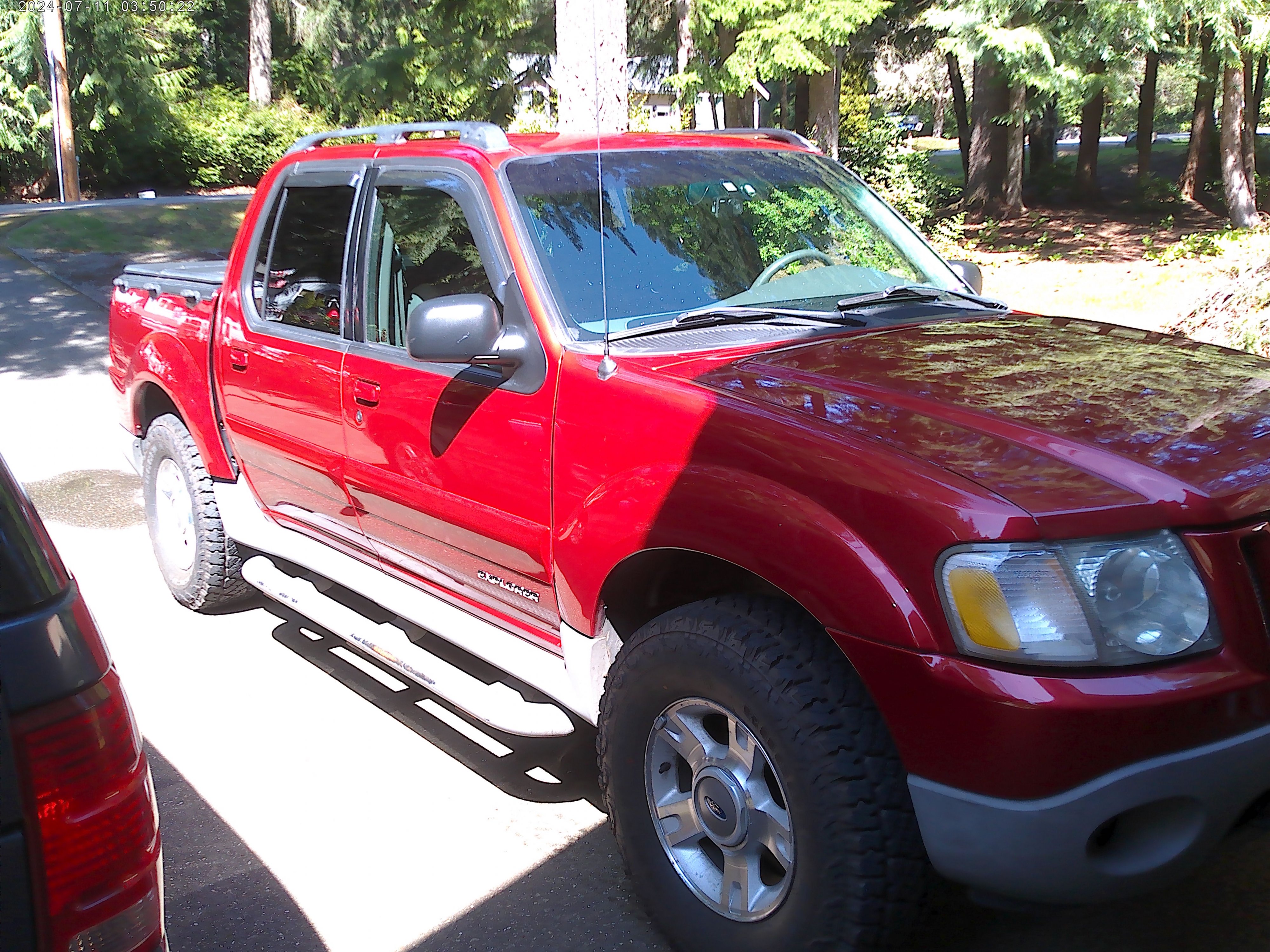

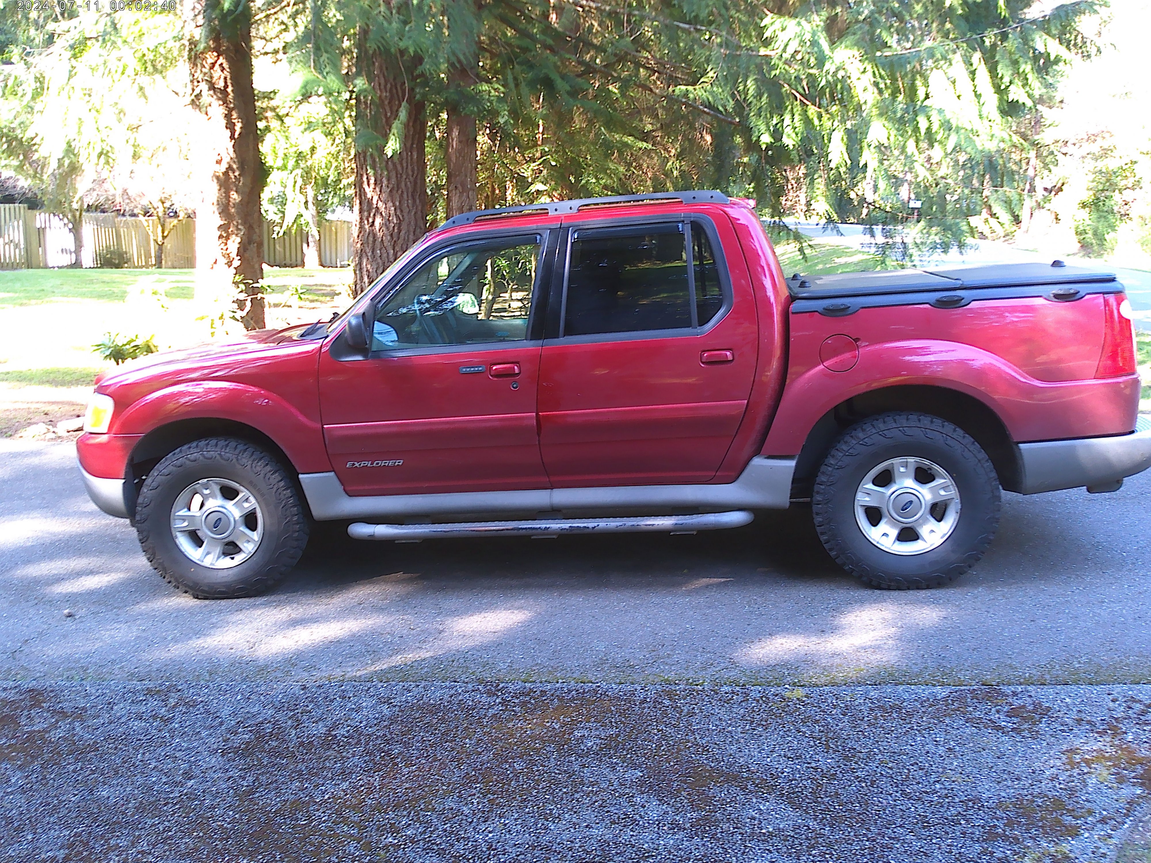

So, today I gave the ST some much needed love. Wash, rubbing compound, polish, and wax.
Before:
After:
Before:
After:
Before:
After:
Debating on buying new headlamp/turn signal assemblies or polishing them. Most likely will buy as the t/signals and dr. side h/lamp have moisture in them.
