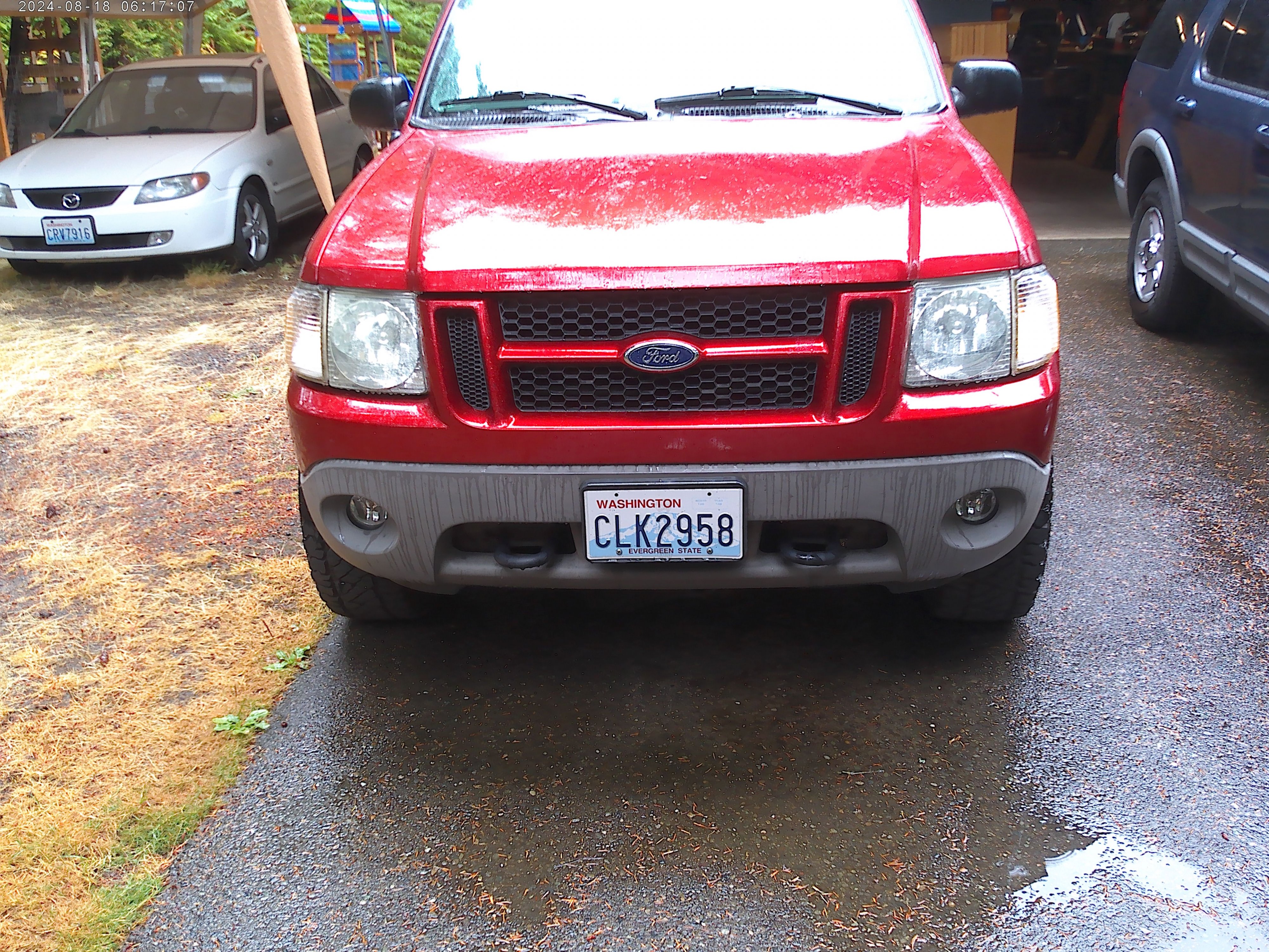

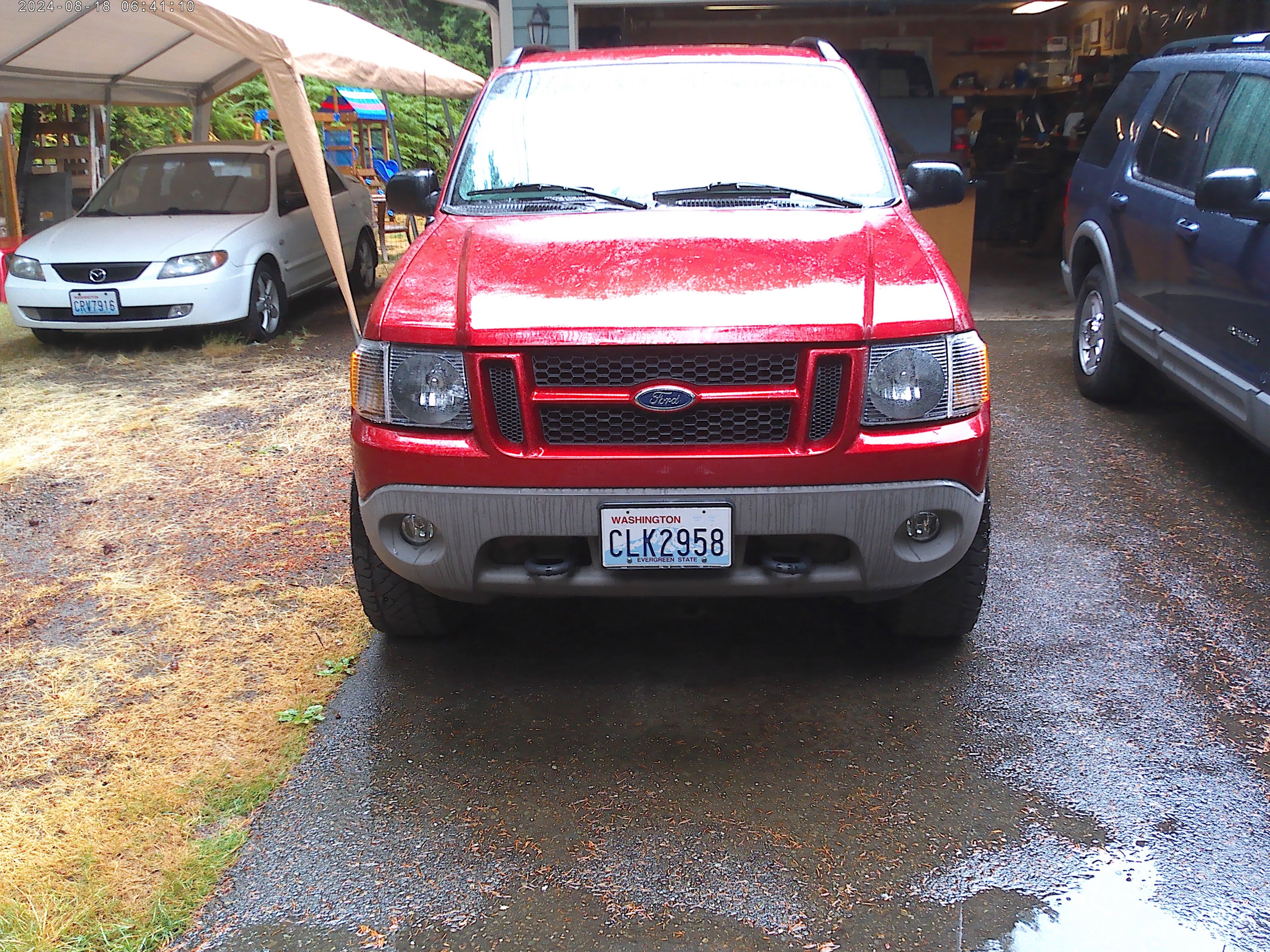

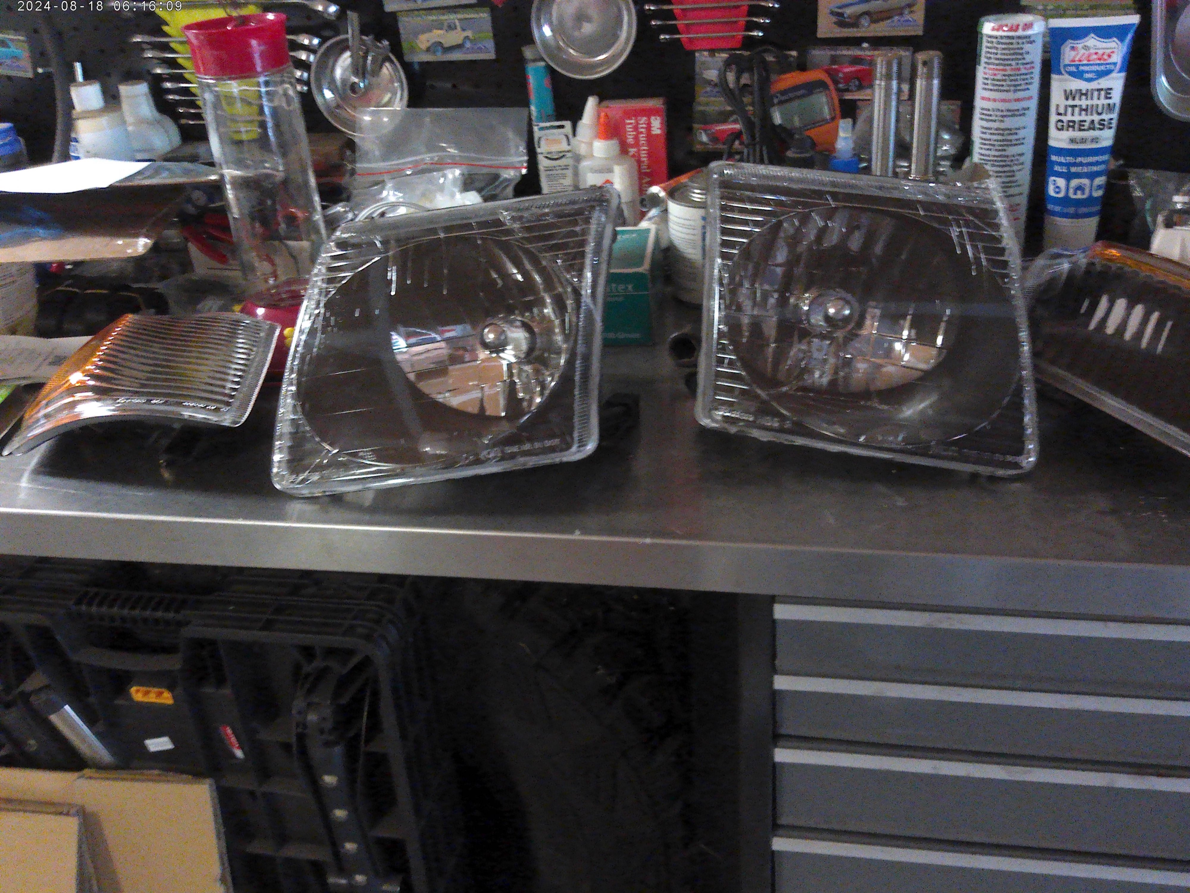

Nothing major today, just did upgrade to headlights. Maybe I'm just putting off getting under the truck because it seems to get harder to get up off the floor.
Before:

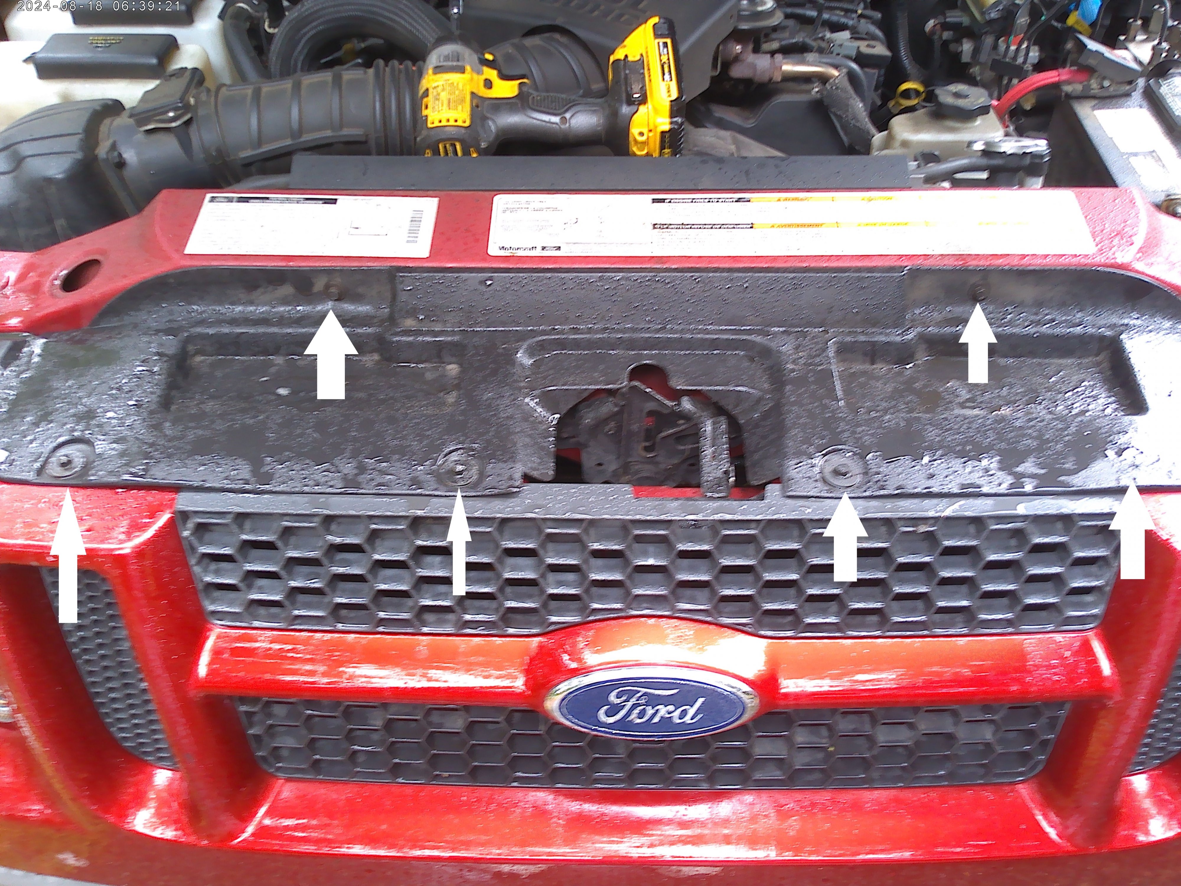

6 8mm screws (2 screws and 4 bolts actually) to remove the top cover...

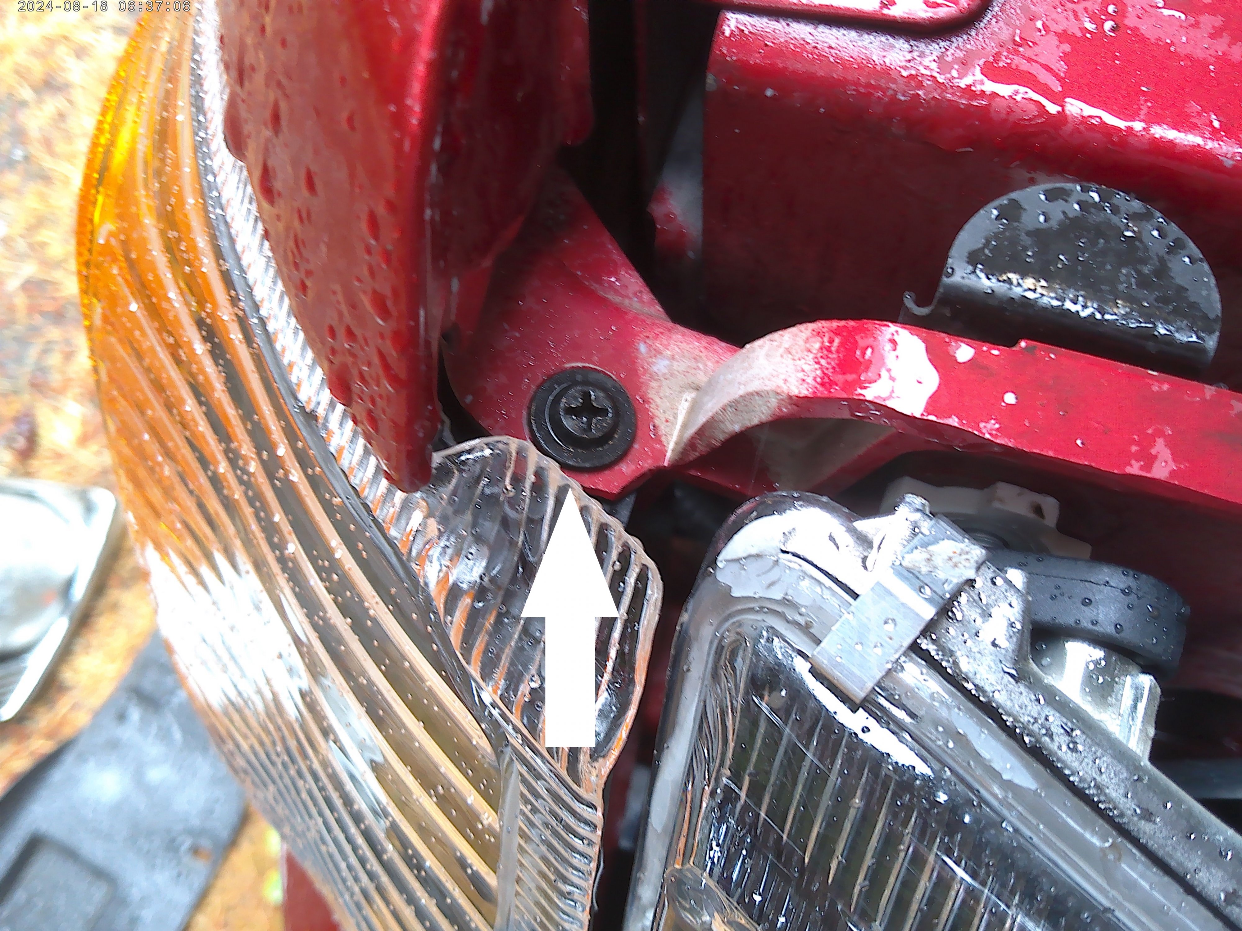

one screw for each turn signal then pull out the turn signal, be careful not to damage the 2 slide posts... disconnect bulb, it twists out.

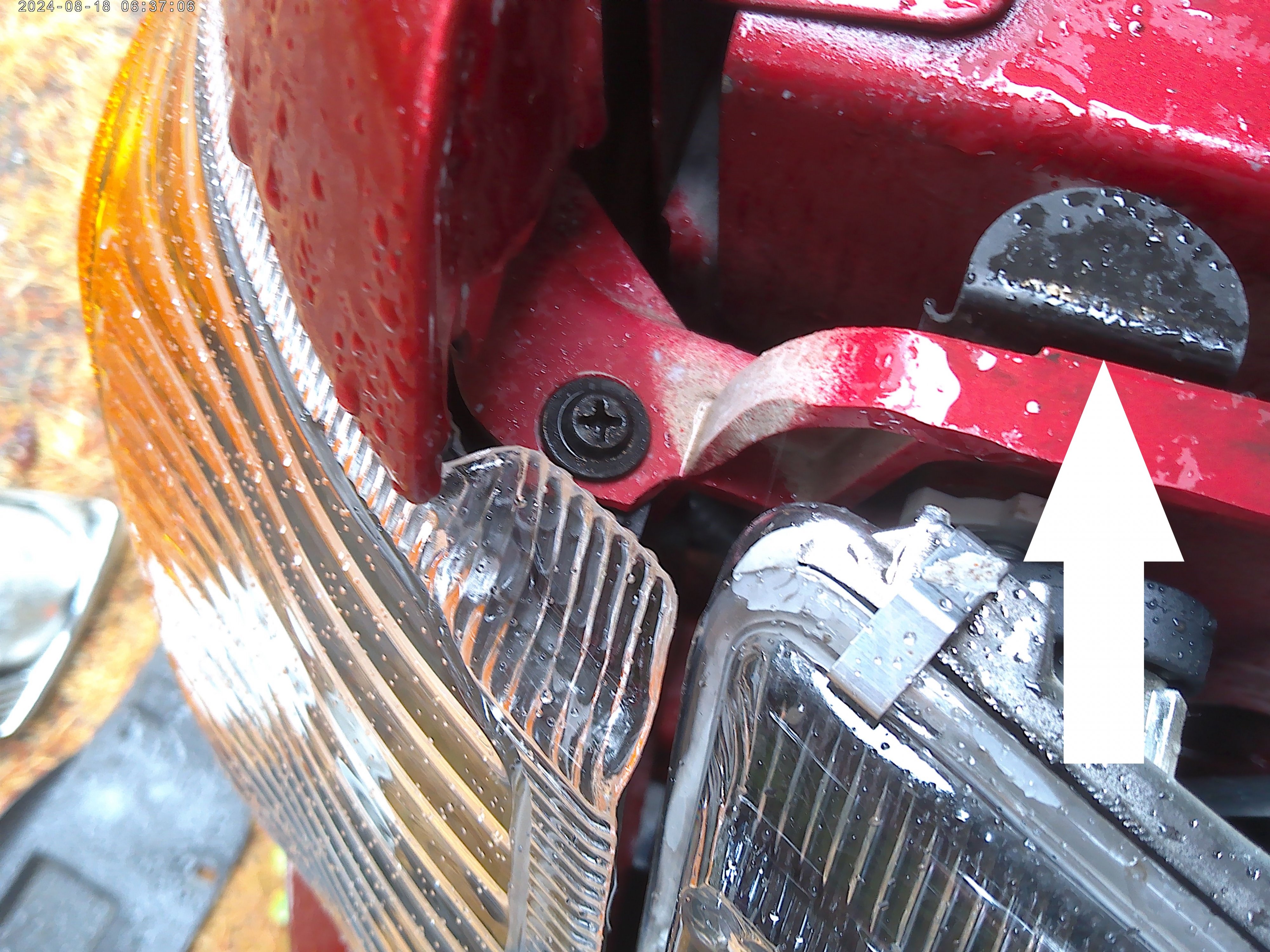

there are 2 slides for each headlamp assembly, that pull up that hold the headlamp assembly in. You can use a pry bar to assist you if they don't pull up with your finger. Incidentally, you would do this process to replace your headlamp bulb. Disconnect the connector from the headlamp bulb and the assembly pulls out.
Install is just reversed. Step back and enjoy your new lights. Don't forget to align them. I did count the threads which actually matched the new ones, but they do look like they might be high.

These are the headlamps, these ones come with new bulbs as well. The others are just housings.

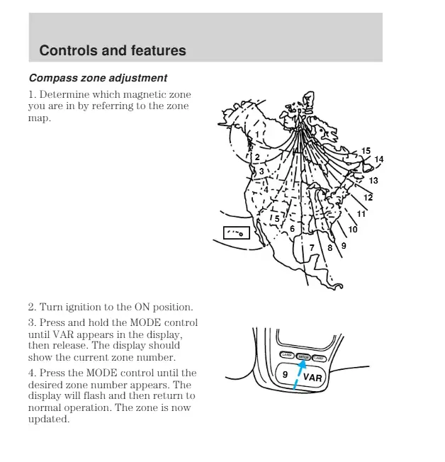

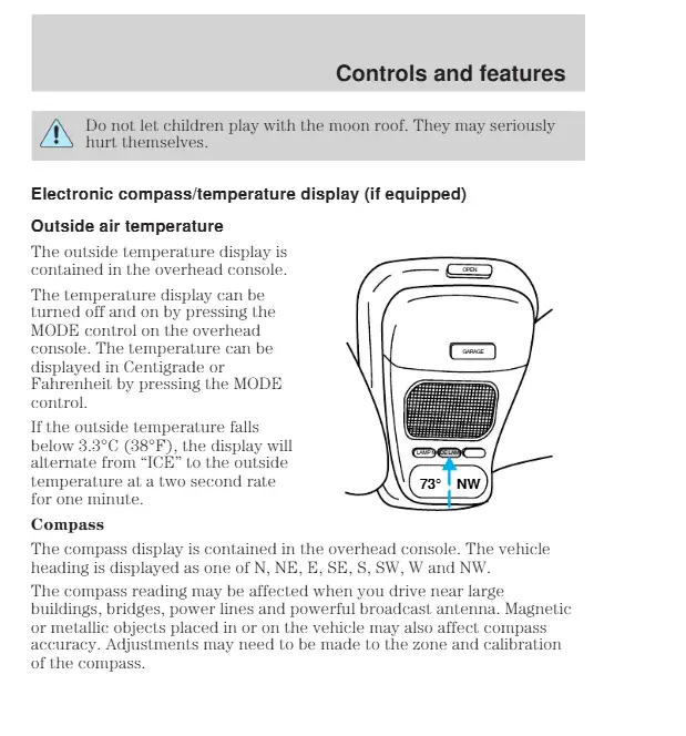

About 2 or 3 weeks ago I switched on the interior lights and the compass/temperature display went blank. Figured I look at one of the weekends coming up figure it would be a quick fix since I had a spare console sitting around from the wiring circuit I fixed some time ago. Replaced the board for the overhead console on Saturday with the extra one I had laying around. Display works now, just need to open up the TM and do the calibration for it. I did see videos of loose resistors and all that. Unfortunately, none of the resistors were loose and did appear to have a complete connection.
And after a quick search I found the "How-To" in the owner's manual.
