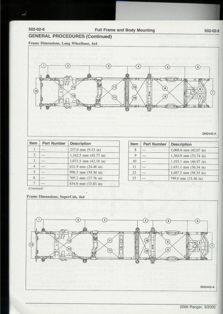

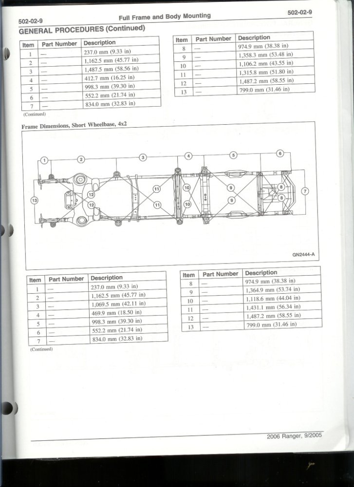

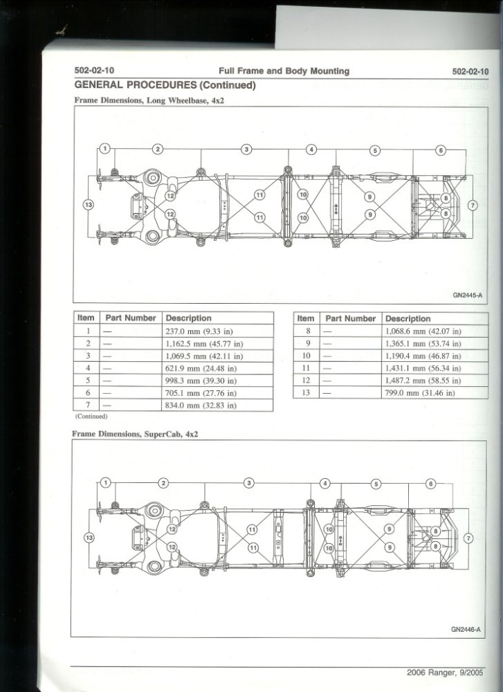

Where and how does one obtain a drawing of the frame for 1998-2011 Ranger regular wheelbase (111.5") and "long bed" wheelbase (117.5")? I have some CD's that contain shop manual stuff but a real engineering drawing would be a great addition. Any and all suggestions greatly appreciated.

diyoffroad.com has a scan cad file of the ranger frame as you can see in some of their product renderings. as they are a DIGITAL product seller im willing to bet theyd sell the frame scan cad files!
