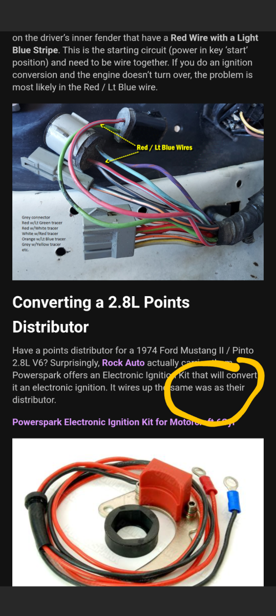

I noticed 2 spots that may need clarification.
The first is "them". Which them specifically? The distributor or the kit?
Distributor option
And the second is the "was as". Is it supposed to be "way as"?

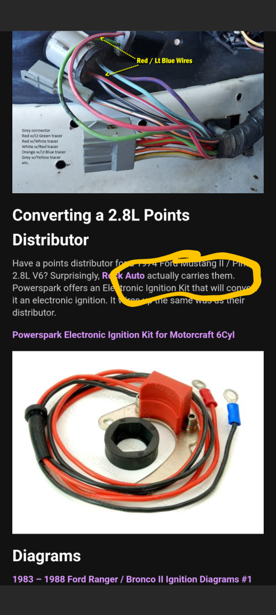

My understanding is that the Powerspark distributor works in the 2.8 and has a built-in ignition module. If true, then it would seem to me that you could replace the Duraspark conversion by using a Powerspark distributor, a coil, and a 2BBL carb. I've been waiting for someone to actually do this, share some photos, and confirm it.

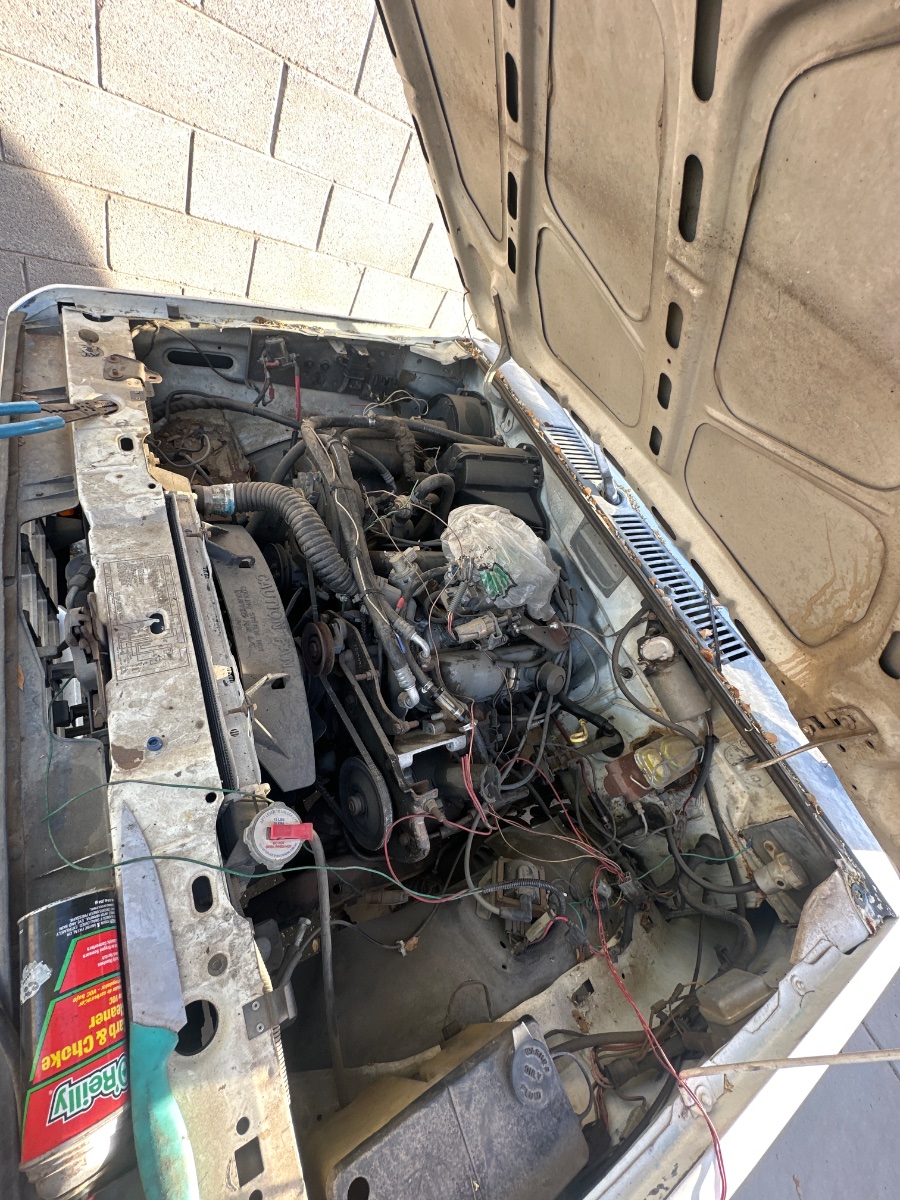

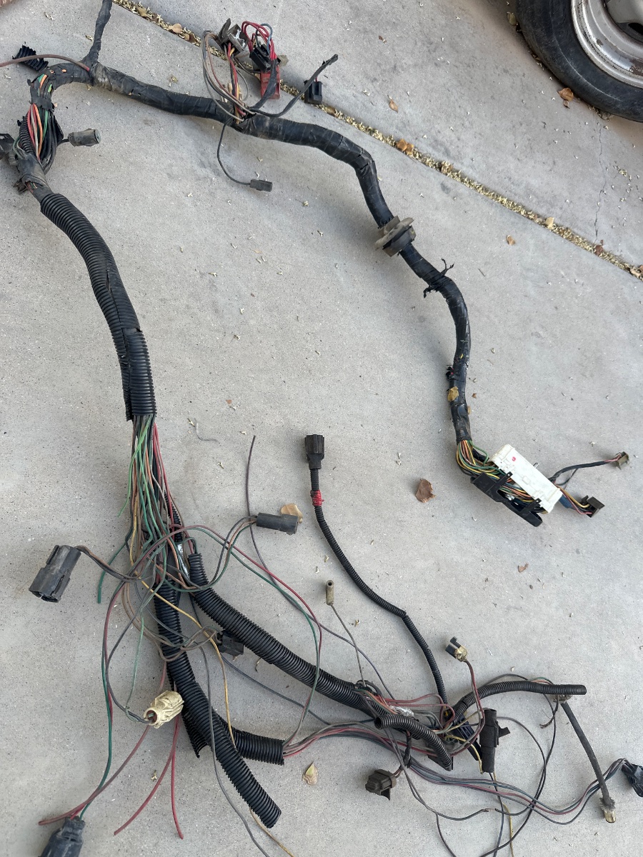

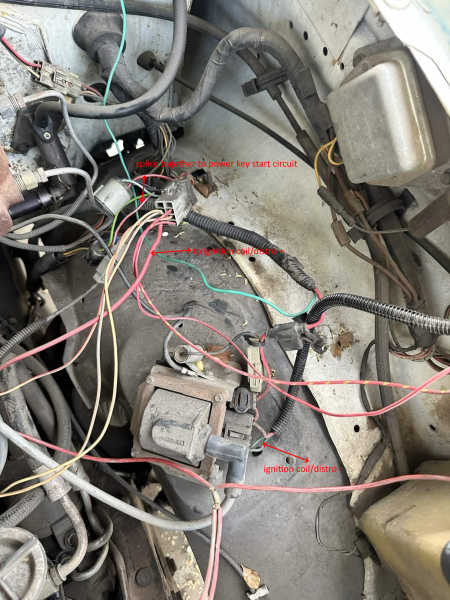

Agreed, ill worry about that later. I finally ripped out ecm and wiring harness, i cut length to most of the wires just in case. Does anyone know color codes for the oil pressure sensor and coolant temp? I wanna make sure that still works. There was 2 plugs next to the ecm plug that went to relays of some sort, no idea what for. The climate controls i think were on their own circuit and harness? Either way i can always rewire and fix what doesnt work.

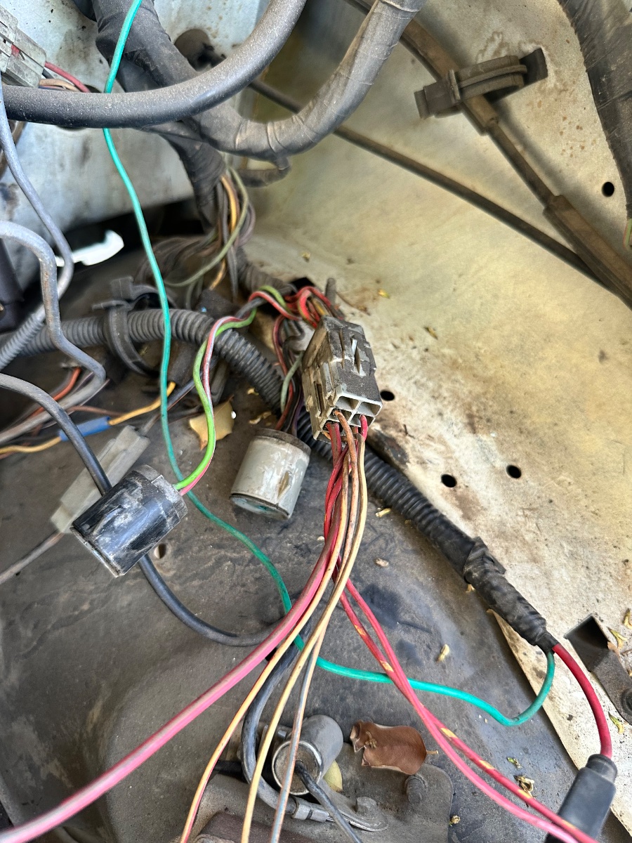

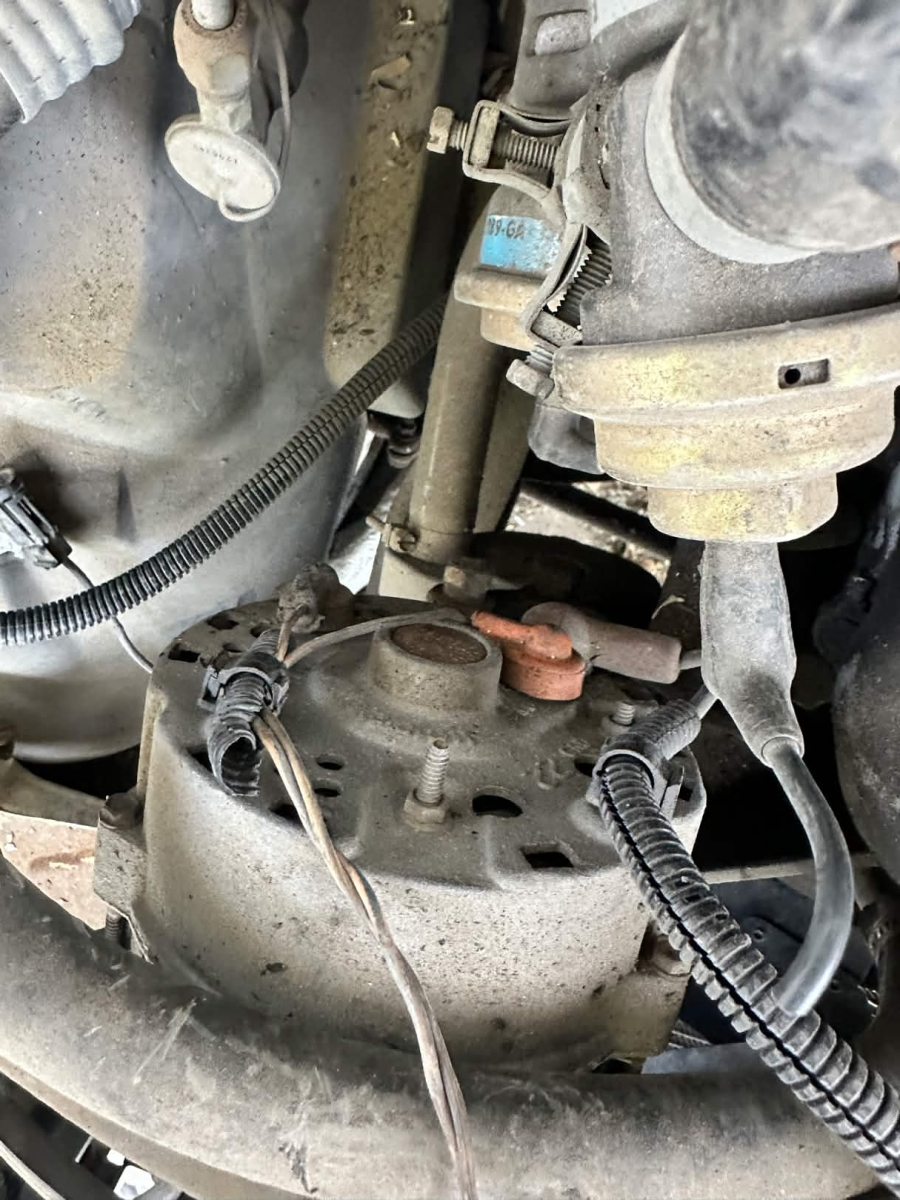

please verify this is correct, if possible whats the other color codes for or do i worry about for temperature/ pressure sensor to keep cluster working?
Distributor option
what are the other posts for besides the 12v constant one? will be swapping alternators later on that will remove this mess of wires also. i only need 12v ignition and constant lmao.
Distributor option

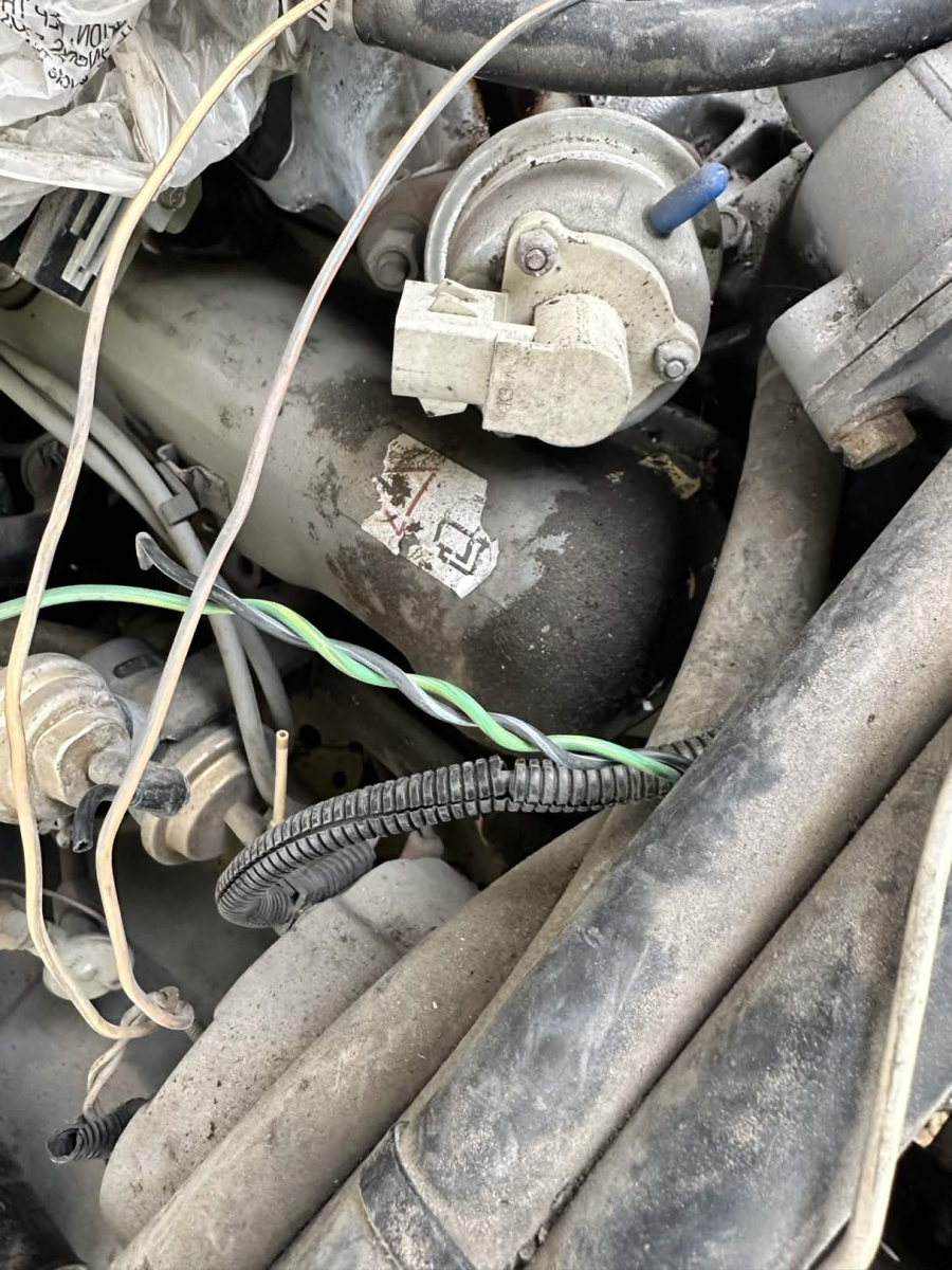

is this bright green/blck wire for ECM data for engine temperature ? or is it actually the temp sending unit? only things im confused about.

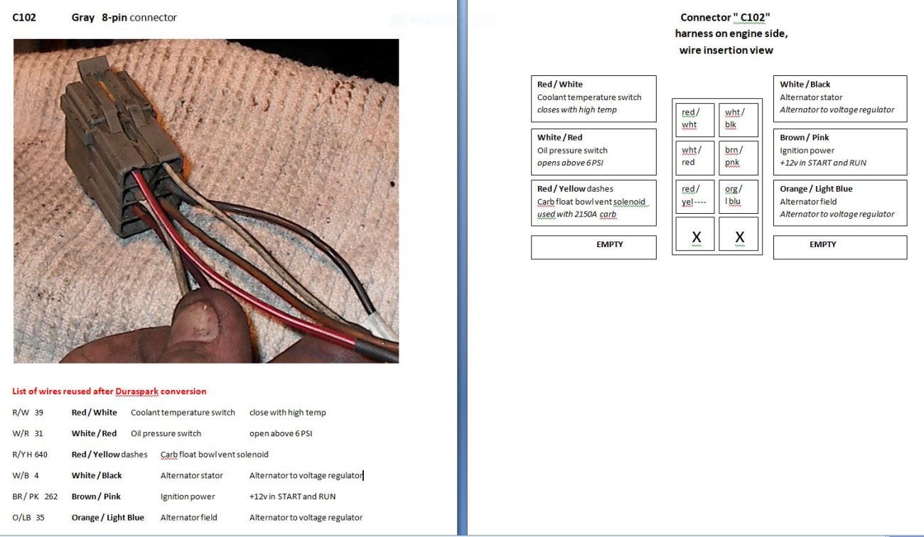

Mine was Red/Wht coolant temp and Wht/Red oil pressure.
Here's what I have from my conversion years ago, but note that this is an '84; maybe your '85 has the same C102, and the pin-out and wire colors are the same or close enough.
Looks the same will use for reference thanks!

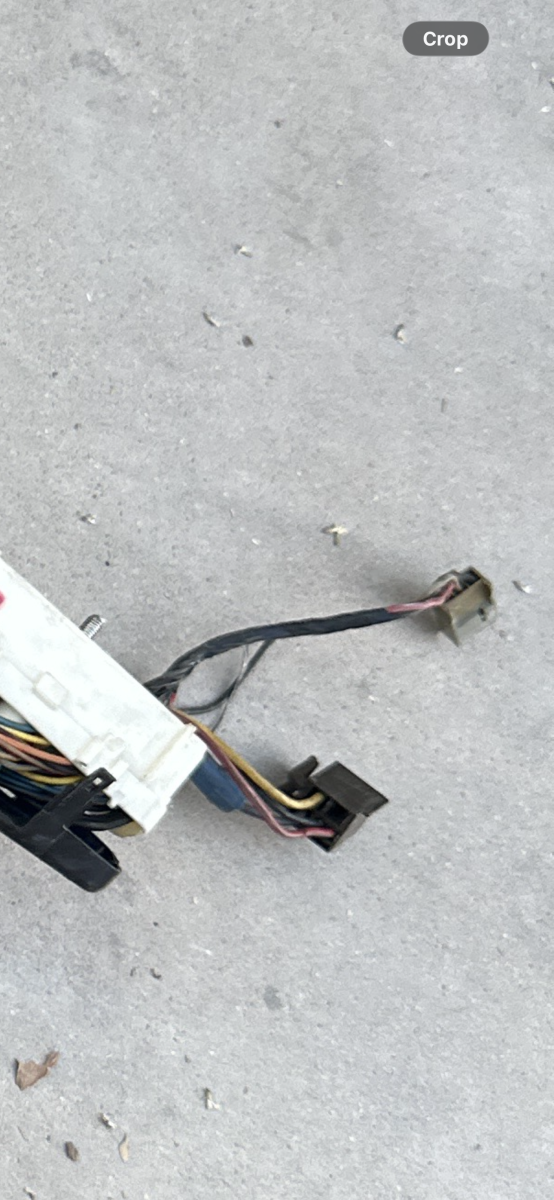

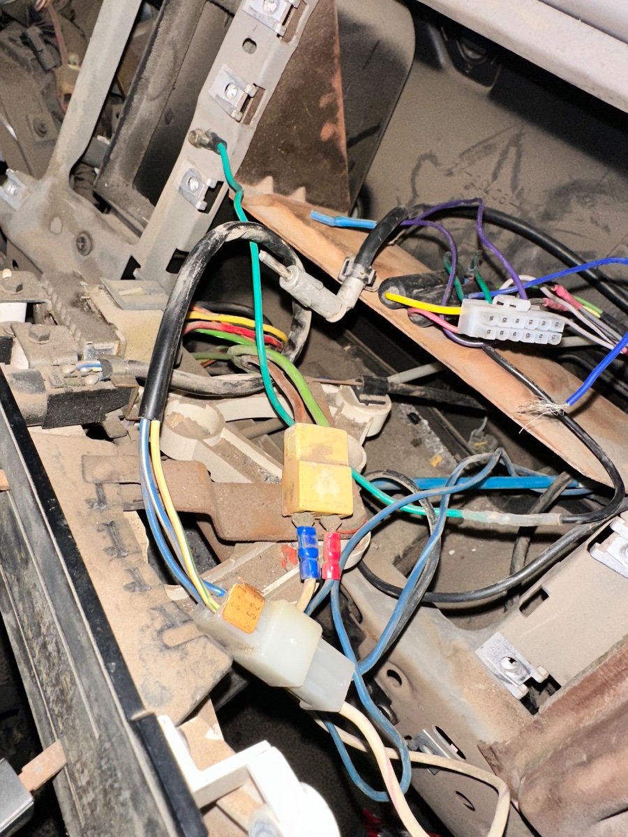

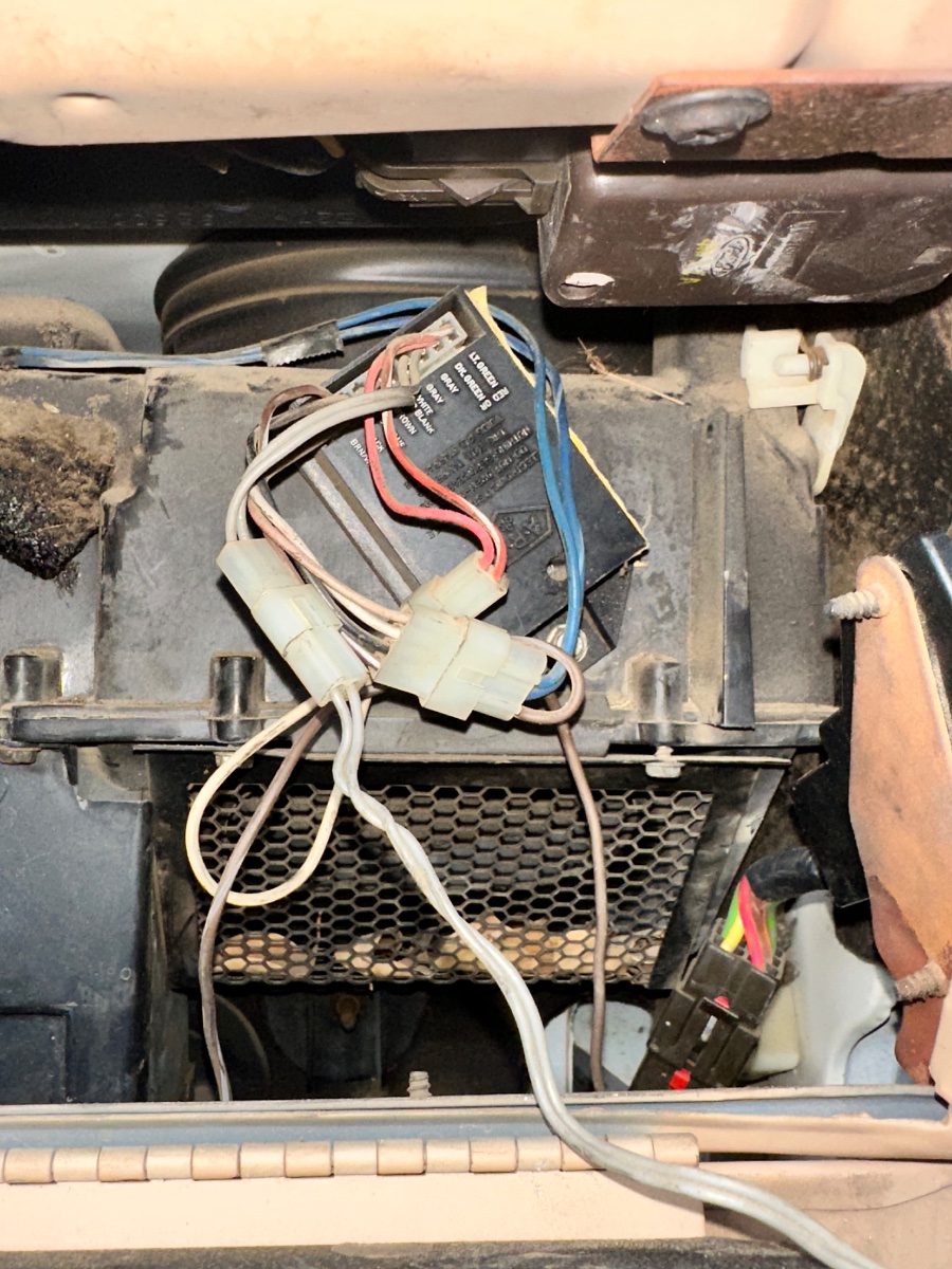

Is this even factory 🤣 ? Do i need to worry about the harness thats goes to a relay next to the ecm connector? Whats it for? Theres two.

Your big pic is factory connectors. What they are escapes me at the moment, but I think off the top of my head that it's for the ECM power relay. No more ECM, you won't need an ECM relay anymore.
In your small attached pictures, I strongly suspect that your truck had aftermarket air conditioning installed. That's definitely aftermarket connectors around the HVAC control head, crimp-on spades stuffed into the OEM blower connector, and the AC switch looks added. That aftermarket controller behind the glovebox / kick panel looks to have an "ARA" logo on it, which jives perfectly with aftermarket air.
As deep as your diving in that truck's electrics, grabbing an EVTM off eBay would pay for itself. Luck, or patience, will usually get one shipped to your door for $20~30.
Okay thanks! Ill keep that relay and use it for accessory power later on (equipment, fans, leds etc)
Yeah i realise my ac isnt factory, seeing the wiring slop. been tough finding the correct ac compressor since its missing but after searching around it looks to be a sanden sd709 type. I should have this project in the bag, not too difficult so far. I pretty much got all the info i needed now. 😎
On mine those have nothing to do with the ECM and came out of the dash harness on the DS.

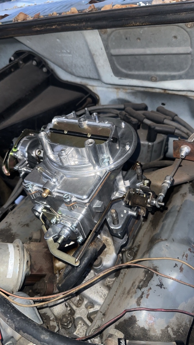

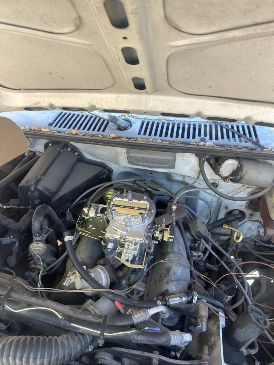

china carb has arrived. this is gonna be fun.

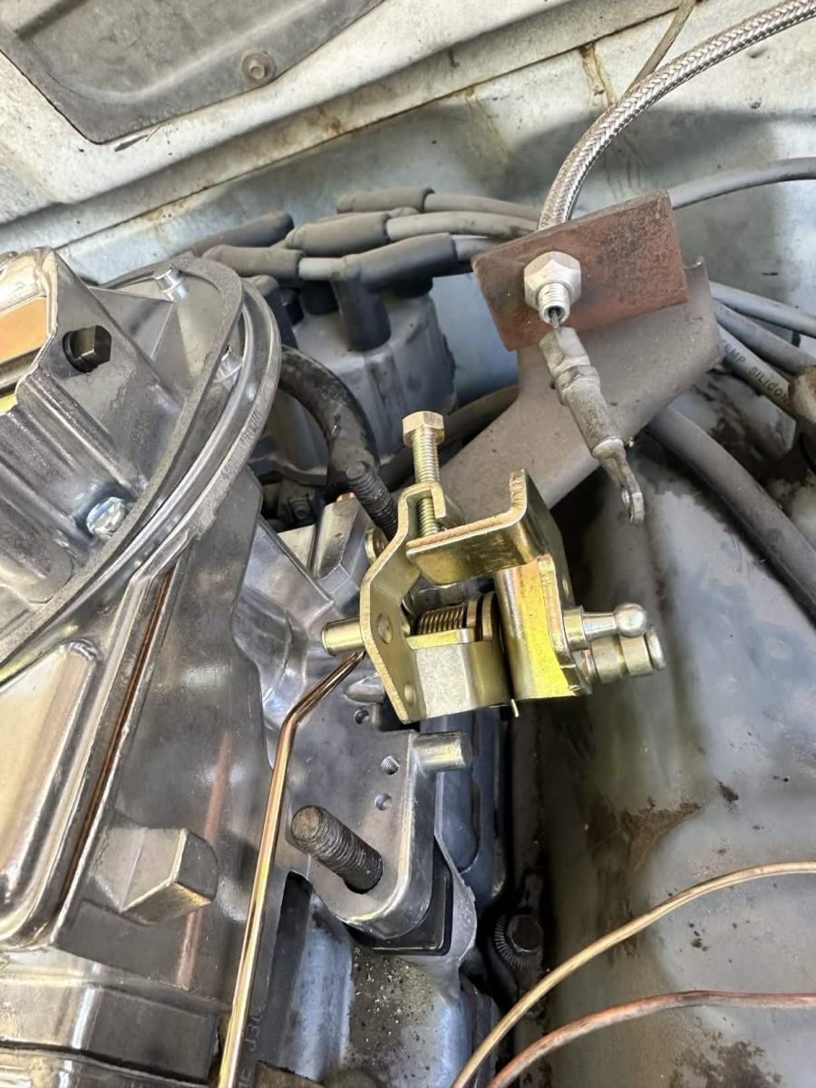

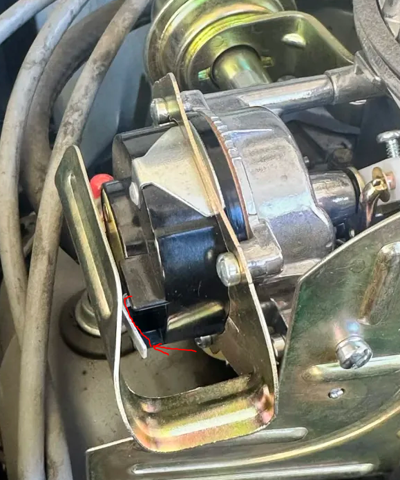

there is this adjustment screw thats attatched thats just dangling, how is it even supposed to be mounted? the throttle cable doesnt fit the pin, how can i go about this?

is this pin the 12v signal for the electric choke?

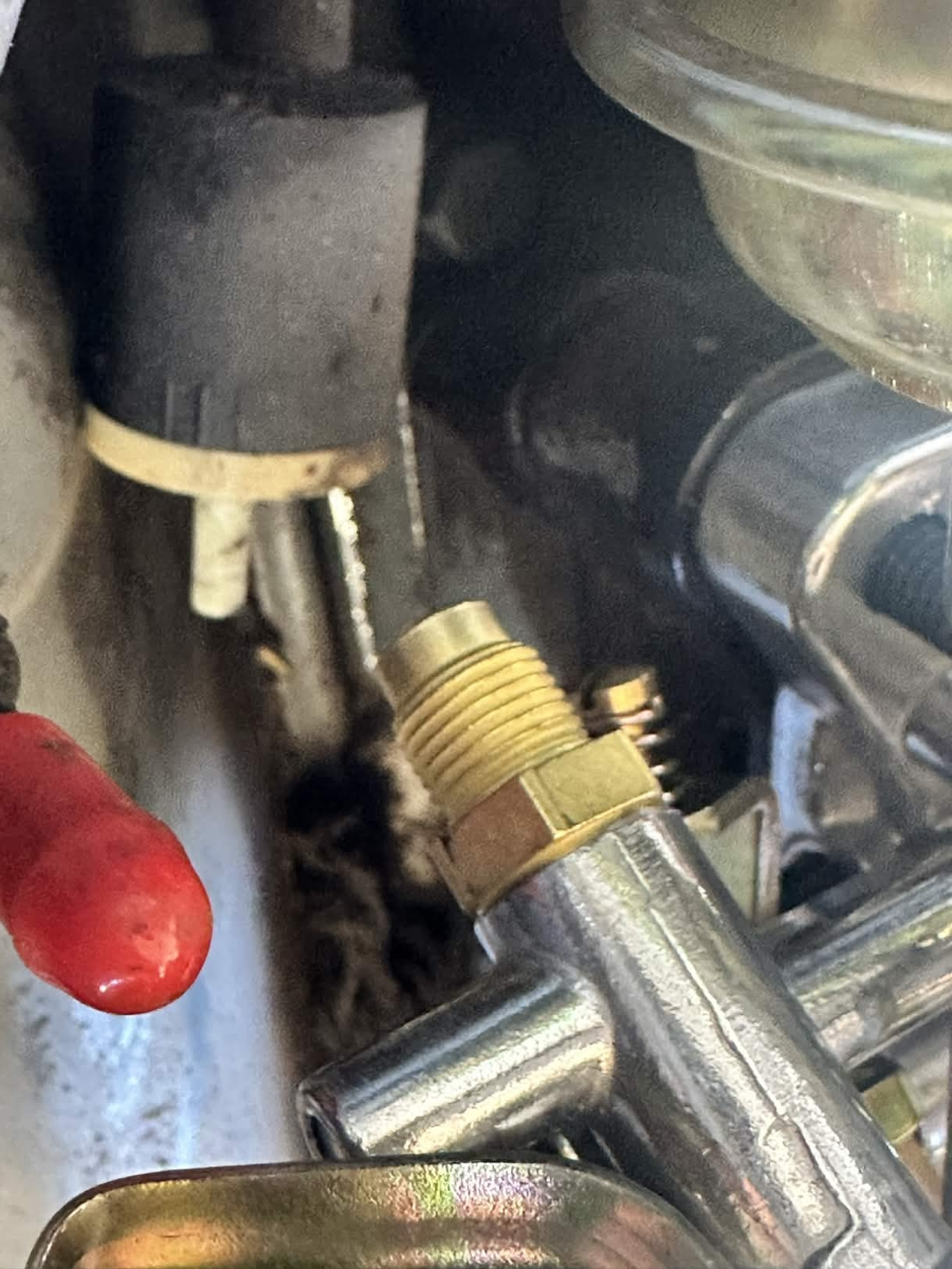

it also has a spout behind the electric choke, where does it go to, whats it for?
Nevermind i got the throttle cable worked out. Just swapped over the assembly from the old carb.

Electric choke will pull 12V from the alternator or a key on engine running source.
The threaded part is probably another choke option that your vehicle doesn't have. I would cap it. Before electric chokes they would pull a vacuum on the choke and there was a passage that would pull air from under the intake. As the air warmed up the choke would open.
