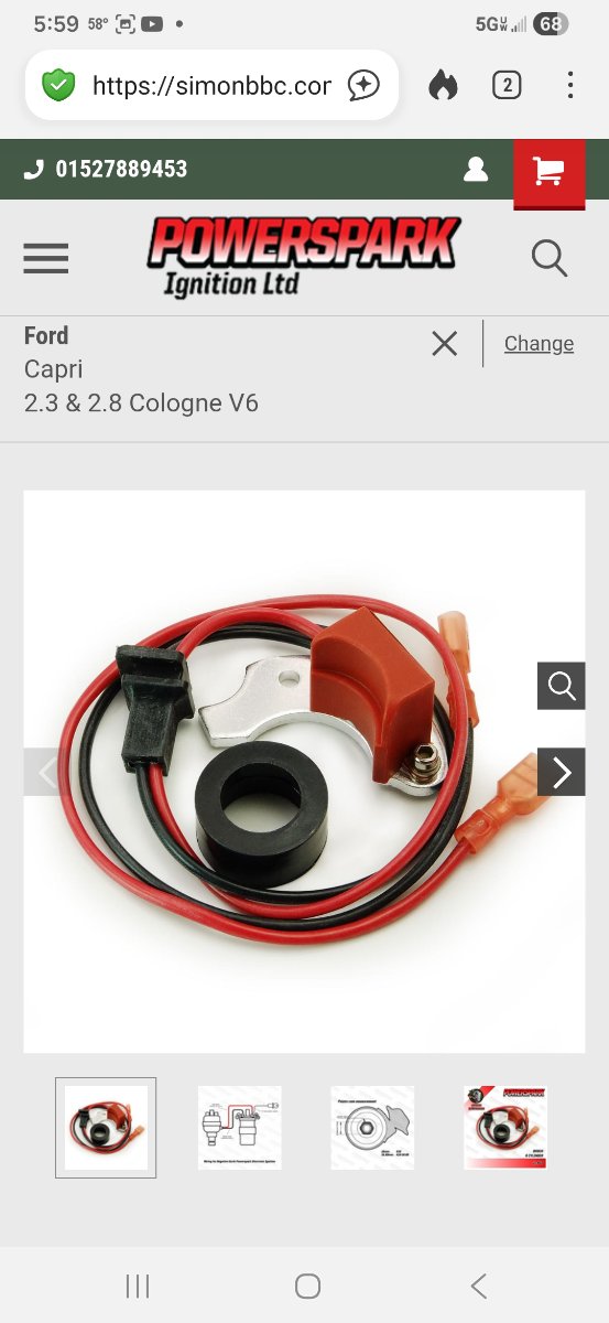

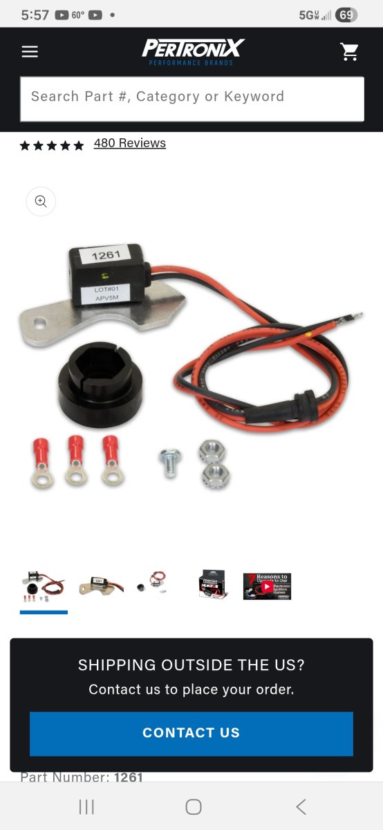

Both seem similar. And they both work with a magnet.

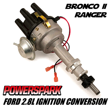

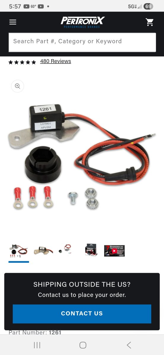

That particular pertronix does not fit either distributor that i have. The power spark distributor looks to be a copy of the bosh that I have.
Just waiting for mon morning to call pertronix to see what will work.

Pertronix instructions show coil resistance should be around 3ohms.

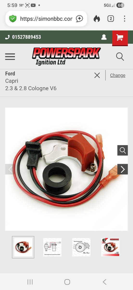

Powerspark instructions say more resistant than 1.5 typically around 3ohms.

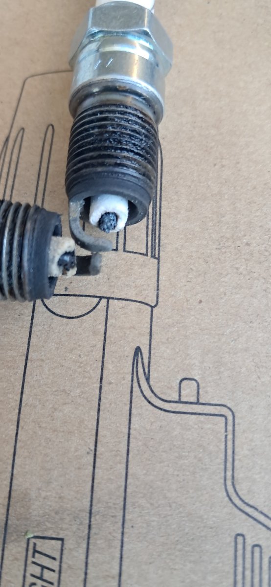

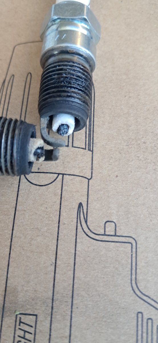

BUT, a buddy mentioned.spark plugs,so know #1 was fairly new I started with 2 and 3.
And find this,
Electrodes burned off and guessing it got hot enough to break the porcelain.
  • Distributor option

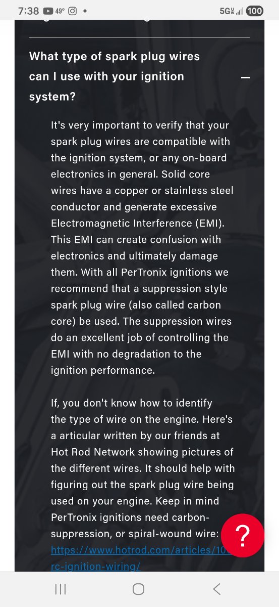

That got me looking at the wires I bought and they turned out to be solid core wires.
The system requires suppressor core wires.
So new plugs and proper wires and seems to be good.

So, this is a Powerspark distributor and not a points distributor with the Powerspark points conversion kit right? And you destroyed the plugs from using solid core spark plug wires?
That is interesting, Petronix wants solid wires.

Yes .this is still the powerspark complete distributor from UK.
I am ASSuming between 1.5ohm coil and solid core wires i had a meltdown of 2 plugs.

That's not what their website states.
It looks like the newer ones want resister wires lol.
