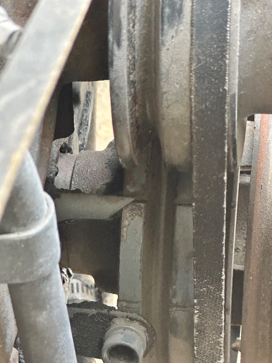

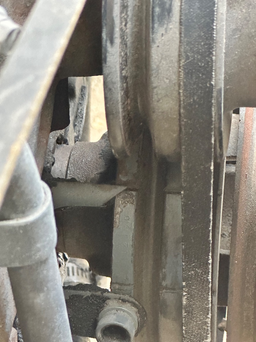

Aye so what do the timing marks mean? I turned engine clockwise facing the pulley until air was pushing out of cyl1 , stopped at first mark. There is a 2nd mark if i keep going. Where do i want this for initial start up? I can kinda see the measurements on the pulley.

If you look really close you will see some numbers stamped into the metal. Those numbers are the btc, (before top center). You want the pointer at 10°. Use a paint marker or felt to mark the 10 degree.

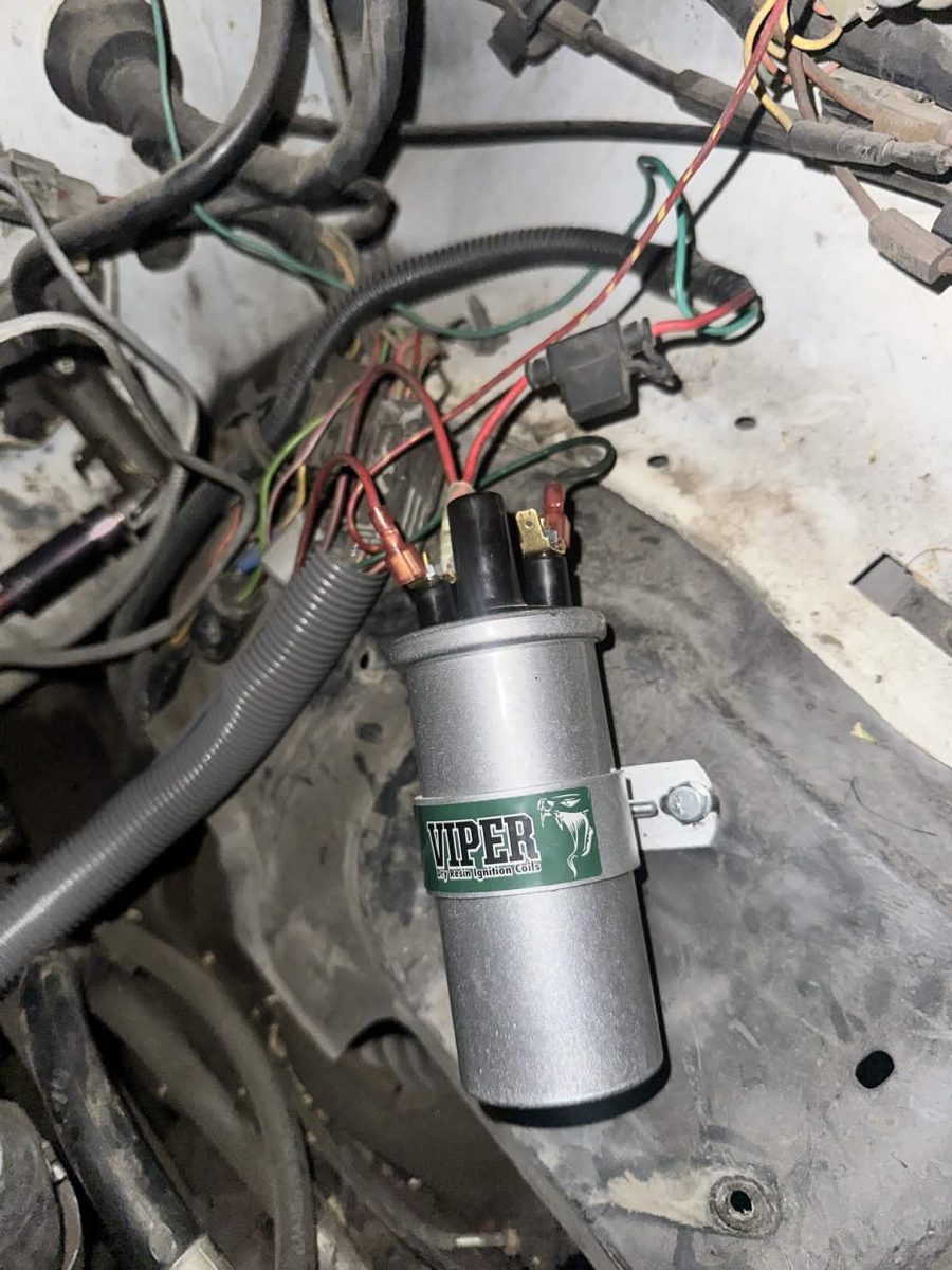

And got it, tommarow i buy timing light, will report back how it goes. Viper ignition coil is here too so alot of the wiring mess is getting cleaned up.

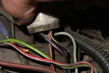

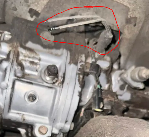

can someone verify if the purple/orange & black ?pink? wires on the round plug is for the backup lamp switch , its on the side of the transmission right?

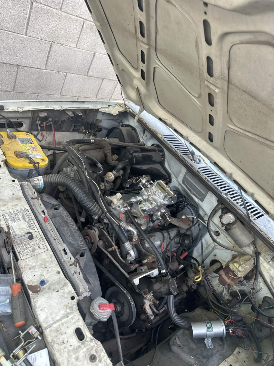

engine bay looks so much better, let me know what you guys think. so far only thing thats hooked up to the carb at the moment for initial startup is fuel inlet, manifold vacuum in the rear, theres only one port on the front of the carb, not two like the original, let me know if its fine to keep it plugged since i assume its for emission stuff like rest of the ports. PCV is hooked up to manifold vacuum, and the vent hoses ill just route to the charcoal canister to keep it somewhat alright.
+ if anyone can direct me the proper way of routing my fuel inlet, i'd prefer to keep the lines metal in the engine bay for safety but as of now im just using regular fuel line + 2 inline filters (need to clean tank)
