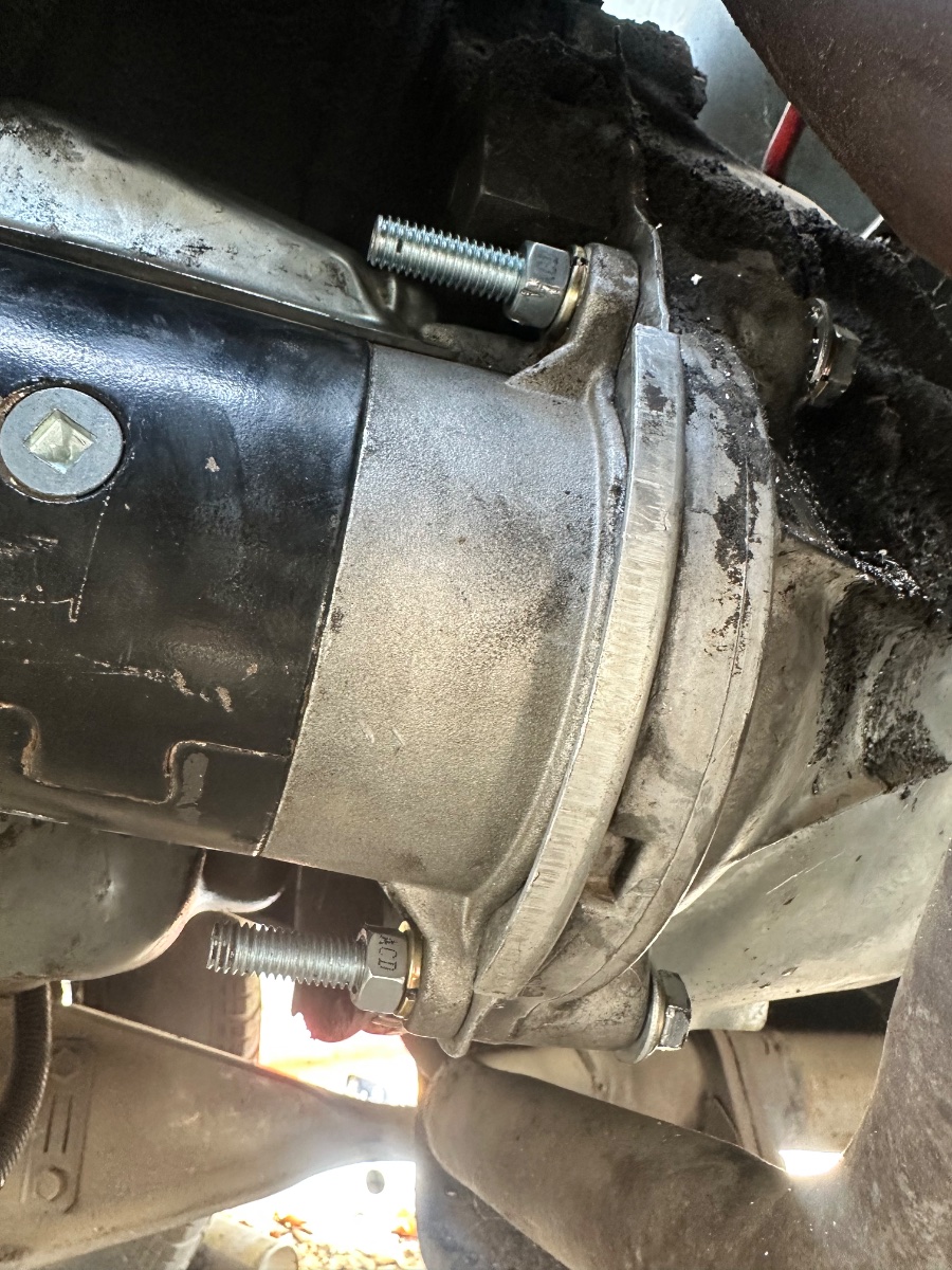

The aluminum plate is fine as far as I can tell I’m pretty sure my problem is the weak threads on the bell housing so my starter isn’t close enough to the flywheel. This has been an ongoing issue. I remember having a crawl under the truck and tighten the bolts and it would work for a few cranks. just now I tried repairing the bell housing threads and when I went to put in the bolt, it ended up snapping inside, so then I had to drill that out and ended up just making the lower bolt hole through and through.
The upper mounting bolt I’ll probably do the same thing, and use nuts and bolts and lock washer. If this doesnt work, then im changing out the starter drive gear to the 10 tooth like everyone suggests.

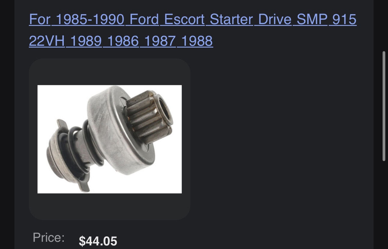

I ended up replacing starter gear with a 10 tooth one from a Ford escort and it fixed my issue no grinding or anything now. Even with a worn flywheel.
Also, before I did that work, I think maybe it was coming loose. The bell housing threads were weak so I ended up just drilling them both through and utilizing a nut and a bolt with lock washers

Rockauto has em cheapest however they do not ship to Arizona. 44$ including shipping. Sure beats buying a new starter

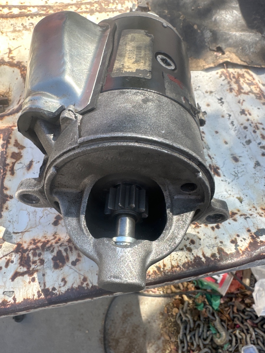

3. Locate 2 10mm screws on the back of the starter housing, removing them will allow you to take the starter apart. There will be o-ring and washer, you may have to remove it to take out old gear, I had someone help me with this part (I dont have oring pliers)
4. Remove the shifter lever fork and the bendix and replace and assemble accordingly.

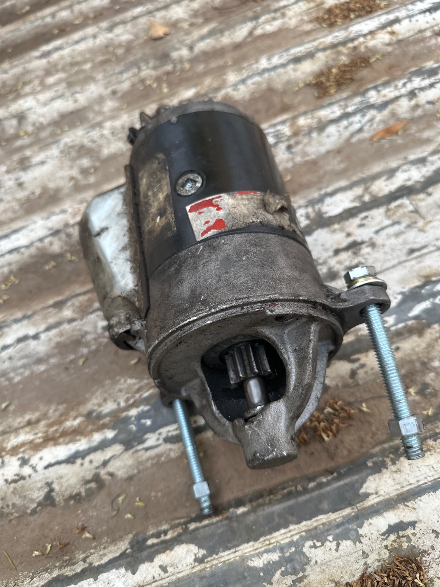

Is that a before and after of the bendix (gear) on the starter?
Old gear is photo with starter and mounting bolts.
Can you give me a link to the starter gear? I can't find it anywhere.
