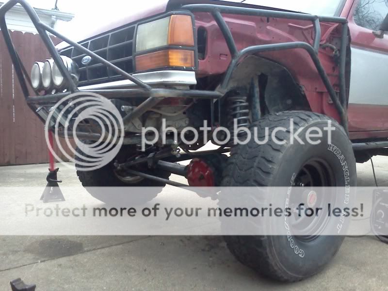

Looks good, are you going to do anything to get your steering up a little higher?
Once I get everything the way I want it, get a locker, and possibly some new rubber, then I am going to look into some high steer brackets.

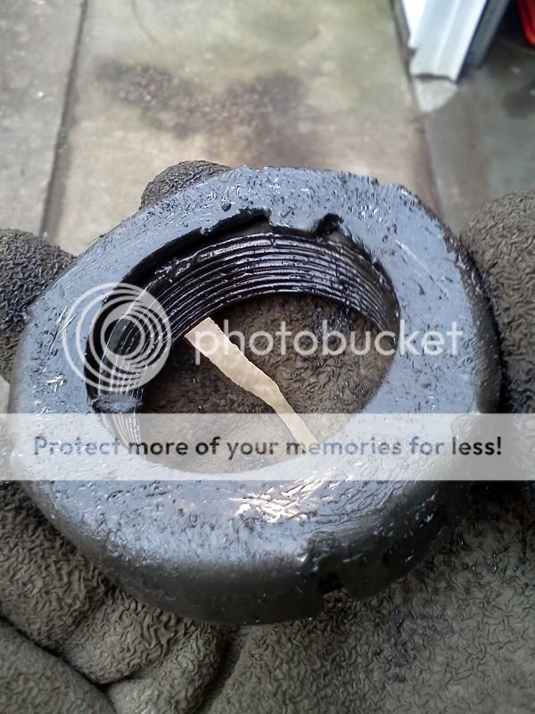

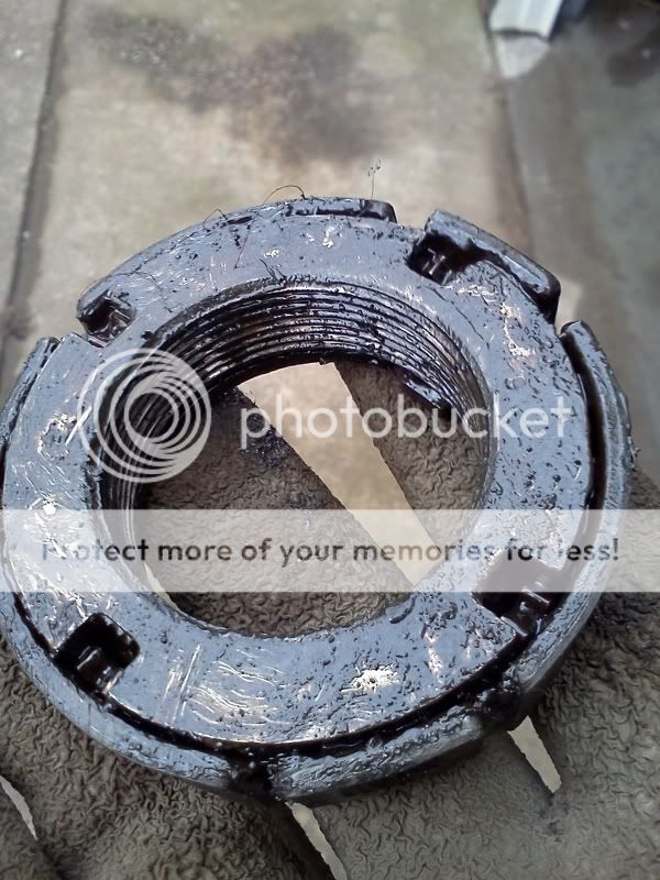

Anyone seen spindle nuts like these?
No sir!!!! I like that better than the worthless warn "two nuts, pin and washer" set up.
Found them on an F250 with a HD44 TTB.

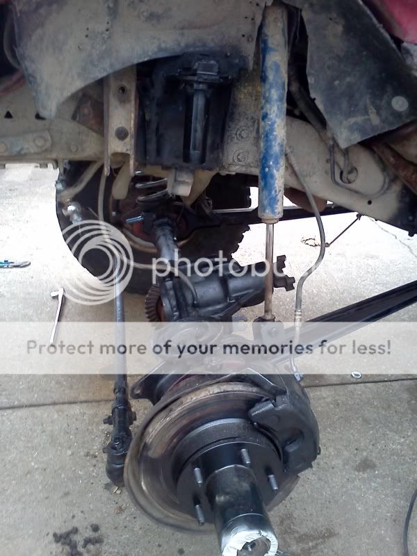

And some work today. Redid buckets, cleaned some things up, and splashed a little paint.
is there any way you could make the bottom spring bracket more level, or does it really matter ?????
