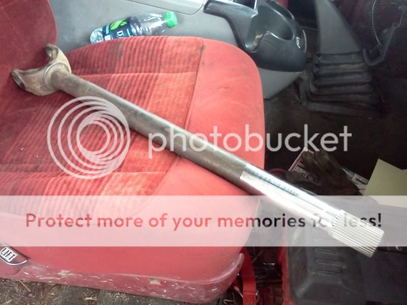

Would you be able to do the cobra rear disk brake swap to a FW 8.8?
Not bolt on, the flanges are a different pattern, but with some mods you can, just make sure you have a big enough rim...
SVT
Thats why the Explorer swap sounded good. Just have to have the shafts lathed down and new holes drilled in the discs and I can keep 15" rims.
Thats why the Explorer swap sounded good. Just have to have the shafts TURNED down and new holes drilled in the discs and I can keep 15" rims.

Okay not cobra swap but Mustang GT rear disk brake swap. You use regular mustang backing plates, rotors, etc... and you can still use your 15 inch rims.

Wouldn't the Mustang GT still have 5x4.5?
Yeah Dustin, the mustang is still the small (Ranger) pattern...
SVT
Then thats not really helping. That would hard as hell to find. I'll just stick to the Explorer discs.
