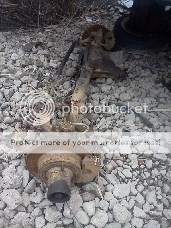

Seen this today. Thought about taking the flat top knuckles, but decided against it.

Also been thinking about what rear axle to run. My original plan was a FW 8.8 so all I'd have to do is have my gears swapped over. But I don't want to go back to drums and only the newer ones with the metric lug pattern have discs. I read up on modding Ex rear discs to fit and then looked at other options like the Dodge 9.25" rear. Same pattern, discs, and stronger, but then I'd need gears. Oh well, still weighing my options.
Also got someone from Indy thats really interested in my 35. Hope to sell it soon.
I'd do the full width 8.8
I'm sure you can do a disc setup
Dustin, grab an 8.8 front a mid 80's F 150, swap the gears over, the disc brakes will swap over, you will just need to either redrill the Rotors or get new ones. I hear the metric 5 lug is close enough to the standard size that the runs will still work. I'm sure you can verify this at the jy...
