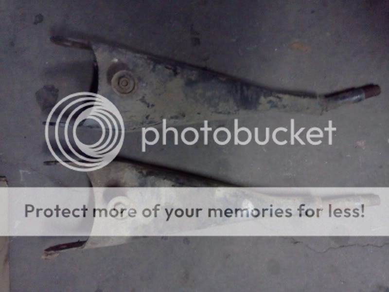

If I wasn't too broke right now.... I also had a question. You mentioned the D28 rad arms have a "Better Shock Mount" What exactly do you mean by that? Cause I know you have to move a shock mount in some way or another to switch to jeep coils.
the d28 ra's have a bracket for the bottom shock mount
the d35 ra's have a stud sticking out that the bottom of the shock mounts to...its a weaker setup than the d28 arms.
i don't think you HAVE to move the shock for xj coils... most people that want more flex use f250 shock towers tho, to get a longer shock for better flex.
Yes the only mod I made was F250 shock towers.
Here's a comparison. Nevermind my bend studs.
D28
disciplerocks's B2 build thread
D35
Oh okay that's pretty cool. Yeah I always thought there was some sort of clearance issue. I never really understood the tech libraries explanation.
