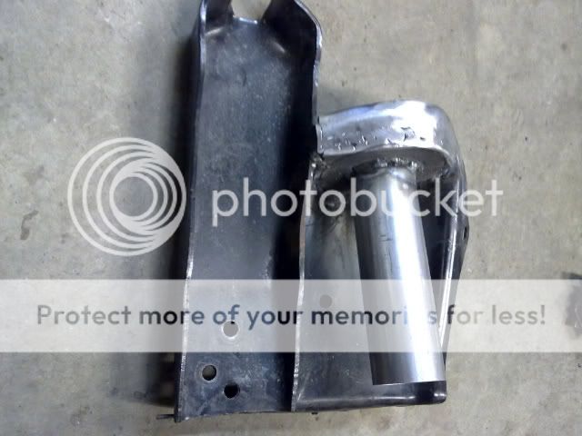

my upper coil buckets to help fit the larger f-150 coils. cheaper than ordering bronco coils. strong as hell and i know i wont kick out anymore sprigns.
eidt to above post. *cheaper than running bronco coil BUCKETS*
Think I'm going to mod my buckets to fit the XJ coils better and see how they perform.
Right I remember now. That would work better than what I had in mind.

How well do the xj coils sit in the cups on the radius arms? Aren't the xj coils 5 1/4" od and the early bronco and f150 coils 5" ?
If they fit ok I need to get some.
