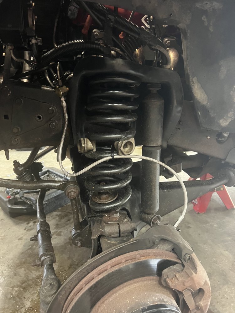

The brake lines on the truck now are cracked all over, and rusty on each end. I’ve always replaced old rubber lines with stainless braided ones on vehicles I plan to keep a long time. Yeah OEM rubber will probably last 25years, but the stainless lines seem to marginally help with pedal feel, and should be a little tougher in case a stick jumps up and tried to grab one.

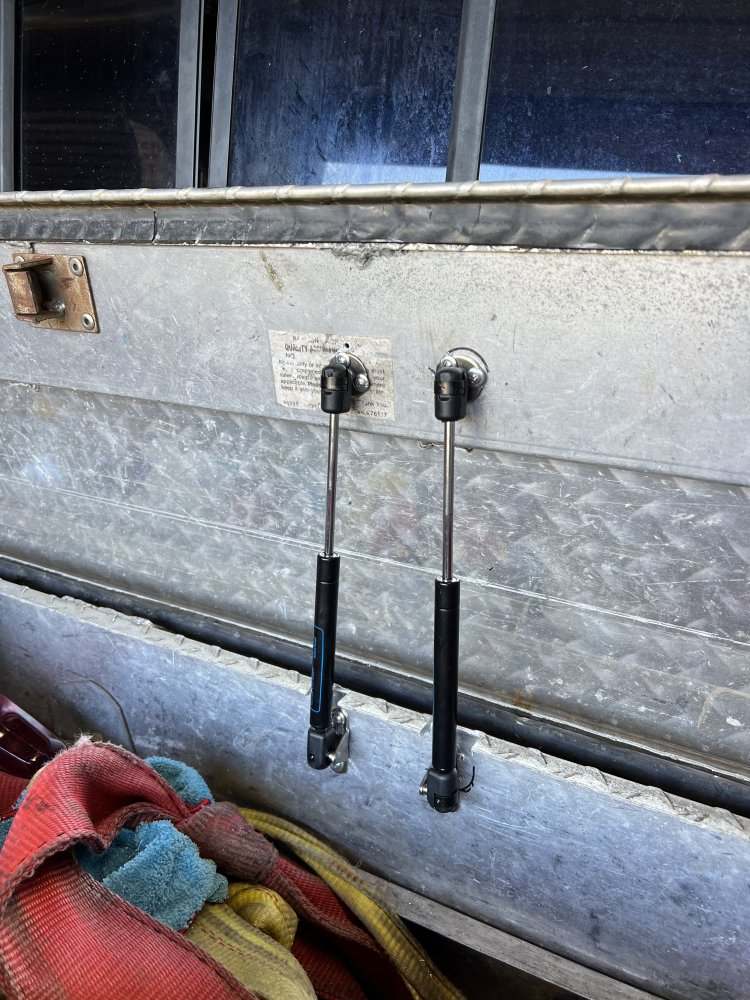

Also replaced the decaying front brake lines, added lift struts to my tool box, and replaced the PS pressure line that I could not get to stop leaking.

I would get rid of the coil spring twister lift thingys... no good can come from that.
Search the Tech Library for "washer lift". Far better choice IMHO then those coil spring twisters.
