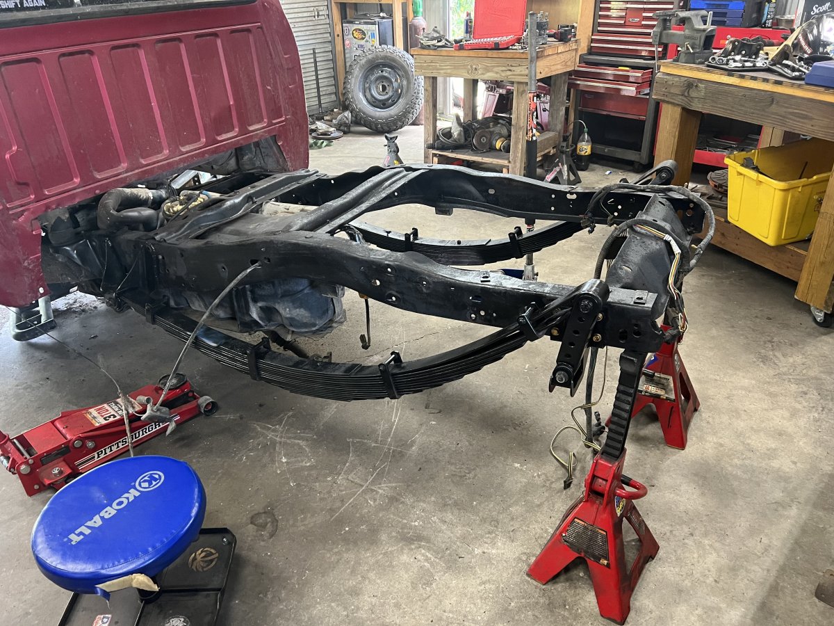

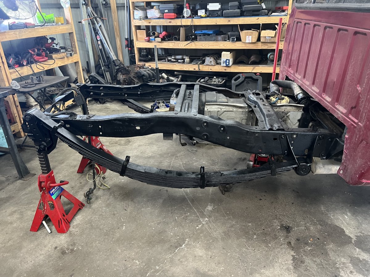

Got the rear axle with 4.56, rebuilt extra clutched posi, sn95 disk brakes, 64” deaver spring pack, bilstein 7100s, and of course cleaned the frame up. Been driving about two weeks breaking in the new trans, Tcase, and rearend before I start on the front. The 4.56s feel amazing! It has no issues spinning both 32”s in first or second on dry pavement. The Deaver pack I had to pull some springs out of because it was originally on my RCSB Silverado and was too stiff for this little thing. But after pulling 6leafs each pack I think it feels good. The Bilstein 7100s valved to 255/70 also feel good although maybe a tad stiff still. I have the bed on but none of the stuff I usually have in the bed including the rear bumper so I think with another 200#s in the back it will feel good.
The only issue I’m having is that for some reason the rear disks will not bleed and are not getting enough pressure to even push the pads lightly into the rotor. I guess I’m gonna have to look into the proportioning valve or ABS valve next time I have it on a lift.

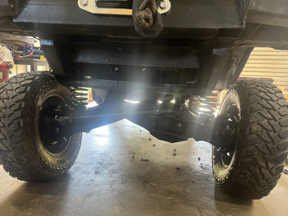

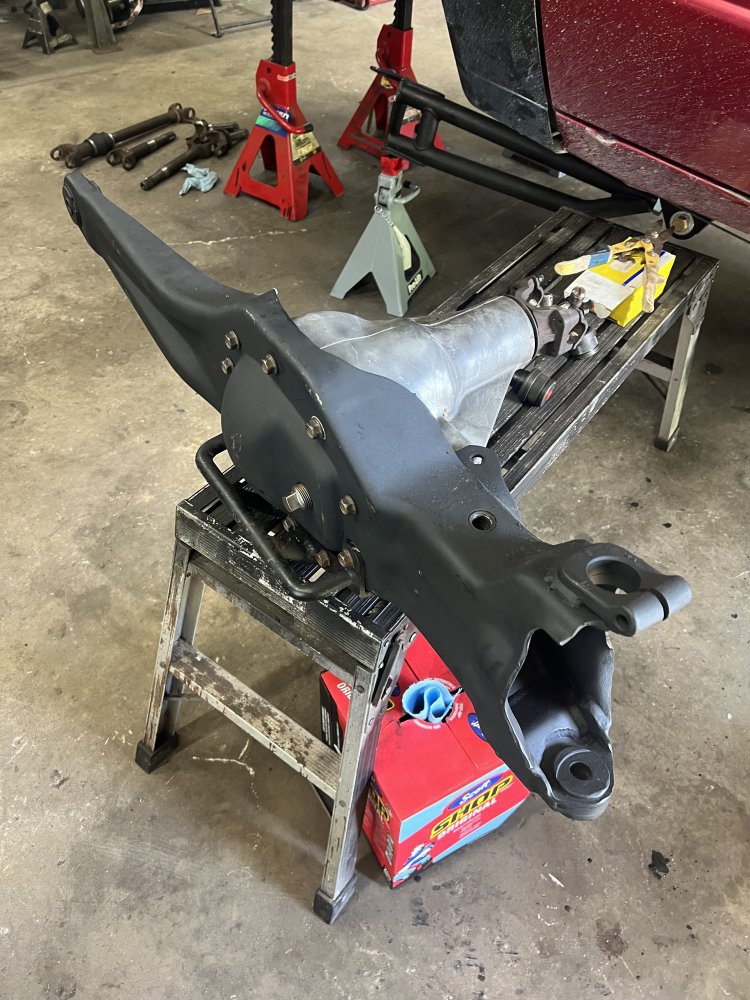

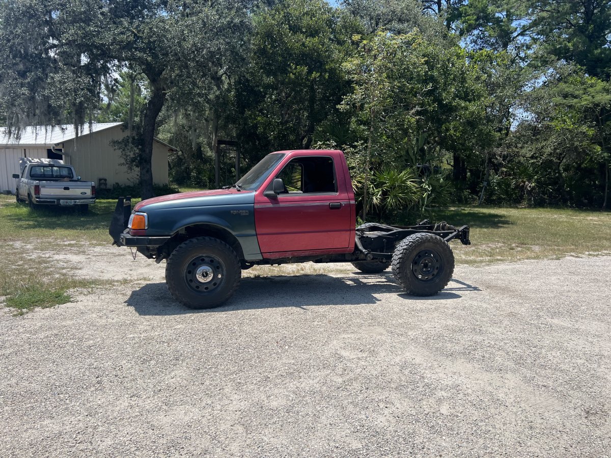

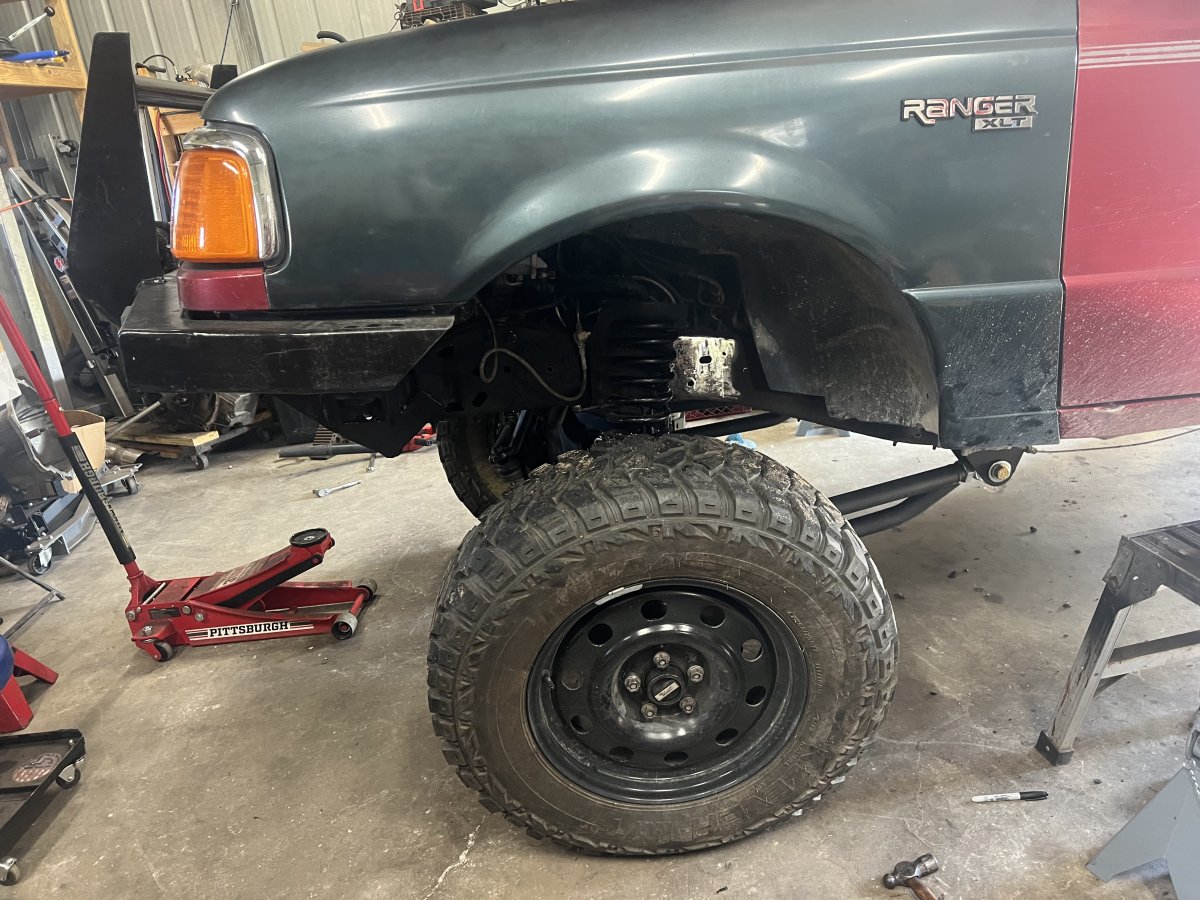

Got the front together with go fast explorer beams, all new everything as far as bearings, joints, bushings and seals, 4.56/open rebuilt diff, and 5”procomp springs. Problem is the 5” springs added 13” of height up front! I’m kinda blown away they did so much. Maybe it’s because the springs are for an explorer, but something must change. I’ll probably cut some coils off until I get close.

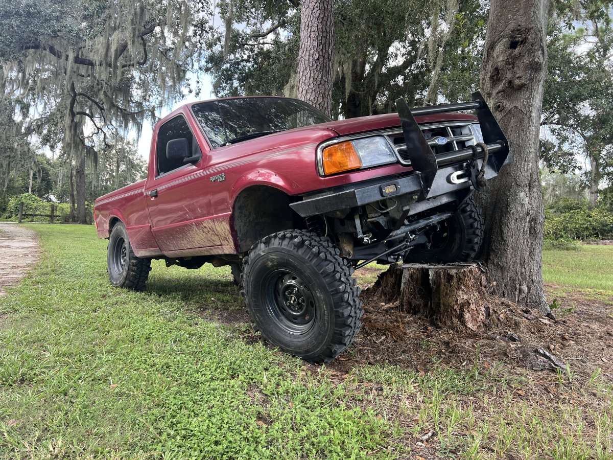

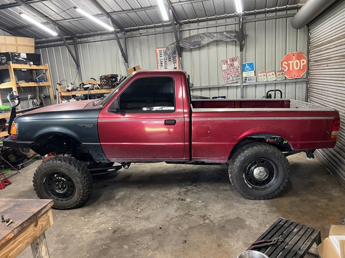

Cut 2 full coils off the springs and brought it down to only 3” taller than the rear. I’d like to bring the rear up to match now. Also got the rebuilt driveshafts in, tightened everything, gave it a homemade alignment, and made coil retainers. Then went for the first test drive!
It’s awesome so far, still have a few things to finish up including measuring for front shocks and placing an order on some 7100s. Went and flexed out a bit on a stump down the street and realized I need to do something about the rear badly. Gonna start with attempting to push the axle back an inch using the slotted leaf brackets, then bring it up 2-4” by flipping the hangers back to the stock orientation and running a long shackle, last but not least will be trimming if it’s still needed.

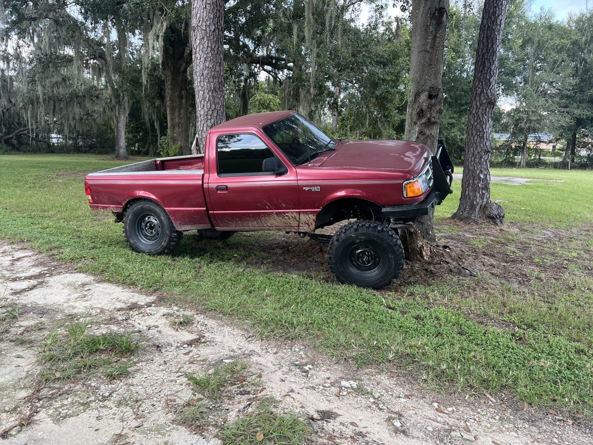

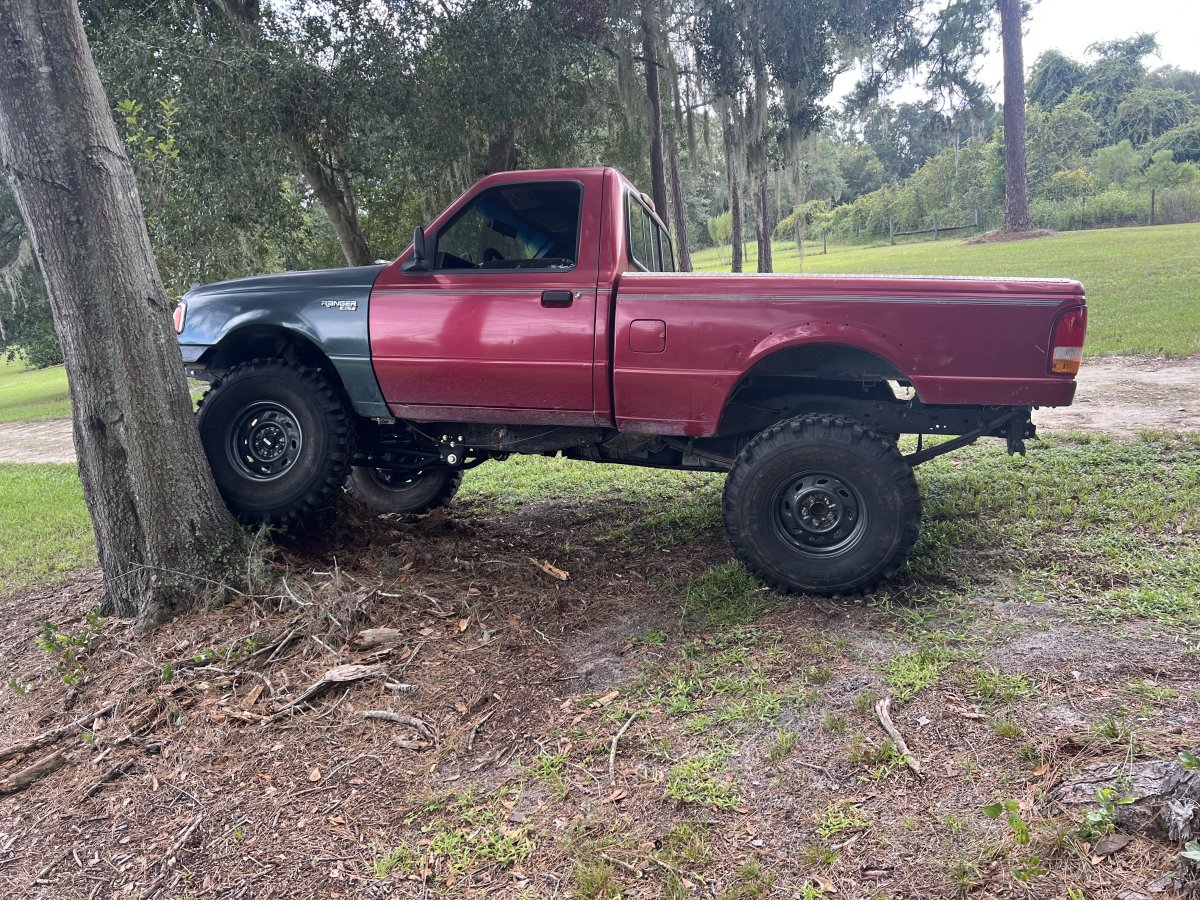

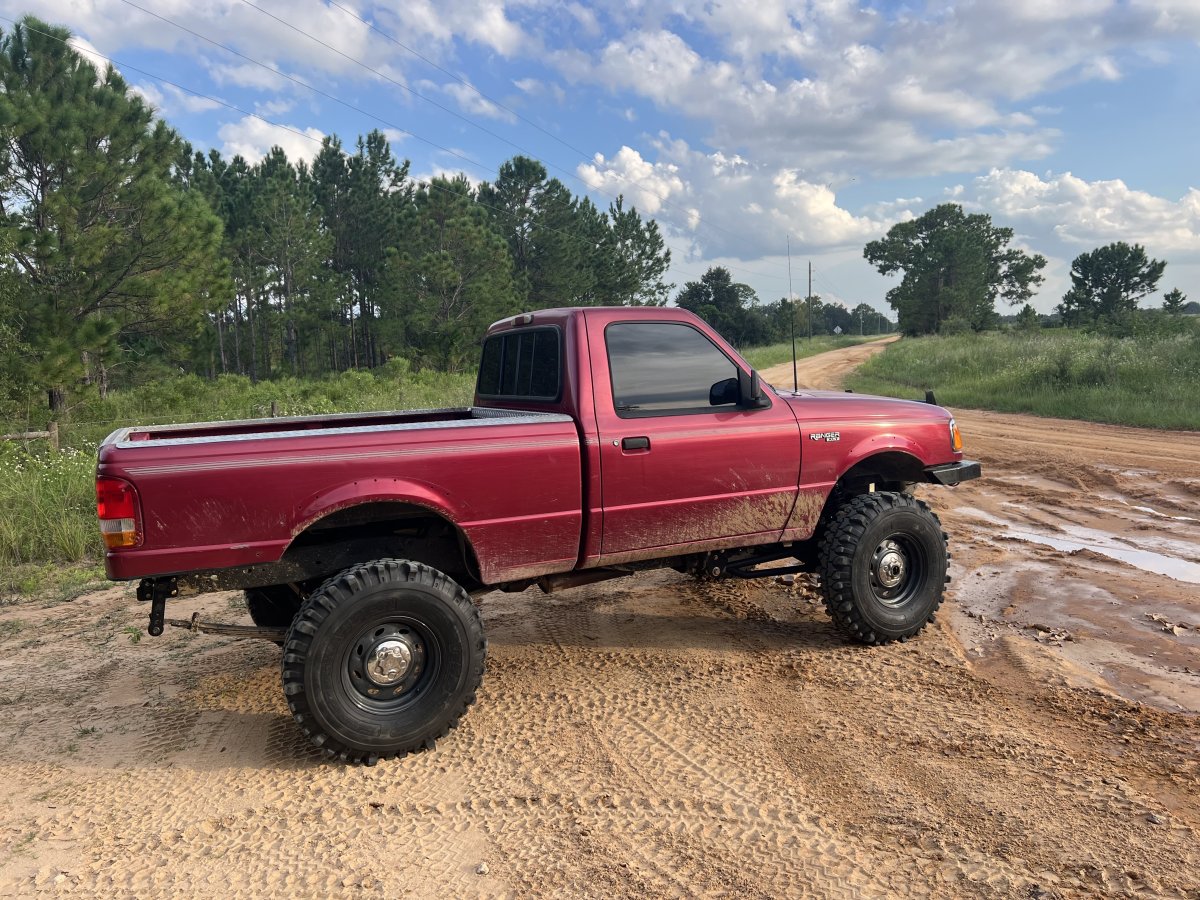

Flipped the rear hangers back to stock and threw on some beltech 6400 knock offs. Got the rear up to 2” over the front which is perfect. I think I’ll still pull a leaf or two or three out of the deaver pack to soften up the rear.

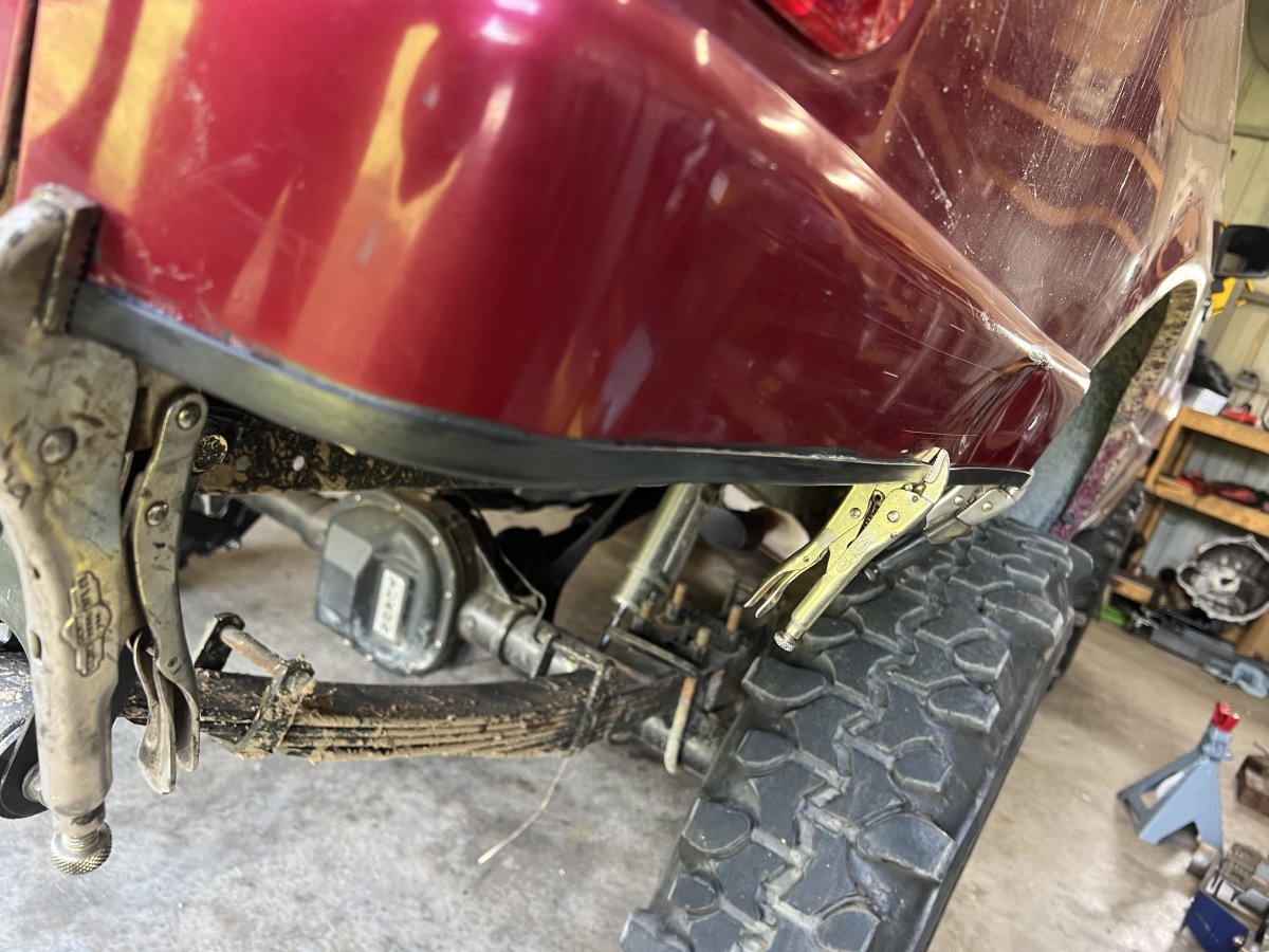

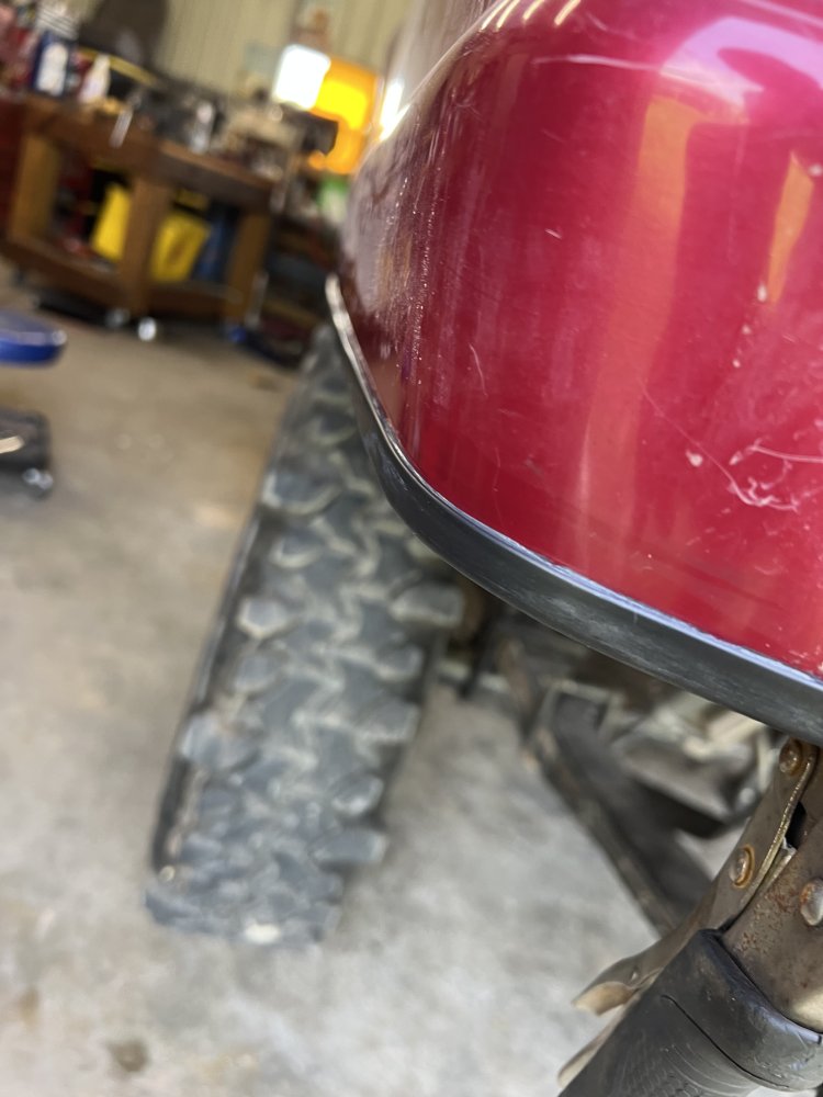

Also took some rubber mounding and ran it along the cut bedsides razor edge. The stuff had adhesive in it but I don’t trust it so I squirted black RTV in it for hood adhesion. I think it came out super slick!

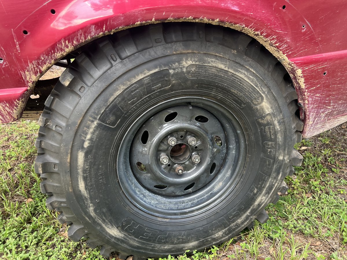

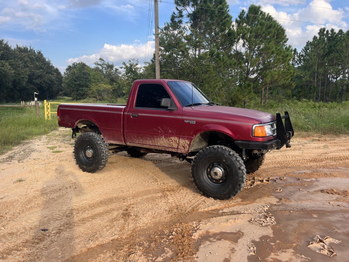

Then went on a full test drive into town and around my neighborhood dirt roads. Forgot how brutally loud these swampers are, but also didn’t realize how well the truck handles them. The little 4.0 has no issues spinning the 34s on dirt in first second or even third depending how violent I am on the shift.
After a vacation coming up this week I’ll order some 10” short body 7100s for the front along with limit straps. Cannot wait to see how it feels with shocks!
If anyone has a suggestion on a tall skinny 34-35” AT or RT tire please let me know, I’ll probably sell these swampers soon for something milder. only thing I’ve found so far that’s affordable is the Kenda Klever RT 35x10.5x17.

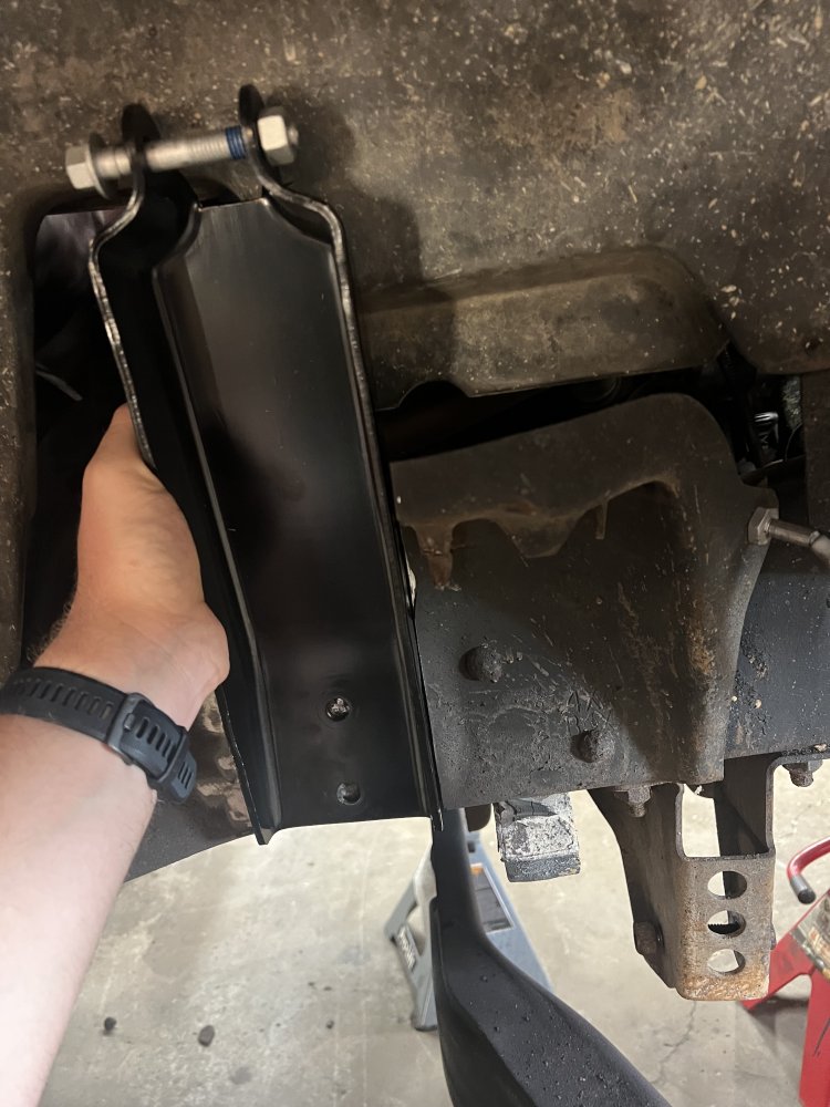

Also got the front shock mounts built which was just using those f350 towers in the tech section and welding the lower tabs to the radius arms. shocks would actually be on but I didn’t have the correct hardware on hand.

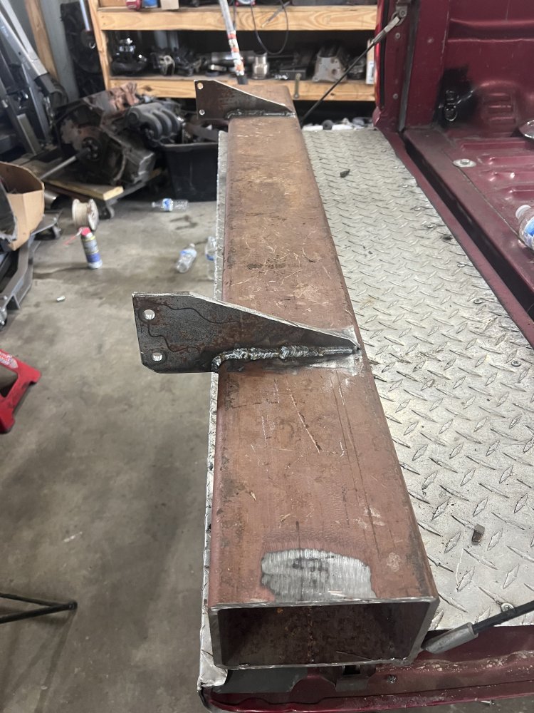

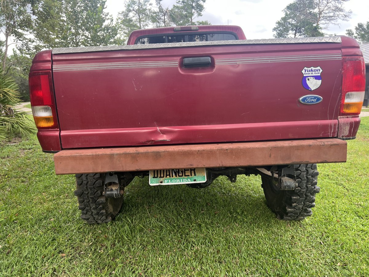

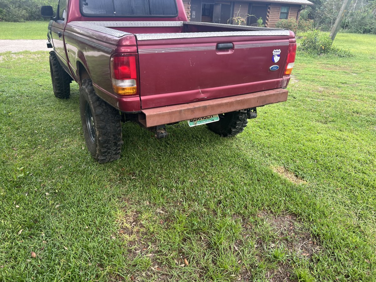

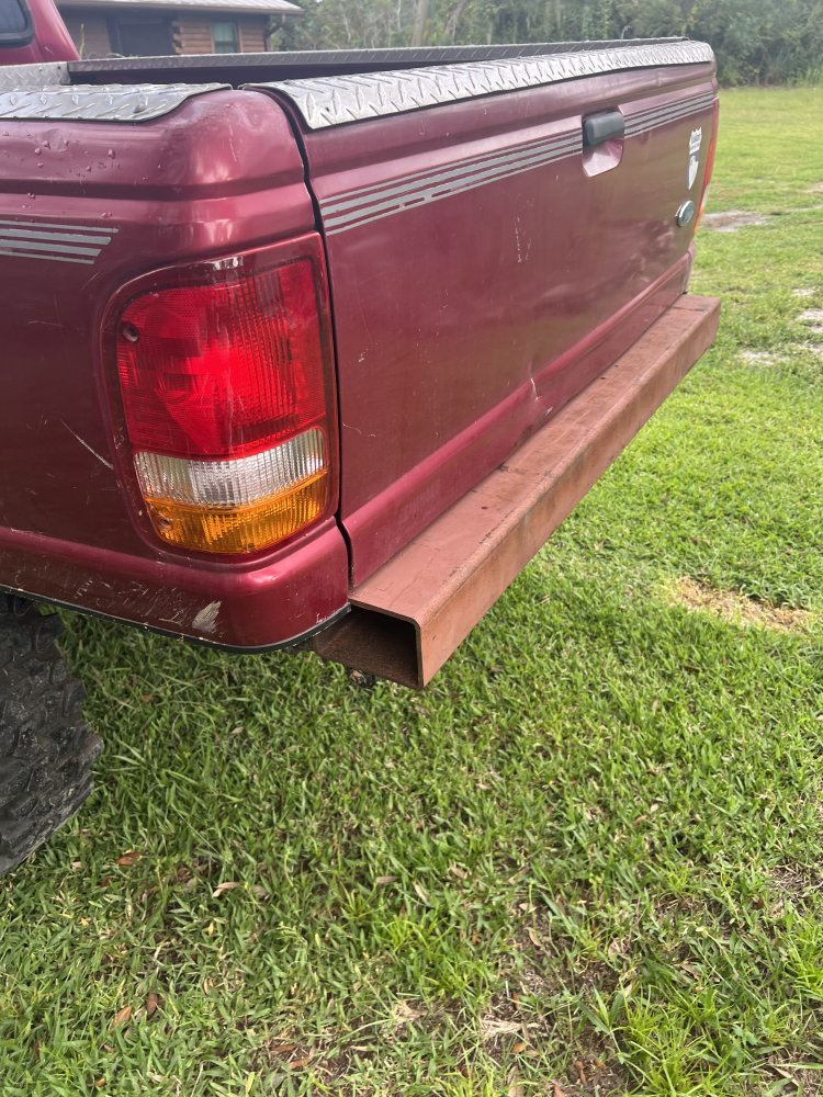

I did make some picture worthy progress which is on the rear bumper. I decided to make the main center section out of the same 3x5 that I used in the front. Made some real thicccuh mounts with some plate I had laying around and made it bolt on to the same bolts as the back two of the shackle hanger. Not sure what I want to do about wrap arounds yet. Might cut the bedsides higher to match the tail gate gap and use some 3x3 I have to wrap around like I did in the front. Or use some 2” well casing I have and ghetto bend it or use pie cuts to wrap the corners. Also have a new receiver to add in of course.
For now this works and I like driving around with a work in progress because it helps me see what I like and don’t like about it for a few days. Not to mention some rear end protection
