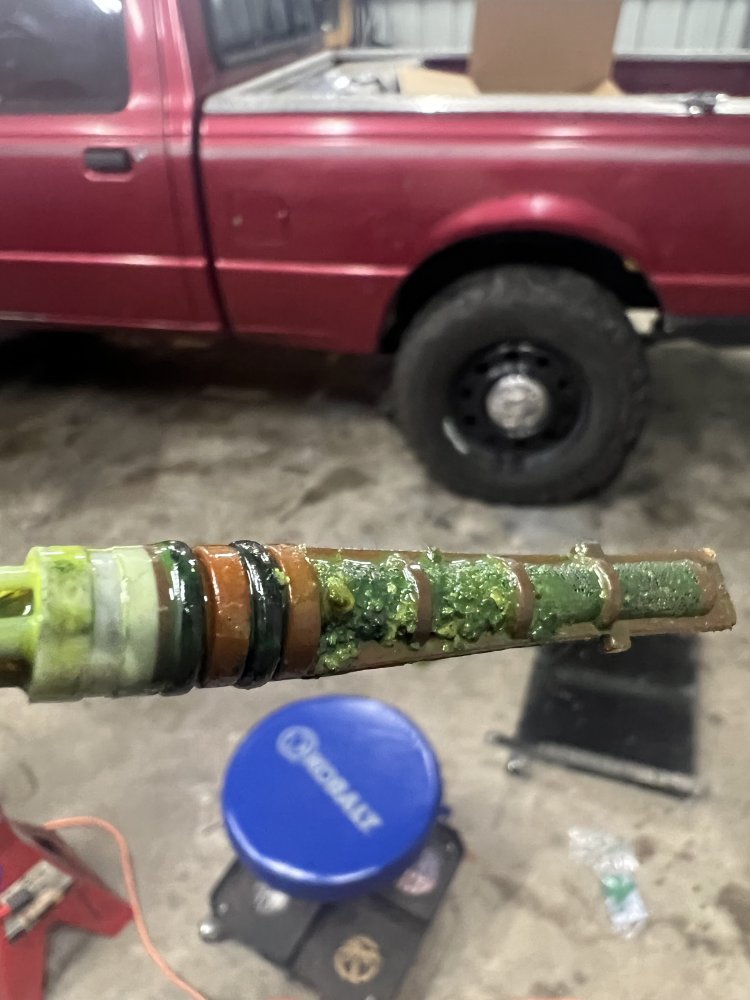

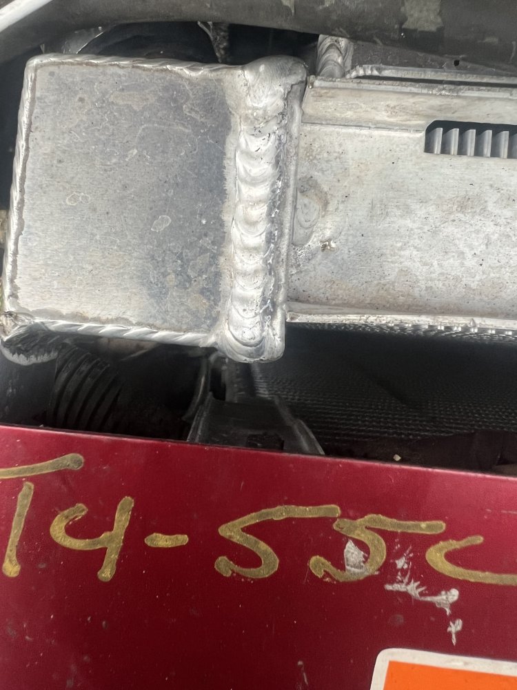

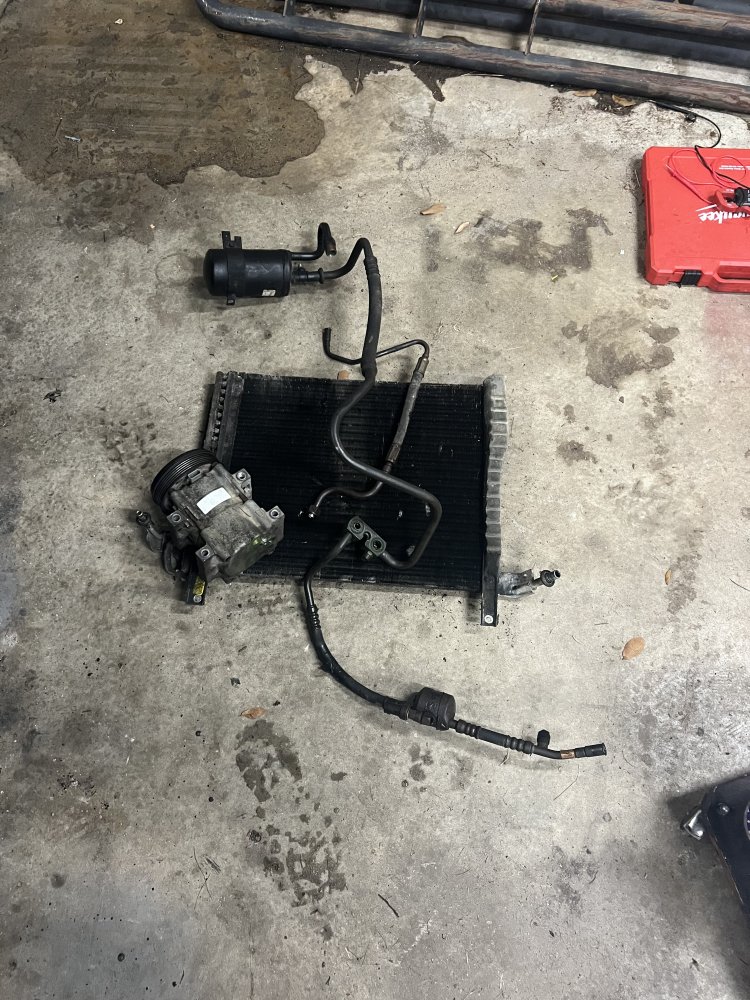

Finally got all the AC parts together and got it blowing cold. Had a heck of a time getting some of the QDs back together without the Orings getting beat up. Ended up replacing the Orings on one connecting three times. I tried everything I could think of including preoiling them, oiling the female tube end, and gently working them on. Finally got it tho. Blows nice and cold but now the engines getting warm, I think I might need to drop the fan temp switch to a 170*on instead of a 190* seems to take forever to activate.
Also might need to find some of the foam that was sorta sealing the condenser and radiator together. There’s almost an inch gap between them which I know isn’t good for the fans airflow.

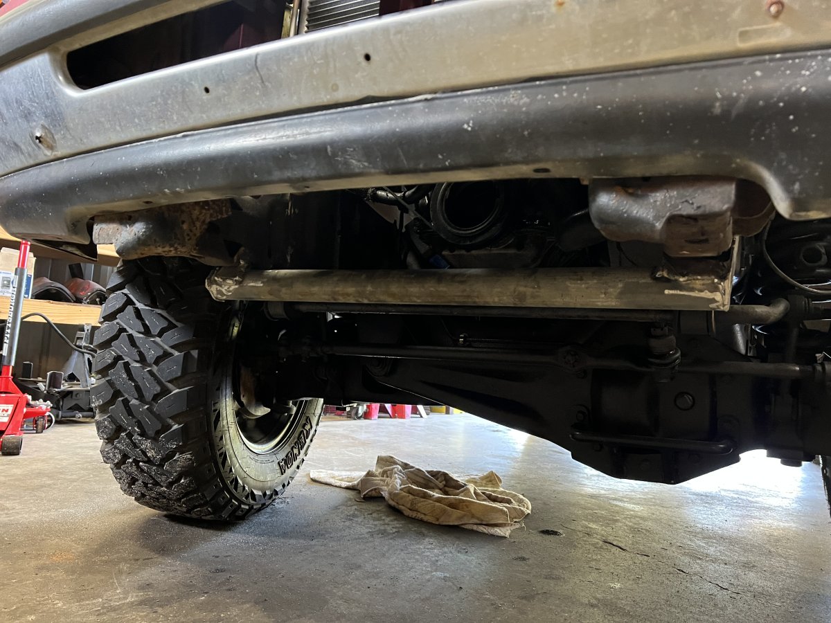

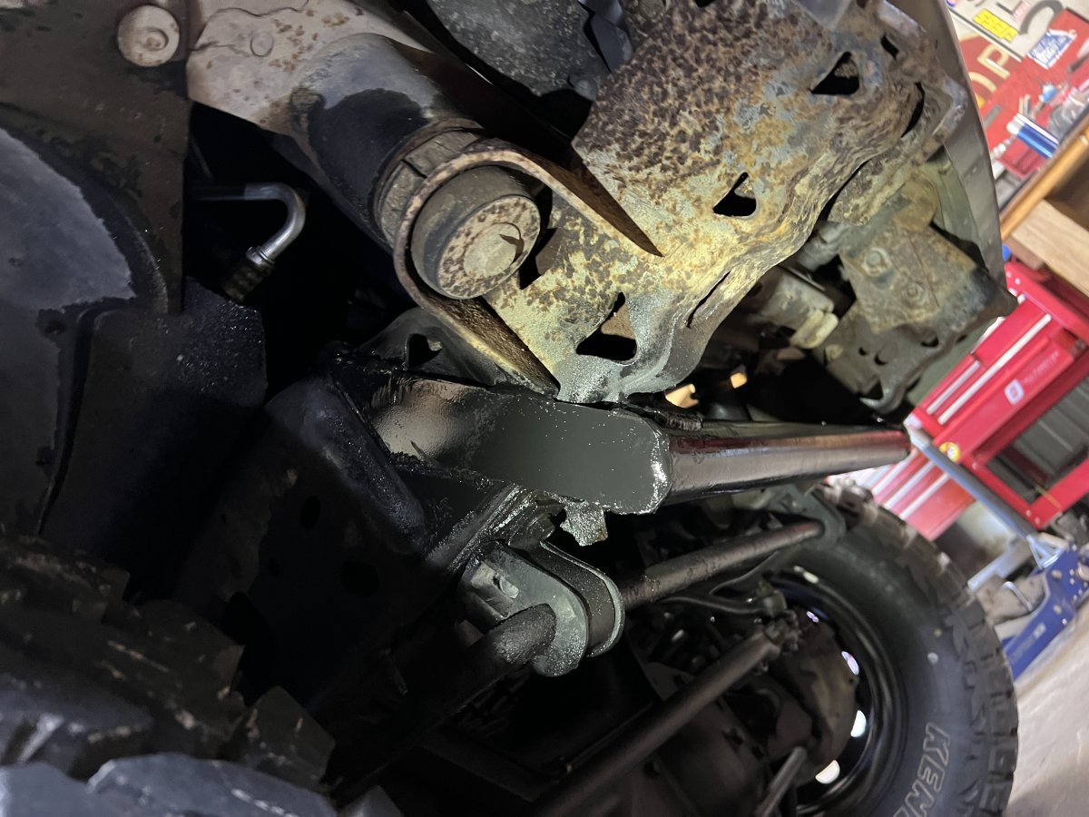

Also, welded in some tie down points in the bed, as well as a piece of pipe to the front frame where that flimsy sheet metal crossmember usually sits. My crossmember had been ripped apart when I got it so I hacked it out and now have a solid 3/8” thiccc pipe to hook recovery ropes to and for frame reinforcement.

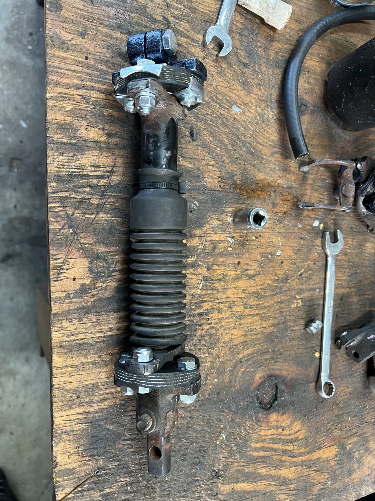

Almost forgot the most important safety upgrade which was the intermediate steering shaft rebuild with new rag joints on each end.

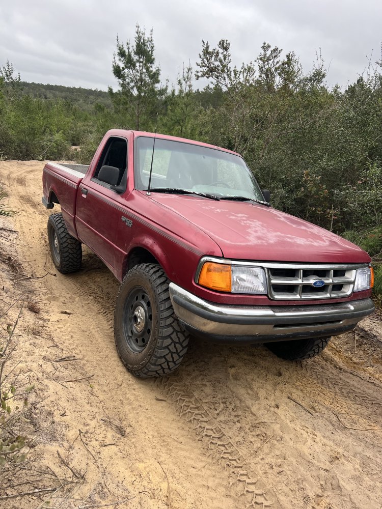

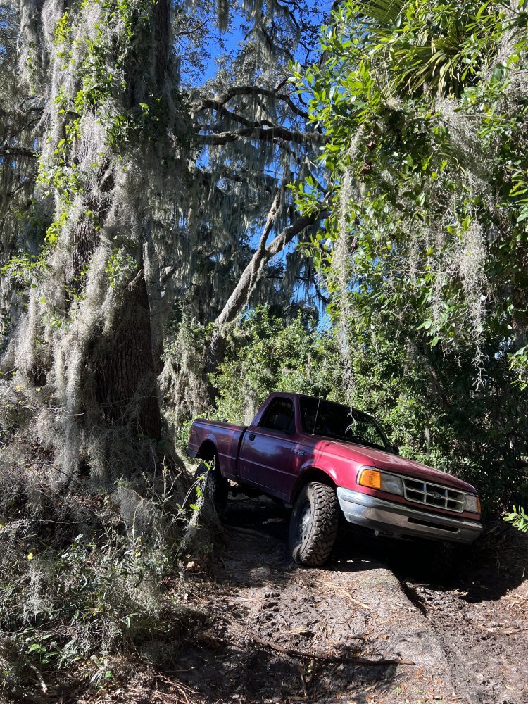

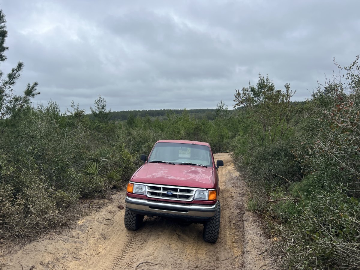

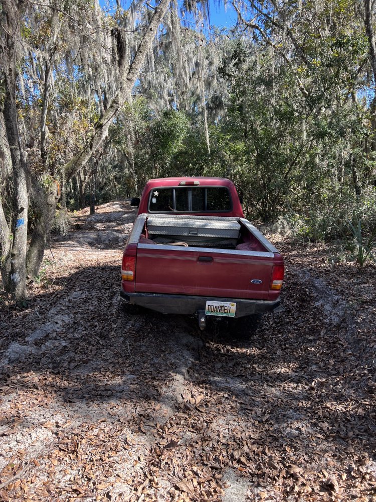

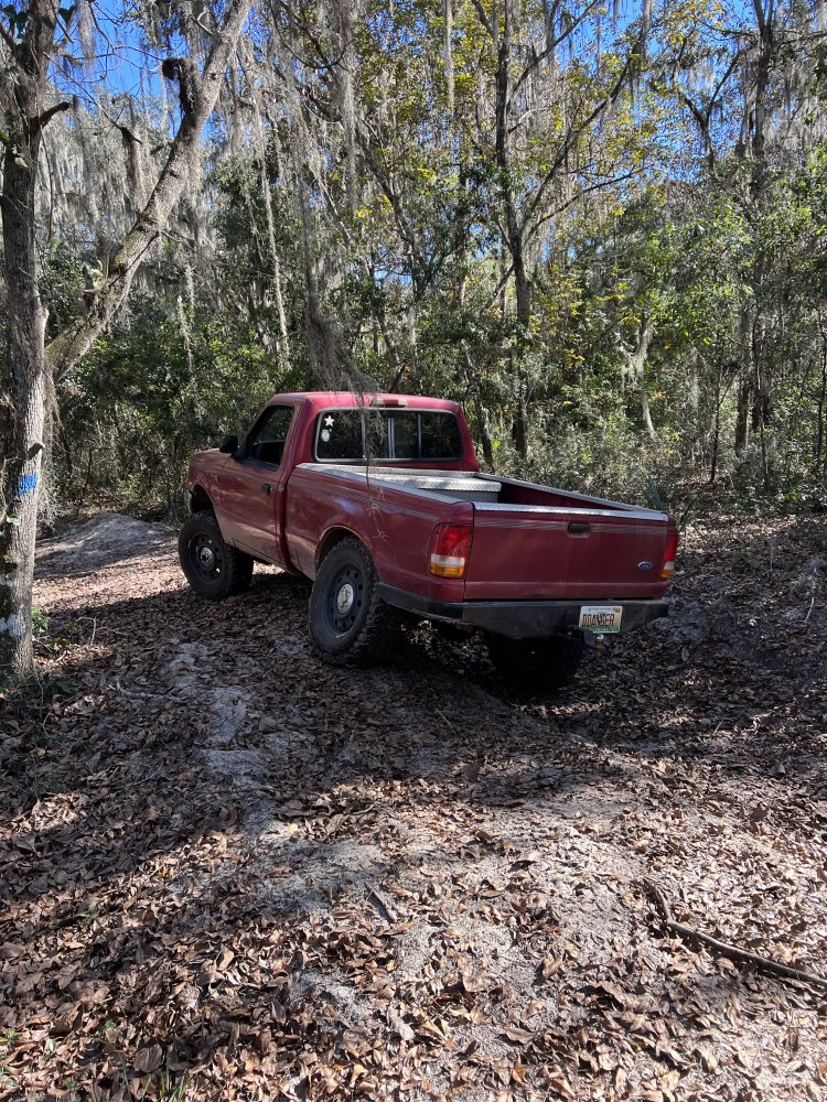

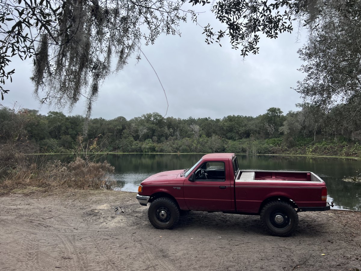

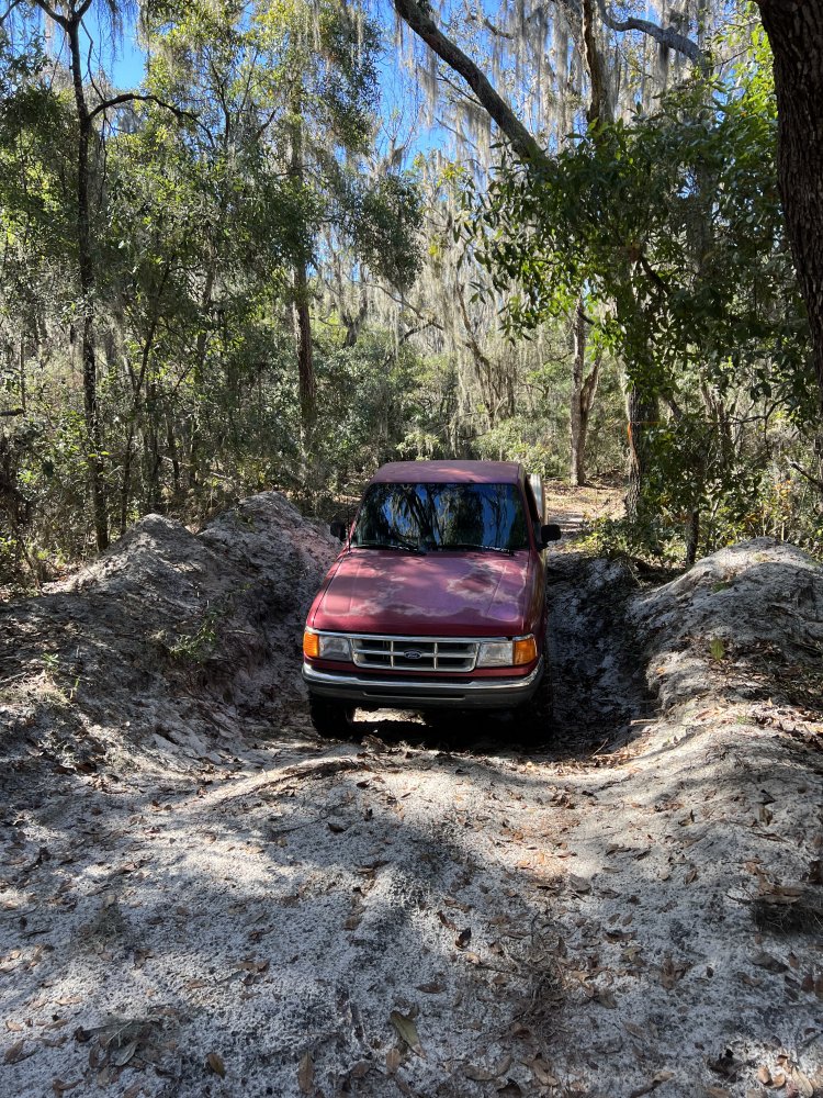

Finally got to hits some trails in Ocala this weekend and the truck did excellent! Only really needed 4x4 for a couple obstacles but still had a blast on its first outing. That is until the Chinese POS Electric fan completely quit. I bench tested it and it appears to have died so I have a derale replacment on the way. The good news is as long as I can maintain about 15-20mpg the big radiator and 180 Tstat keep the truck nice and cool even without the fan so it never got hot.
Truck definitely needs more parts to be better offroad but even as is it’s a blast. 4.10s and posis are definitely next. Then some suspension tweaking, and good god it needs shocks!

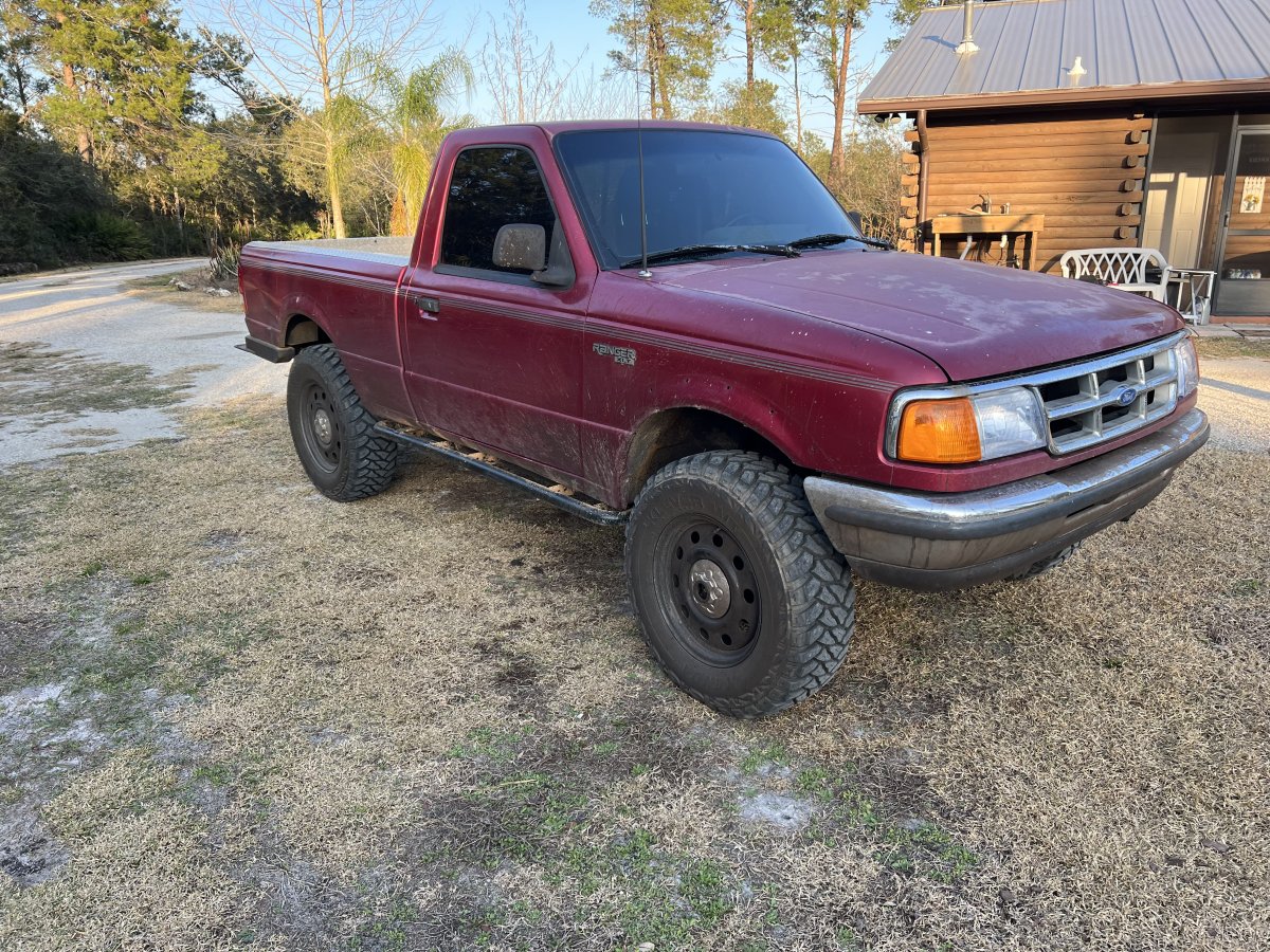

Got a set of rock sliders from a neighbor a few months back. They were off a YJ and fairly well beat, one was bent, and the other kinda twisted. I finally got the time to spend a could days and get them fit in installed on my ranger. I think they came out good, nice and tucked up above the frame and they don’t stick out further than the tires.

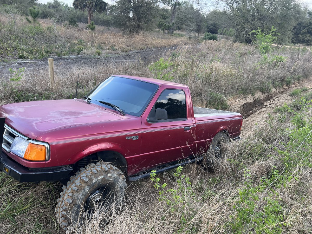

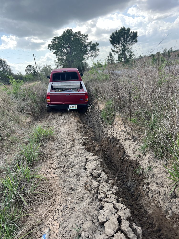

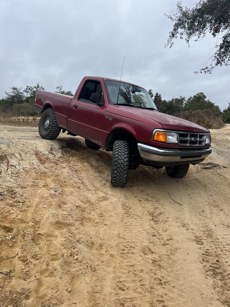

Almost forgot the weekend before last I went to a local 4x4 park and get the poor thing all sorts of twisted up in some off camber holes. It really surprised me for having open diffs front and rear, but check out that bed to cab flex 😂

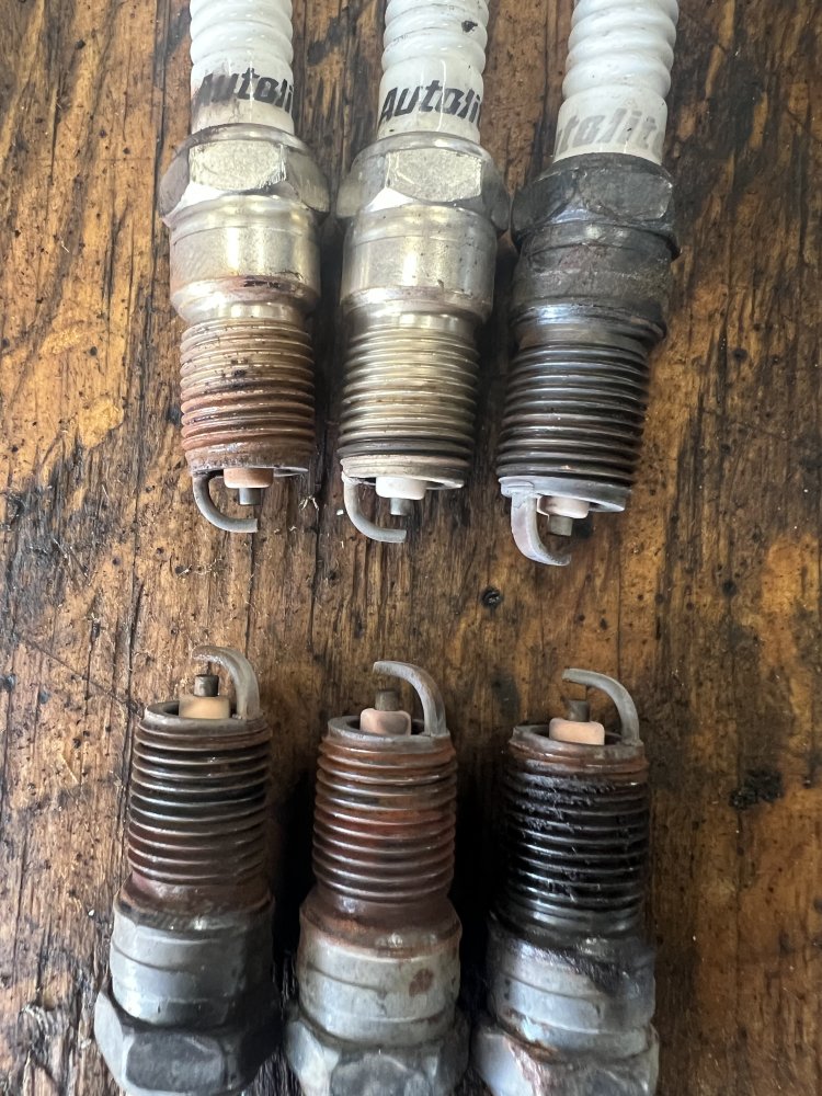

After 2,500 miles on the new motor I did some basic maintenance, new plugs, a good full synthetic oil, fuel filter, and air filter. I was super happy to see the spark plugs are very clean! As was the fuel filter, and the oil filter when I cut them open to inspect.

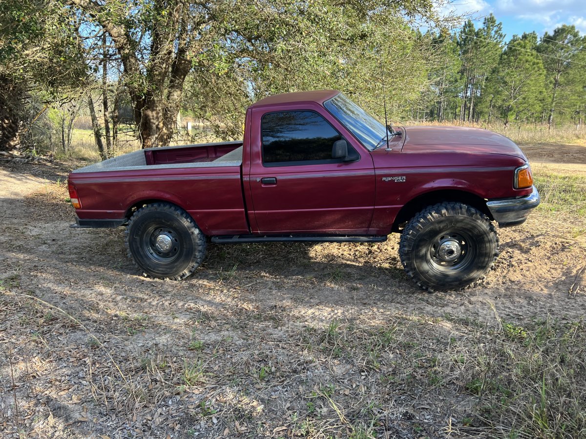

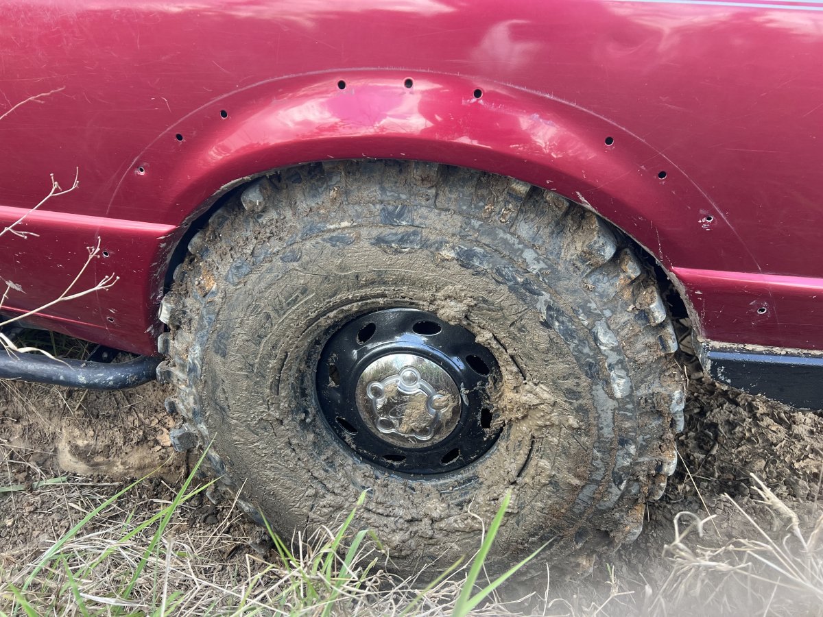

I also bought a set of 34x9.5x15”Narrow TSLs on market place, 5 tires with 90% tread or better and a late 2021 date code for $1,100, these tires are $486 each on 4wheel parts. I had them mounted to a set ofnew stock ranger 15x7” steelies that my buddy powdered in Cadillac metallic grey. They take the same center caps as my crown Vic wheels so I get to keep the same look for the most part. I had to trim the rock sliders a bunch to clear the big meats, butas of now, daily driving situations are rub free, it will get better when I get new radius arms and push the axle centerline forward a tad.

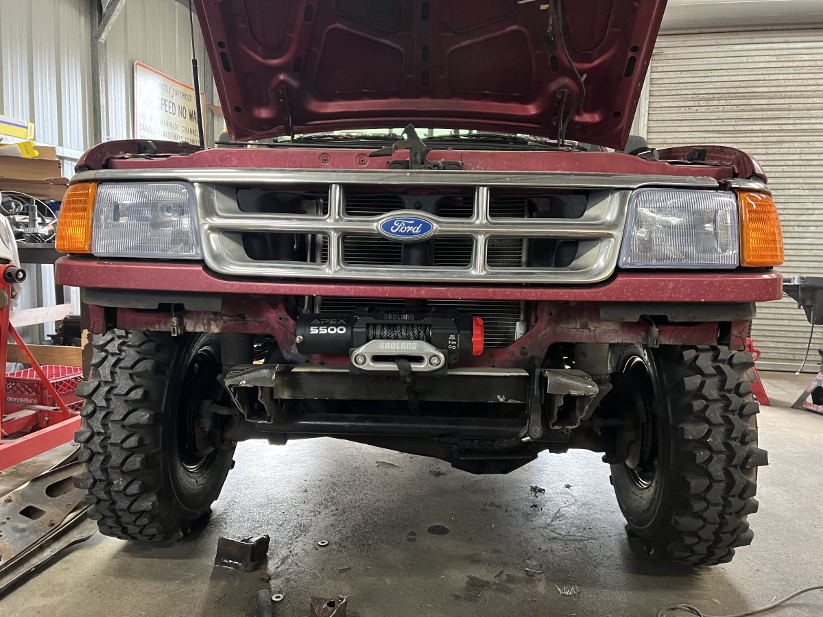

After the new tires I decided to start on a winch bumper, spent half the day making the winch fit behind the stock bumper. Then went to lunch in my Tacoma and remembered that I like big steel bumpers with full headlight hoops, incase someone acts dumb in front of me and needs a nudge. So I pulled the stock bumper back off and started cleaning up the frame horns for a bumper made of 4x6 and 4x4 steel beams I have laying around. The goal is max clearance, with the ability to run a cut down push bar in the middle, and use that to have the headlight hoops attach too. Would also like to have some good fog lights cut into the bumper, but might have to use something smaller than a 4” pod unless they will fit in the 4x4 beam.

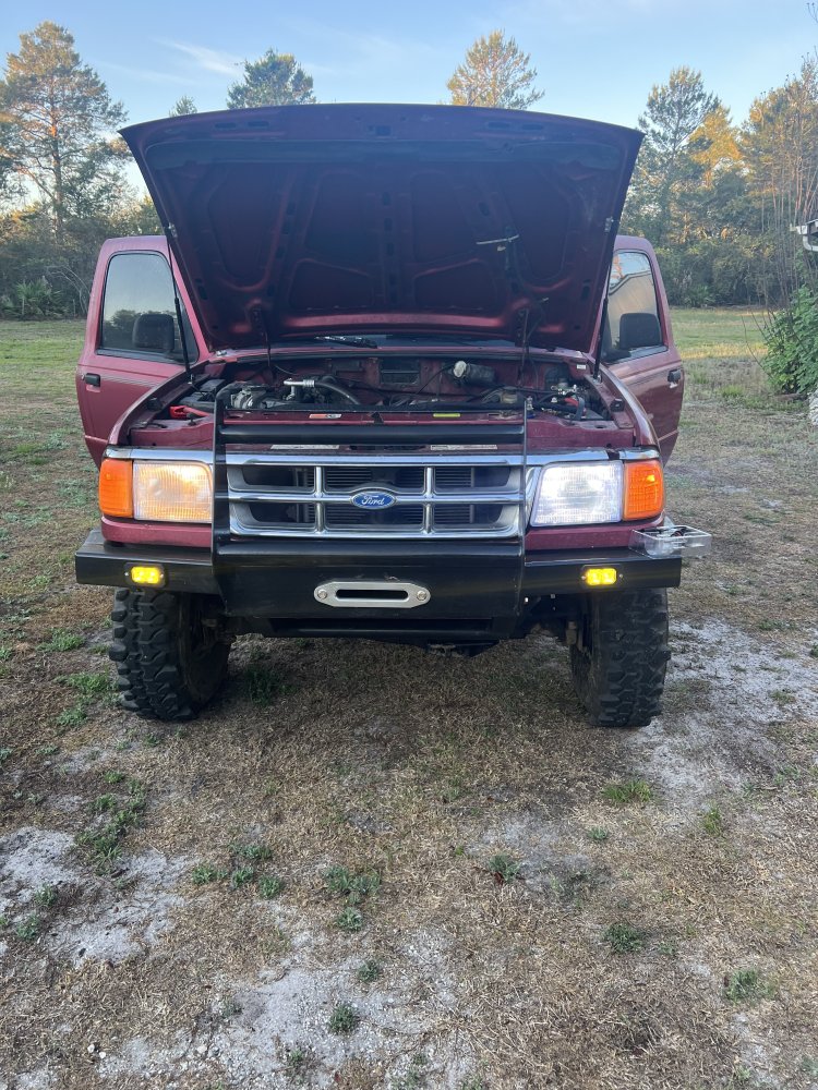

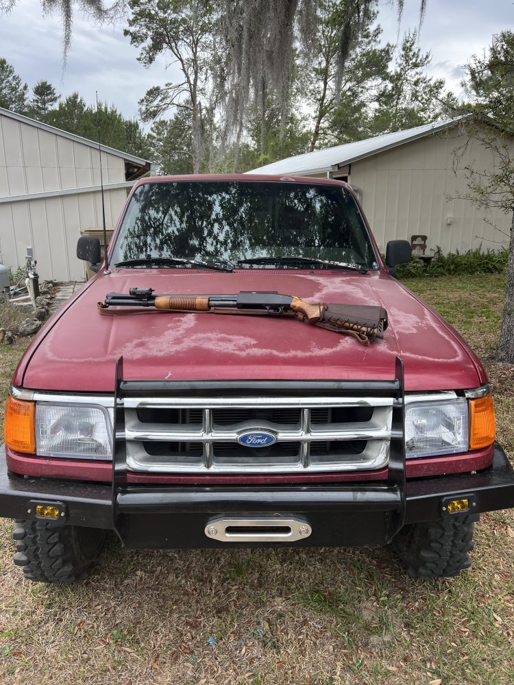

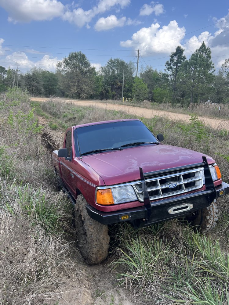

I did however finish the front bumper a few weeks before the clutch died and I’m pretty happy with it. Here’s a bunch of random photos with the new bumper.
