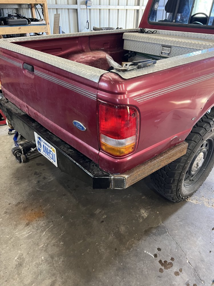

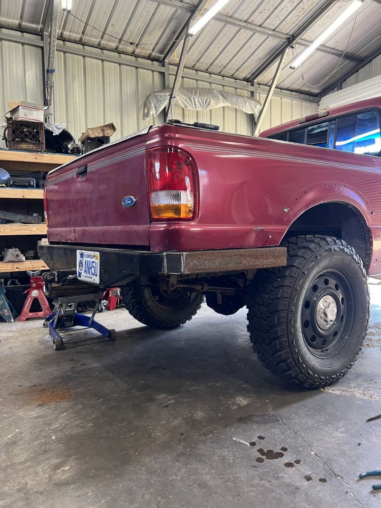

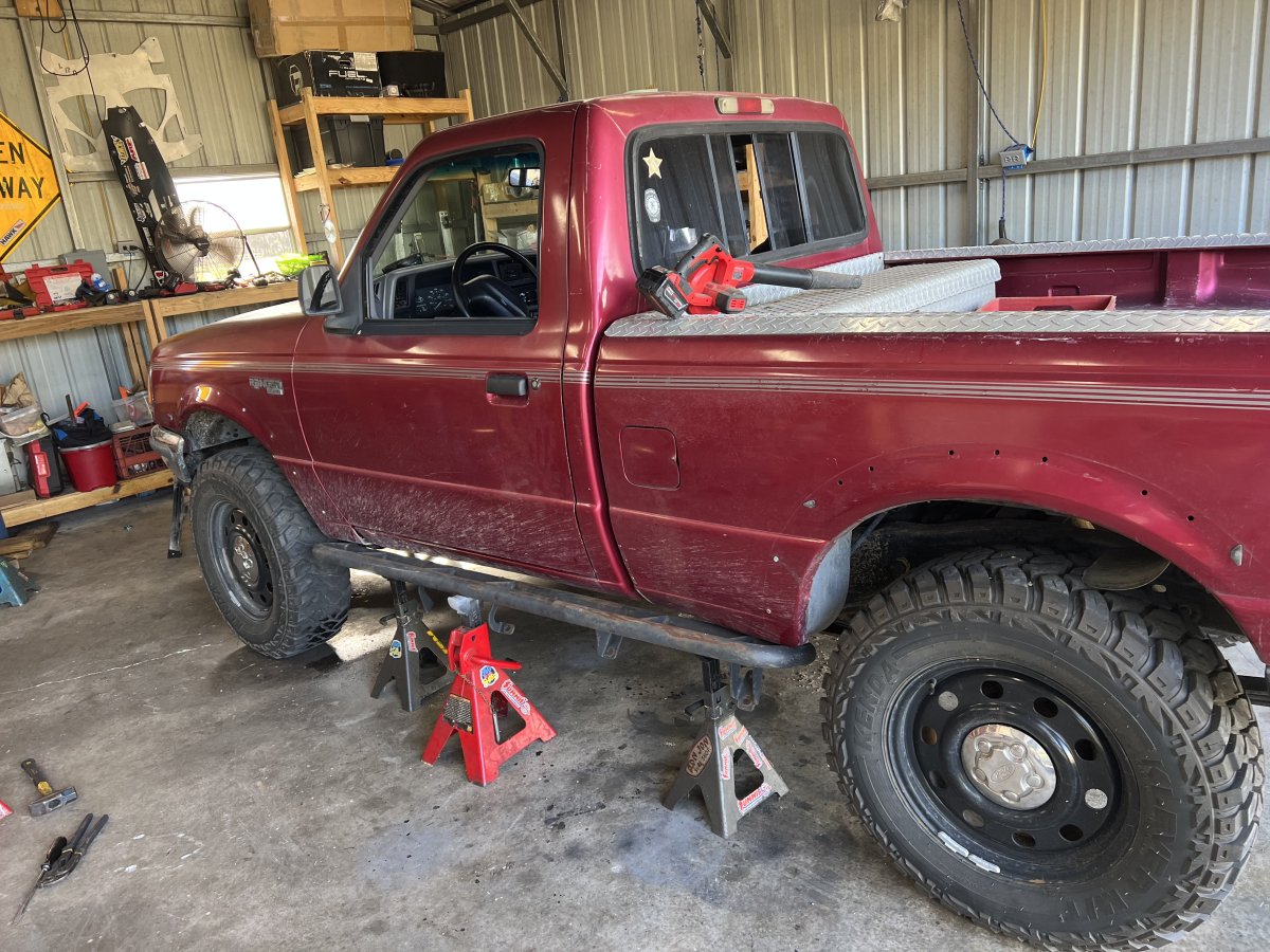

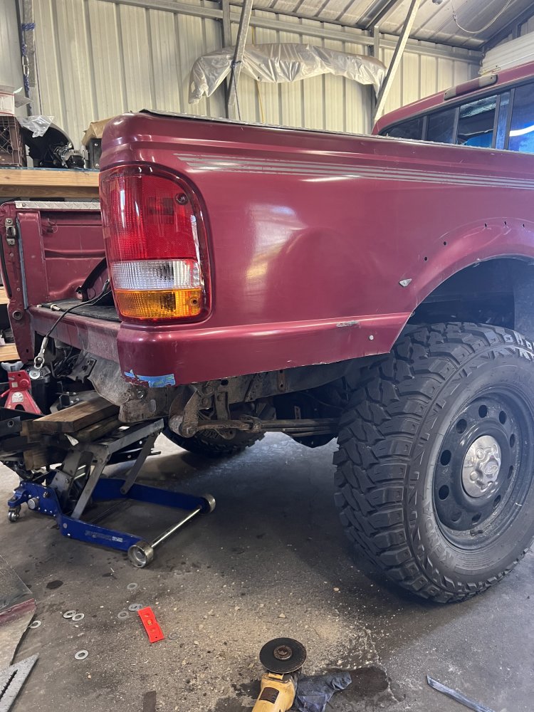

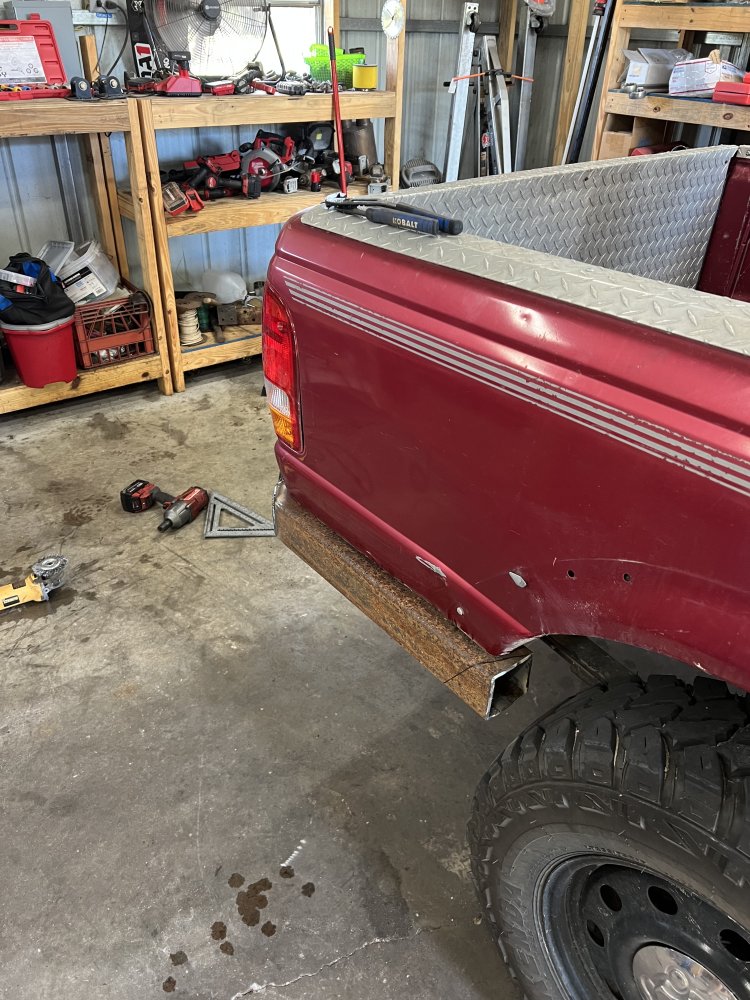

Decided to hell with working on important things, I’ll just hack up my bed and do more bumper stuff. Still have a bunch of cleaning up to do, need to figure out how I want to do the ends by the wheel wells, build brackets from the frame to catch the new pieces, and of course grind and paint the new bits. I like it so far tho.

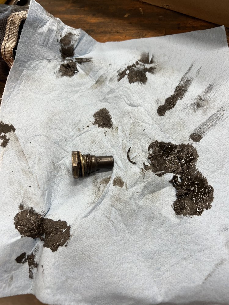

Oh I almost forgot about the trans fluid change I did. Not much came out, probably less than half a quart, and I’m not sure it was all lube, or water. Poor thing has had a terrible whine since I got it moving and at first I thought it was PS pump, then rear end, but after fixing both of those it persisted and I realized it was tranny. Nothing I can do to fix the damage done but 3.5qts of synchromesh sure has made a difference!
That's worse than mine was(at 230K when I bought it) but on my first go round I drained the transmission also, and kept all I found out of it, and took it to a dealership shop foreman, and he called his transmission man up and after a bit of brainstorming they said it was likely a bearing cage. I still drove it another 80K or so before having to find another one
If I’d had taken a sample of this fluid I’m pretty sure it would have been identified as pond water and mud mostly. Tranny sounds good now tho so I’m not worried about it. I have the trans and T case in the back of my head as things that need eventual rebuilding. So I’ll keep an eye out for spares I can have rebuilt and waiting for these to die.

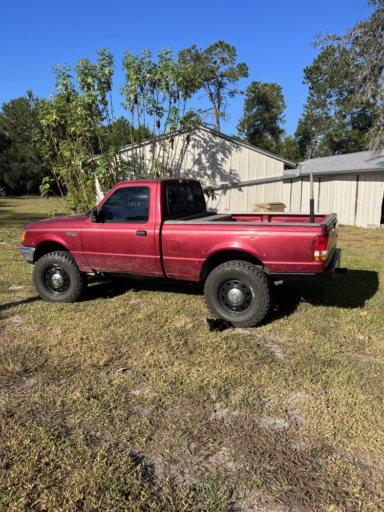

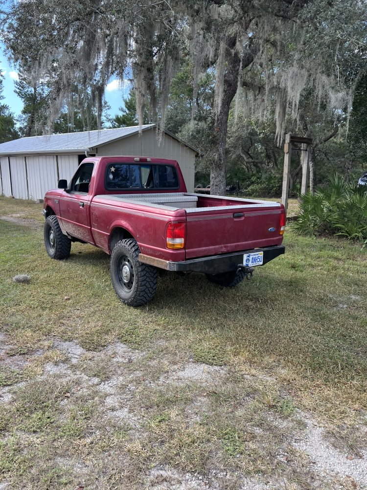

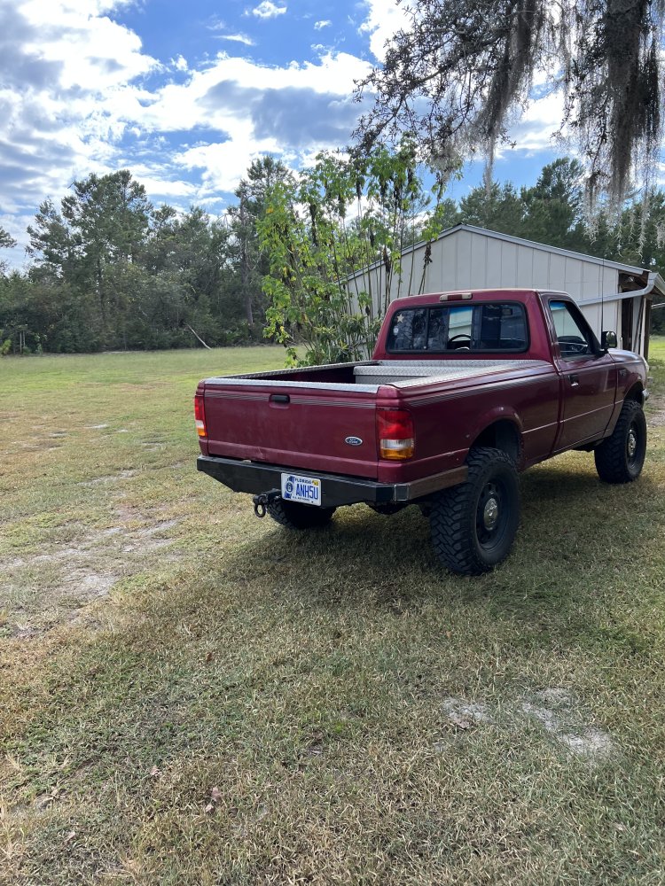

Finished the bumper wrap arounds and painted it again finishing it for awhile. Also found a set of what I think are YJ jeep rock sliders for free today and they look like they will fit really well.
Oh and did a bunch of yard work with it.

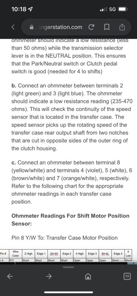

So far I have found two failures while going down the 94 and older 4x4 diagnostics write up on the tech page.
First is that the 4x4 module fails the self test by not lighting up at all. However, I have verified that it’s getting power and ground like it should. I’m assuming both my modules, one which was original to the truck, and the other which worked good on a buddies before he sent it to me are good, but the light simply doesn’t work anymore.
Second is that the test for the speed sensor failed completely. Continuity is broken for that circuit. (See attachment paragraph B for the test I’m doing)
My next question is, does that speed sensor also send data to the speedometer and Tachometer? Because both of those work fine, which would lead me to believe the sensor is fine and there must be a bad wire between it and the 4x4 module. If it doesn’t speak to the tach and Speedo then likely the sensor is bad and it could be an easy fix.
Last question is, does that transfer case speed sensor talk to the Rear ABS? I have a rear ABS light on the dash and have yet to begin diagnosing that issue. Would be sweet to fix two issues with one sensor.

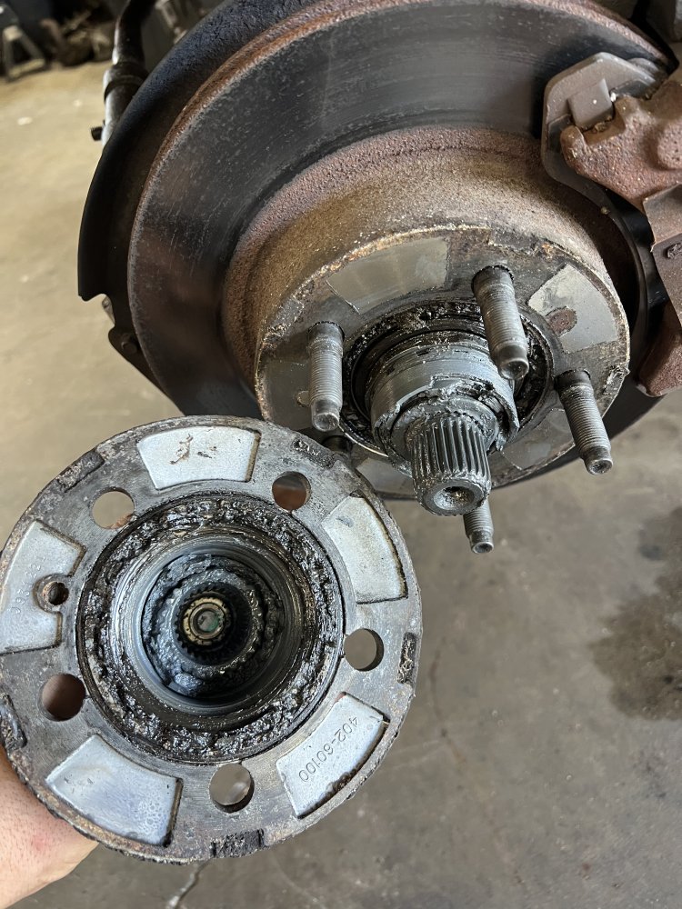

Dug into more stuff and I believe my auto hubs are toast. When jacked up I can spin the tire and it does not spin the axle or drive shaft. When I slip on the manual hubs I have, when locked it does spin everything. Unfortunately I didn’t realize I need a special socket and some other bits to swap to the manual hubs so that swap will have to wait.

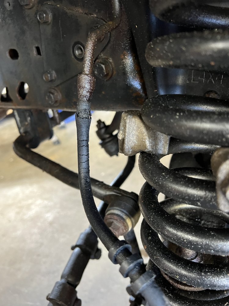

This was really my first time inspecting anything front end related, and I found that the rubber brake lines are about to blow. Therefore stainless braided lines are on the next parts order. Along with wheel bearings because the passenger side is a little loose. Other than that the brakes look really good, as do the steering joints which is a big win!

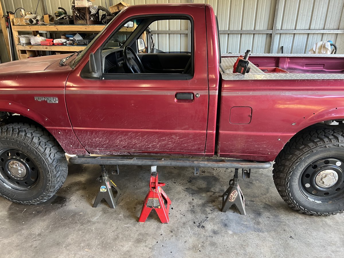

Anyway, last thing I did was mock up the sliders a little better, then washed and waxed it!
