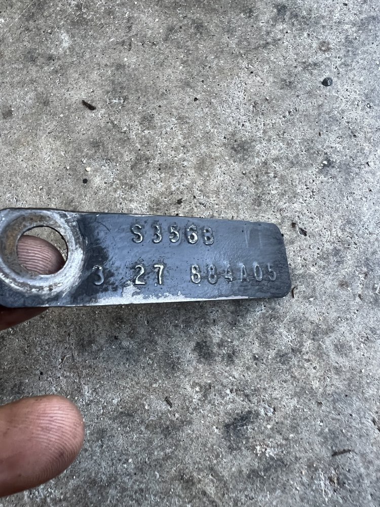

Cleaned the shop this morning and found the axle tag in the drain pan. Turns out this thing has 3.27 gears! This means 4.56s are gonna be crazy spunky.

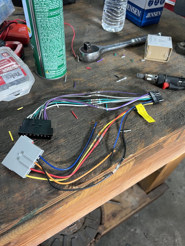

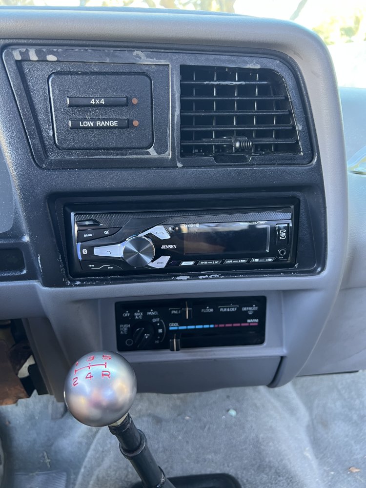

Also slapped in a cheap radio and two kicker speakers, got everything for $106 on crutchfield with the use of old rewards points and buying scratch and dent products.

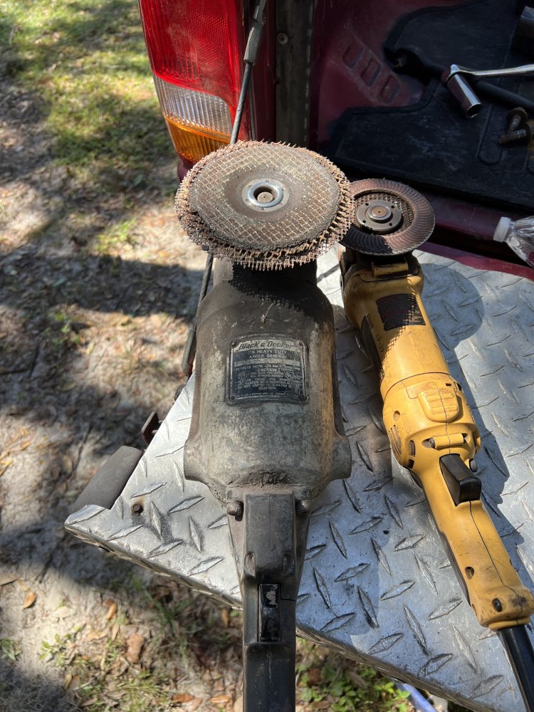

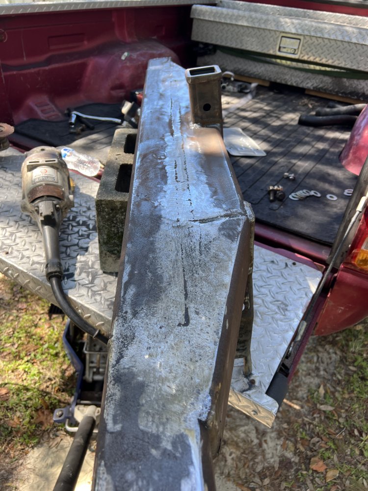

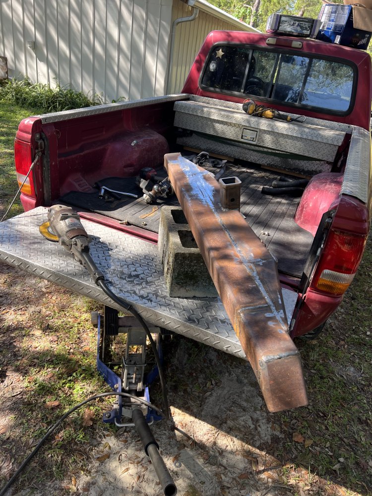

Bumper grinding has begun it’s a lot uhgg

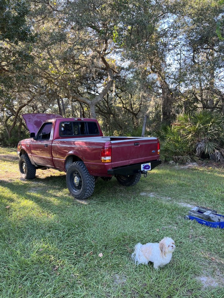

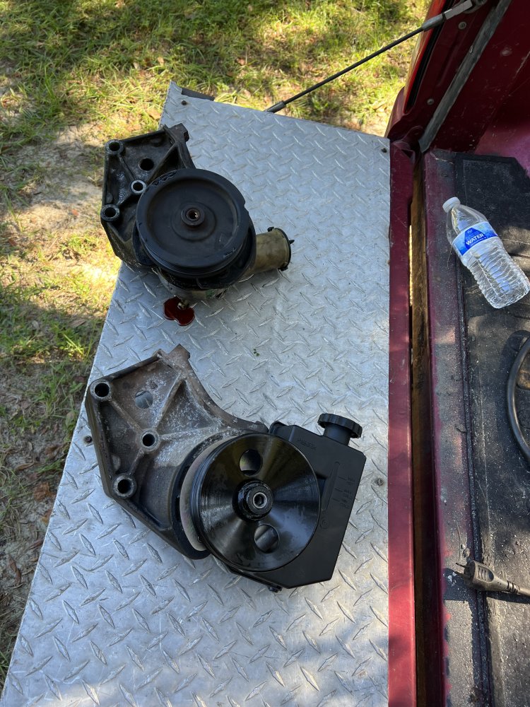

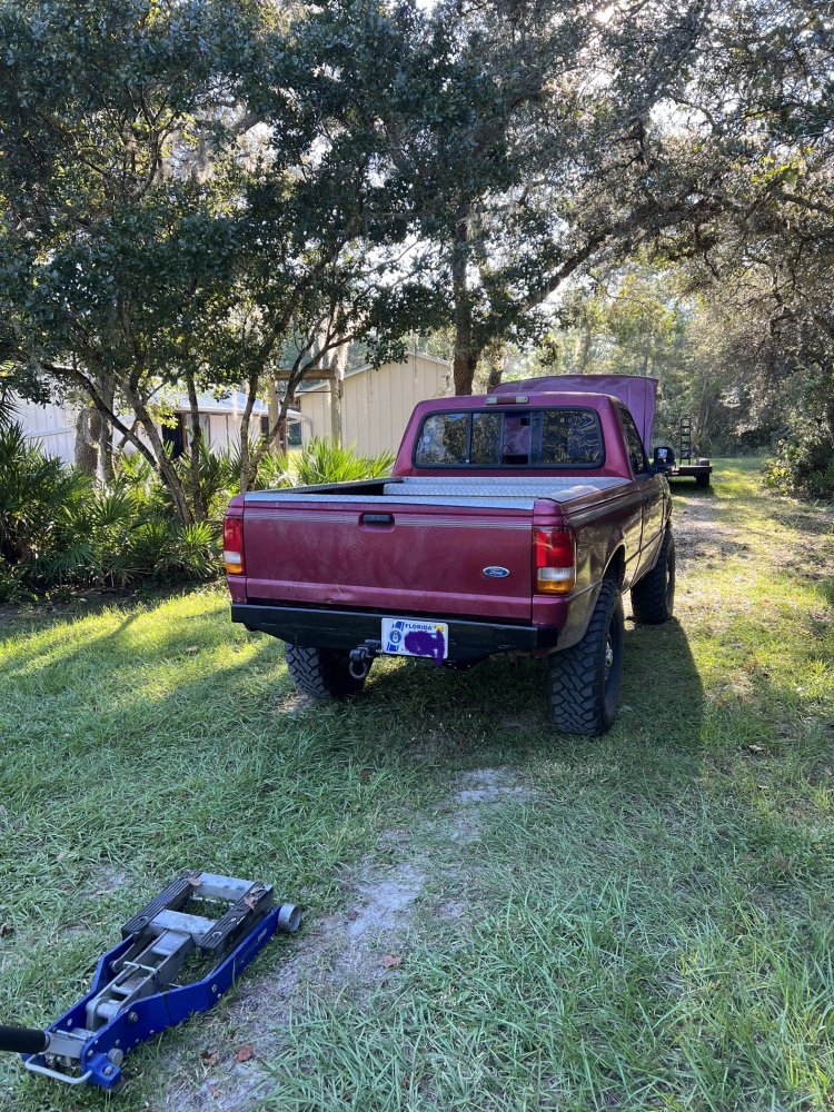

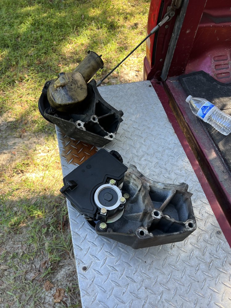

Bumper is done enough for me, many low spots where enough weld wasn’t added to grind it flush but oh well. I’m gonna beat it up anyway. Jeep Liberty PS swap was fairly easy, only downside is that I still have 90% of the whine I could hear while driving. Pretty sure it’s input shaft bearing on the tranny.

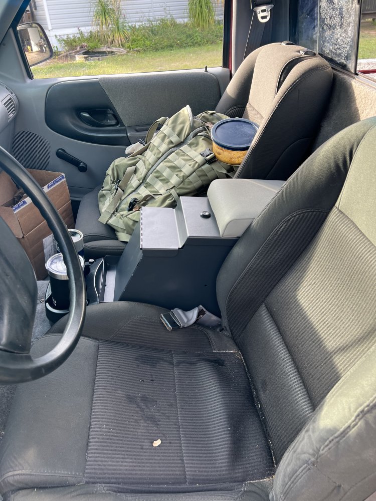

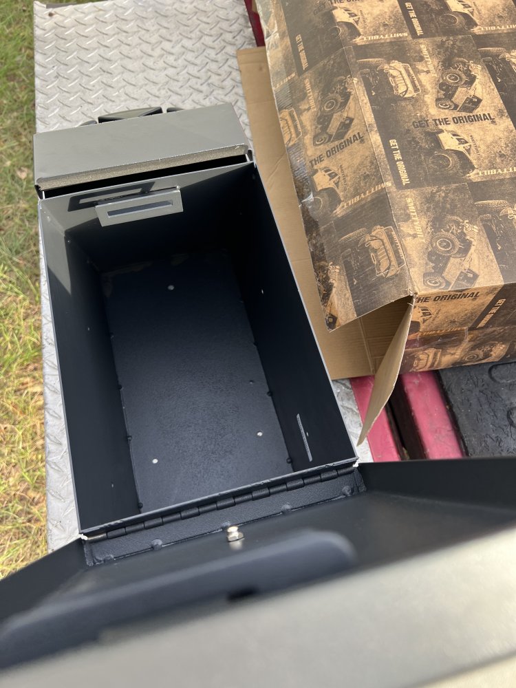

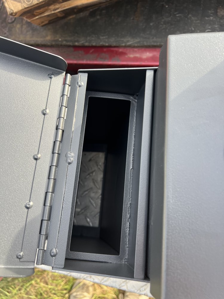

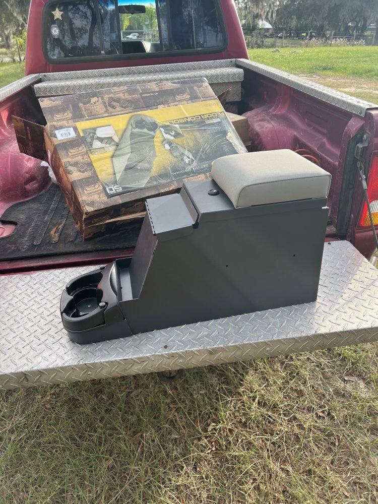

My smittybuilt center console showed up today. $66 on sale on Amazon and this thing is freaking nice! Locks well and feels fairly durable. The pad is very comfy although it’s a little far back to rest your arm on while driving, gonna wait in mounting it until I figure out if I want to remove the cup holders so it will slide closer to the shifter or what.

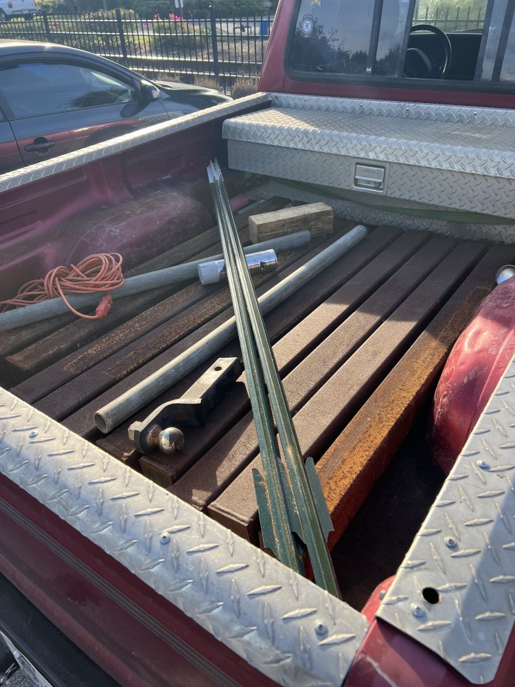

I also picked up more free 4x4 steel and some thick wall tube. I might highcut the fenders and wrap the bumper all the way around, similar to how a lot of Toyota guys do it now.

That rear bumper looks pretty squared up now... looks like you lowered the passenger side.
I almost bought one of those smittybuilt consoles. I think the only one I saw was like 9 inches wide. How wide is the one you bought?
Yep I was unable to get the driver side up without cutting off the mount and re welding it which was more work than slapping in a few washers.
The console is 9” wide and it fits perfect between these mustang seats and the seat belt female side, just wish the cushion was further forward. I would have bought the black cushion model but it was $30 more.
Yeah I was going to put that console in my pick up... I have the 60/40 split bench. I would have had to make them buckets and wasn't sure that it would fit. I have a Tuffy console going in my Bronco II and bought the 6 inch wide version. The 8 inch wide probably would have rubbed on the seat tracks and made seat belts harder to access.
That was a good deal though... I saw them at 4WP for about the same price. But that deal is gone now.
I was really close to buying an original explorer console, but it cost more and then I’d have to deal with old brittle plastic. I’m super shocked that even the cup holders which had the most negative comments seem to be fine for me. They aren’t the best design ever, but heck most new vehicles have garbage cup holders anyway.
Those tuffy consoles are nice, the price is too steep for me tho.

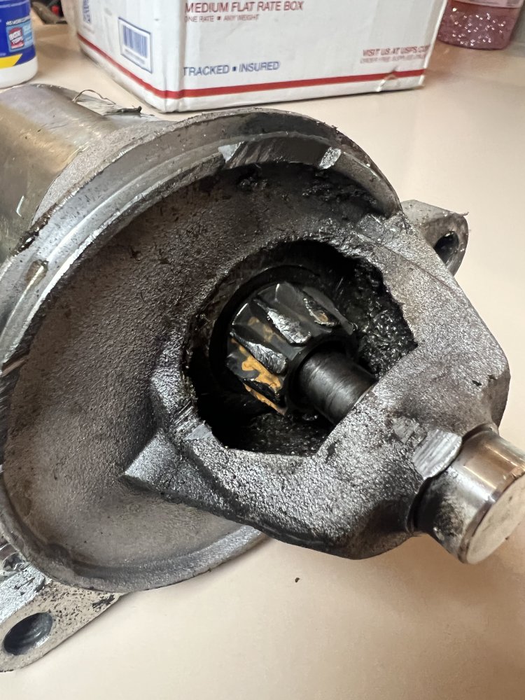

Started sounded funny last night and didn’t actually start the truck so I took a look at it, and found it very loose. Tightened it back up but the damage was already done. The thing had been making noise since day one, but I wasn’t 100% convinced it was the starter since sometimes the noise would go away for days. Turns out I ordered one for an auto trans and there is a small difference I was unaware of which led to this. Oh well, that was a cheap amazon/china starter. I picked up a nicer looking Delco Gold replacement that hopefully won’t make any noise.
  • Dans 94, RCSB, 4.0, 4x4, 5spd
Wow the new starter seems to have fixed several things. Along with the weird rattle noise in startup there was a deeper low knocking sound that I kinda thought might have been something not getting oil right away during cranking. I even added a qt of atf to the oil for awhile to clean out whatever sludge might still be in the oil galley. It seems the new proper starter made that noise go away too so I’m thrilled!
