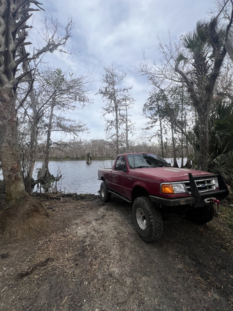

Without going back through your thread...
Are those Kenda Klever RT's?
What size?
They are and they are my personal new favorite tire. These are 33x10.5x15. I expected them to be good in gravel, sand, and loose rock. But what surprised me is their ability to clean out mud like an MT without sounding like one on the road

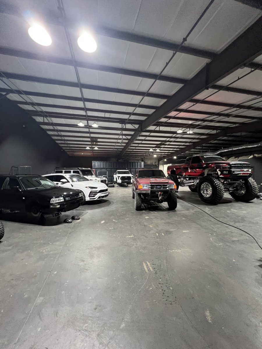

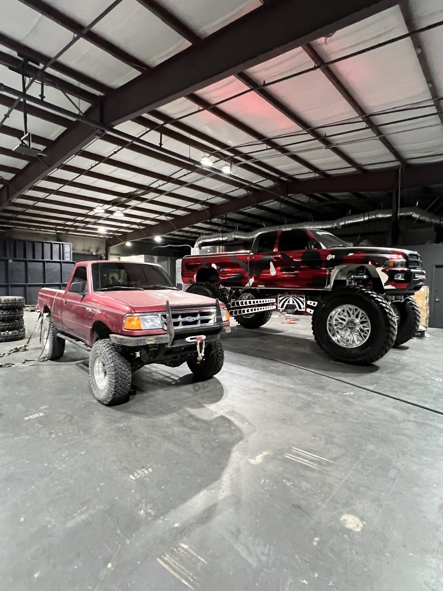

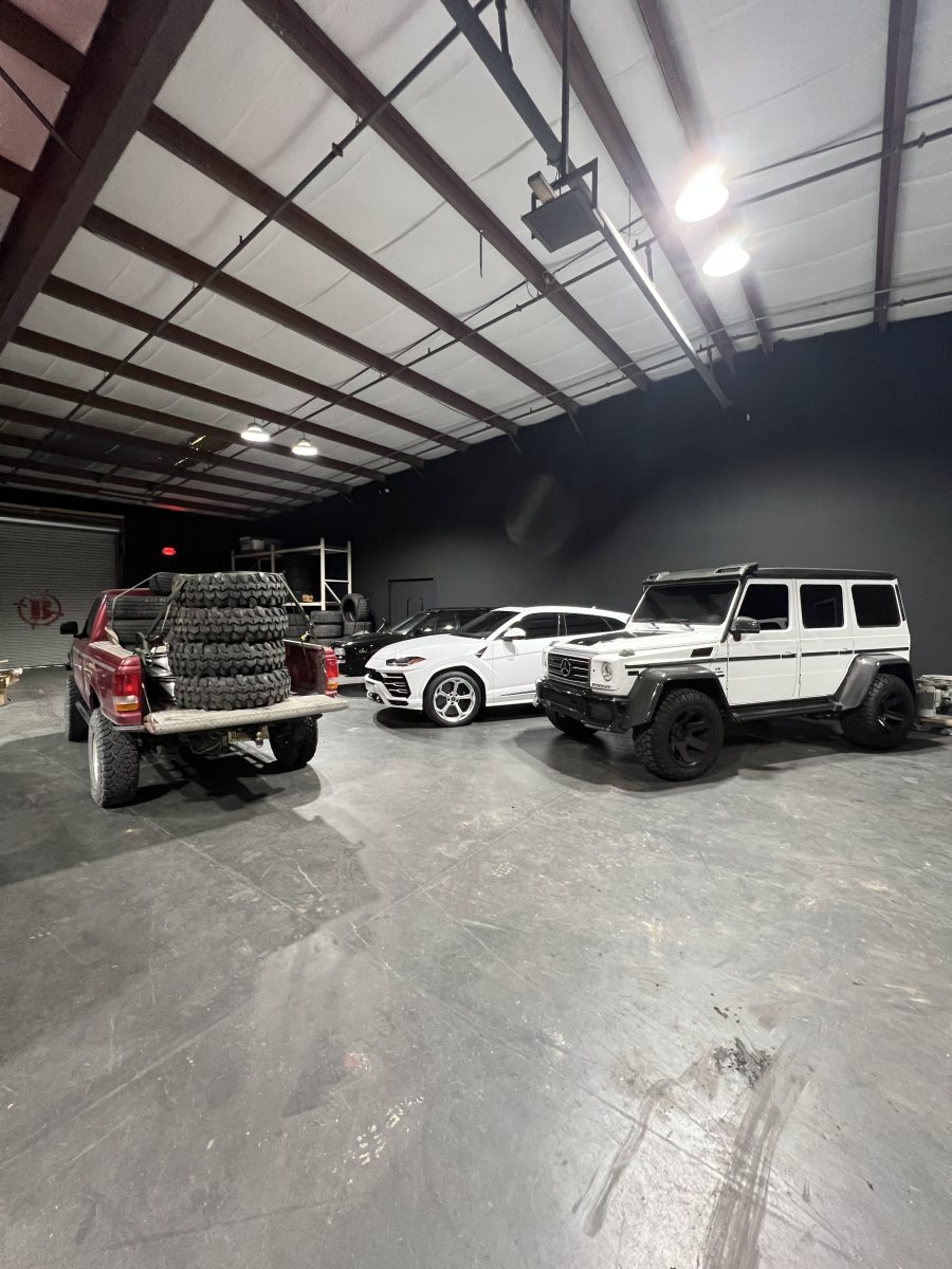

Speaking of tires I took a load of stuff over to my buddies powder shop to have thing swapped around and he let me drive this POS in next to the lambos, and show trucks.

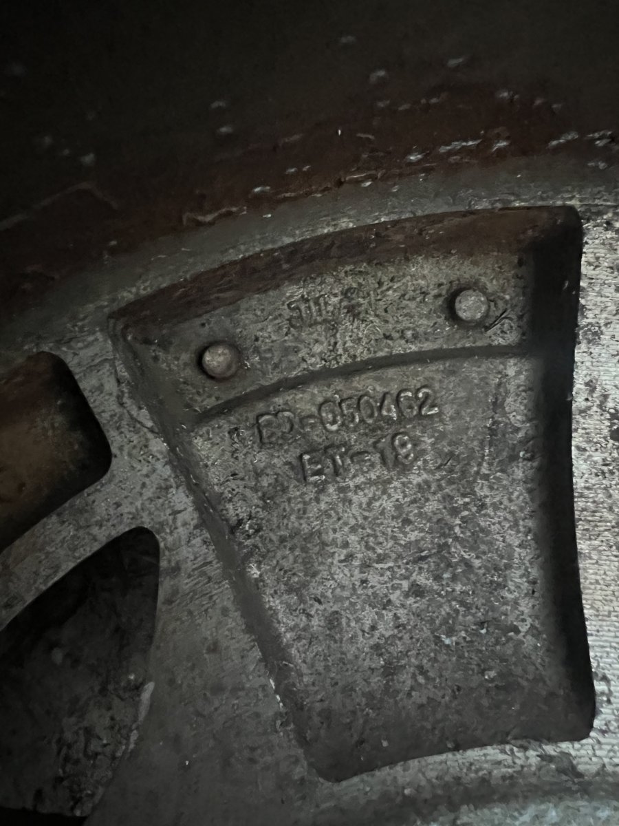

What is the width and backspace on your wheels?

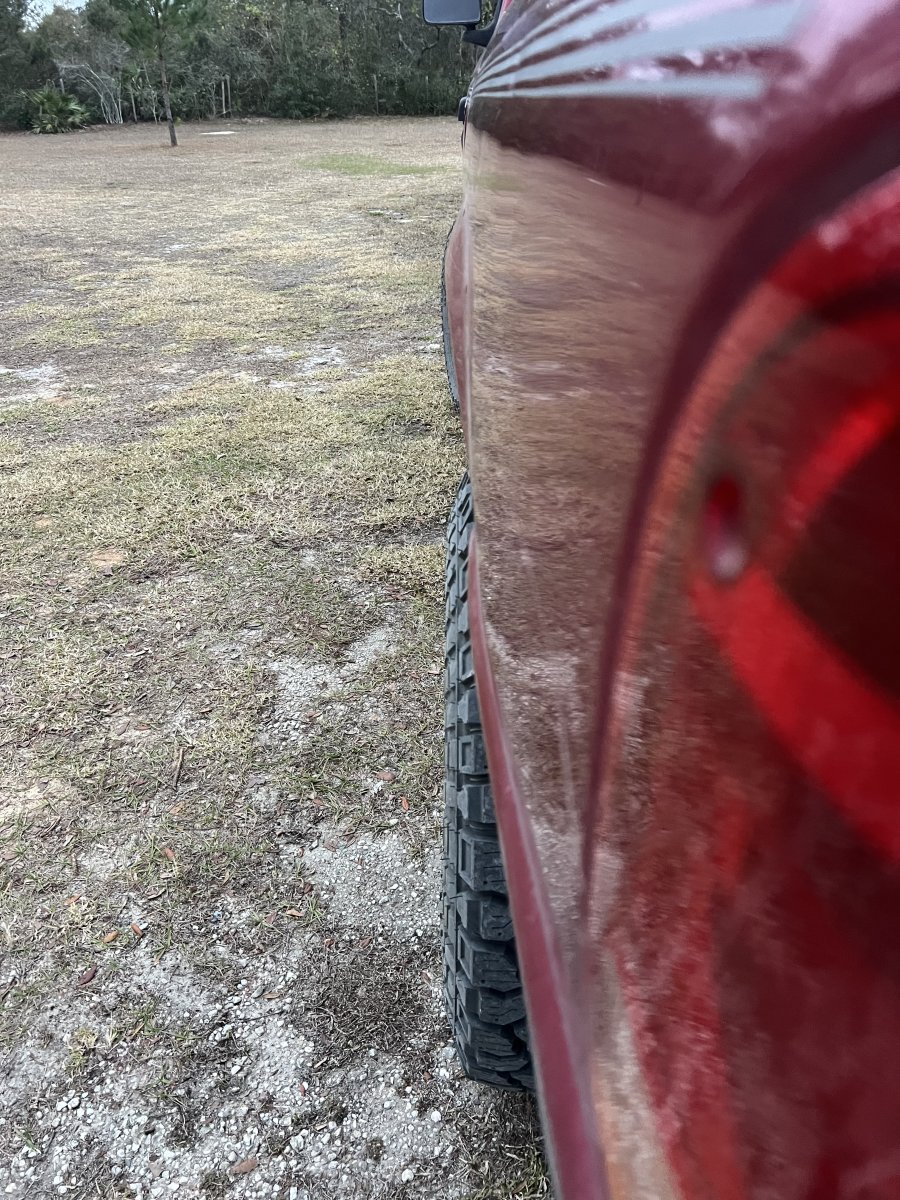

I will check to see width and BS when I get home but I’m pretty sure they are 15x7 with -19 BS.
No spacers at all
I think the road manors are fantastic! I have a set of AT3W Falkens on a Tacoma and they are similar in noise IMO. Also that’s almost unfair to test because the Tacoma stays at proper air pressure 30ish and I keep these in the low 20s even on the street. Also to speak to road manors I can say yesterday I did some really aggressive braking on the lime rock roads I was running and I did not get ABS to kick in or feel the fronts lock up, they just gripped and slowed me down very very quickly. (This truck is rear abs only)
In the rain I have no fear, although this truck doesn’t really go above 65 ever and I don’t do a lot of highway.
Couldn’t tell you about snow but they are studable.
The 9.5s are cool but so are the 35x10.5s.
No spacers at all

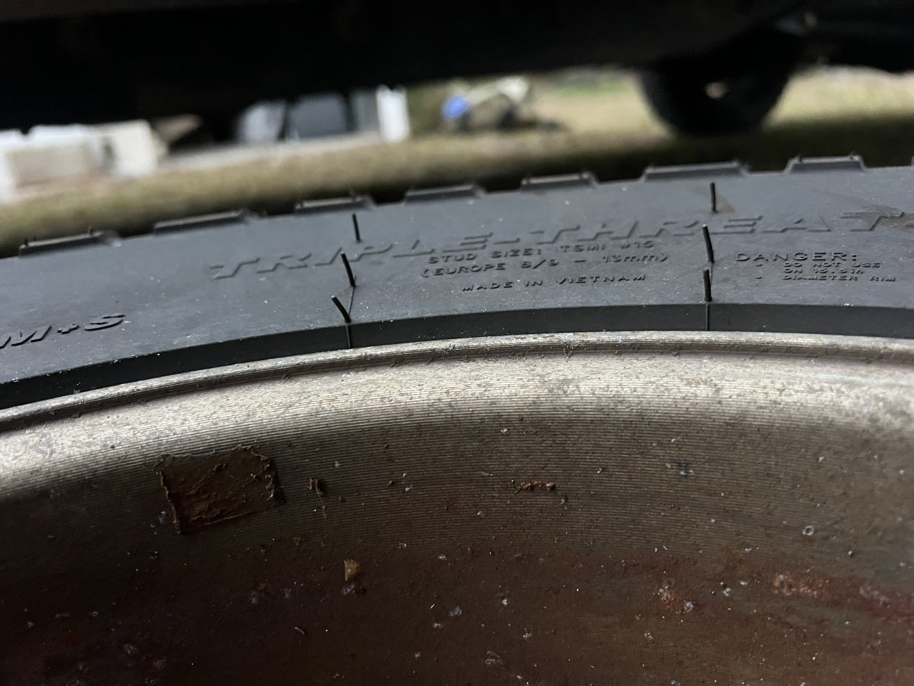

Last thing... do they have a bead protector that stands proud of the wheel?

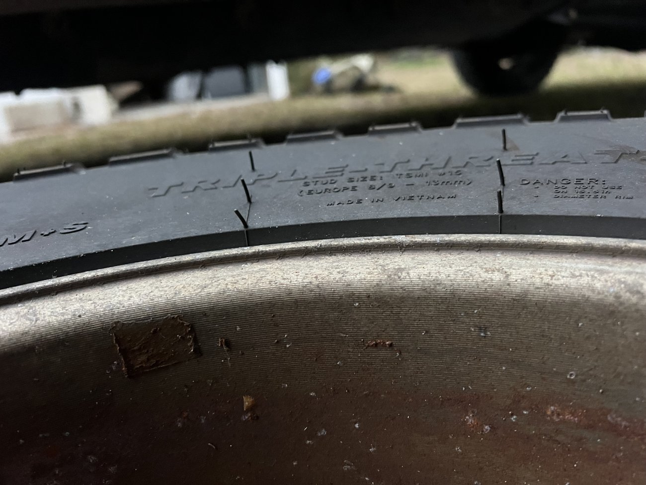

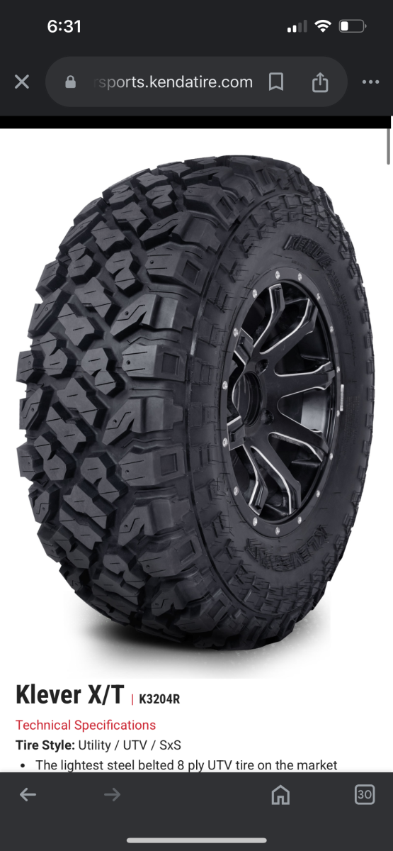

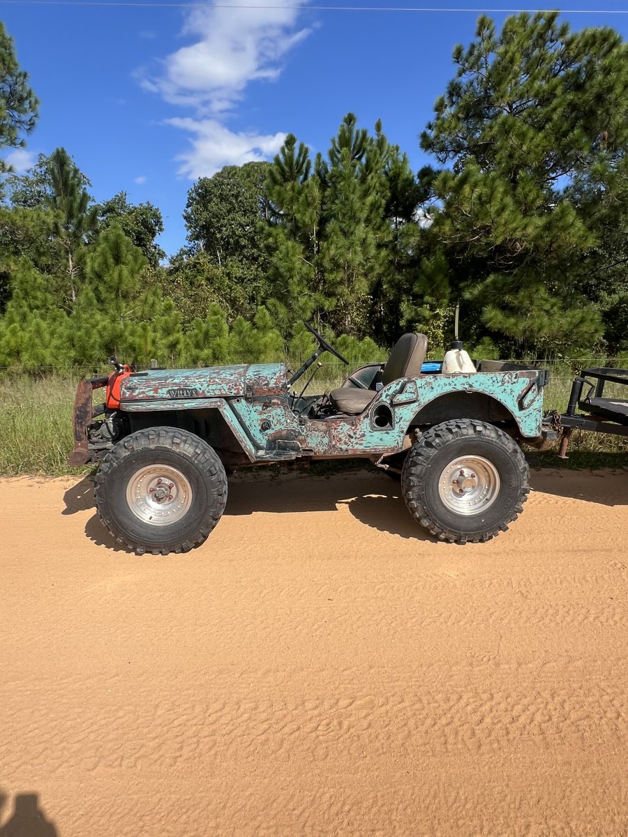

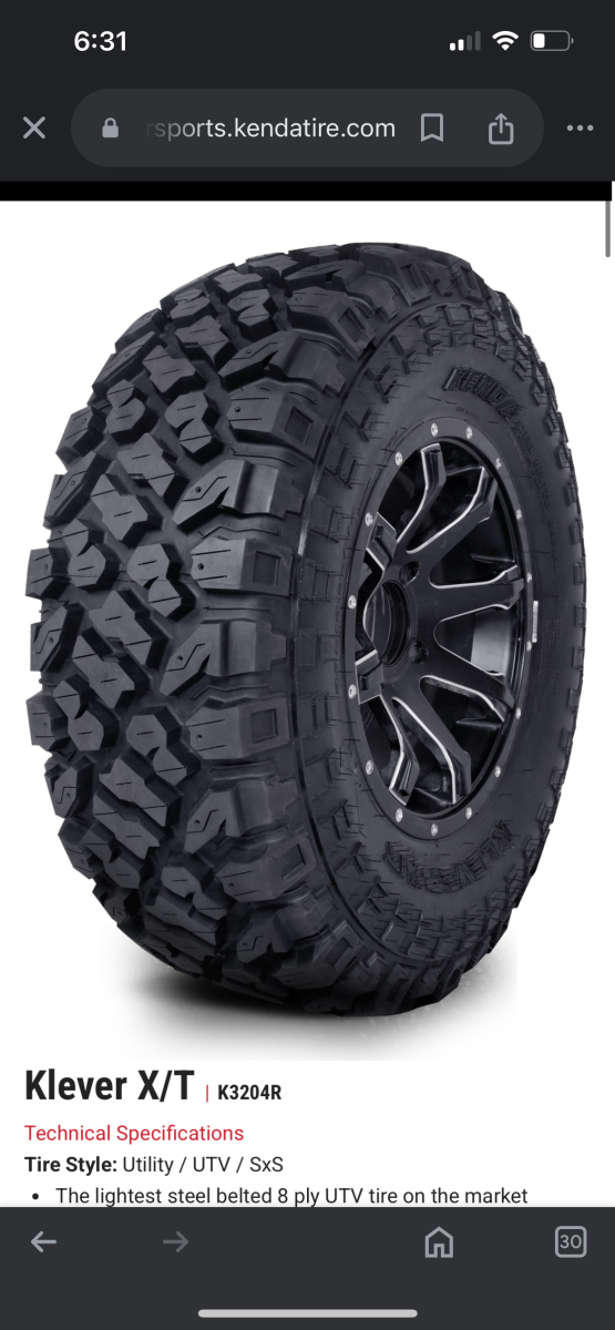

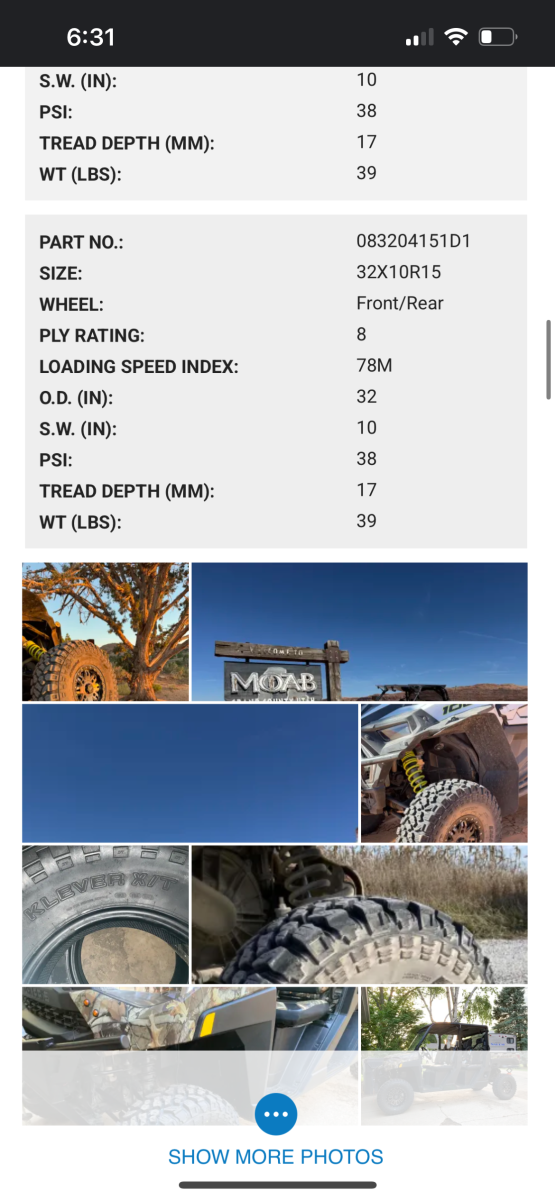

lol I feel ya on the 35s which is why I went with a 33x10.5 load C tire for weight savings mostly. These wheels are okay but I have my eye out for some factory forged fx4level 2 wheels (not sure how much they weigh but being forged I’m hoping in the mid teens). Or any 15” forged wheel to shed a few more pounds. I have a set of 15x7 in 5x5.5 that are forged and I just weighed them at 14# for my CJ2A im pumped! Gonna run kendas UTV Klever XT in 32x10 on them, it’s based on the RT but even lighter I’ll have a nearly 50# setup since the wheels are 14# and the tires are 37iirc.
Anyway less need stuff and back to your questions.
I was right 15x7-19bs.
And yes they have a good thick bead protector!
I hope I don’t sound overly positive about these tires but I plan to put them on basically everything I have based on price, sizes they offer, and how they have performed for me. They are the first RT I’ve tested and I see no reason to get an MT anymore.

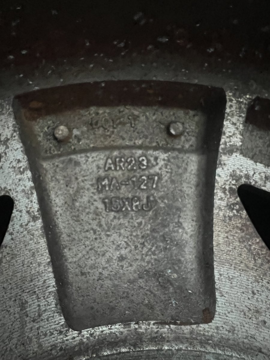

The billet or forged 15x5.5s I was referencing as well as the Kenda XT 32x10.

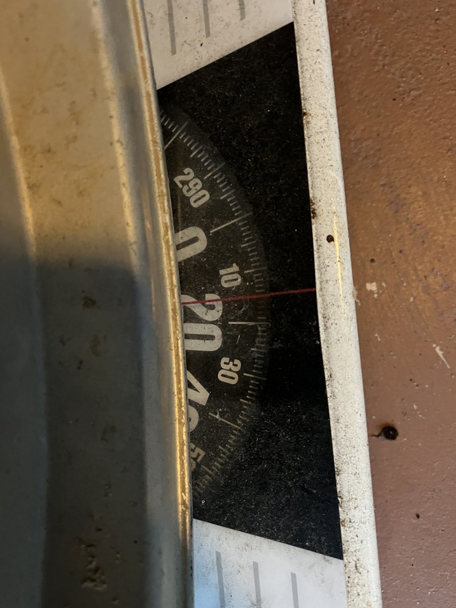

I have a wheel in the garage with no tire or wheel weights... I'll put it on the scale tomorrow and let you know. Your or my scale won't be scientific... but somewhere close I'd guess. I like to keep my wheel and tire choice as lite as I can too.
That's a nice bead protector... I like it.

Oh yes please do give me a weight! I was seeing 21# on some places I saw them for sale but that seems pretty heavy to me. Also I don’t care about stance, I’m function over form 99% of the time.

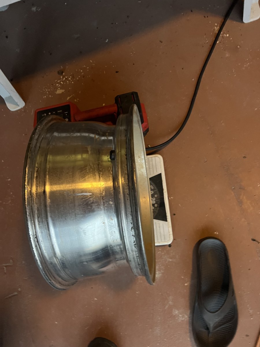

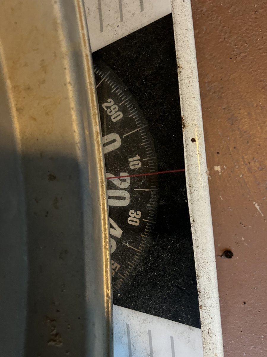

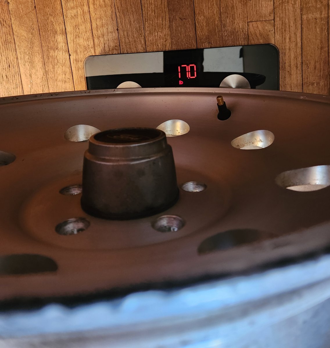

Alcoa forged wheel... with center cap and valve stem. No wheel weights...
Like I said... not scientific but as accurate as a digital bathroom can be.
I'll add that I repeated the weight test 3 times. All ended at 17 lbs.
Thank you! 17 isn’t as light as I hoped, had my fingers crossed for sub 15# but still not bad. I’ll have to dig up and see how much my American racing cast wheels weigh.

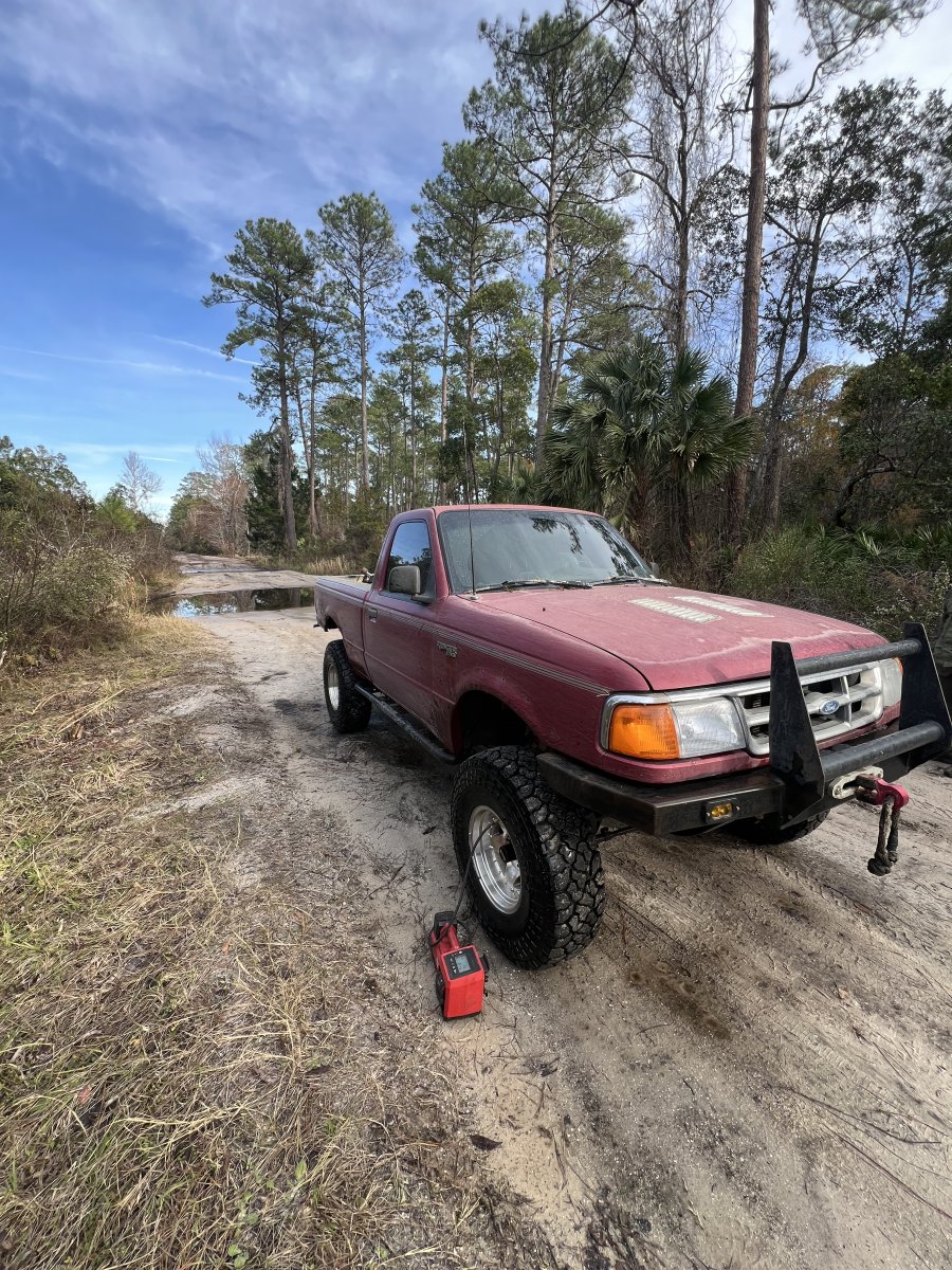

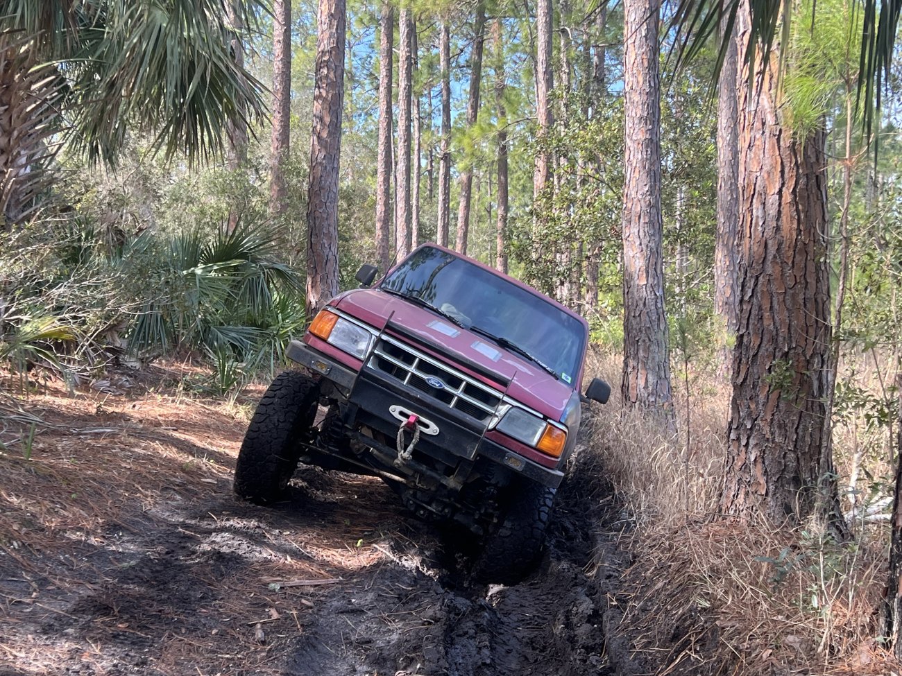

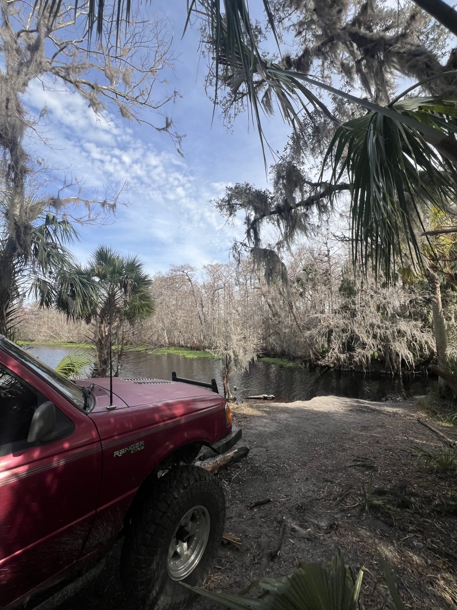

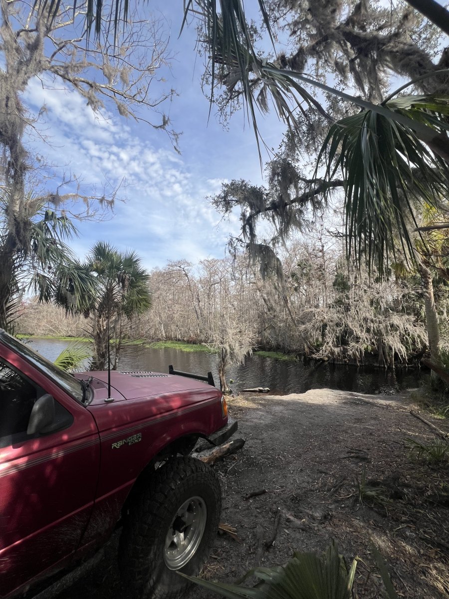

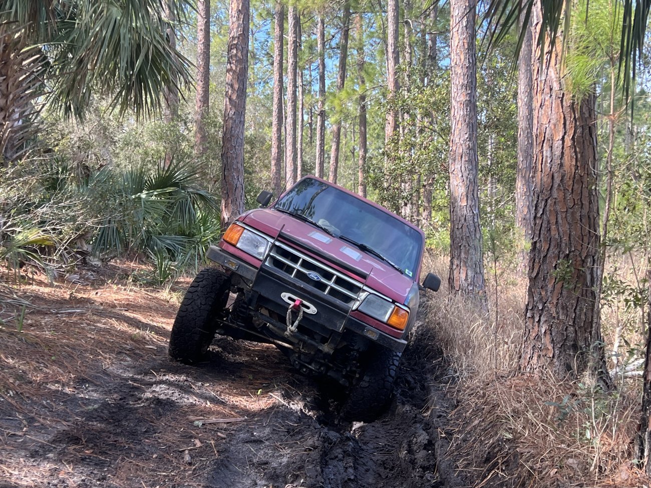

Had a blast today scouting new trails, new boat launches, and new places to hike. I keep planning these trips simply by searching Google satellite view and trying to spot anomalies in the tree canopy’s and it keeps working. Did a lot of easy dirt roads which are fun to blast down, did a bunch of water/mud crossings, some long extremely rough trails that just toss you side to side, and a few miles of dense scrub that was once a trail and now is just torture on your paint.

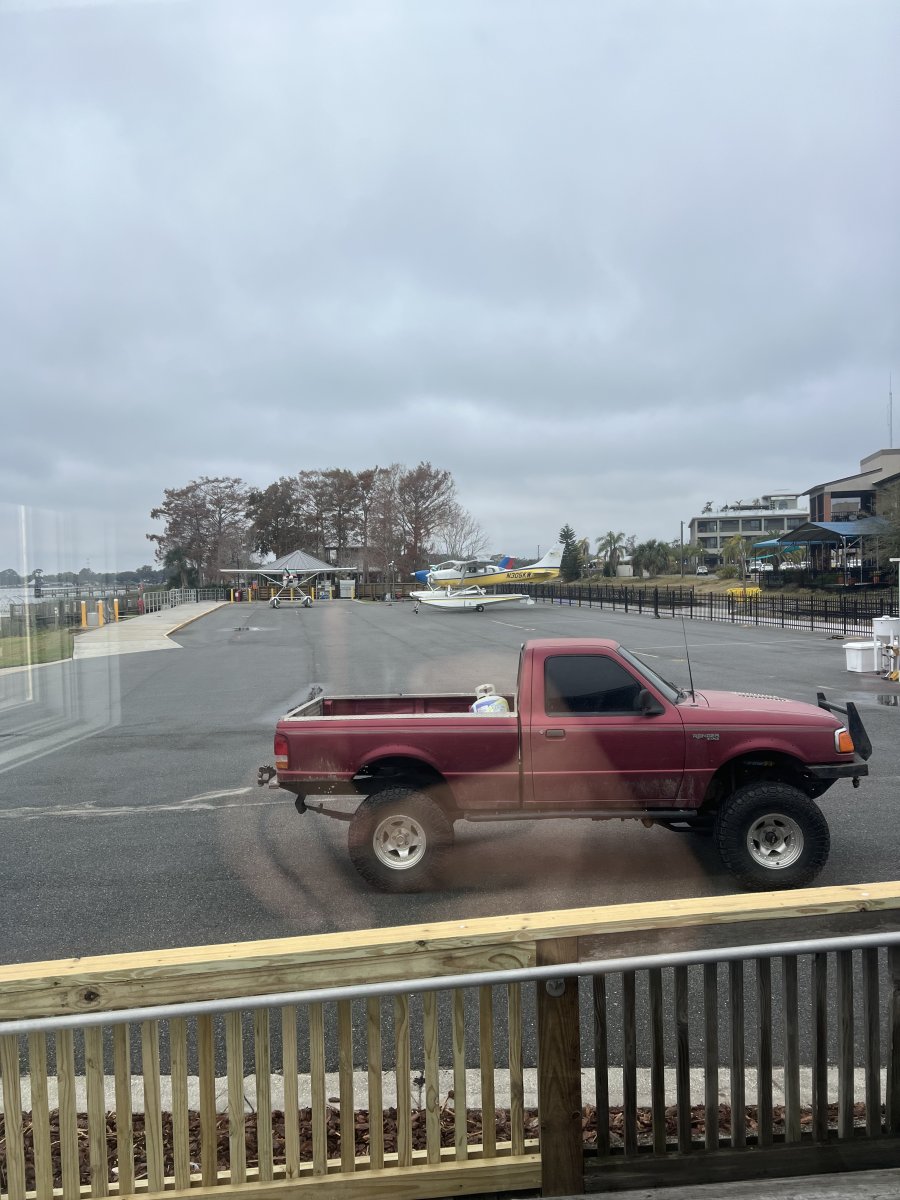

Been nasty out so I figured I should park really close to my office. Made for a nice office view 😎
