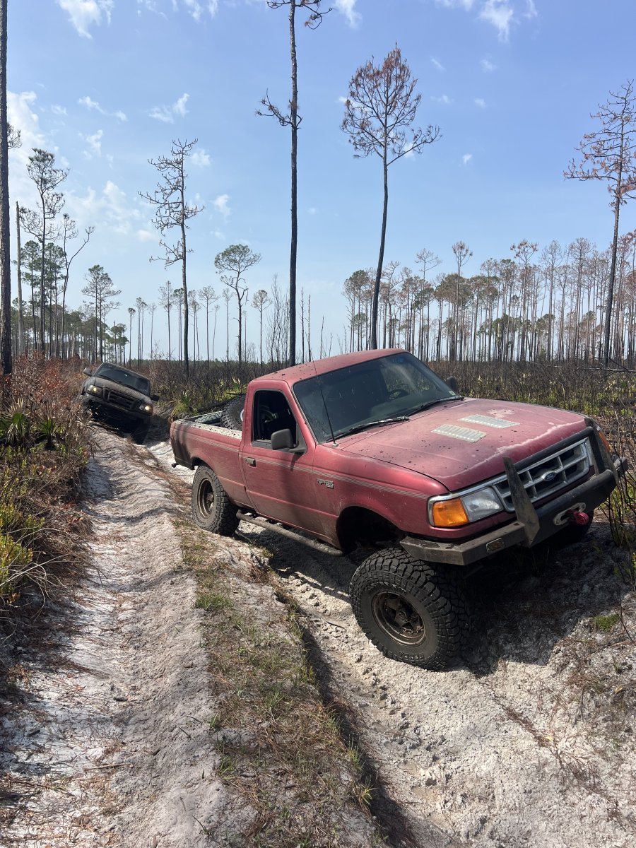

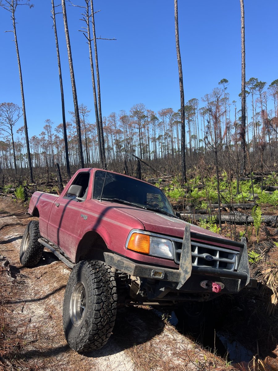

Went out again today with a buddy and made him drive the whole time to try and convince him to get a 4x4 mini truck. Trip was a blast I got him to hit some whoops, do some crawling, some little mud holes, and a lot of trail cruising. He got it stuck a few times and we did a bunch of hoping in and out to lock in the hubs and once we had to winch to a tree.

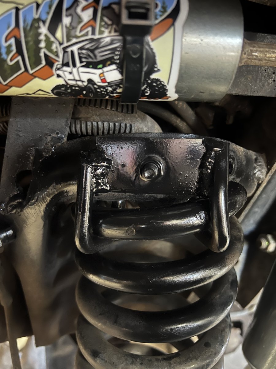

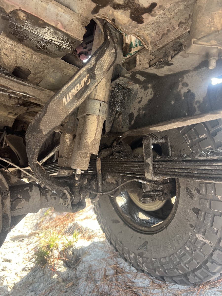

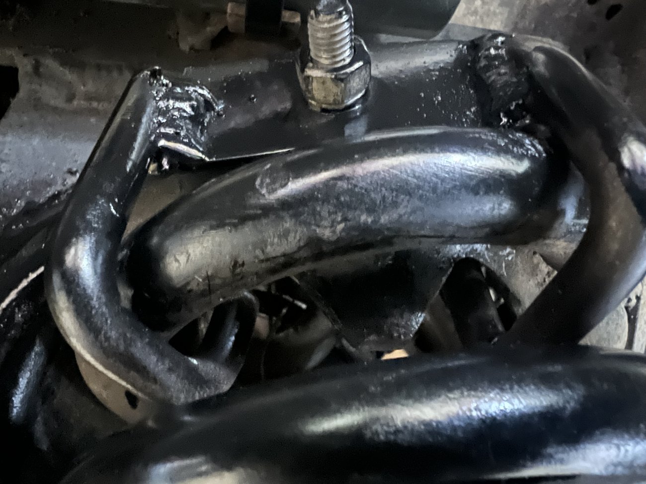

Also there was an exciting part when he hopped over a downed palm tree with a bit too much gusto and the driver side coil spring bounced off the top of the bucket. I didn’t bring a jack and I really need to buy an offroad style jack. I was able to use half a deer stand ladder I collected as trash to hook my winch high up a trees then push the spring back into place, tighten the retainer and continue on with the day without issue.
I’ll redesign my coil retainers and buy an offroad jack sometime soon!

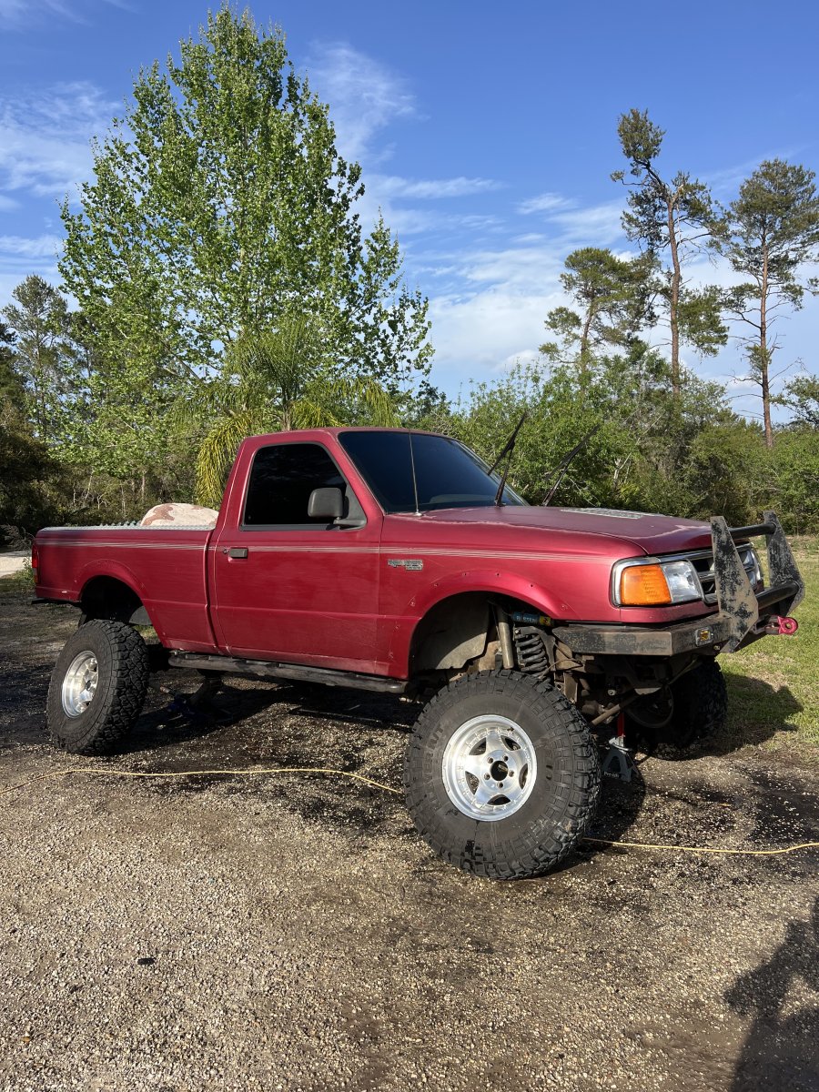

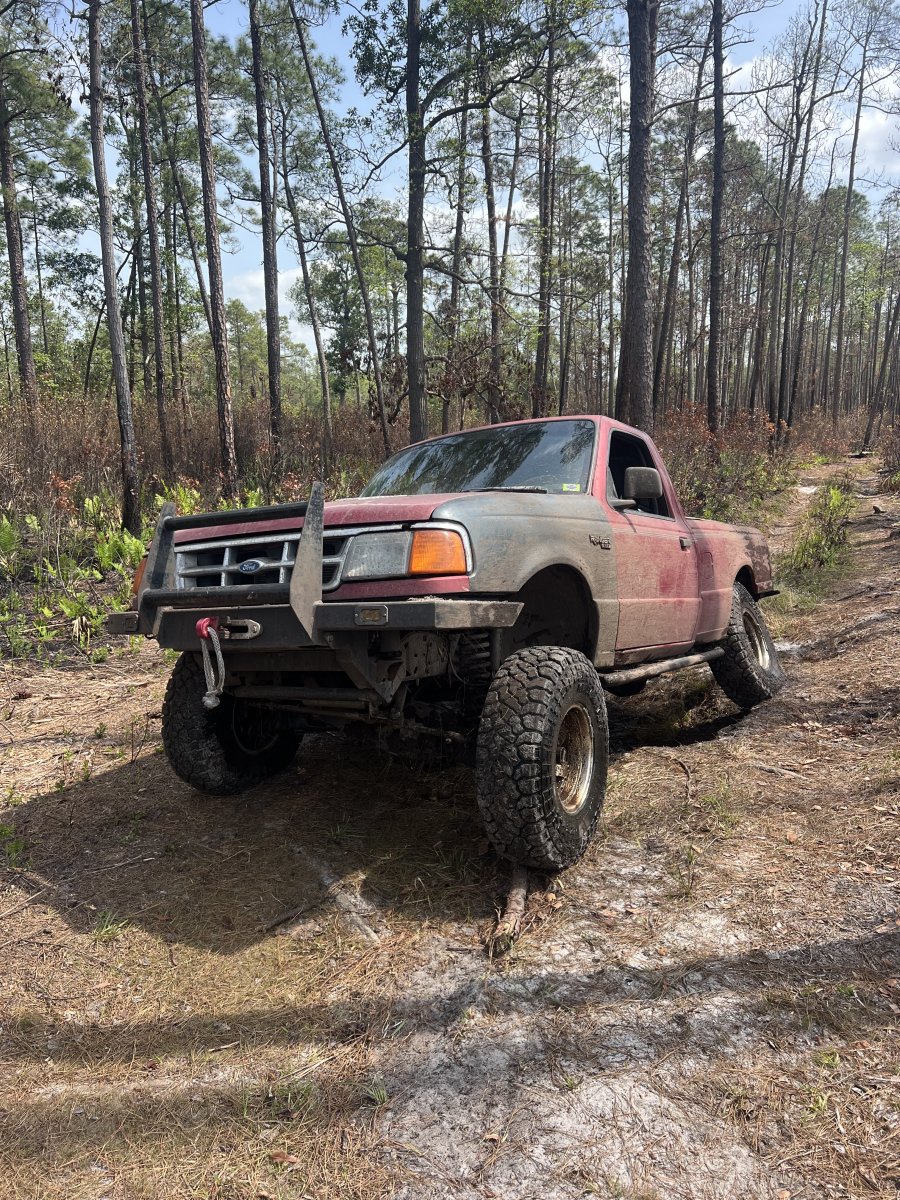

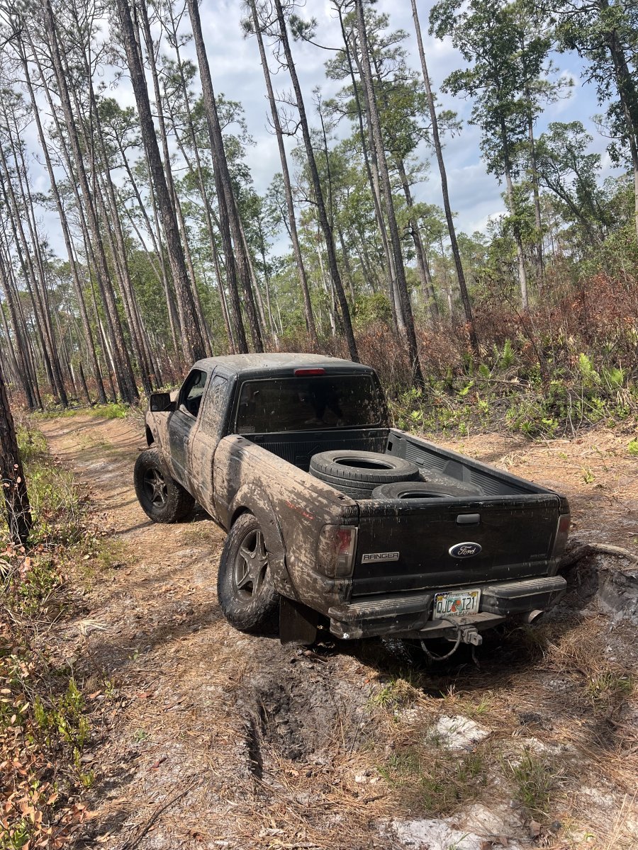

Got egged into going out wheeling with a friend in his 2011 ranger. Had a great time as always and his a arm rough county lift somewhat impressed me. I feel like I need to pull my shocks for an inspection and check the pressures something feels off in the whoops. Also got just 100 miles on 11 gallons of gas. Not sure what’s wrong I’ll run it to and from work all week and see if it improves if not I’ll pull plugs.

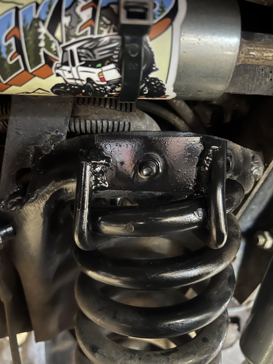

Ended up doing the above trick as well as using paint markers in the inside of the wheel and tire just to see if it lasts. Also rebuilt the coil spring retainer on the driver side to have much more strength and completely capture the coil. Inspected wheel bearings again and noticed the passenger was a tad loose so I snugged that up.

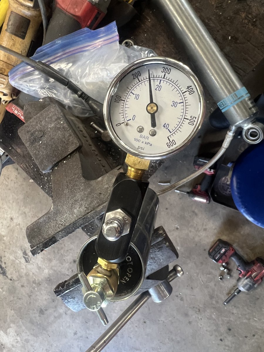

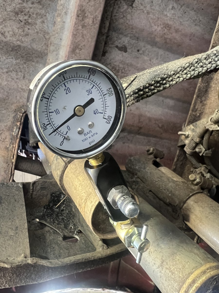

Pulled all 4 shocks out of the truck for a cleaning and inspection and noticed something surprising. The fronts were right at 240-250psi, but the backs were almost empty! Driver side was like 20psi and passenger is near zero. I’ve heard a lot of horror stories of shock QC these days and the fronts came from Wheel every weekend who checks each individual shock before sending them out. The backs came from 4wheel parts because they were the only people that had them in stock at the time. I guess I learned my lesson and will continue to buy from WEW in the future. Gonna juice these up sometime soon and hopefully enjoy better ride quality.
