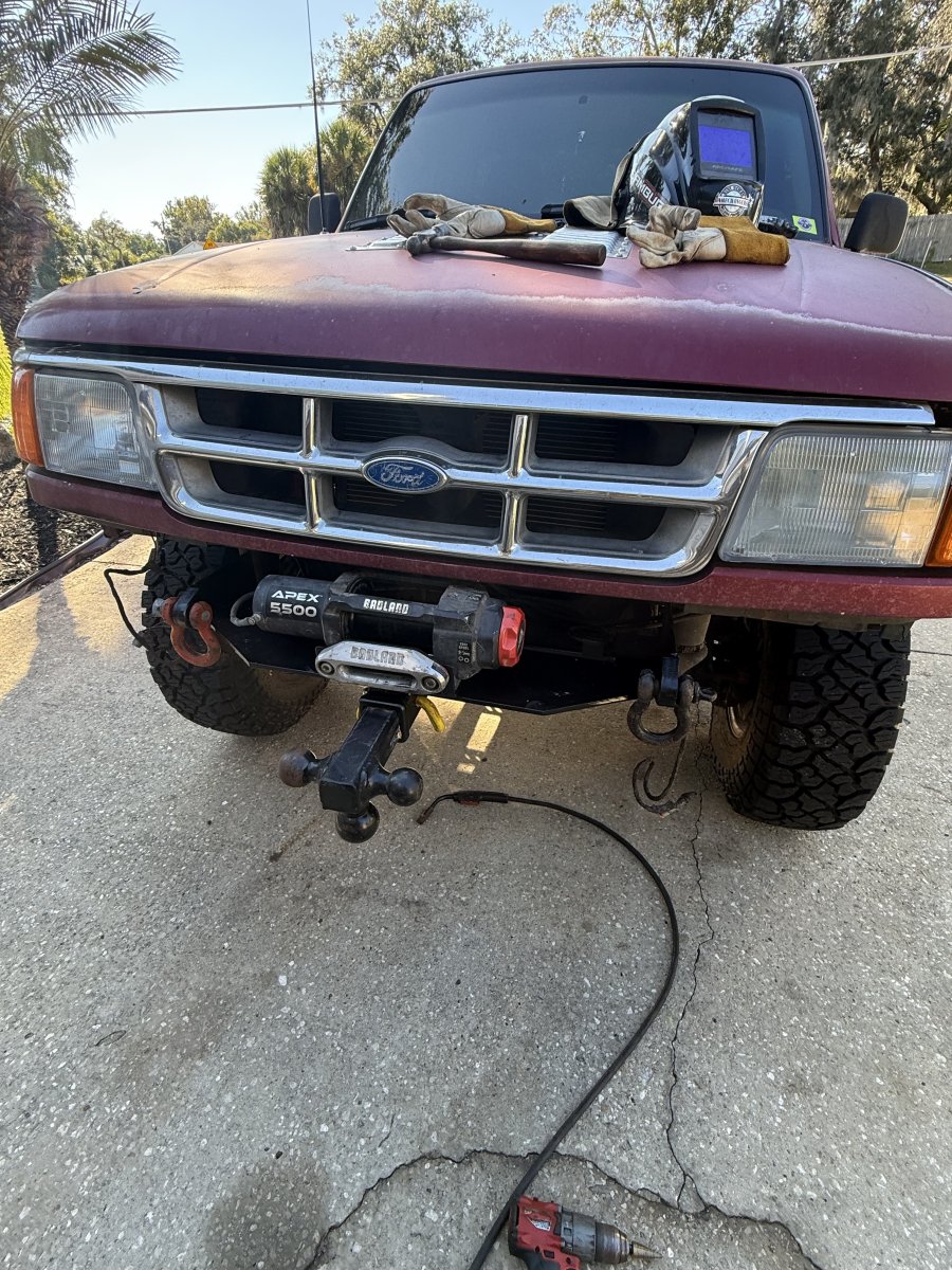

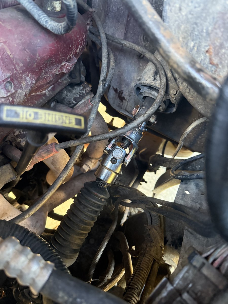

Made more progress on the new bumper over the last few weeks. Added a bunch of 1.5x1.5x .125 square tube, as well as a larger fairlead and moved it out further, a diamond plate filler panel, and fog lights. Pretty happy so far, not totally done but it’s getting there. Also cut out the top rag joint in my ISS and welded in U joint which cured a lot of steering slop.

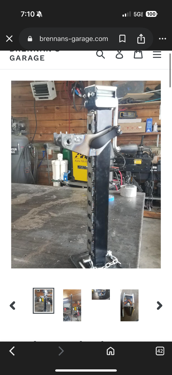

I think I’m going to finally order a Tauler jack from Brennans Garage. It’s a a pretty slick and much safer high lift jack in my opinion.

Also heavy as heck, and hard to stow. I figured these Tauler jacks are a one hand lift item and for someone with neck/back injuries that’s worth gold. It’s also an excuse to weld stuff
