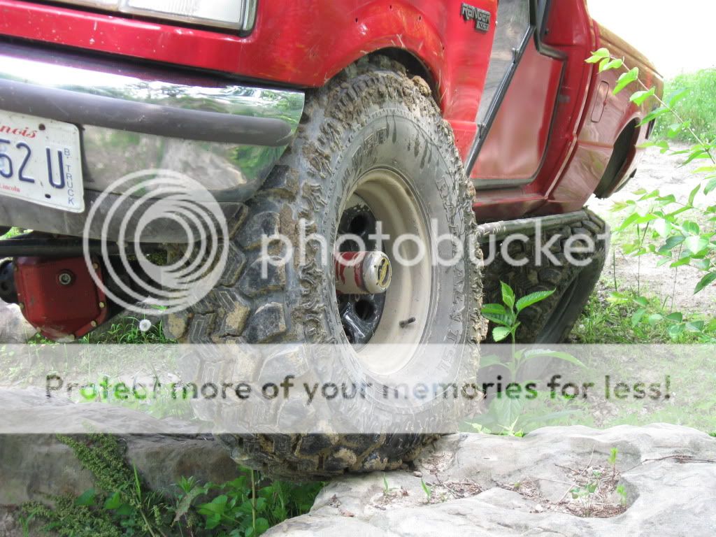

is the ssr a radial tire? i am thinking about running those tires, the 35x10.50 but i dont know how long lasting they are for a dd? i guess i'll find out from you!
I had SSRs for a little while. They are a fantastic tire. The soft compound really makes them grab onto anything. It does however reduce the miles that can be gotten out of them on the road.
My buddy ran them on his f-150. The 35's held up great to road use. Aren't near as loud as other super swampers
We'll see how long they last. I got a rediculous amount of miles outta my Kumho's (~70k). I was debating whether to get the TSL radials or the SSR's. I wasn't sure I could pull the 36" TSL's so I went with the 35" SSR's. Not sure how they compare performance wise, but I figured I couldn't go wrong with a swamper.

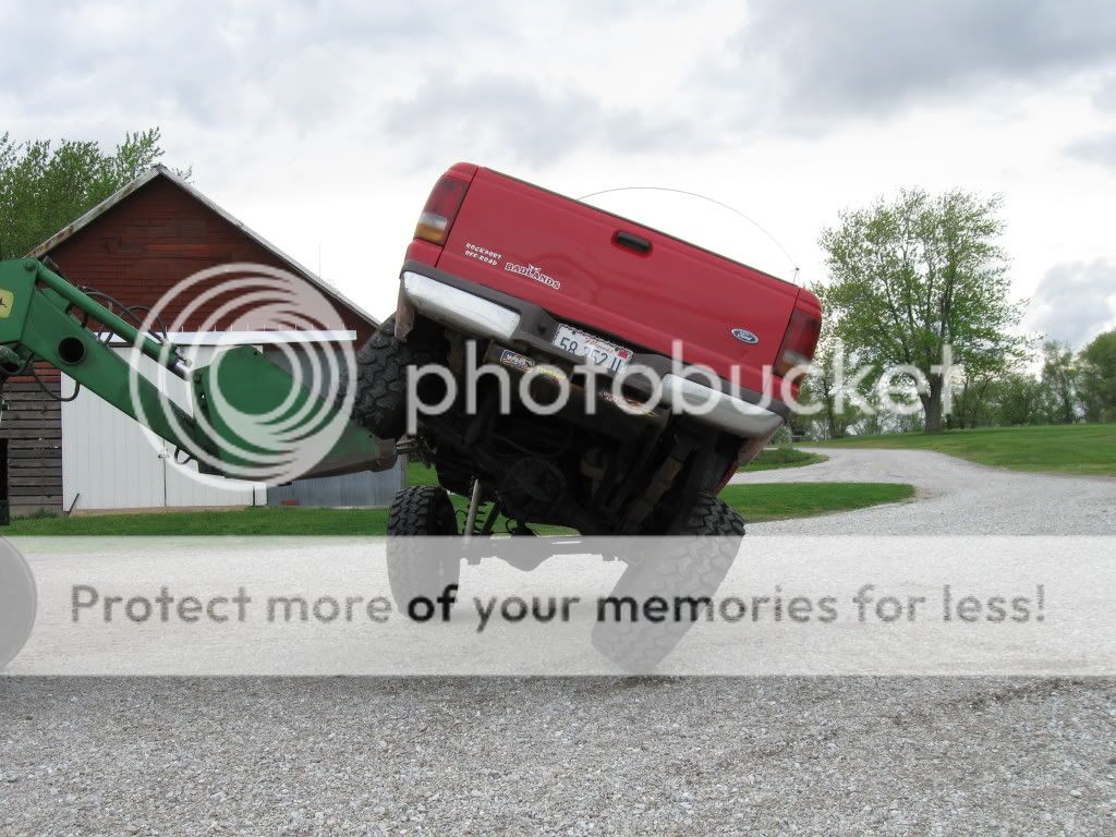

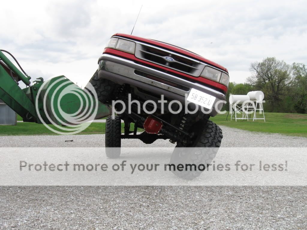

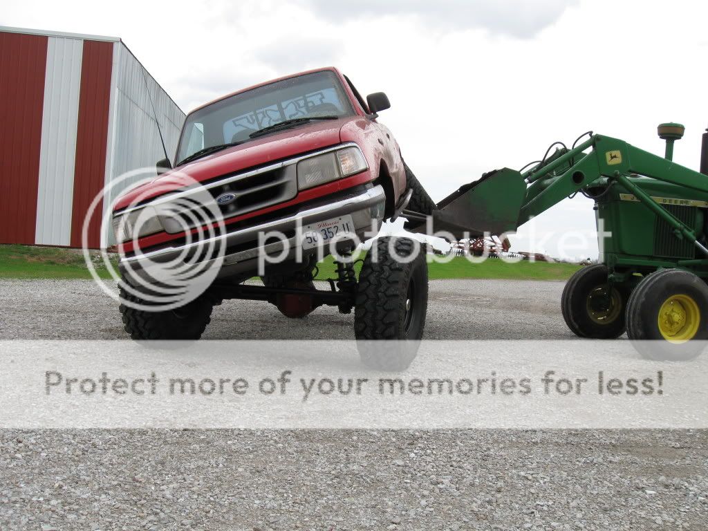

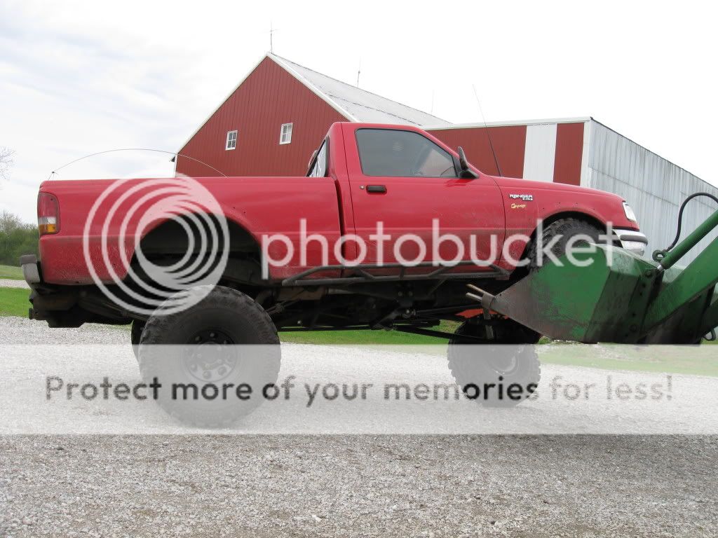

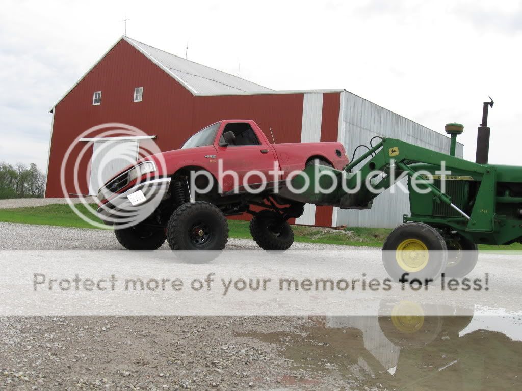

I couldn't help myself so I headed to the shop and got the loader out. 34" with the front lifted and 40" with the rear at street pressure (35psi). I was hoping for more, but looking at the pics I'd say its not too bad.

Took it out in the woods this weekend. No pics or vid. I think everyone out there had a camera but noone wanted to take pics lol. Wasn't holding much back. It met all my expectations. It was pretty soupy in some spots and I never got stuck. Had the SSR's at 10psi, and they were barely even squating. I couldn't hardly take my Kumho's lower than 15-18 and they were flat due to their super weak sidwalls. I'm likin the tires so far :icon_thumby:

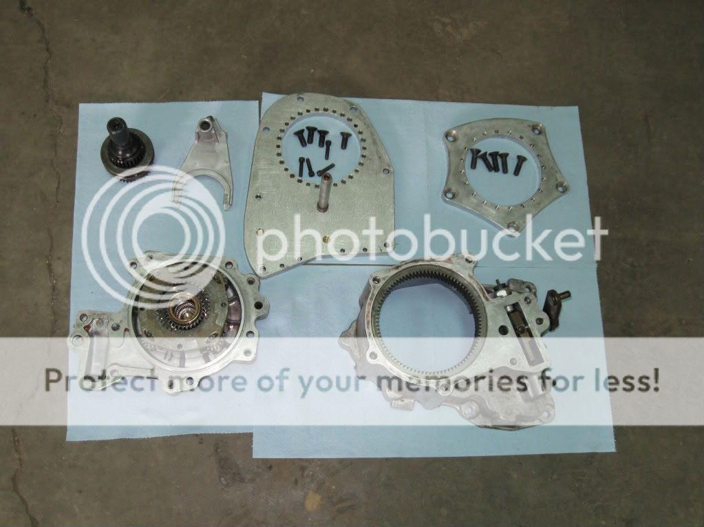

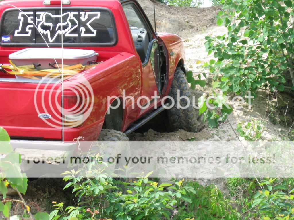

I aquired some damage as well, couple scrapes and a decent dent in my tailgate. Slid backward down a hill and smoked a tree, thought my bumper took the hit but it looks like my tailgate did. Also, my doubler was leaking like a siv. Had to leave early. It looks to be coming from two mating plates, so hopefully that's all it is. I'm going to rebuild it this weekend and I hope I don't find anything more serious.

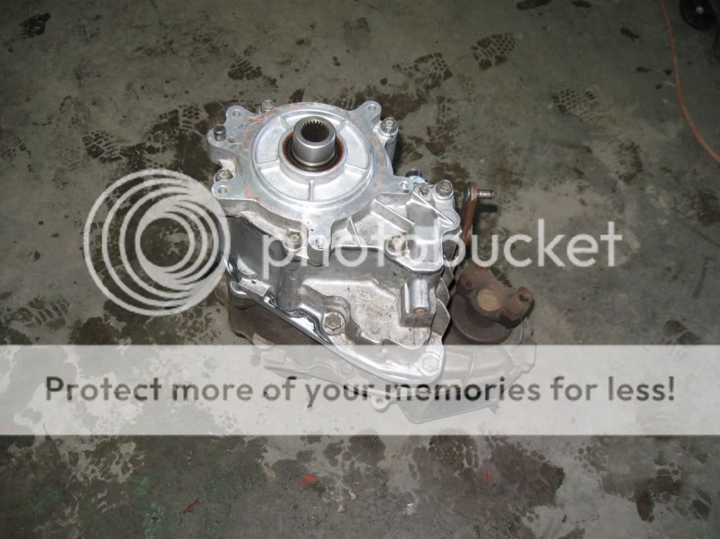

Well I got to bench press the doubler once again this weekend. I'm not sure what caused it to start leaking so bad. I checked to see if my front driveshaft was a touch too long, but I lifted the front of the truck by the bumpstops and I've still got right around an inch of spline showing in the slip joint. Dropped it down to full droop for fun and I've got just over an inch and a half of splines still engaged.
Anyways here she is, I'm about 200 miles short of having 15k on it. I don't plan to have it outta my truck again unless it starts to leak, again.
note - not all hardware is shown

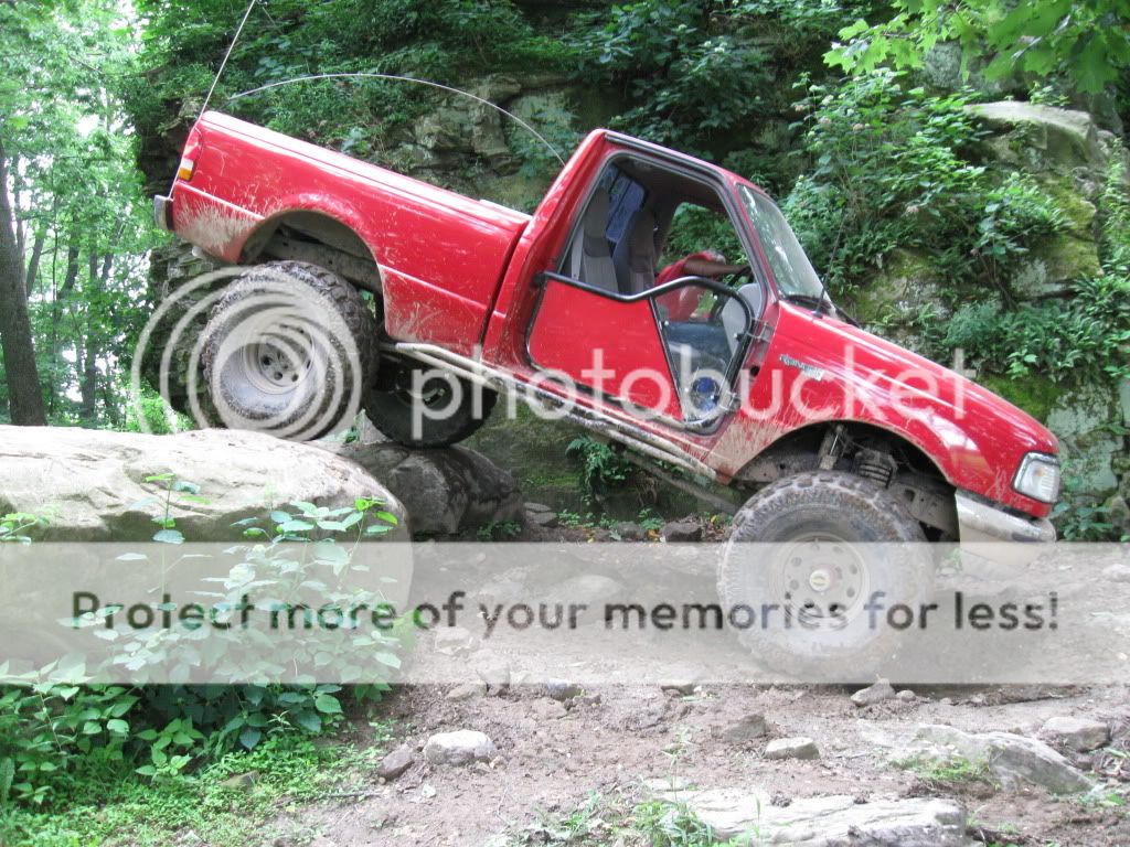

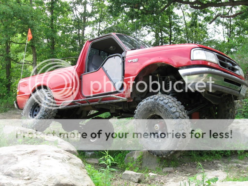

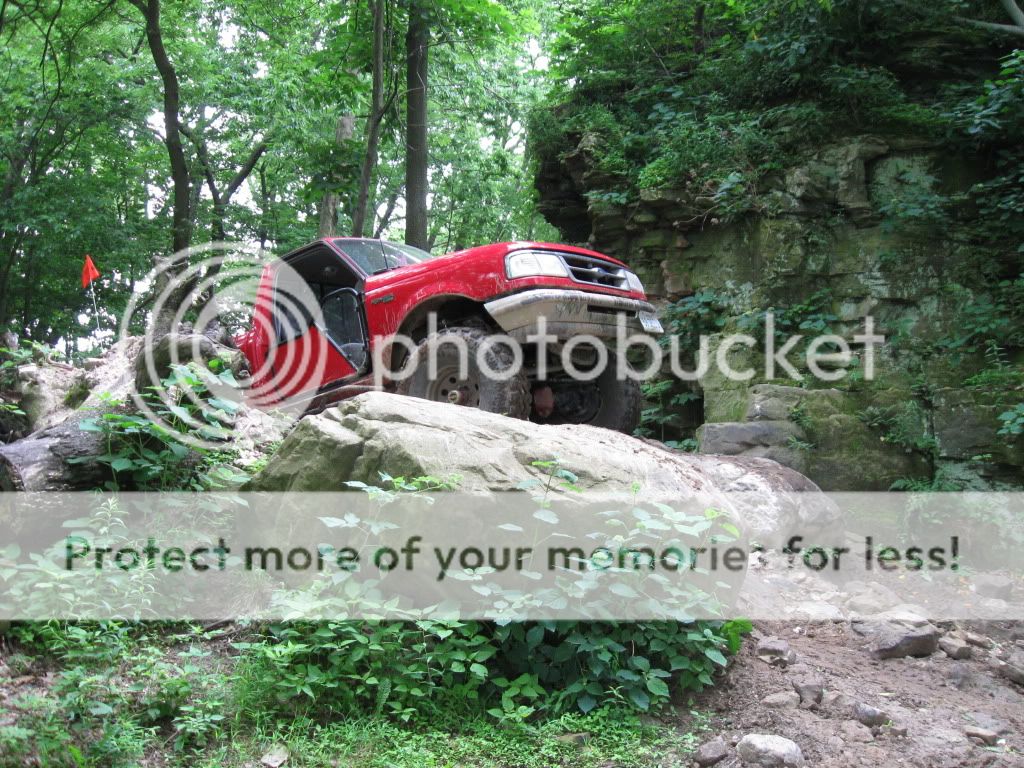

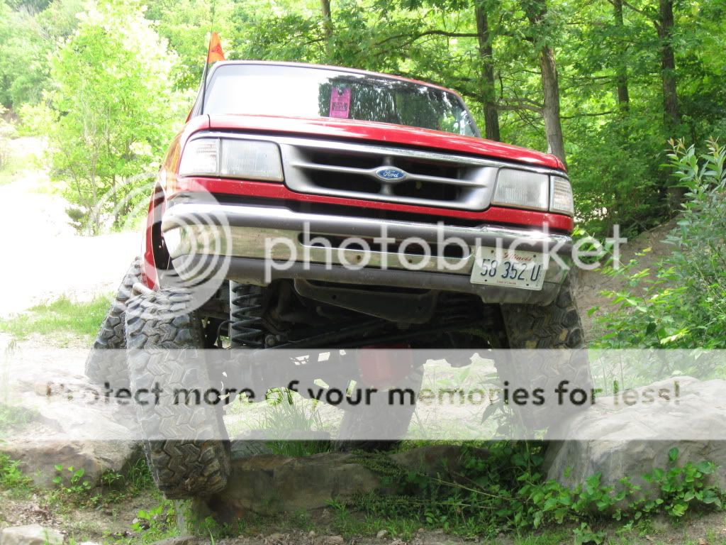

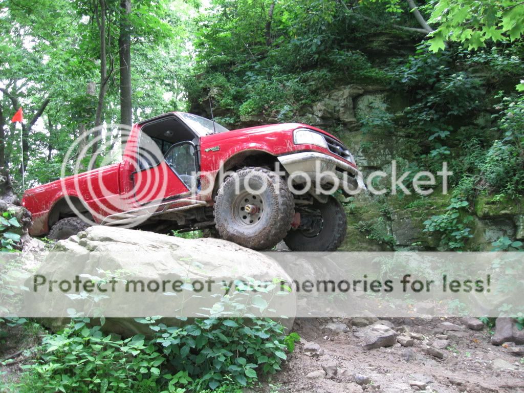

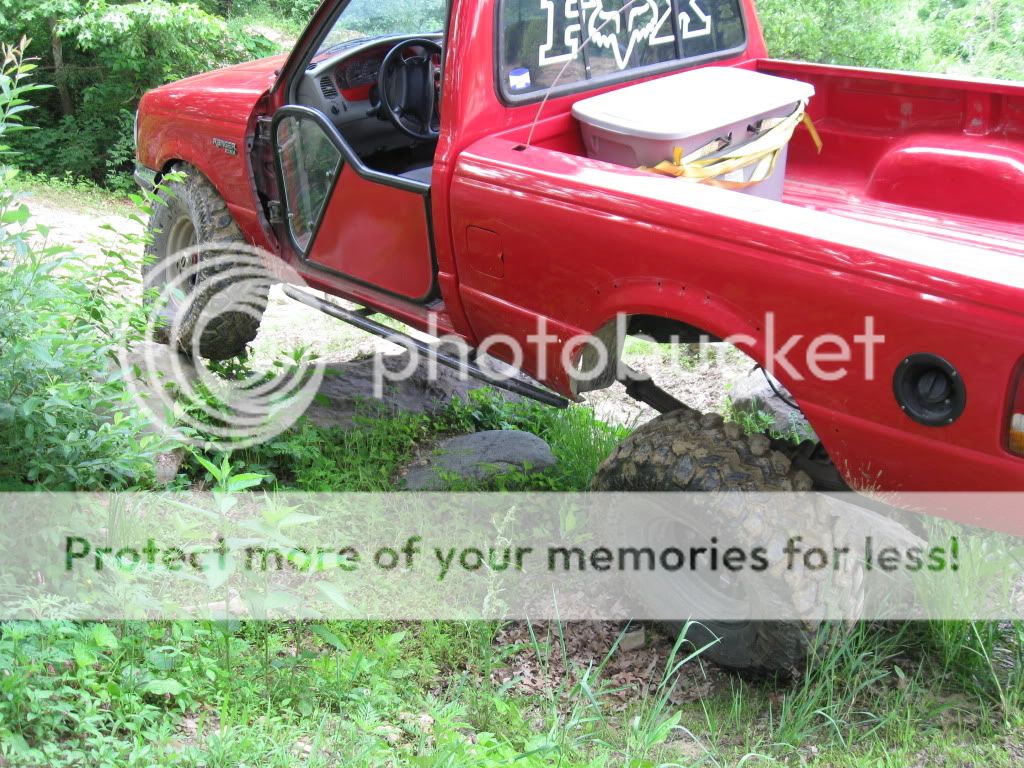

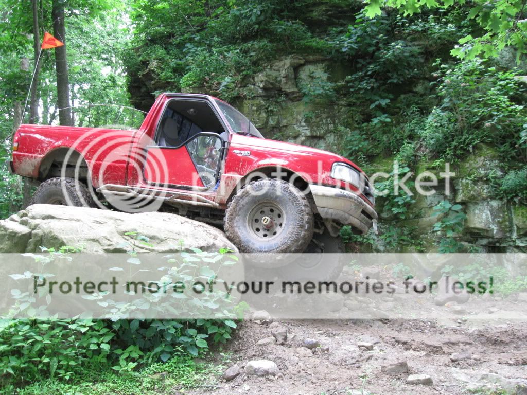

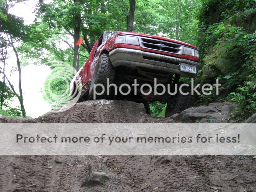

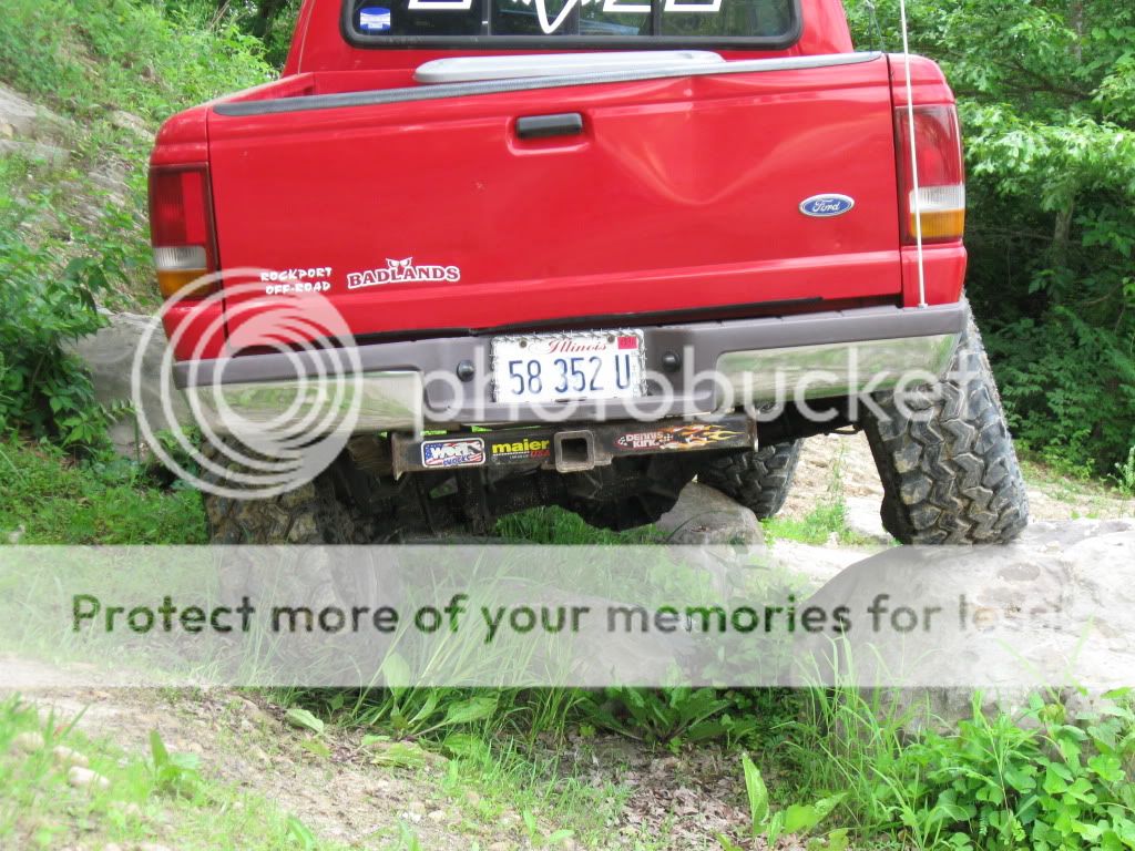

Went out and beat on the ranger a bit this weekend. I wish my gf was more into photography haha. Anyways heres the few pics we did get.
Poser shots
just a random shot
She went a little crazy on the pink trail haha
and a vid of the 2nd half of the trail. I came up the ledge a bit sideways, but I didn't wanna back up for a better approach. Still crawled it like nothin :D
