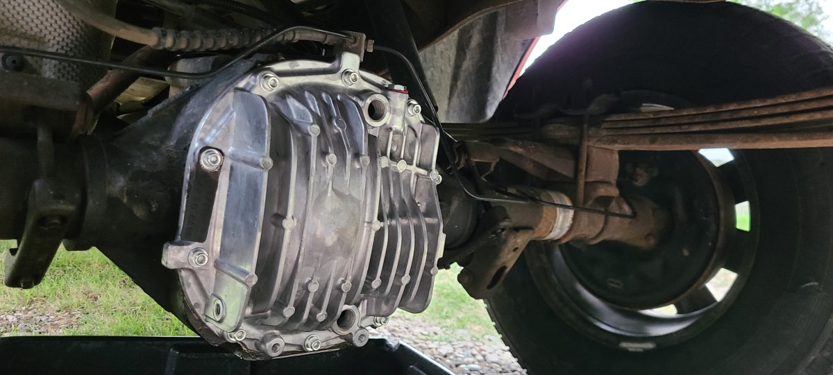

Motorsport clone finned cover is on. This is the one from amazon for like 50 or 60 bucks but its not plug and play. You have to grind an internal fin so the speedometer or abs tone ring doesn't get smashed into it when you bolt the cover down.
Flap wheel cuts it like butter, later trucks don't have tone ring too.

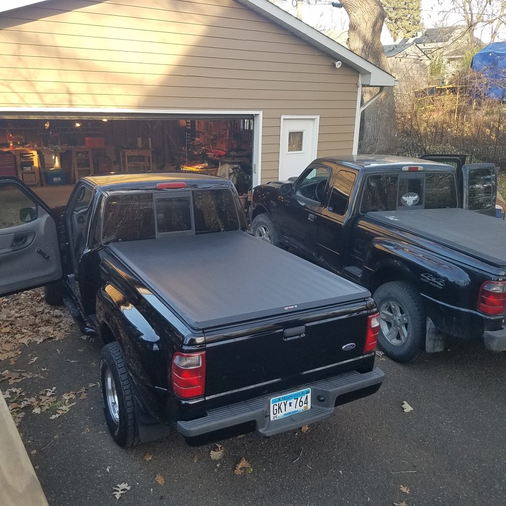

The $5,000.00 truck is on the right.
