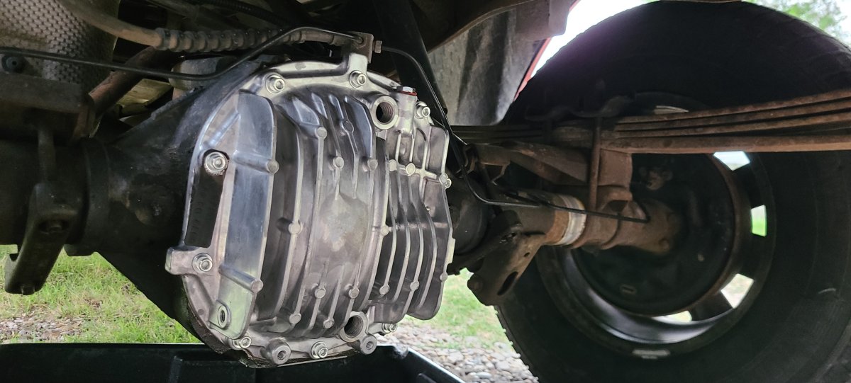

Once upon a time there was a comical glitch is the universe. You could get cast aluminum MOTORCRAFT Shelby GT-500 differential covers online for like $60, Ford Performance ones were like $200. Same part, one was thru their replacement part system and one was thru their upgrade accessory system. So I snagged one. Diff cooling needed or not, Ford came up with this apperatus for the Shelbys.
Cooling Differential covers, do they really matter?
I found a plug to plug the hole for the temp sensor and while I haven't yet I have the block off ports for the cooler lines for a drain plug and the top one to flush out the case if need be.

Ay that's the thing I was talking about!
Looks like it has an electric pump attached? I'm curious where you'd find power for it with the correct voltage all the way back there.
There is a sensor that goes in the cover so I assume there is wiring back there for it.
I put a normal metric pipe plug into that port and just use it as a cover. I am throwing less than a third of the hp at it and was mainly tired of my steel cover seeping and having no ability to drain the diff after water crossings.
I also had to knock down some of the internal cooling fins because my old Explorer axle has a tone ring than the Shelby wouldn't have.

I was wrong. There is tons of diff covers but the two 8.8 ones i was mis-remebering are ford motorsport 8.8 ones like pictured above. 200 bucks which is a nogo

Motorsport clone finned cover is on. This is the one from amazon for like 50 or 60 bucks but its not plug and play. You have to grind an internal fin so the speedometer or abs tone ring doesn't get smashed into it when you bolt the cover down.
