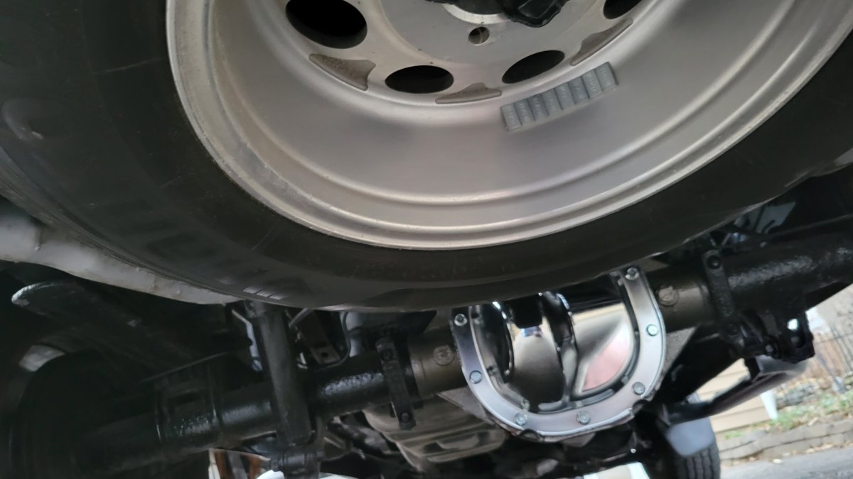

I recently had installed a new limited slip. I asked the transmission shop about a new cover. They said any would do. So I bought this for $40.00.
  • Cooling Differential covers, do they really matter?
Years ago I bought a summit alloy cover (for a 8.8 though) still have it, bought it for the drain & fill plugs, added bonus is that it holds more oil. I still have it-somewhere.
I doubt your truck would generate enough differential heat to be a issue- unless it was very low on oil, Then you’d need another axle once it seized up.
I wanna say that looks like a stock 8.8 cover but since it's so shiney I can't tell?
Yes, 8.8.

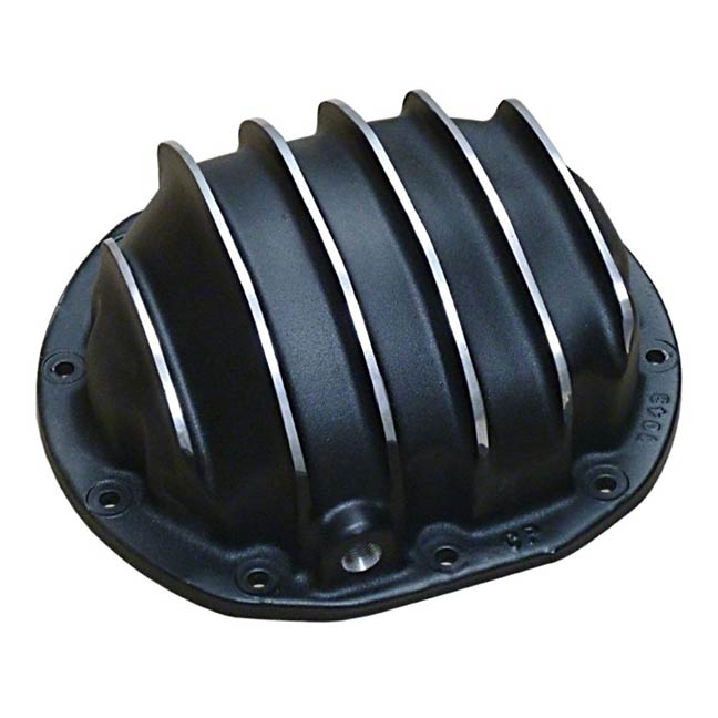

@sgtsandman types faster: Banks that demonstrates that the cover pictured by @Uncle Gump does worse job at cooling then the stock one in @Lefty 's picture as there is some science to the stock one keeping the oil liquid, while the aftermarket one tends to foam the oil and as a result it heats.
