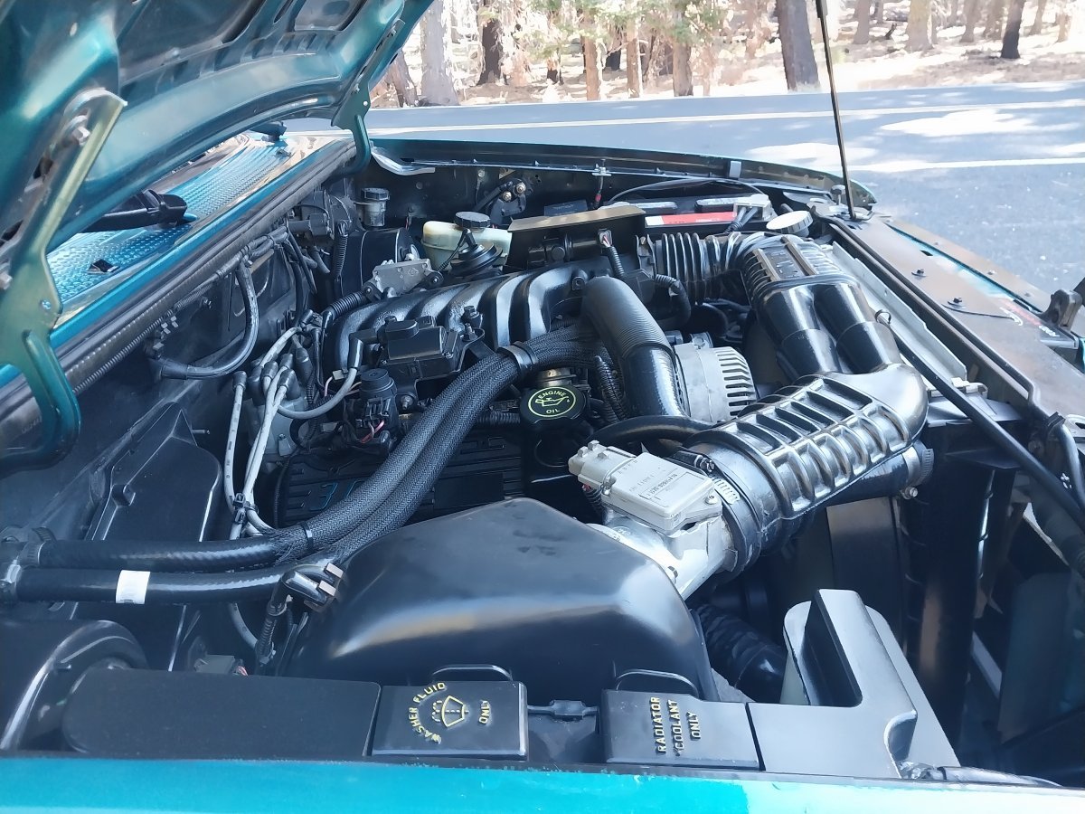

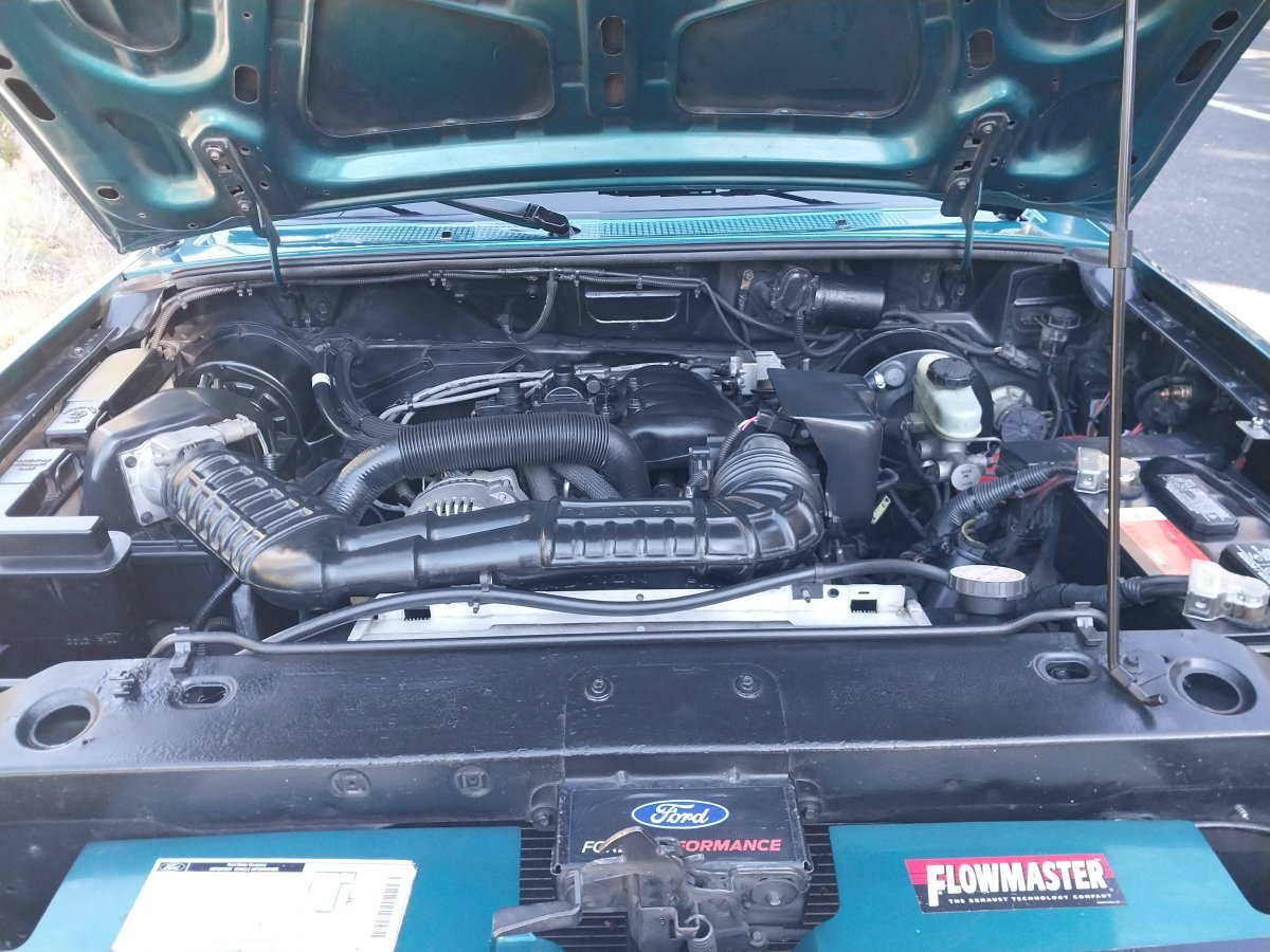

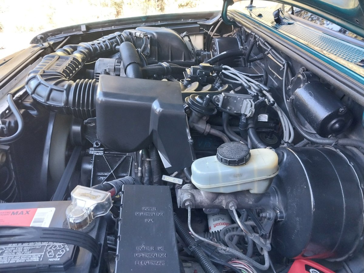

That is what you need to run a 2 row radiator in your 93. Both hoses will match up correctly with no modifications. Even the bigger fan shroud will fit correctly. Both went into my 94 3.0 5spd ranger very easy. Some pictures for you to compare. I would do again. I now have a 97 3.0 5spd ranger i purchased last year after my 94 was totaled. When my 97 needs a radiator I will do the same thing. I will need a 2 row radiator fan shroud from a 95-00 4.0 explorer. I plan on getting one soon just to have.
