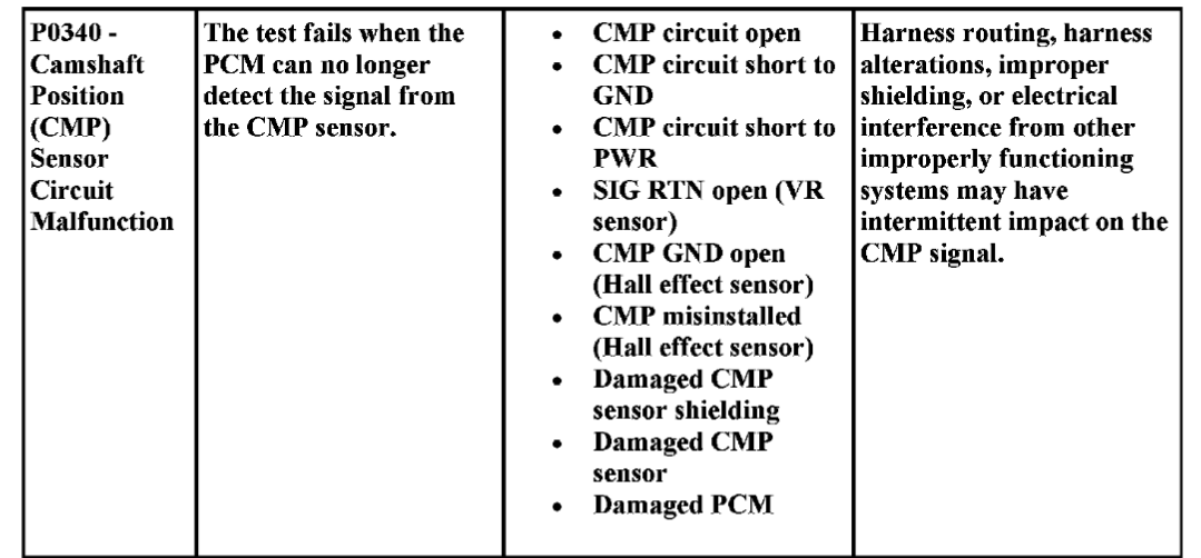

I would check the connector and wires to the cam sensor. Also the ground straps from back of block to the firewall. Is there any play on the cam synchro under the sensor? If both are aftermarket, the air gap could be off.
Here's some diag from a TSB
  • Code P0340 isn't going away.
