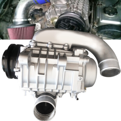

Go with a turbo and intercool it if you want more than 5lbs
OR
^^ get one of those.
You'd still have to build brackets & plumb the thing, but it doesn't cost many thousands of dollars and will give you boost throughout the entire rpm range
