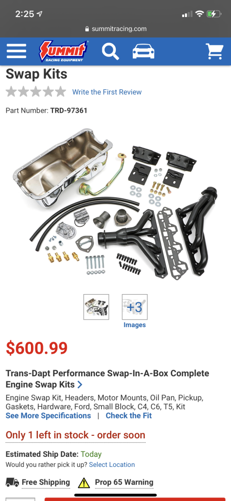

so i found this kit for the 302 swap. i have been reading abt this swap for quite a long time but can’t seem to find all the information that i need. i have an 88 tbird 302, AOD tranny, and an 8.8 rear end readily available. but i can’t find a thread on EVERYTHING i need to do this swap. i know that the explorer is a direct swap, but i do not want EFI. why won’t this kit work on an 01? what’s the difference between a 97 and an 01 that makes this incompatible ? what ALL parts do i really need to make this 302 run in my ranger ? my truck is a 2001 ford ranger 2.5 5 speed single cab. please help, and thank you in advance !
Ford changed the entire engine bay and front suspension in '98.

i don’t mind to completely remove the hood. i’ve seen you on this forum quite a lot, do you know why this 97below kit won’t work on my truck ? what do you mean “regular intake”? what all parts will i need to do this carb swap
Might be the motor mounts, 1998 and up could use explorer 5.0l mounts
