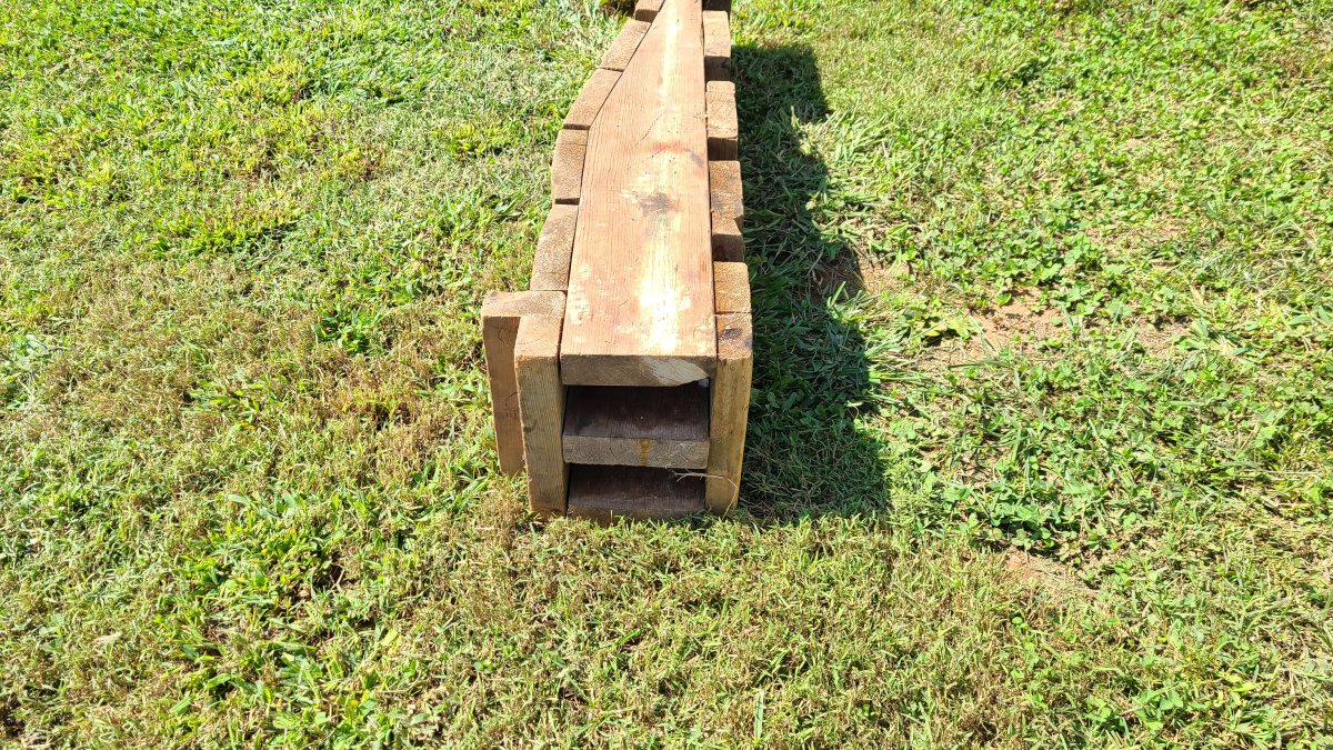

If I was going to buy some, I would get those plastic ones. I don't trust the stamped metal ones. I have 2 pairs of wooden ramps. One is a pair my dad made when I was a little kid, or earlier. Thatsmy favorite. Each one has 3 2x6's or 2x8's on edge with the ramp profile cut out. Then pieces of 2x6 nailed crosswise on top and bottom to tie it all together. Heck. Give me a minute I'll go out and take a picture.
Ramp. I use these for the Fun50. The Ranger sits high enough it doesn't need them. In fact, I was crawling around under it with the pressure washer this morning.
