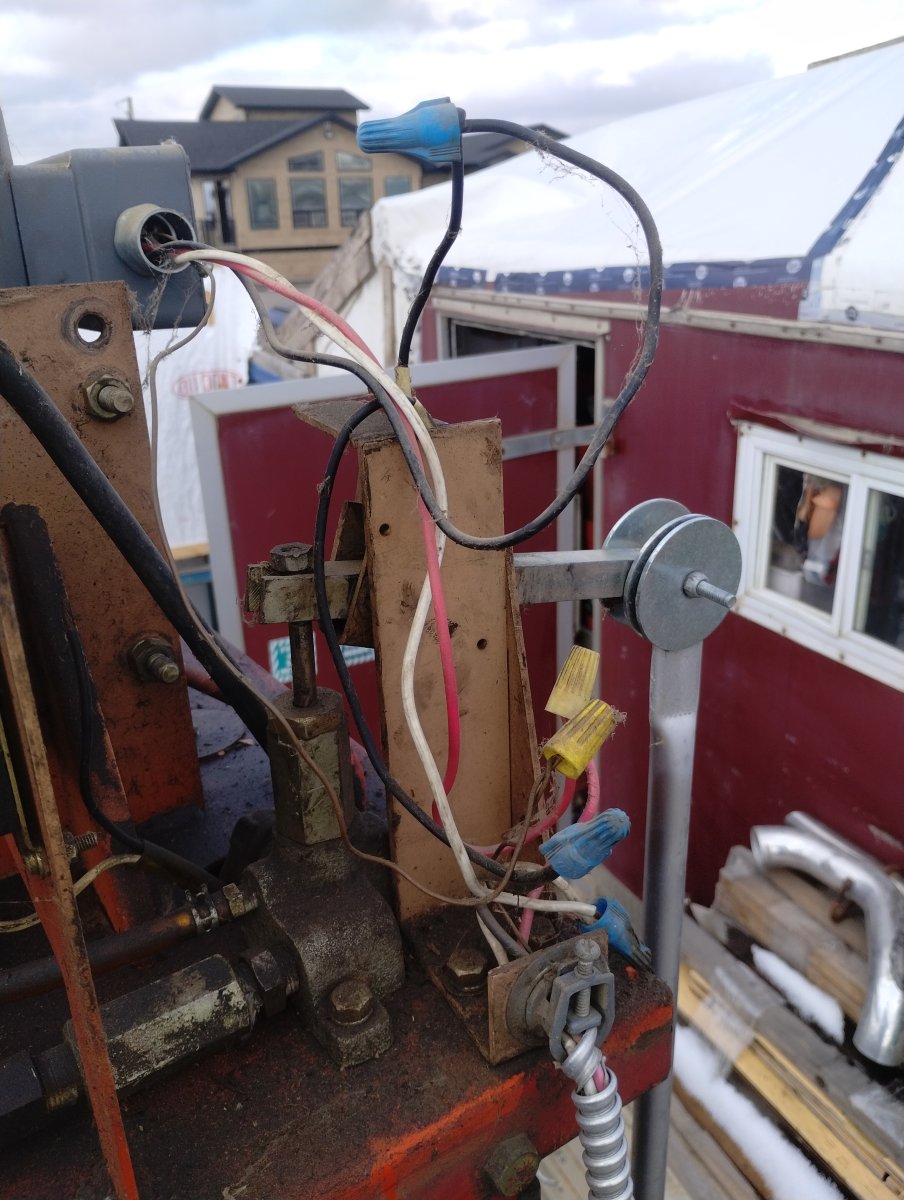

I took a look at the electrical of my new to me lift. It used to be a 3-phase 3hp electric over hydraulic system. The manufacturer shut their doors on 1984! So no manuals to be found as yet.
The farmer that sold it to my boss put in a 220V 5hp Baldor. The motor starter has been bypassed. The safety at the top of the column is bypassed. The wiring was done by a farmer...
So I will fix the connections and wire the safety cut-off back in at the top of the column. The unit was working when it was set up at my bosses place so I don't believe I need the motor starter.
Then I have to figure out what fluid slopped out of the reservoir. Probably hydraulic jack oil but....

I haven't touched the wiring up top yet. I decided to hook up a plug and see if the motor works... And it does! That makes me happy. I'll sort out the wiring up top next, but probably after I get over the cold/flu that I'm in the middle of.
I went back out and removed what I thought was a small bolt holding a large washer. I wanted to see in the tank and try to figure out what type of fluid is in there. I know someone suggested in a different thread that its most likely aw32 hydraulic fluid, and that makes sense to me, but I want to confirm it by seeing and feeling what's in there.
Anyway, that bolt ended up being a dipstick! And nothing shows on it...
