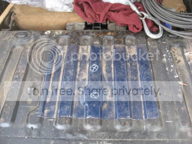

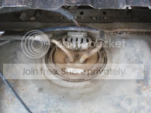

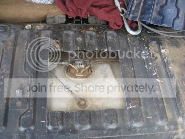

The following pics are pretty much explain themselves. They are of a b2 I bought with a 4.0 transplant. I was told the pump came from a mustang. I no longer own this. I felt this was easier than dropping the tank to fix the pump.
edit; it should be noted that I never had rug back there to begin with. I don't know how difficult r+r the rug would be.

That looks really smart, floored. As in, it looks good. lol

that looks a lot easier than dealing with a bunch of rusty hardware but how did you get it to stay in place when you put it back? did you just weld it or was there another way of doing it?
I never did get around to finalizing it. My plan was to use a bead of silicone caulk around the perimeter of the bottom and let it dry before screwing down the top plate. Letting it dry would make it easier to remove if necesary. FYI silicone caulk will NOT stick to itself once cured, probably why so many silicone caulking jobs leak.
