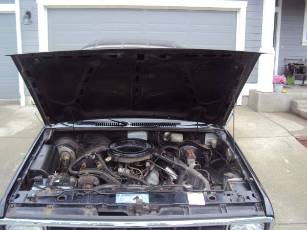

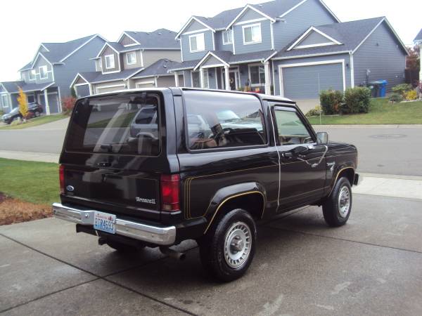

Just recently bought a pristinely maintained, bone-stock 1985 Bronco II (pictures below). Manual, 2.9 2.8. Want to turn this into a beast. 302 swap, suspension, all the bells and whistles. Want a overlanding/outdoor rig that I can also cruise around in. I've been scouring forums all over the internet and have the general idea of what to do, but I'm missing pieces and want to check with y'all. Never done something like this so want to check I'm getting my plans right.
Plans
Engine - Found 93 mustang fox body at junkyard, getting engine for $500. What's everything I need to grab from the mustang?
Transmission - Read stock transmission can't handle V8, need to upgrade. Upgrade with what exactly and what components? Can mustang transmission work, it's a T5?
Suspension - James Duff stage 3 lift, body lift. Read I need to upgrade axles. I've read front = dana 35, rear = 31-spline 8.8-inch axle. Are these both from an 90's explorer?
Wheels/bumper carrier/ other bells and whistles
What else am I missing? Videos seem to have a laundry list of upgrades.

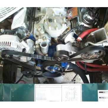

You will want the FEAD components from a 5.0l Explorer. This keeps all the pulleys and things closer to the engine so you have room for radiator and fan.
Explorer has the best of everything as far at the engine goes. Better heads, intake, FEAD, decent cam... all in one foul swoop. I would grab rear axle too. If the Explorer is new enough to have a V8 (96+) it is new enough to have factory disk brakes (95+) 91-94 Explorer for the front axle, the rear will work if you want rear drum brakes. 90-97 Rangers can have D35's as well but watch out for the hybrids, 95-97 Rangers have dual piston bolt on calipers.

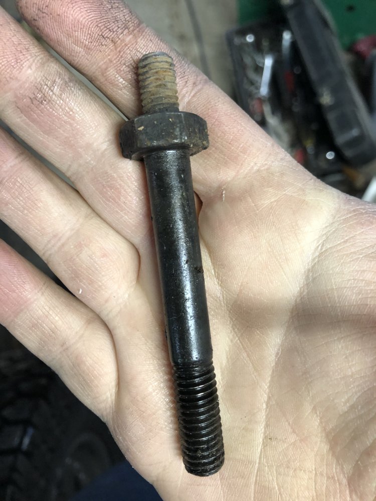

You will need the dual sump pan and pickup from a foxbody though. Get a new pickup whatever you do, I snagged a pan off craigslist for like $20. There is a special main cap bolt that has a stud made into that holds the pickup too.

I pulled the FEAD out of an Explorer for mine, I think it is about half the work of pulling the whole engine. Big PITA but however you want to cut it the accessories are VERY worth it.
Here is the writeup on how to install and make it work in an older truck from when I installed mine:
